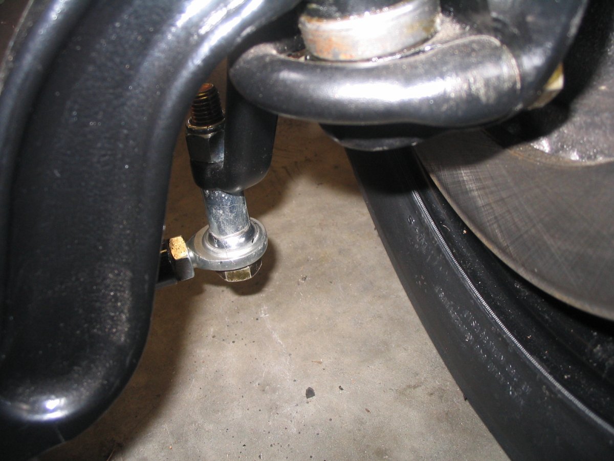

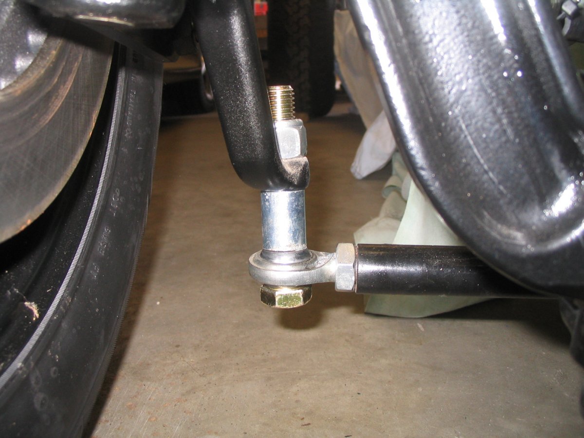

    Well, I got bored and swapped in the Zinc coated spacers. They actually look good, but only time will tell how long the coating will last.o_O At a few bucks each, if the coating wears, I'll just get a couple more. In my ****tered mind, the look is worth it.

    Everything on that link is cad. plated. It will last a while. Then dull. If you want some bling for small bucks just drill some chrome lugs for the spacers and get some stainless steel fasteners and polish them. I've been upgrading a lot of the stuff on my roadster with SS.

    Well, the package said Zinc plated, either way, they'll be fine. Thanks.

    Your right Fred the spacer is zinc plated. If you keep wax on it it will last a while. But the wax might darken it. Still who cares.

    The spacers will probably be just fine; but I would be leery of the unknown qualities of the material they made from. That is a pretty highly stressed application; I would make those spacers out a chunk of DOM tube, the same diameter as the eye on the steering arm for full support and also add washers on either side of the heim joint to capture the end in case the ball or bearing failed. Not a real fan of a spacers on steering arms like that; but recently was stuck using one to make one of those stupid Unisteer cross steer racks on a friend's '33 fit.

    I have a friend who has had heim joints in the steering of his T for a very long time.
    Safety washers are a must, if you search for them you will find that they make specific special washers for that purpose.
    Another thing that will extend the heim joints life is to use seals on them.
    Speedway motors sells them for a reasonable price.
    My buddy uses both safety washers and seals.
    I was going to use heims on my T but decided instead that I felt better about using proper steering tie rod ends.

    They're DOM steel 1/8" wall and the ID is 5/8", same as the steering arm eyelet.

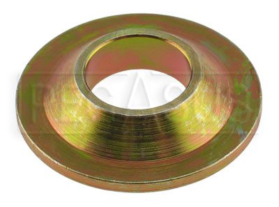

    Someone on the "Tbucketeers" website suggested these:
    https://www.pegasusautoracing.com/productselection.asp?Product=3068
    I'm going to order four in the 5/8" ID size. They're 1.432" diameter, which should cover the whole face of the rod end.

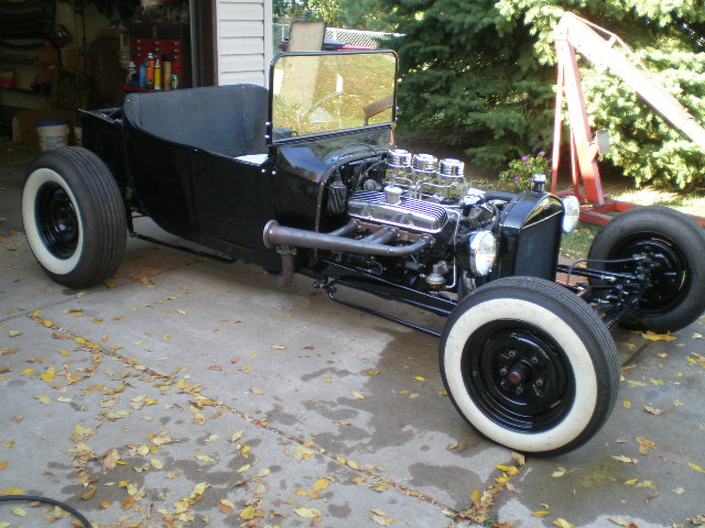

    Ok just to throw a curve ball, I have been setting up a front axle (37-46) with hairpins on cast batwings. Now here's the question, for the best look should the hairpins (1) lay parallel to the ch***is, (2)point down at the rear or (3)up at the rear. I've been unsuccessful trying to find photos that give a clear indication. On my roadster they point down.
    the difference will be where they anchor on the ch***is.

    Just my opinion; hairpins and regular split 'bones should run parallel to ground or slightly up-hill to the frame; a noticeable down-hill slant to the frame looks "broken". (sorry k1w1)

    Mine are slightly down. I think yours look fine.

    Just ordered the safety washers from Pegasus. Should hopefully be here by the weekend. I'm going to check on the beauty rings Wednesday. Seems O'Reilly's has chrome ones for $12 each. I'll check them out and give my review.
    Speedway's are $25 each and I used them before. Stainless steel and always looked good.

    That's a nice T, Rich! Is that yours?

    Honestly, I've seen them go different ways. It seems it depends on mounting positions and where the mounts are located. On my last T, I think they were slightly down. I'd say, as long as nothings in a bind, go for it.

    For me its look best if the anchor is just under the frame or in the lower half on the framerail.
    And then the angle depends how the frontend is setted up.
    My build got them pointed up couse i didnt want my anchors hanging low from the frame.

    On their way. Should be here Friday or Saturday. Beveled on the inside to cover the ball of the rod end. 0.270 thick. 1.432 in diameter.

    Exactly what I ordered from the same place.
    I've got 4 in the drawer in my garage.
    Since I'm not using heim ends I have a plan to use them for retaining washers on my coil overs.

    As for the mounting points, I would try to keep them parallel to the frame or 'up' at the frame mount so there is less hanging down for speed bumps to grab.
    More like Rich Bs than that early photo of the kookie car. Yeah, that's blasphemy, but that mount hangs down quite a lot from the frame. Guess the oil pan hangs down too.
