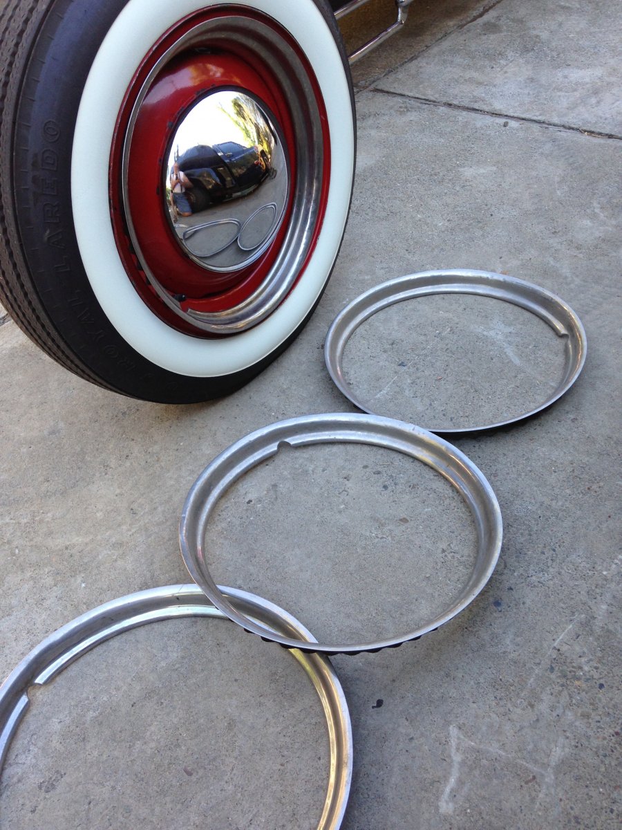

    I looked at the beauty rings O'Reilly's sells for $12.99 each, today. They are chrome and 2" wide. Speedways are polished stainless steel and $24.99 each. They are 2 9/16" wide.
    The O'Reilly's brand looked good, nice chrome, but were tweaked a little and just plain felt flimsy. Maybe they straighten out when installed? I used the Speedway style before and I liked the look, plus they were very well done. Beyond that, the missing 9/16" on O'Reilly's just bugged me.
    So, I'm going to wait and order the ones from Speedway next week.

    Sorry Fred, but O'Reilly's are cheap junk.
    Make sure they come from someone reputable like wheel vintiques.
    Stainless will be better and stronger.

    Fred don't buy any until I check my hangers.
    Rebel

    Okaaaaaay. Rebel, keep in mind these are after market wheels. Speedways are a universal fit, so maybe OEM's would work? I'd just hate for you to go through all the trouble and they not work.

    Fred
    These I have are kinda dinged up. I would't run them on my roadster but I would run them on my '48 Ford.
    If you want them and think they might fit I will send them to you.

    ^^^^ Fred, don't let the those flaws deter you; trim rings are pretty easy to ding out and buff; even if the holder (bare rim) gets a little heavy after a bit.

    Thanks for the offer, Rebel, but I'll p***. The one's I'm getting are smooth with no ridge. I just like that look. These are what I'm going with.

    Yeah Fred those are nice. They are better for your time frame. Mine would look good on a '50s rod.
