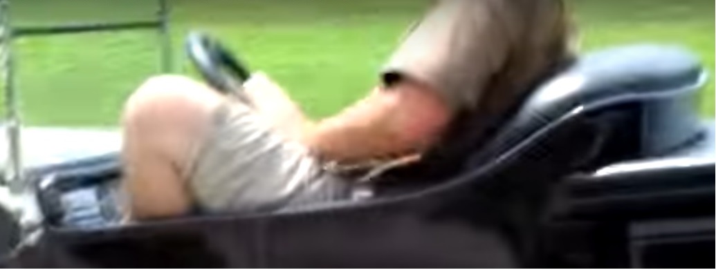

    I also found this one. This is what I DON'T want to look like driving a T! Seems the rear seat padding is too thick, seat is too high and he still has knees to the middle of the windshield. It's tough being tall!
    BTW, non-HAMB powerplant

    Probably the MOST important part of building these cars is seating. Now, what I'm going to post next were MY findings, when I did my first T Bucket and was dealing with seating. As well as plans for the car I'm building now.
    I'm 6'3" and knew I wanted to sit as low as possible, so I made a wooden box at a height I figured would work. I ended up with 3, before I found one that was as low as I could go and still be comfortable. It ended up being 4" tall. While I'm tall, I'm also thin and flexible, so having to pull my knees up slightly, wasn't a problem. I made a seat bottom that had webbing on the bottom and padding. It was 6" tall, but when I sat on it, I sank about 2" ending up at my target 4". The padding was 2 pillows I found at a fabric store.
    Knowing that free space was VERY limited, I chose not to use a lot of padding on the back and sides. My solution was 3" of padding on a back that was hinged, so it would flip forward. I didn't use any padding on the sides. The rest of my interior was covered in brushed on truck bed liner. I liked the thought of easily cleaning and the "spartan" look. Here's a pic.
    In the above pic, you can barely see the white shift knob on the floor. That was Total Performance's shifter set up. It moved the lever to the right side of the transmission and was short, so it was out of the way. It's no longer available, but sometimes they show up on Ebay. I was lucky and someone on another site found one for me, for my present build.
    This is how I looked driving my last T Bucket.
    As you can see, my knees were about 5" above the top of the body, but again, it was comfortable to ME. This time around, I'm going with a 8" stretched body, so I'll have a lot more room. I'm also planning to have the seat or seats (thinking about bomber seats) almost directly on the floor.
    Here are pics of me sitting in a stretched CCR body, like the one I'll be using. If things go as planned, I'll be low in the car and if I want to, I'll be able to stretch out my left leg. The steering column goes through the fire wall, instead of the floor, which also frees up a little more room.
    In closing, if you plan out your interior in these cars, they can be comfortable. But unless you're 5'9" or less, you'll never achieve the seating of a "normal" sized car. The choice then becomes comfort over looks or vice versa, with a very fine line covering both. I was at a local car show and someone commented about the look and lack of seating in my car, which was funny to me, because an hour earlier, I'd watched him crawl out of his 6" chopped and 3" channeled Model A Coupe! He swore he was comfortable with that.
    Bottom line, when it comes to the interior of these cars, you have to plan them out with the same amount of thought you'd put into the drive train.

    tight.jpg Yep, it's been talked about here before, but saw the video and thought it really drove the point home.
    Thanks for posting your pics again.
    Again, when I get serious, I'll have to connect up with Chip and hopefully test sit in his T.
    6'4" here at ~210#. Less limber than 20 years ago, but that applies to almost everyone!
    I got a 97 Dakota standard cab a year back and it's just too tight. I constantly want another 2 inches more seat back.
    I sure don't want to build something that is that tight or tighter! I should probably plan on a stretch like you are.
    I posted a std one from RPM in the body thread, maybe I'll add a stretch one over there, even though some here hate them...
