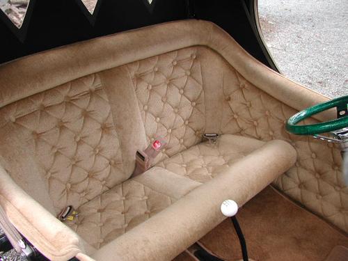

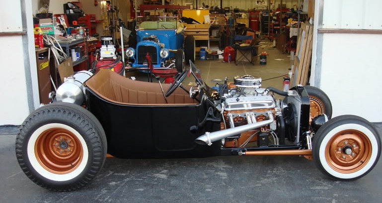

  11. I'm in the same boat as you Fred in working out in my head the seat arrangement, I am impression with what Don did with his T Roadster a couple of years back and sorry, this is the only photo I have of it. The second photo is from another T that I really like the style of too. And finally one that I like the style of again but for maximize room inside, I believe Don's hits the nail. PopsTdone005.jpg 249.jpg Nice T Roadster Interior..jpg
