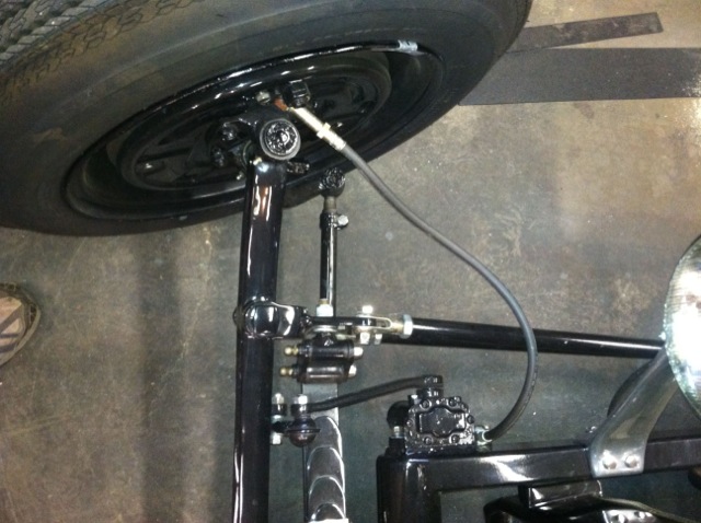

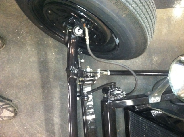

    Instead of coming straight out from the frame with the brake hose; if you aim the bracket up hill, it changes the arch and motion of the brake hose thru turns. Could give you more room around the steering arm and drag link. Only have a picture of the wrong side; but it should give you an idea.

    That would change the arch, but the issue is the section of the flex-line that comes off the caliper. It's like the one in your pics. That hard section keeps the line straight, then it begins to curve. The part of the hoop that rubs is right at the beginning of that curve. Changing how the line comes off the frame, really won't help. It appears that the only way to make the hoop work, would be to add a section of rubber hose at that curve, right after the straight section.
    When the paint dries on the hoop, I'll install it and get a pic, so you guys will have a better idea of what I'm referring to.

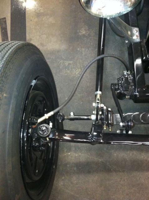

    Okay, here's a pic of the opposite side. See the bolt coming off the spindle? On the steering side, that's where the hoop would be. Notice the proximity to the hard section of the brake line? It rubs the hoop about 1/2" after the hard section. But only when the wheel/tire is straight. It's clear during the turn motion.

    Okay....... the hoop is a wash. I installed it and noticed another issue. The through bolt, that will support the rod end and drag link, will get caught in the flex-line. Even with the rod end mounted on top. The head of the bolt would catch. A longer flex-line MIGHT work for that, but the looks of the hoop aren't worth getting new lines. So, the hoop is a definite NO GO. Thanks for all the suggestions. I guess in some cases, things are best left alone.

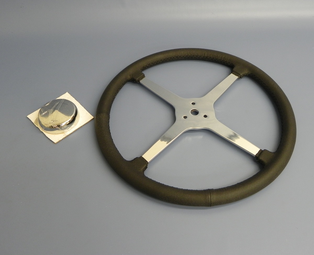

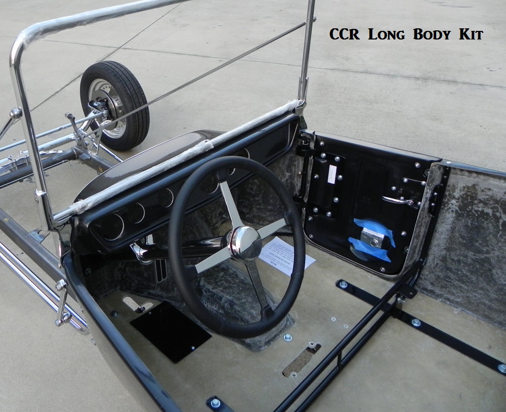

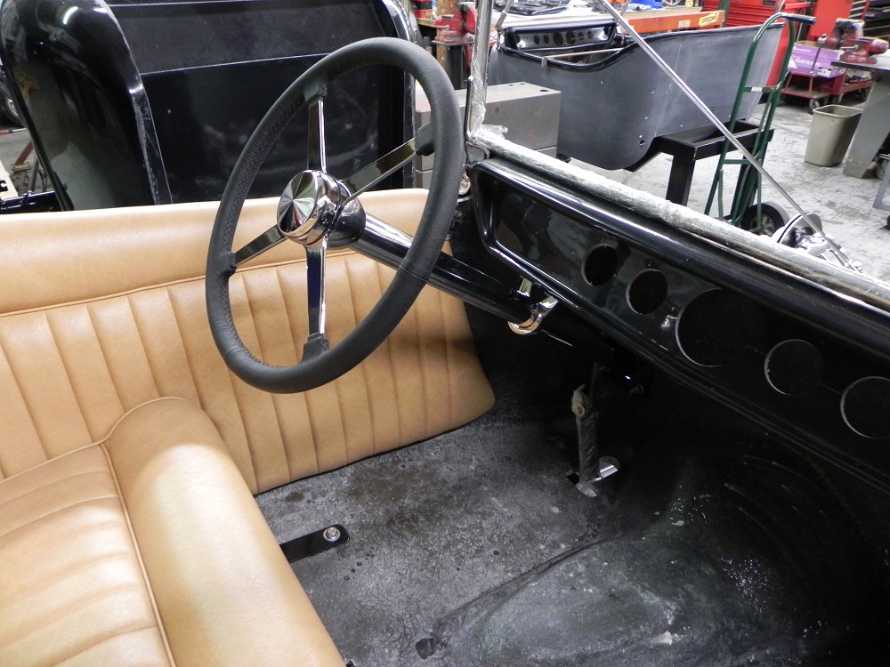

    On a milder note....... as I get increasingly closer to getting the body, I've used this lag time to source out interior parts. I've already picked out the seats. Today I finalized the steering wheel. It's 15" in diameter wheel from Limeworks and CCR uses it in their T Buckets. My last steering wheel was 13" and gave me room to get in the car. The steering column (from Speedway) I've chosen has a removable hub, so this 15" diameter wheel will be removable for easy entrance. Now, it's almost 4 times as much as the Grant steering wheel, which I was originally going with, but I just really dig this style of wheel. So, here's the pic.
    I think it'll be a perfect match for the seats I've chosen. Here's some pics of it mounted.
    I think, if you put all the pics together, you'll see my vision of the interior. This is NOT going to be your average T Bucket.

    That steering wheel is the ''Cats Meow'', Fred, shaping up to be a great build. Not that it wasn't before!! JW

    Sweet wheel, Fred! I knew you wouldn't choose a Billet monster or a 2 level spoked finger cutter!
