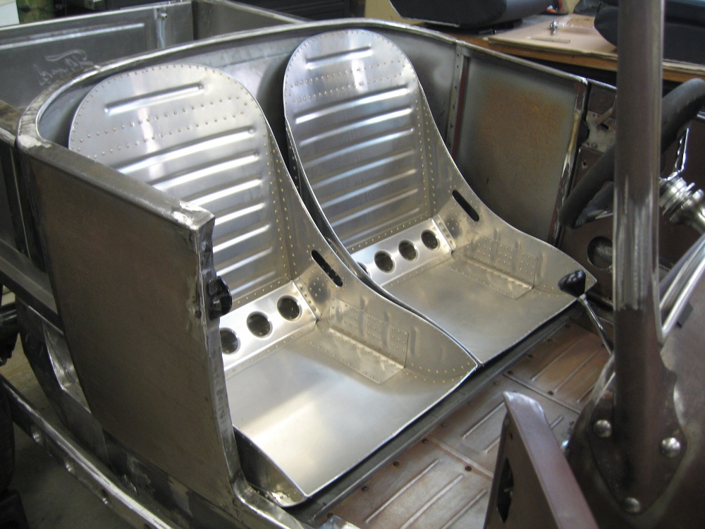

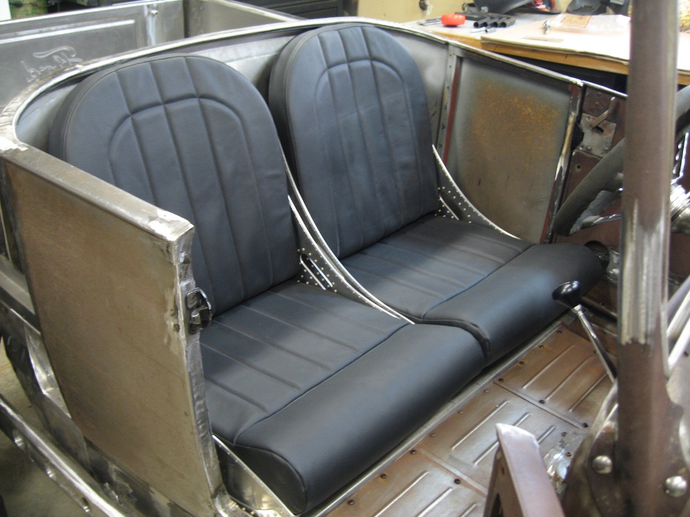

    What in the world is wrong with you guys? :D
    It's mmmm bomber seats. :D
    Point one, a bench doesn't give you more room.
    Point two the bombers can look good and be comfortable.

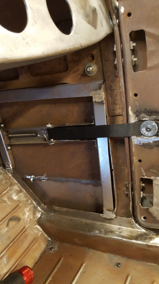

    Hi Fred , Since it's a metal body I bent some sheet metal and welded in a frame like structure that I could drill for the pointed Ford door panel spring clips .
    If you look close here you can see the kick panel framework and also the frame beside the seats.
    Something similar could be done on a fibregl*** body too by screwing the frames to wood gl***ed into the body.

    Interesting check strap setup Blue one.
    I like!

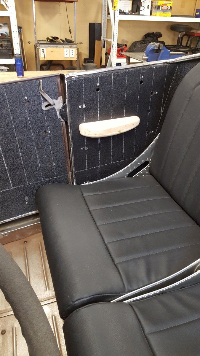

  11. And on the seats, you might ask Corbeau if you can get a set without the badge sewn on. Never hurts to ask. We bought 4 of their buckets for a '35 Ford 2 door sedan back in the 80's, they were very accommodating back then.
    Sent from my SM-S902L using The H.A.M.B. mobile app

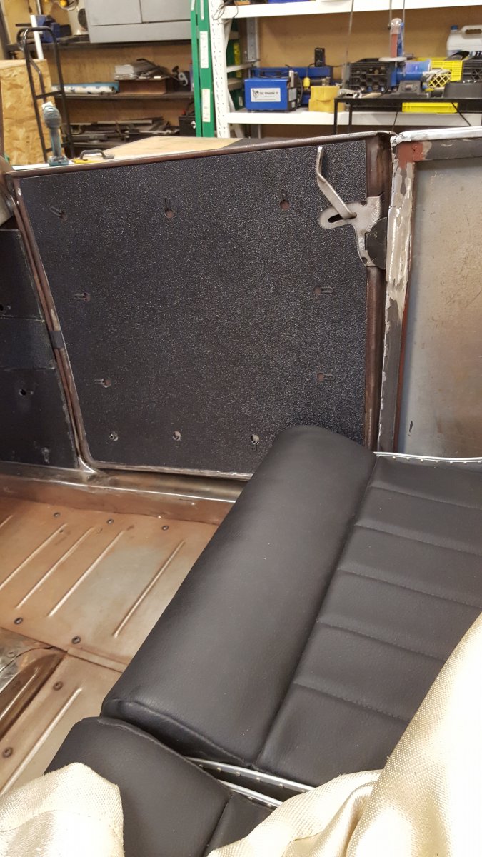

    Rebel, the parts I have chosen are NOT just because they are cool and there's certainly NOT a lot. So far, my seats and a steering wheel are the only parts out of the "norm". I'm working towards a goal. An original idea and style I have in my head. Neither you, nor anyone else see can it, that's understandable and unfortunate. It's in my head and a few rough sketches. No harm. No foul. I have NO way to control or censor what you or anyone else thinks or writes. I take it all in, process it, check if out and if it doesn't jive, I kick it to the curb. So, whatever you feel you need to write.... do as you will. I'll keep posting.
    Now, my take on the cafeteria fibergl*** seats, that kinda look like bomber seats. Actually, a LOT like bomber seats. While they could work, in the end, they'd still look like what they are, a cheap, ugly solution to a critical situation... MY *** comfort. I didn't like them in school and I sure as hell wouldn't ride in them now. I also remember my friends and I taking pleasure in cracking them in half, by just leaning backward too far. So, no. They're not going into any car I build.
    And speaking of seats for MY ***, I just recently posted on my "T Bucket Interior" thread (post #49) and I'm probably going for a bench seat, after doing some more research and info from a rep at CCR. Hell, I may even make my own, using Corbeaus technology. So, all this stuff about bomber seats, is going...... guess where? To the curb. For now, anyway. Tomorrows another day.;)
    Now, if it seems like I'm taking over Chip's thread, then he's more than welcome to ask me to post else where. Again, no harm, no foul. I'll post a link to it and go away.
    Rebel, I respect your opinion and ideas. They may not jive with mine, but it doesn't keep me from reading what you post. And deuglifying is and always will be a matter of opinion. If my build offends you or anyone else, I can't change how you think or feel. In the end, I'll be the one driving it and living with it.

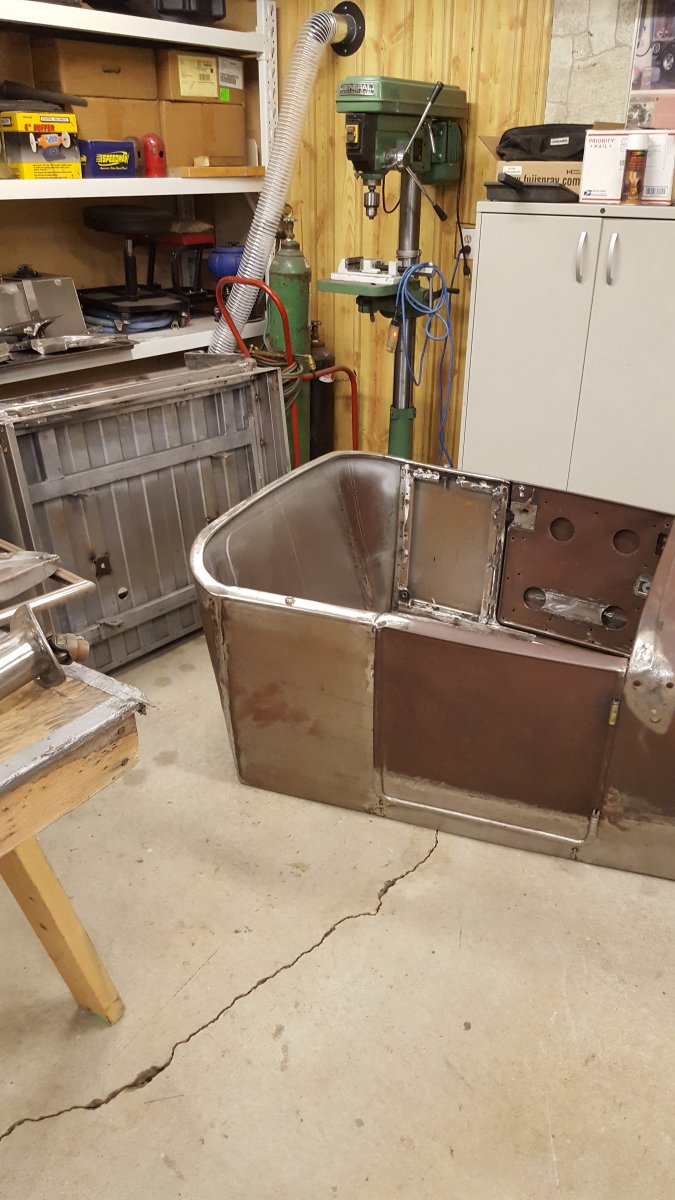

    Well, today I had what can be described as a moment of clarity. I've decided to get my body with a door. I'll have to save a few extra weeks, but I think, in the long run, my future knees will thank me. A plus is that the sub structure will strengthen the already sturdy body. Of course, this is going to effect seat options, but I'll keep mulling things over, while I wait.
    So this means the fat lady is going to stop and grab some burgers.;)
