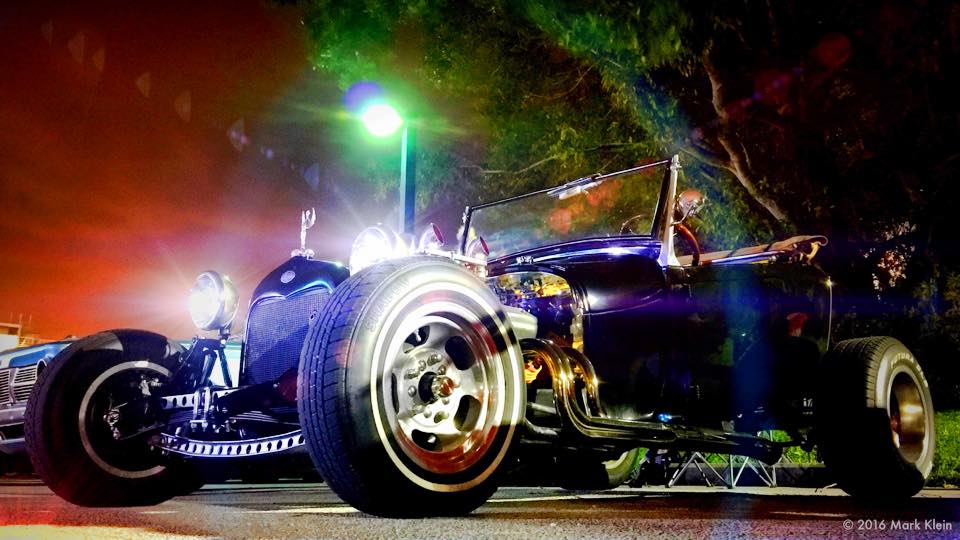

    image.png Sure is looking good!
    Just wish more hot rods like this were being built here on the H.A.M.B.!

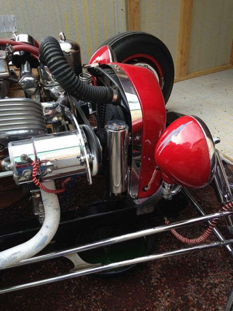

    I had the same problem Anders. I finally gave in and installed the dreaded electric fan and SS overflow. But when I broke the fan pulley and lost the belt it hit the fan and broke the mount. Still works though but when I get around to fixing it I plan to see if I to can find a pusher fan thin enough to fit between the radiator and grill.
    The overflow is another thing. Every time I stop my roadster it spits out a little coolant. It finally got low enough to overheat. Luckily it didn't hurt the engine. My thought about the SS overflow tank is it would be less noticeable as one of the other home made bottles. Actually now I think it looks pretty kool.
    My thought is if my roadster was built in the '50 or '60s somebody would have put these things on by now anyway.
    Oh sorry about the too low radiator. I actually think it is about an inch too high.

    The highist point in any cooling set up is were air/steam goes,that is why its the spot the filler cap is designed to be by engineers,an so steam can be relested with out the loss of water as well... A note about upper hose's with hump in them , if that spot is not filled with water do the fact that it can't be done. =Possible prob.that some just get away with by refilling to offten. Spitting after turning off,from over flow?;,can be too low psi cap{ I think 12lbs is min. needed on any hot rod,6 or 7 don't do the job}. If nothing big is wrong other then cap PSI, that's great,but there are a lot of hot rods that are built with "air pocket" upper hose set ups,most times you can see as a hump in upper hose with each end lower so it holds air/steam bubbles. If your working on cooling an wish a good looking low rad. ,than be sure your fill cap an over flow hose is at the top of all the cooling water. For low rad "T"s with V8s a handy design is this;https://www.speedwaymotors.com/Spee...Housing-Intake-Manifold-Filler-Neck,9013.html
    Home made designs like it have been made for lots of years in both hotrods an racecars. On flathead V8s,often have acted up heating from new hoses added that were too long an made a hump were there was not one before.

    Nice blue rod! If he can mount it there we can too. Looks like his 32 shell is mounted in the stock location on a 32 radiator. The chrome/SS band around the mounting screws looks about as wide as mine. I was kinda disappointed one inch SS is all I had back but I used it anyway. Later I saw some on rods with two or three inch and I was glad I used the one inch.
    Before I installed the overflow I would loose a little coolant overtime I stopped. Soon making it overheat. Don't seem to have that problem now. I do fill the radiator by taking off the upper hose at the engine. If you do this too remember to let the engine cool down before you loosen the top clamp. Ask me how I know. No don't, you already know.

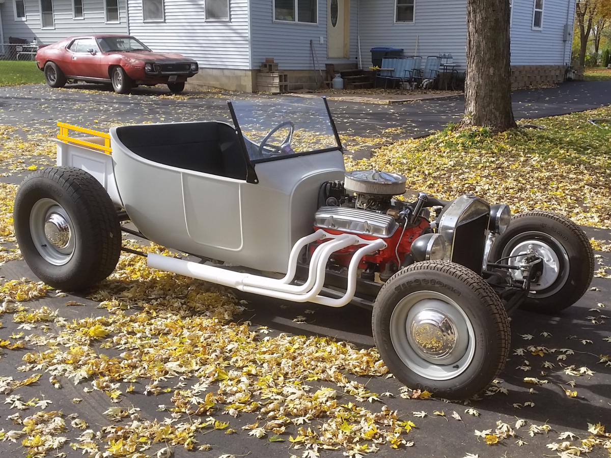

    I grabbed some free time today to work on the bucket. I had decided on '33-'36 Ford tail lights, so I made some mounts from some flat stock. I also made a mount for the license plate and license plate light.
    I'm having an issue with my tonneau cover. It's a perimeter of 3/4" wide by 1" tall wood strips on the sides and back with 1/2" plywood on top. The sides are just too chunky. I could lose 1-1/2" in width by doing something different.
    I'm considering angling up the back edge at the outsides.....?
    Opinions?
  25. tfeverfred
    Joined: Nov 11, 2006
    Posts: 15,788
    tfeverfred
    Have you considered vinyl or whatever covering a 1/2" plywood piece and held on by snaps? Hell, or maybe just vinyl and snaps?
