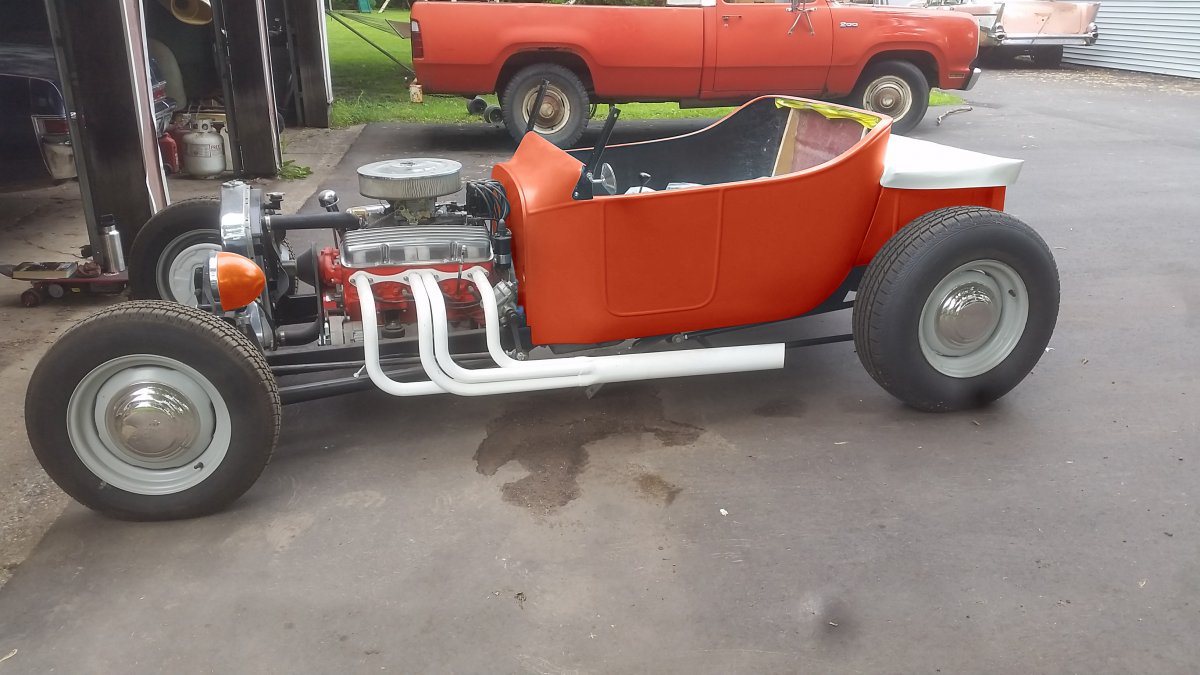

    Well, I went and looked at it. It's just over a mile away.
    Good HAMB friendly (early 60s) bones.
    Ford spindles with empty brakes (no cylinders or lines, just backing plates, hub and drum.:eek:
    5 leaf front spring (very stiff!) Both tires worn on inside, so expect kingpin work needed (see pic for right front).
    Was told it's a 283. Stamping looks like F291D, but hard to read.
    "F" stands for Flint, couldn't find the 291 part. Seems to be date related.
    The "D" suffix crosses over to a '58 or '60 283/Powerglide, and that's what is behind it. An older style PG.
    Short shaft to a drop out rear axle. as told it's Chevy too. The bolt pattern is larger than the front, so it seems to be correct. 5x4.5 VS 5x4.75... Looking online, appears to match 50s 10 bolt style.
    Holley list 4548-s carbs (one missing parts see pic) cross over to 450 CFM 4160 style on the Offy intake, with oil fill in front and road draft tube at the back. Missing the coil, didn't get dist. numbers. Finned valve covers with winged hold-downs as shown.
    Split bones in front, tucked nice and close to the frame, but will probably have bump steer.
    nicely done OLD upholstery, rotten and sagging of course.
    I would hazard a guess the steering box is VW van, judging from pics I looked at. I felt a casting number on it, but couldn't get under it enough to see it. I could have used a mirror!
    Body is not reinforced around the top, plywood angled toe board and floor, appears to be still solid. Dash has flat sections on each side, but is cut out in the middle for gauge clearance under the aluminum plate.
    Bolt on bed, tailgate and top (didn't open). Electric fuel pump (small square cheapie) under bed ahead of axle.
    Single master cylinder under floor, locked solid all the way up.
    E brake handle on outer driver's side floor, works and has spring tension. Did not pull hard.
    Gauges are all S&W except one, only one has wings. I'd have to research more for a better idea of vintage. Turn signals in front, dimmer switch on floor. I'd redo the entire wiring though, for safety and reliability.
    3 link rear with upper on p***enger side.
    Coil springs vertical in back, shocks outboard and shown in pics.
    Battery under p***enger side seat area, flasher, regulator, horn relay under driver's side. Nice 2" riser at front of seat, 'gl***ed in. Battery top sits only an inch or so above floor.
    Good looking frame. Has top snaps around the rear top edge of the body, but seller does not have the top frame.
    Radiator appears to be a local shop-built special, from before 1-800 stuff and has a trans cooler. Fibergl*** flex-fan is shot.
    The seller is looking for cash, not trades, so I've gotta move some stuff to be able to get this. Only a dream at this point unless I can move stuff quickly. I did sit in it Fred, and with thinner upholstery feel like I'd fit fairly well. The steering wheel is right above my knees, but unless I swap the whole thing out it would do.
    I'll attach pics from the ad so they don't disappear. Bag on front is just covering the plate holder. No plate (or bag) there when I saw it.
    Overall, this is probably exactly the kind of bucket Chip started this thread about. early to mid-60s stripped down basic bucket. It's even Orange with a Black interior and white homemade headers! Aside from the wheel/tire combo which is obviously later, it doesn't have Br***, slicks, Discs, Billet or extra add-ons. Heck, it has very little chrome (windshield parts, headlight rings, Ford script on bed). The rest is painted or aluminum.
    I hope Chip or someone else who might be able to ID the body/frame takes a look at the pics. It may be home built, but it was done pretty nicely. Wonder if it's an early kit.

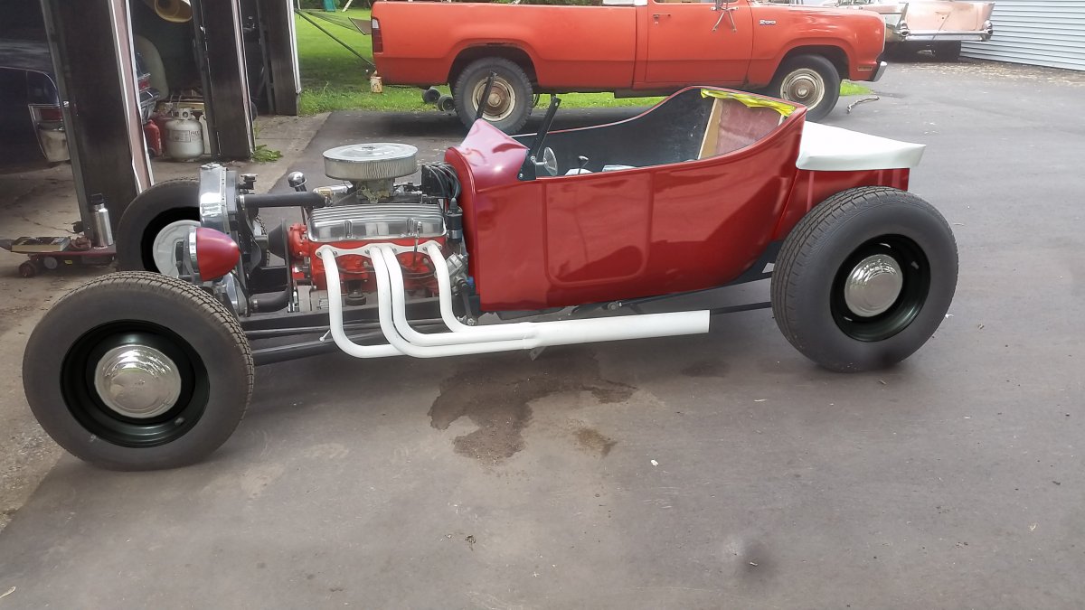

  30. themoose
    Joined: Dec 7, 2008
    Posts: 9,743
    themoose
    Here ya go....
