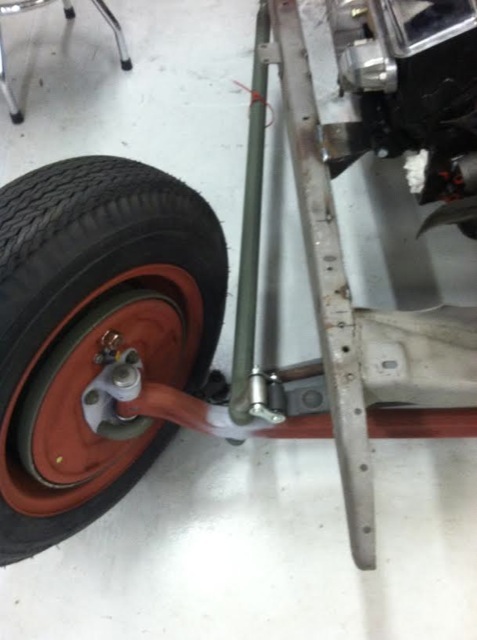

    @AndersF Can you tell me where these dropped tie rod ends came from?
    Edit: Never mind I just saw the link you posted to the Ford 1948-1964 Pickup tie rod ends.

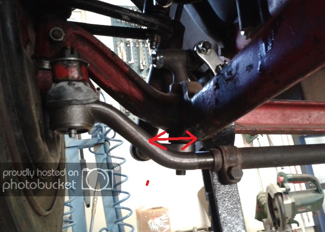

  20. RICH B
    Joined: Feb 7, 2007
    Posts: 5,984
    RICH B
    Maybe I'm missing something; but how does the drop tie rod end allow enough "swing" room between the steering arm and wishbone.
    When the steering is at full lock the eye on the steering arm is usually right close to the wishbone; from the picture it looks like the drop portion of the rod end would run into the wishbone and limit steering range.
    Compare the dropped tie rod picture with the the of steering of dropped steering arm at full lock.

    I've never used this set up before, but I have seen people use something similar. You may not be able to mount split wishbones on the frame rails, or maybe you just lose some turning radius.

    From memory they would work to clear the spring and hangers on a spring behind the axle setup, not to clear the radius rods and would still need the steering arms to be dropped. JW

    Just fooling around with some a friend has :); when the "latest and greatest trick part" didn't work on his '33 with split '40 bones, due to the travel; compared the travel on my car with minimum split to the bones, still same stop to stop concern. Just seems easier to heat and bend the stock steering arms; or if not in your skill range; get some bolt-on arms. Figure the best application for these ends would be the F series trucks they are intended for.

  26. AndersF
    Joined: Feb 16, 2013
    Posts: 952
    AndersF
    The pic with the steeringarm is on a car that come to sweden.
    We are not allowed to bend steeringarms here so this was used instead .
  27. RICH B
    Joined: Feb 7, 2007
    Posts: 5,984
    RICH B
    Thanks for the update and further information.
    Interesting; maybe it is just the picture itself that does not show the clearances well and the tie rod does have enough range of motion.
    Maybe it was the set-up we had, roundback spindles on a 46" SuperBell and split '40 bones on a '33 that was incompatible.
    Question on that picture tho; if you can't bend steering arms over there, how do you get them to even swing fully on an original axle that has been dropped. Wonder how the axle can be heated and dropped but not the arms. Not trying for drama; just curious.
  28. AndersF
    Posts: 952
    AndersF
    I dont know why its ok to drop a axle but not a steeringarm.
    On my build its the steeringarm that limits how much i can turn my wheels.
    But it seems to be enough for decent steering radius.
