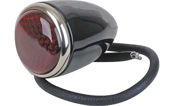

    Hey Fred, I used Macs. Some guys have said they are terrible, but I had no problem, I ordered a pair of lights and had them in no time at all.
    I just ordered the complete light ***embly and then swapped the lenses and bulb sockets into my painted housings.
    So, now I have a pair of Led equipped lights for swap meet material.
    The tail lights from Macs are pretty nice quality, I ordered 2 without the licence plate light, they are also available with the plate lens.

    Well, my lights from SoCal are already coming. I'll check them out once installed and if there's a problem with brightness, I'll think of something. Today, I ordered my steering column drop and firewall column mount. Things are moving along nicely!

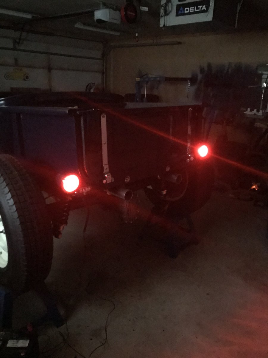

    Well.... my tail lights showed up today. They look good and are bigger than I thought. Only one small problem. They didn't come with any hardware. But a quick trip to the hardware store took care of that. My original plan was to attach the lights to the rear of the frame, but the upper rear shock mount is in the way. But since my tail section is shorter than most T frames, I was going to make an extending bracket to support the gas tank. So, they'll attach to that. All in all... I'm satisfied.

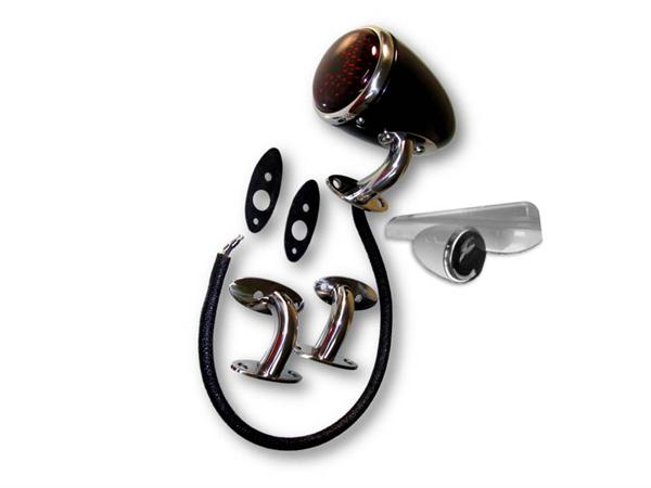

    I bought the mounting brackets that So cal sells for them Fred, they’re nice in that the wires are run through them.

    That's what I bought. Two lights and two stands. I was still surprised no hardware was included to attach the light to the stands or the stands to the car.

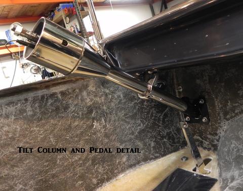

    The CCR firewall mount for the steering column came today along with the column drop. Both are good pieces. The column mount is powder coated. Here's a pic from CCR's website.

    I checked my setup and it looks like I'll be fine. Plenty of room for the steering wheel without having to move the column or box over.

    Steering column and mounts. Might be getting a new camera soon.
