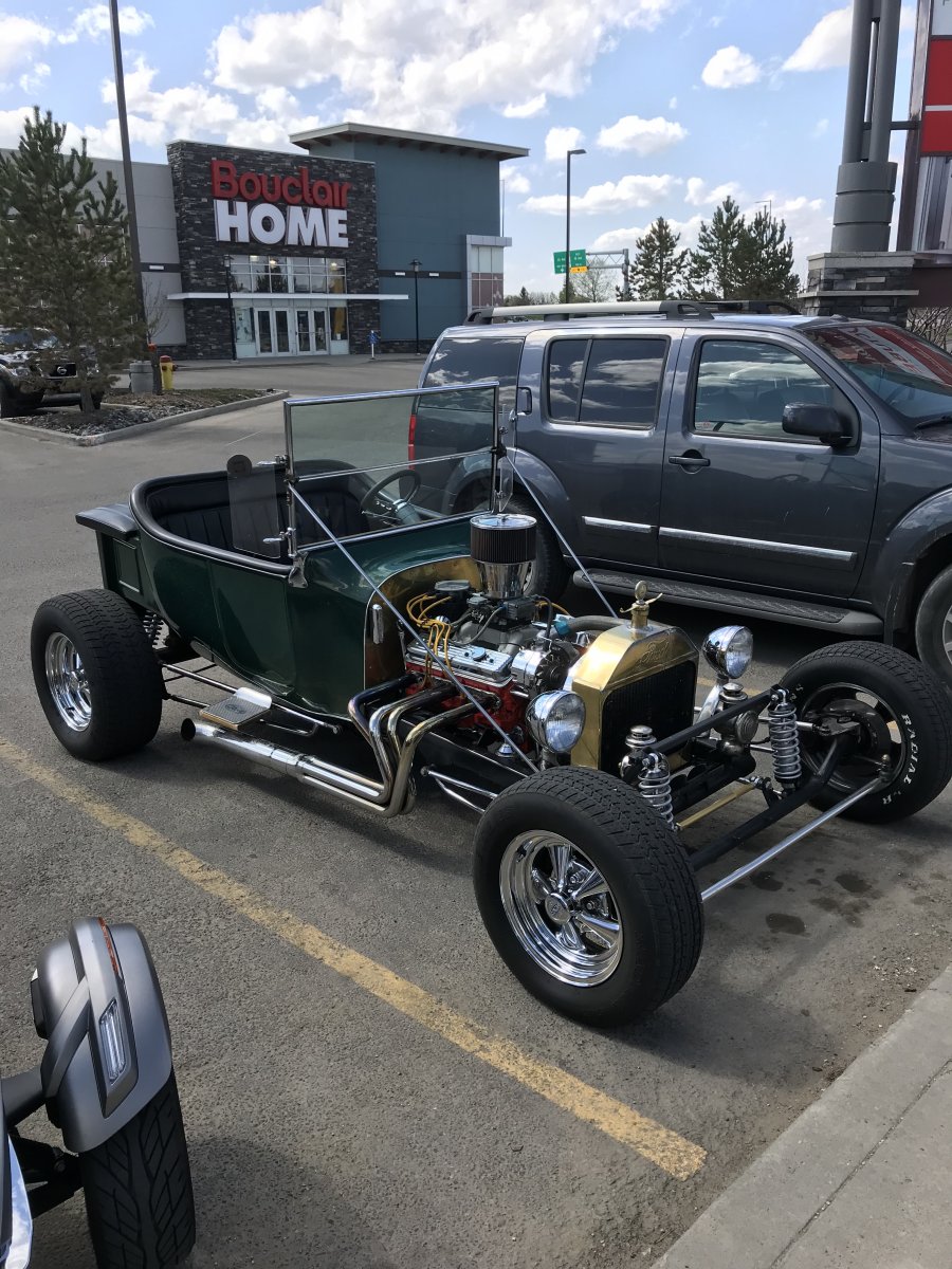

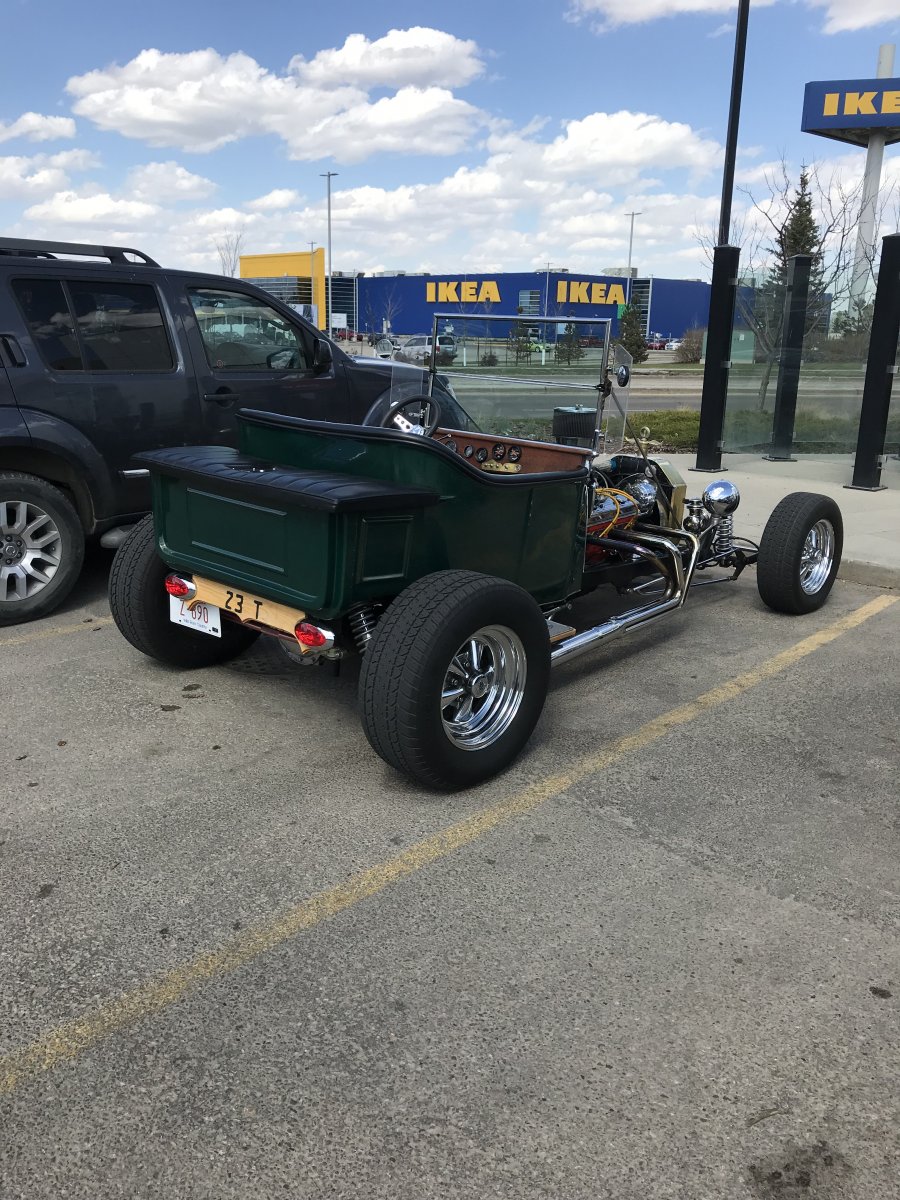

    Wow I must really be Hot rod deprived this spring :D
    I saw this driving down the road here this afternoon while I was doing a little parts chasing.
    I actually didn’t hate it :D
    Looked like the guy driving it was having fun.
    206A92A0-08D5-4C8B-9B21-67C7F2D83F18.jpeg 8A4A3603-6A18-40E6-AB58-15881E5AE695.jpeg
  9. Blue One
    Joined: Feb 6, 2010
    Posts: 11,512
    Blue One
    from Alberta
    Besides that the ugly stuff on it is minimal.
    It’s got a decent angle to the steering wheel and column too instead of the usual school bus wheel position :eek::D

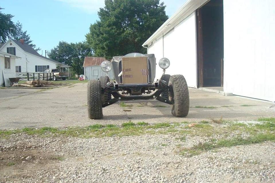

  10. 26 T Ford RPU
    Joined: Jun 9, 2012
    Posts: 12,592
    26 T Ford RPU
    It does have a lot of promise but I can't work out why the tie rod had to go out front ! JW

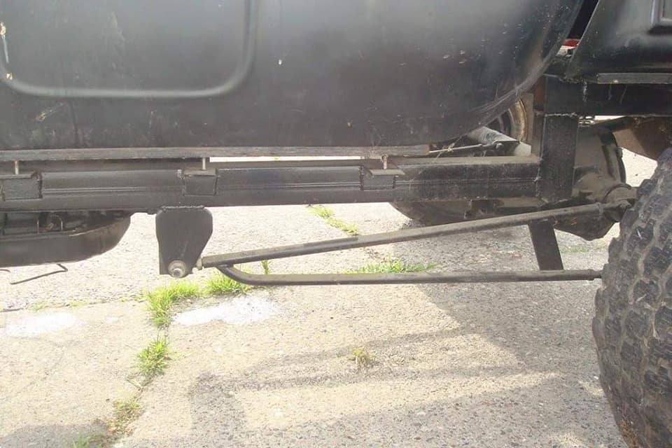

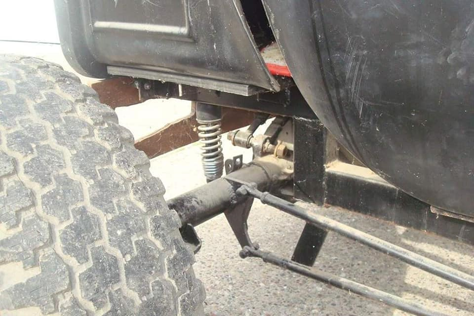

  12. RodStRace
    Joined: Dec 7, 2007
    Posts: 8,840
    RodStRace
    Total Performance (now Speedway) built them this way for many years and was the most prolific kit builder.
    A pic of the old kit ch***is
    Speedway now sells Vega cross steer on most all kits. The Tribute still has traditional steering but the tie rod is behind for proper Ackermann.
    https://en.wikipedia.org/wiki/Ackermann_steering_geometry
    https://www.speedwaymotors.com/Speedway-Tribute-T-Bucket-Frame-Kit,46195.html
    I'd guess the big reason is to avoid sneaking the tie rod through the space behind the axle which may have;
    Frame
    cross spring
    hairpins/four link/radius rods
    steering linkage (for traditional steer)
    panhard rod (cross steer)
    Radiator
    shock or shock mount
    light mounts
    In this case, it's got a panhard rod, coil springs (the springs don't locate the axle side-to-side, so the rod is needed) Spring/shock mount, and cowl lights taking up valuable space for the tie rod.
  13. 26 T Ford RPU
    Joined: Jun 9, 2012
    Posts: 12,592
    26 T Ford RPU
    There is nothing in the way behind that axle and the ch***is you showed above has correct Ackerman where the green T has incorrect Ackerman. JW
    RodStRace and loudbang like this.
  14. RodStRace
    Joined: Dec 7, 2007
    Posts: 8,840
    RodStRace
    26 T, I agree that
    1. there is room behind the axle and under the frame (If the panhard frame mount isn't too deep)
    2. it has incorrect ackermann (tie rod ends ahead of axle are narrower than kingpins)
    3. The TP ch***is has tie rod wider than kingpins (correct ackermann).
    I still prefer having the tie rod behind the axle. Many home builders have made a bunch of changes to components and ride height and were not able/willing to fabricate or purchase the parts needed to tuck the tie rod behind. I know the TP design shown does make it work, but it looks like the 'wrong' ones and detracts both in being right out there in your face and resembling the poor attempts. Just my own prejudiced opinion. The reply was all to kind of explain why it was out there, to go along with the Monkey See, comment.
    I'd personally strip all that stuff off the front and go with either a regular leaf spring (cheaper, easier) or get a good builder to fab up a Dan woods style front suspension. BUT, it's not my car, and it's built, running and driving while mine is not, so I can't say $#!*....

  15. 26 T Ford RPU
    Joined: Jun 9, 2012
    Posts: 12,592
    26 T Ford RPU
    Just reinforcing my original comment. i agree with what you say above.:) JW

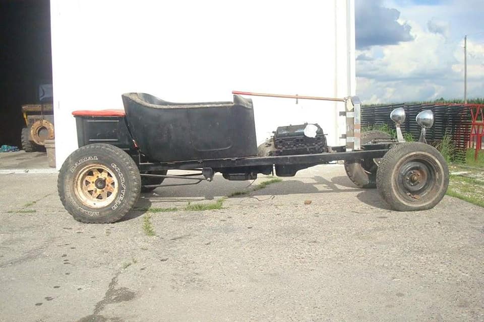

  23. justabeater37
    Joined: Jan 1, 2009
    Posts: 1,827
    justabeater37
    This is for sale in Missouri. I don't even know where to start...Knock off the ugly or the unsafe. Scary. rat1.jpg rat2.jpg rat3.png rat4.png raty5.png

    At first glance it reminds me of a Snail !!. Take the good bits and make a whole new project out of it.
    The body mounts and some other engineering (for the want of a better term) bits look like how my RPU was when i got it. :eek: JW

    Justa, I look at the pics and contemplate whether I'd reuse each part or replace.
    I could see reusing the headlights and stands... maybe the radiator. Really nothing there as far as suspension, frame or body.
    The Green one really fits the nice 60s vibe, but the Red one looks well-built and could be back-dated with minor changes, too. You could do a lot with the 6K savings on the side yard one, provided it's bones are decent. All 3 seem to have decent seating and steering angles. Remove/replace some questionable parts and enjoy!
    ****, as far as the "CA plates but has not been registered since 2002 - there are some DMV fees waiting for the new owner." CA requires people to register as non-operational or back fees would be required, plus penalties. However, after a few years (7?) it would 'drop off' the registration and you would be able to get most or all fees waived if you were to re-register in California, depending on the clerk. If you were to buy and register in another state, I doubt there would be any back fees. In your case, NE really isn't going to go through the effort to determine CA fees, collect them and then send them off to CA. I've even heard of people 'selling' something that is 3-5 years out across state lines, then 'bringing' it back to avoid fees. Just like the exotics and big dollar RVs that are often registered in Montana (cheap) to avoid state fees. Of course, you have to know the laws and loopholes to avoid doing something illegal!
  26. dana barlow
    Joined: May 30, 2006
    Posts: 5,435
    dana barlow
    from Miami Fla.
    Last sat,looks scary for too days roads!. Neat an clean yellow T,but ackerman is backward,has round tread MC tires on front{maybe less then 1in. of rubber to steer an stop with,an both front tires will fight each other in turn also} an side steer rod has a bit too much bumpsteer do too pitman arm/steering box placemint{ if nothing other then box/arm was wrong/could get away with it.. But with other probs its all scary combo combined. Control is bad at best! That is part of it,is ugly to me,now. Going back to a time in the p*** when all the cars on the road only had drums brakes,it was not so bad to be that messed up engineering wise! Still stance is good !

  28. 26 T Ford RPU
    Joined: Jun 9, 2012
    Posts: 12,592
    26 T Ford RPU
    Lots of room to bend those arms out and even around the discs to at least gain some kind of correct Ackerann..........too hard why try or just don't understand it, yet they can build a complete car .:( JW
