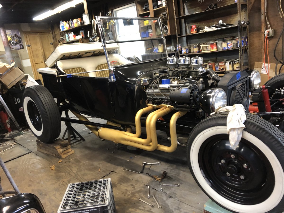

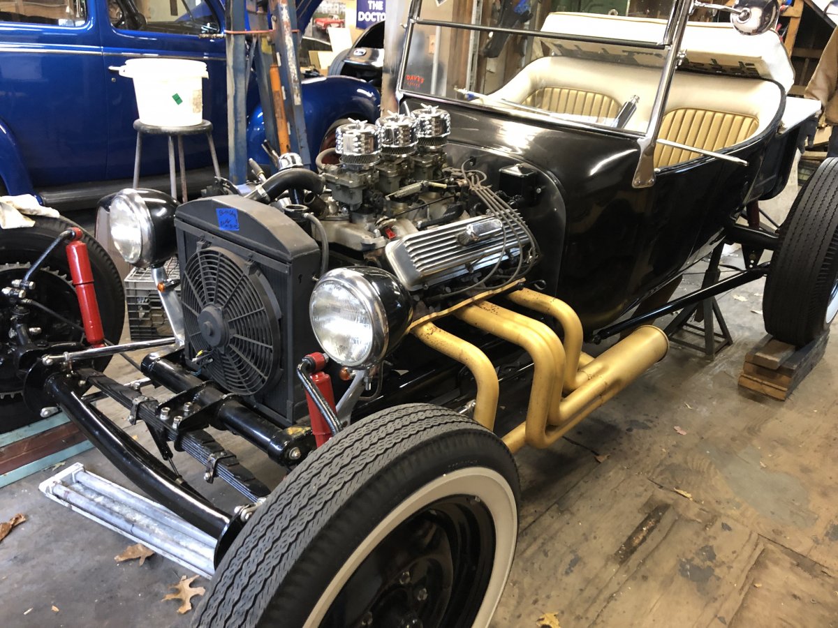

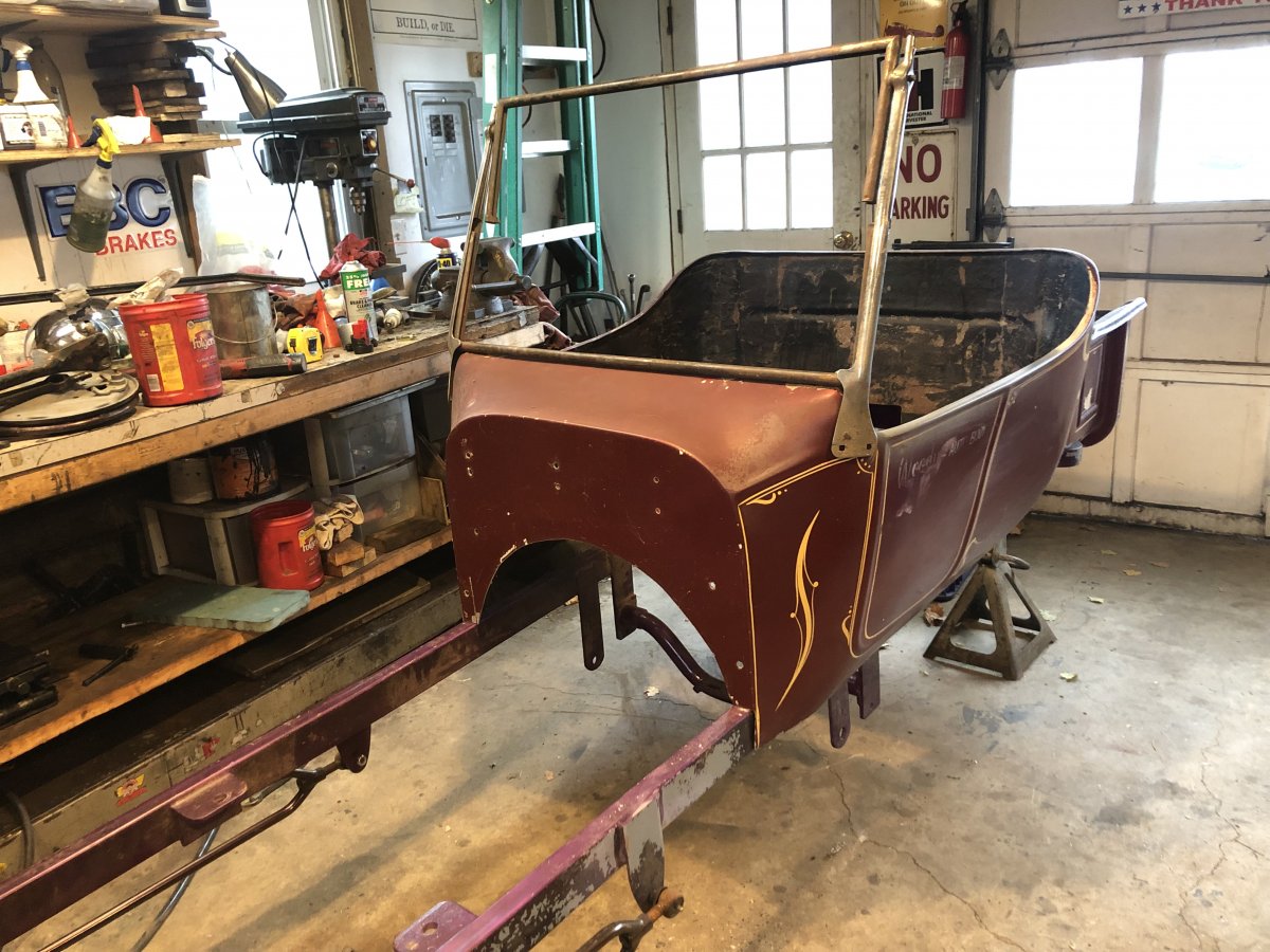

    6CFAE528-0B54-44FF-AB33-9456724ADA8A.jpeg Visited a t bucket buddy of mine today and snapped a couple picture of his car. Also got hooked up with a windshield frame and stancions.

    Yeah, I'm diggin' the 4 link front and maybe rear (kind of goofy back there), although I wonder about the frame brackets. I have not seen that before that I can recall.
    The forward tie rod is typical TP/Speedway, but the (almost) vertical steering box with the upward linkage is not.
    There is a lot of good stuff there, but it's all weathered/rusty/beat. The dual quad (Carter) SBF is interesting, and I wonder if those front brakes inside the MC tires are Airheart?
    http://www.airheart-brakes.com/150x.html
    That's a 70s Pinto/Mustang shifter, so it was probably built after that, judging from this and other components (Vega tail lights, radio in an overhead console, Appliance rear wires, the big/wide rears and the motorcycle fronts, padded top with pattern sewn in). If the chrome wasn't so heavily pitted (past the point of sand and paint), I'd be dreaming too!
    I bet if Chip would see this he would be able to point out more stuff and probably determine possible builder/time frame.
    Gotta get rid of that rear pan! Looks like a full diaper!

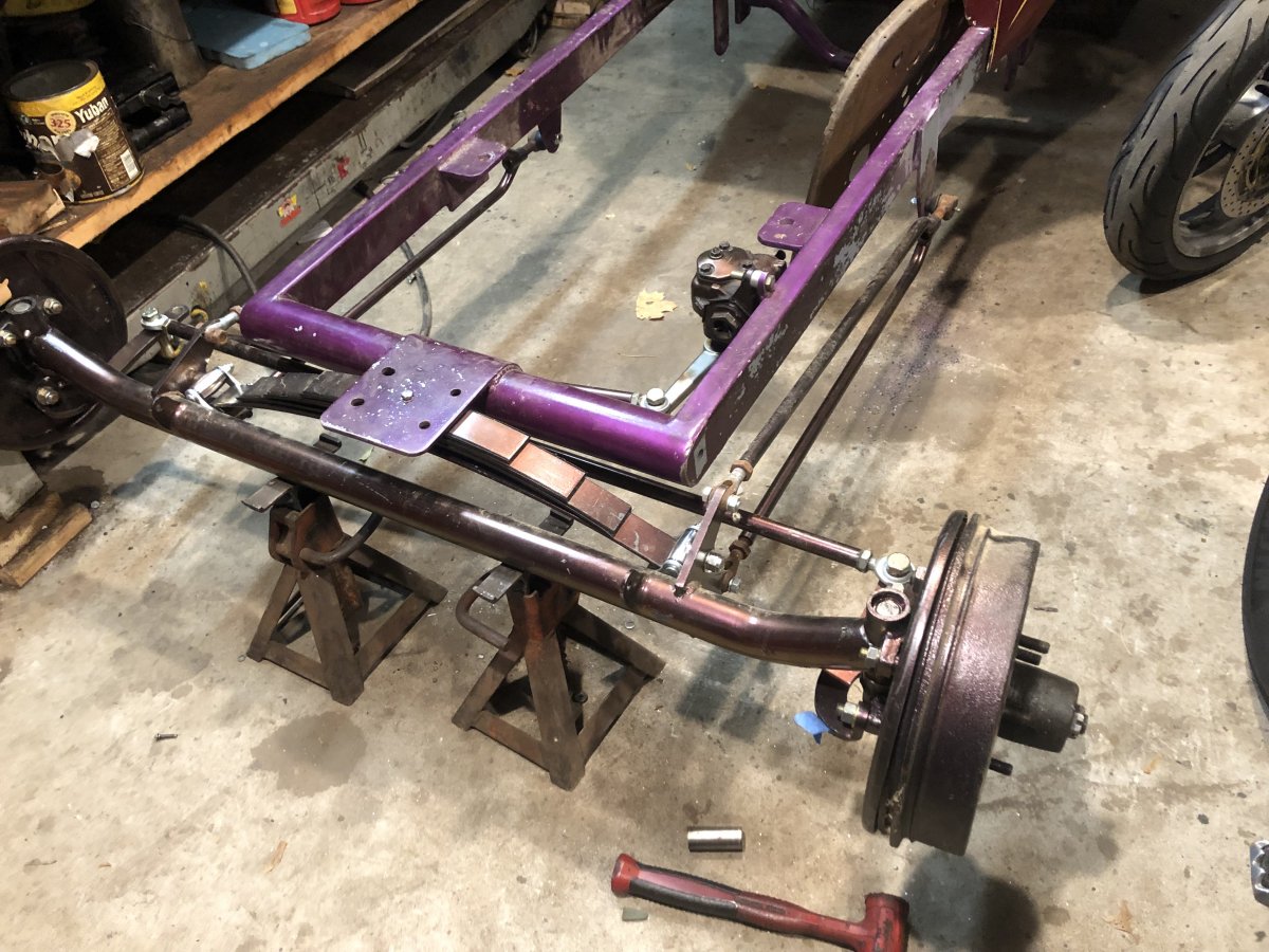

    FEF93356-314C-4C65-B671-AD40A5F19349.jpeg Got the steering and the stock 54 Chevy drum brakes figured out tonight, it was a little too easy in fact.

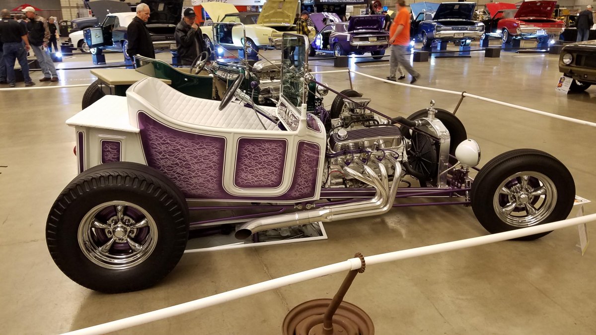

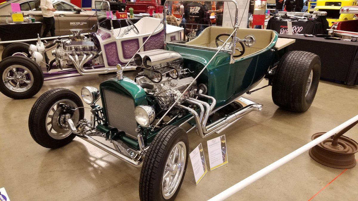

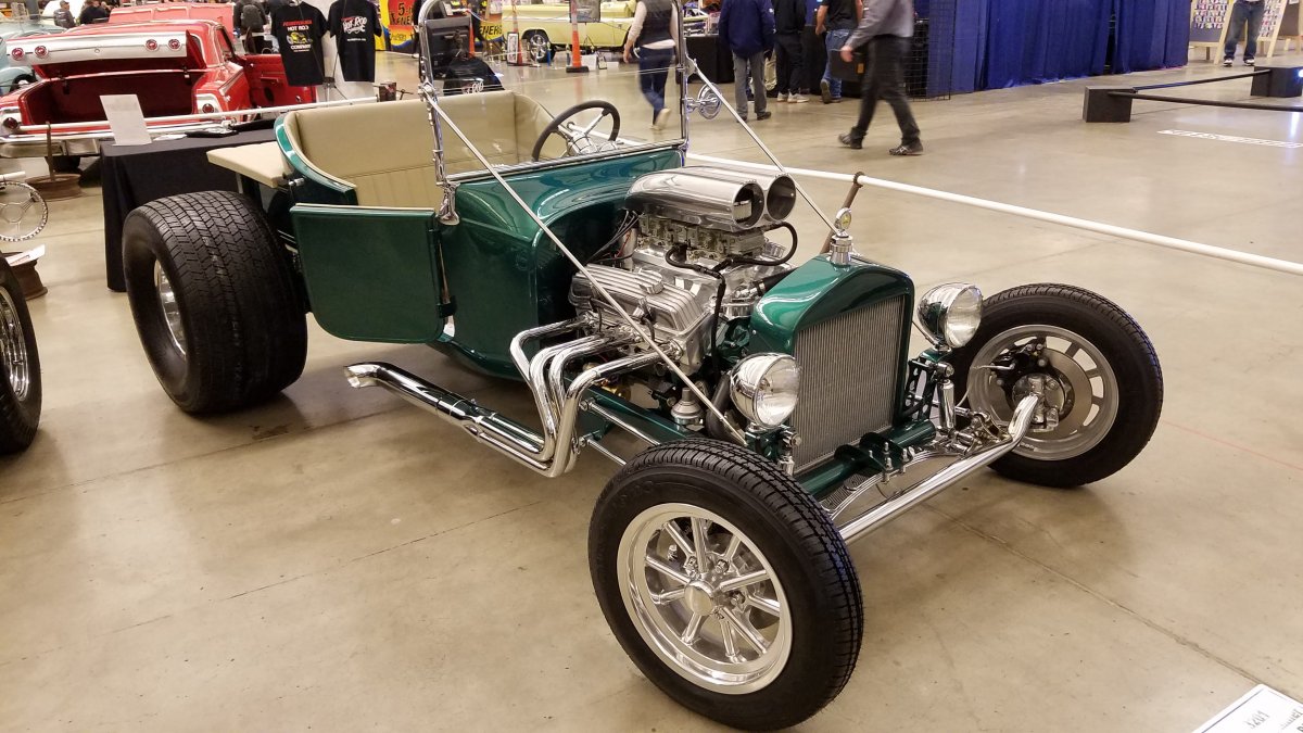

    Went to the Pittsburgh World of Wheels on Friday. Normally not a great place to see well done traditional hot rods but a few manage to sneak in every year. This pair of T buckets was not half bad. I'm sure that there are some bits to complain about but they were better than the usual fare.
    20200124_174555.jpg 20200124_174657.jpg 20200124_174715.jpg 20200124_174729.jpg 20200124_174603.jpg 20200124_174620.jpg
