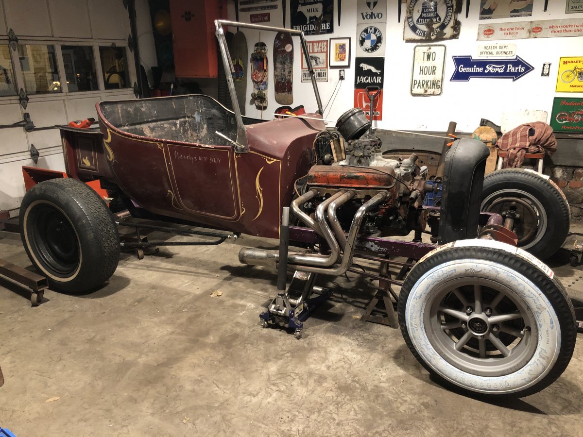

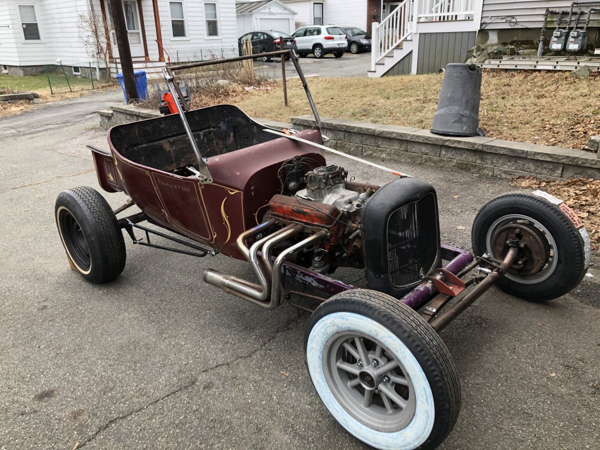

    Here's where I'm at. I'm about to cut the front crossmember out of my T Bucket project to install a model a unit. I'm hoping this will tighten up the wheel base a little more and make it look less stretched out. I've got bigger tires on order for the rear right now so try to ignore that, but what do you guys think, is it worth the effort?
    I know it's tough to tell from the pictured but the top is how it's set up now and the bottom is where the front axle would be if I change it (approximately).

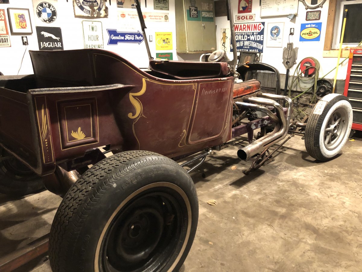

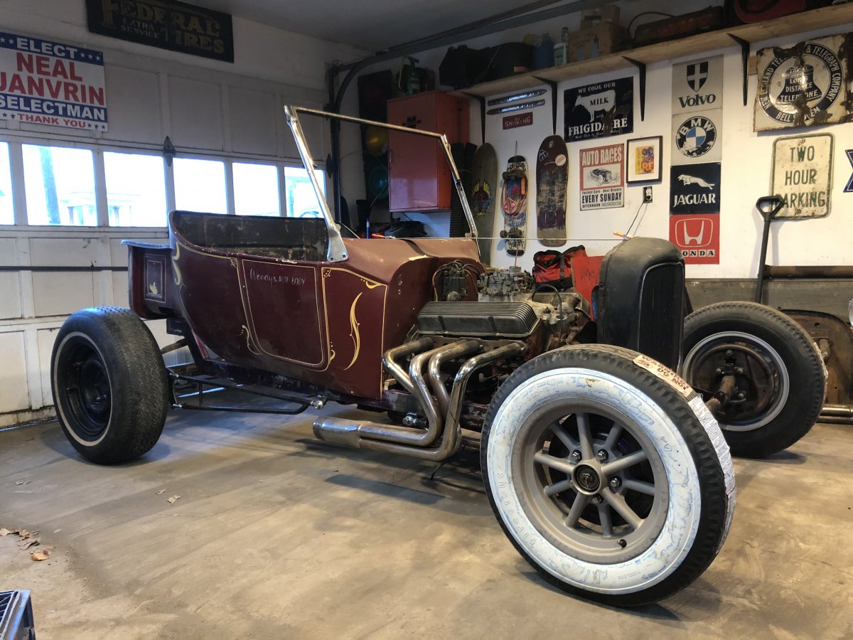

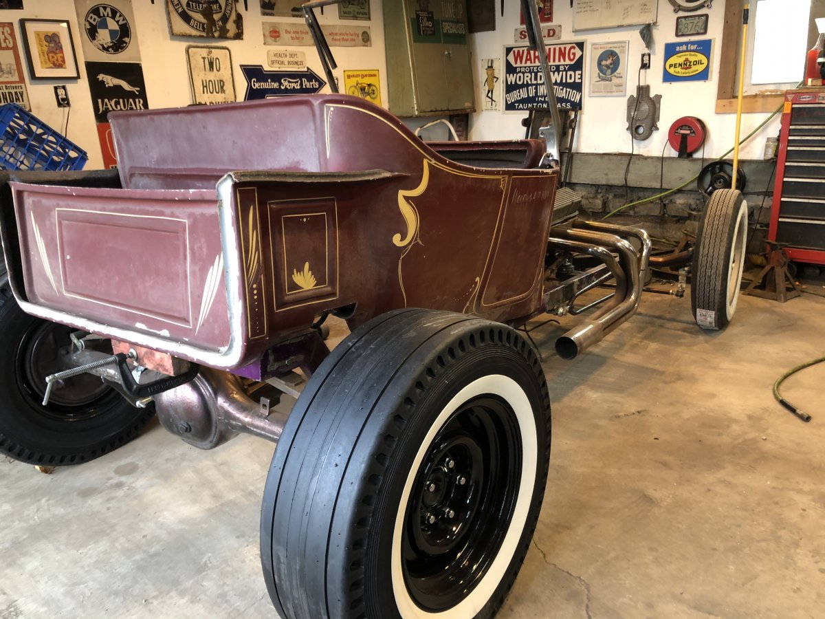

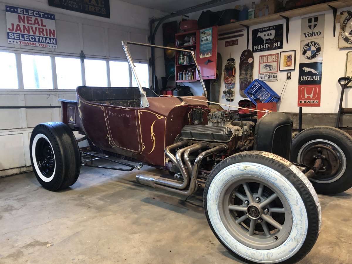

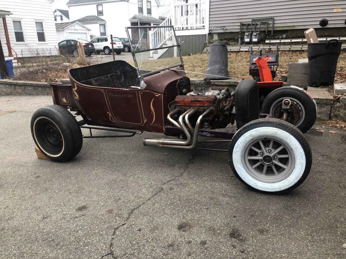

    Here's a few more. First two are as it sits now and the second two are about where it would be if I move it. Wheel base would go from about 97" to 93".

    Gonzo, the length is fine as is. Tucked looks cool, but also ends up raising the car, which isnt as cool

    May be the photo but head on pic looks like steering Ackermann way off. Should google it then can do quick measure on your car

    Put the distributor close to the firewall and the radiator close to the fan; if any excess length, shorten the rails. Then put the spring on top the axle and build a new Z'd perch to get it back lower. Lot easier to change up stuff at this stage than later.

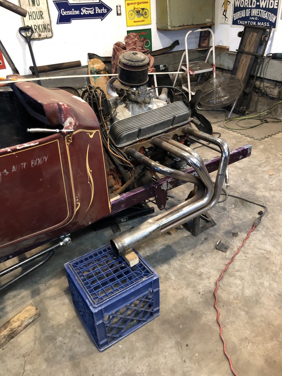

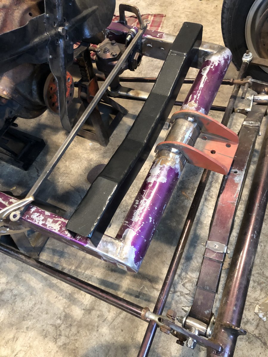

    E33CCD7A-A641-4C30-BE39-9A70883B9E59.jpeg C849616C-49EA-4A68-926B-2517D1FDD190.jpeg
    no turning back now.

    Looks very good!! Are keeping the tube axle? JW

    I am. If I was starting from scratch I probably would've just put a dropped axle in it but now that I've changed the hairpin mounts and crossmember to work with what I've got I think I'll keep it. This is supposed to be a low buck build and I'm trying to use as much stuff off of the project I bought as I can to keep the cost down.

    I do like the look of them but with split bones and hairpins they turn into a big anti sway bar and with the same on the rear things become very rigid. Gary (Steel Rebel RIP) had the same setup on his T and said he had no issues, that i cant see but it may be OK. JW

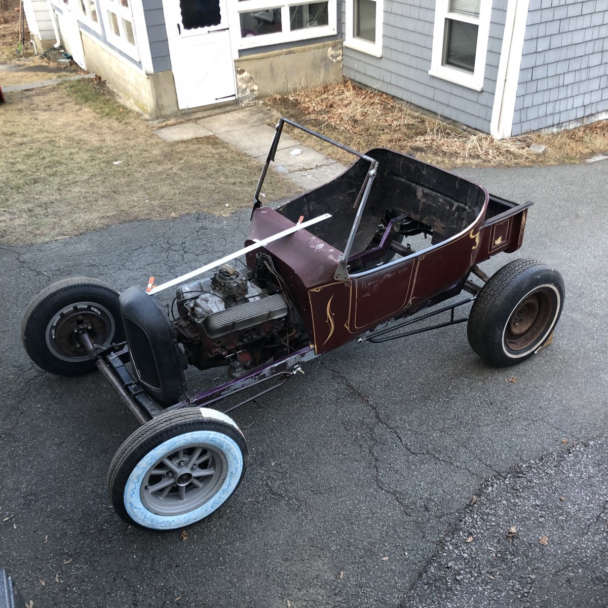

    gonzo t.jpeg Since this thread started with pointers about getting these cars looking 'right', may I point out something that IMHO could be better?
    The radiator top should flow with the front of the cowl, not the back where the windshield sits.
    Again, this is an observation of an armchair q'back...
    You may simply be holding the rad shell in place and will move it down later, but just wanted to comment on that visual line...

    You're 100% right on that. I will be moving it down in the future. Right now it's just propped up on the crossmember, I'm toying with the idea of t******* some material off the bottom (which is an old poorly done repair anyways) and moving it forward as well as down.

    New rear tires installed.
