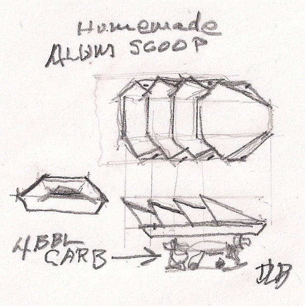

  17. dana barlow
    Joined: May 30, 2006
    Posts: 5,436
    dana barlow
    from Miami Fla.
    Louver kind of design idea 4 aircleaner,could be any size an any # of louvers or shapes,just for fun.:D:cool:
