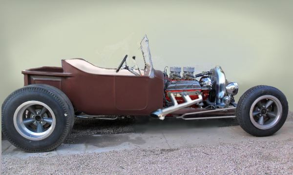

    I was bored and thought I'd take a quick stab at de-uglifying it. 28/29 chrome grill, added a carb, zoomie headers, chopped windshield & shifter and white interior (sort of).

  3. Ralph
    Joined: Jan 8, 2004
    Posts: 295
    Ralph
    Sinister, much better already! could you take a good six inches out of the steering column while you're at it? Personally, I'd like a painted grill shell, but I'm not the guy with the photoshop skills, or the car!

  4. Sinister
    Joined: Jan 19, 2004
    Posts: 710
    Sinister
    from Oregon
    Shortening the column was something I forgot to do.

  6. need louvers ?

    Hey Bob,
    Just got back in. I had to put a starter in a '40 Chevy for a client so he could make his lowrider show tonight. ALWAYS a ball doin grungy mechanical stuff on a 110 degree day! Whoopie!
    Just as an aside real quick, For the next 4-6 weeks, if it seems like I'm doing more talking than working, don't give up on me please. I know to most of you out there, you wait with anticipation for three months of summer to get out and do stuff and work on your cars.... I live in Phoenix. Summer means you work from about 5 am to about noon if you can stand it THAT long, and retreat into the house for the REALLY hot part of the day. As an example, I walked out to the shop at 10:00pm to grab something last night, and it had cooled down to 108 by that time. COOLED DOWN! At noon yesterday my shop was 126 or so.... So bear with me and slow progress until the end of September when our years dose of hell ends.
    Okay Bob, back to what you asked for. I didn't copy the last two complete pages of fine print text. If you really want to read the whole article, let me know and I will be happy to do so. That'll give me time to round up the earlier feature on this car from about '61 as well. Click on the pictures a couple of times and it'll get big enough to read.

    That looks awesome!

    DUDE! Thank you! Very much where I'm going with this, with one exception. The grill shell... Historically, '28-'29 shells really weren't used much on anything BUT '28s or '29s. There were a couple of Comp cars I can think of the used them, but that was it. Please don't take offense, but the use of that shell on other cars started showing up about the time Deuce grill shells went on the gold standard at the beginning of the rat rod era, about 15 years ago. They are now accepted as "traditional" even though there is really little historic precedent. I'll be sticking with the "T" shell or Deuce shell if I can find one.
    But Damn! otherwise you've nailed it! I've never had a screen saver on a computer, but that will be it if I can figure out how to do it!!!
    Hey Ralph, it does look *****in' with the shorter column, but unfortunately, it'll probably have to stay long. That's a major part of the comfort level on these cars, and when your 6'1" and mostly arms and legs, you really need the length to be able to do mundane stuff like, oh, say hit the brake pedal and stuff! If you read through a bit and see all the taller guys saying "I wish I could fit in a 'bucket, this is one of the major things they are talking about. I wish it could be shorter, and if the proposed seat changes work as planned, I'll take off what I can.

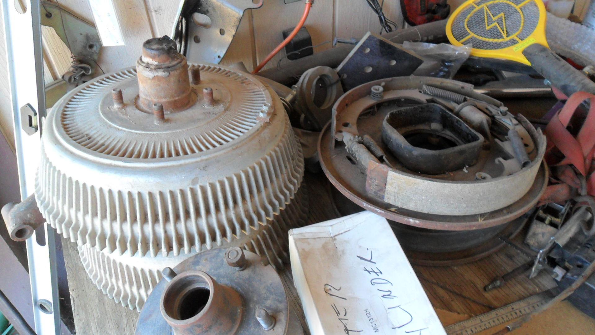

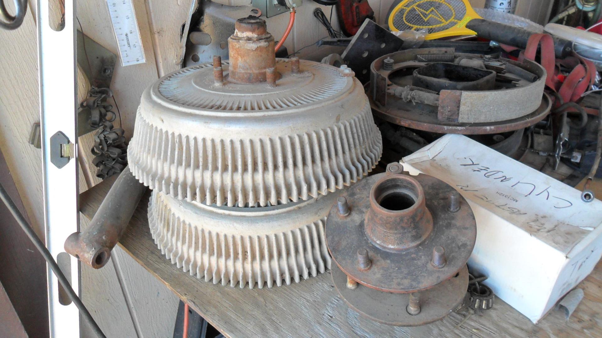

    I have a couple little updates for ya. First is, Judy was out in the shop with me one day last week and saw a pair of 90 fin aluminum brake drums hanging on the wall slated for my roadster pickup. "Must use on T-Bucket!" was her only exclamation! I explained how they were already earmarked for another car, and that a fall off a shelf had chipped a couple of fins, and it was gonna be some work to find the right backing plates.... Well, my '40 Chev client from this morning is Roy, the previous owner of this car, and he had a complete set of 90 fin drums, hubs and 12" f-150 backing plates spare that I didn't realize he had. Moments after finding these at his place, he kind of sheepishly asked if I intended to do anything with the freshly rebuilt brakes that are on the bucket now, and offered me the whole kit and caboodle in trade for the brakes that are on it now, back! Hell yes, says I! JOHN EVANS from here on the board will be receiving the hubs, drums and backing plates to change the bolt pattern and mate the drums and hubs later this week. So, my pretty wheels will now have pretty drums too!!! Excited? Ya, just a bit!!!

    If one of the drums is out of spec, call Brad King. He has a spare 90 fin he isn't going to use. He grabbed a pair out of the wrecking yard a few years ago, and when he pulled the second drum off, he realized that one drum was a 45-fin and the other was a 90-fin! He sold the 45-fin a few months ago at the LARS swap meet.

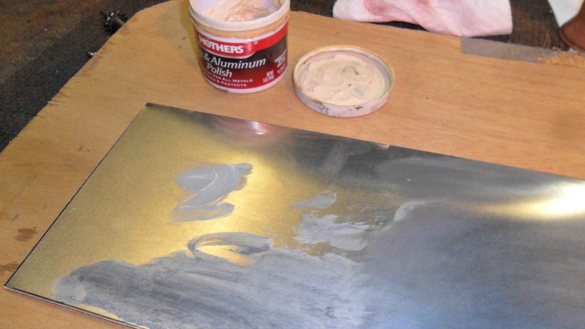

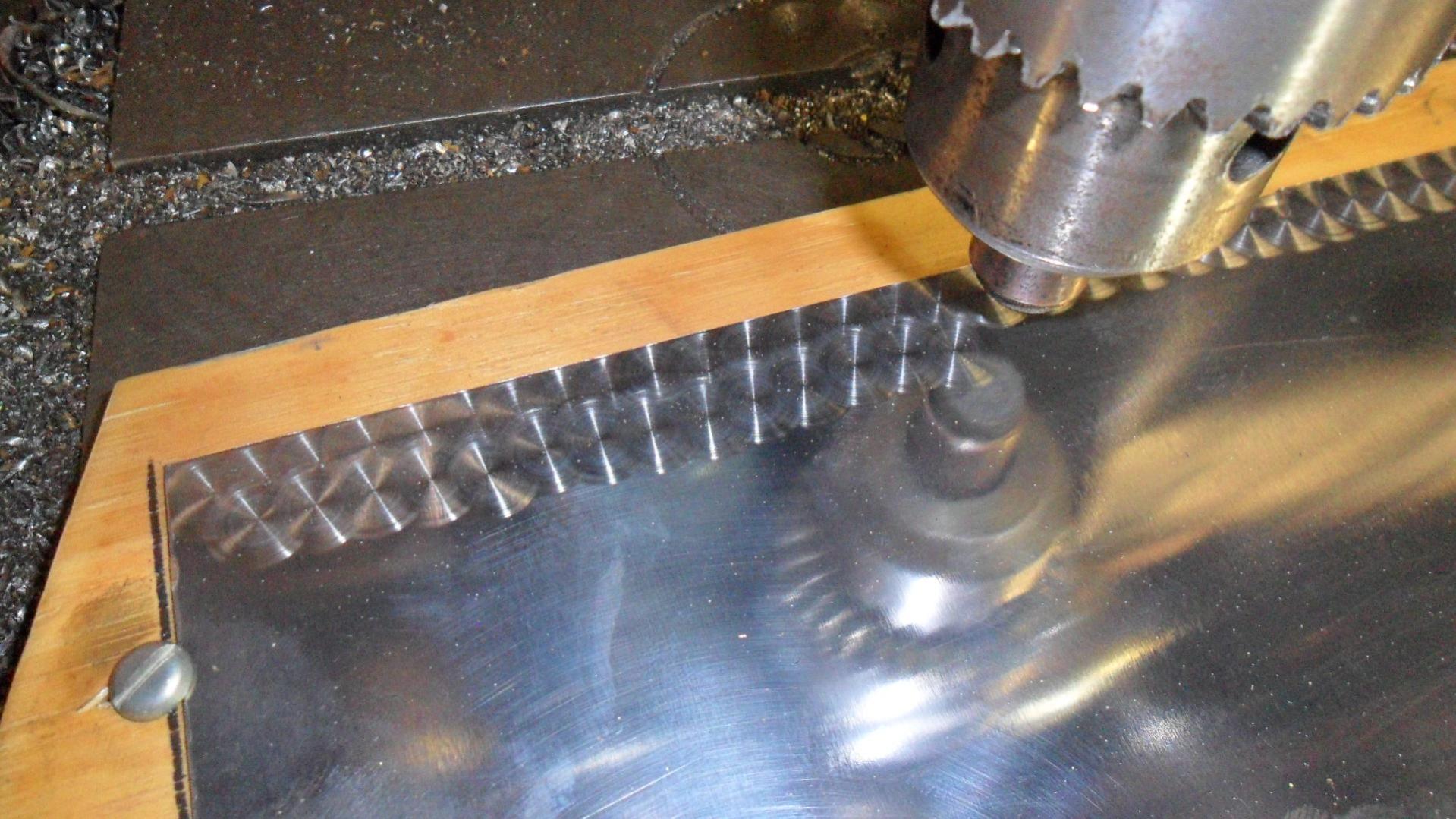

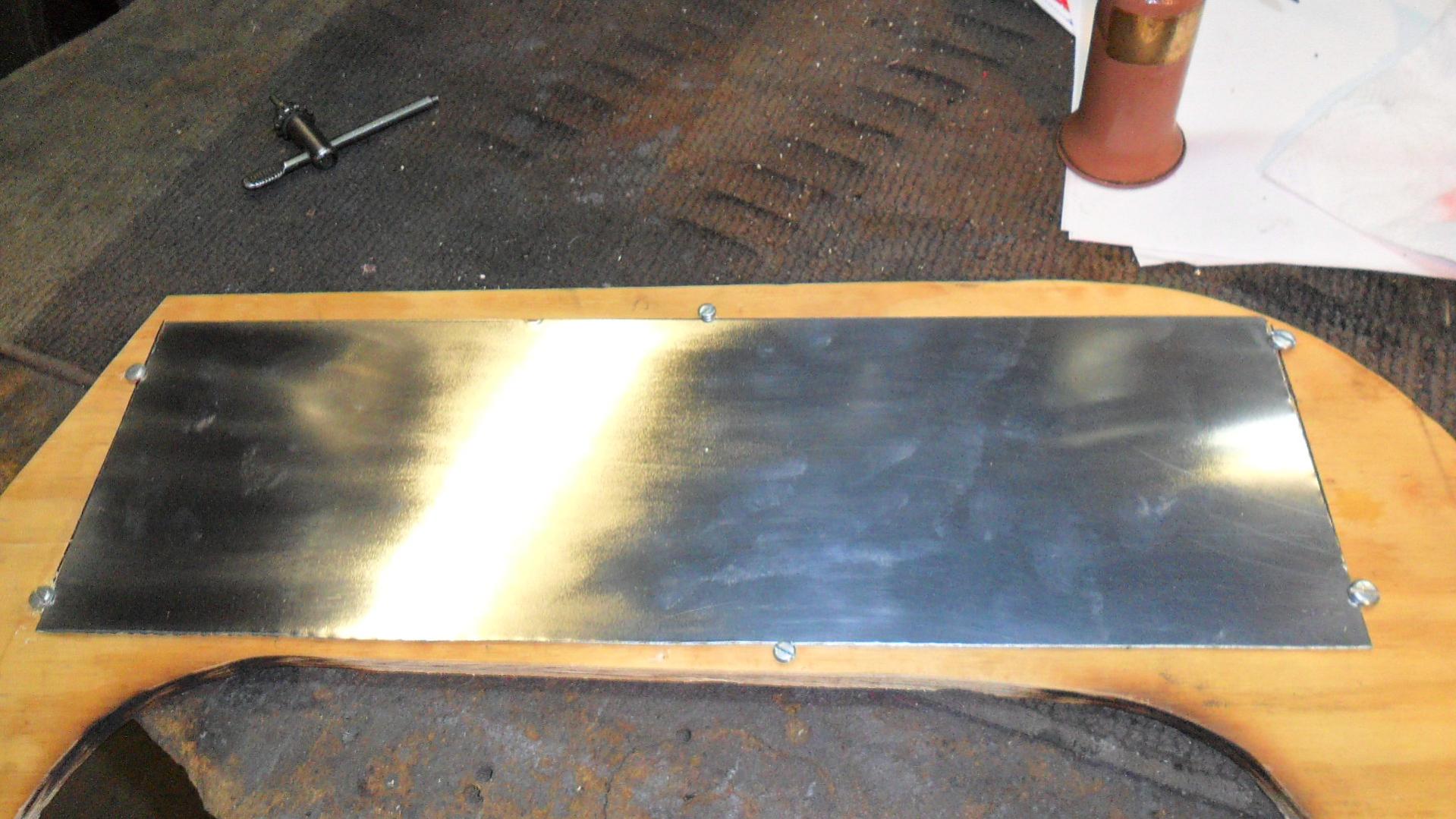

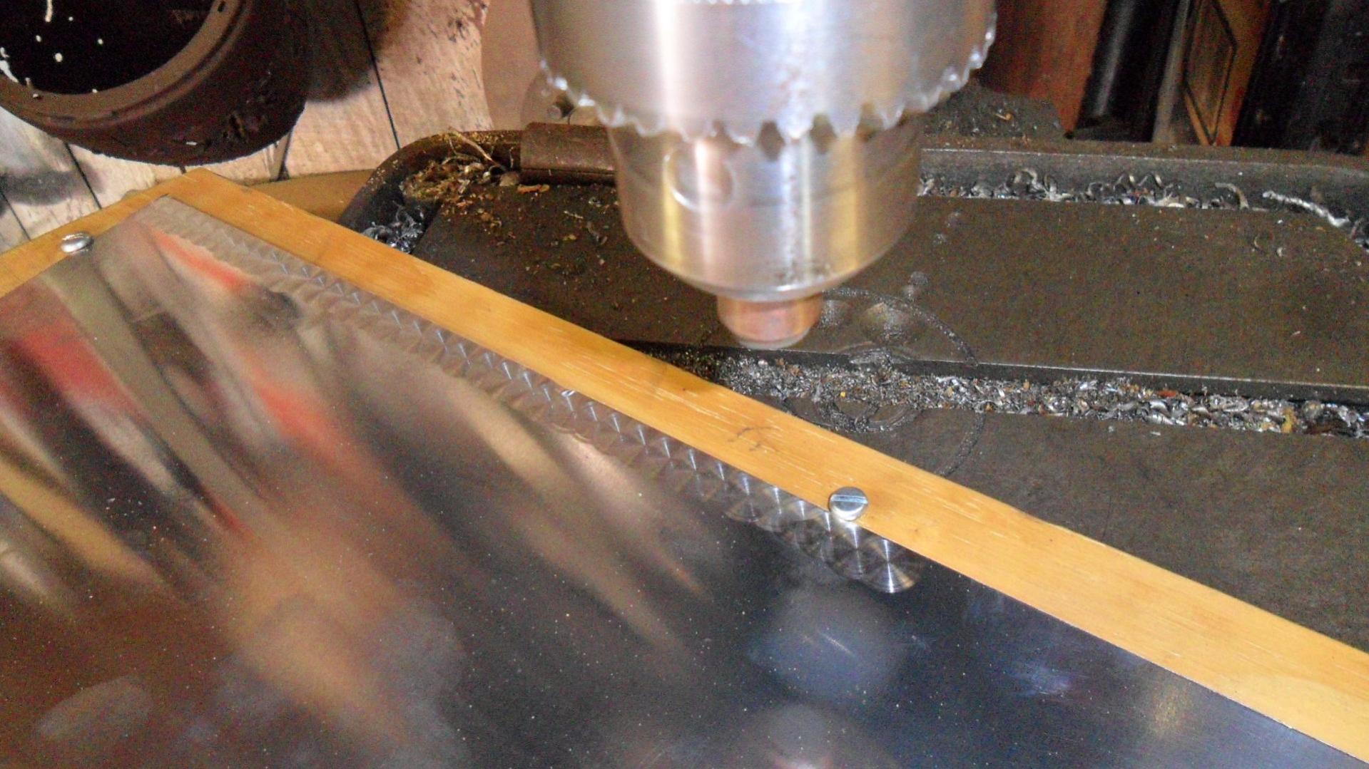

    I usually freehand it, but I noticed hers was a little less than straight. What I think I'll do is straighten the work piece on the board, and clamp a straight piece of tubing to the drill press as a guide. I used this deal with my nephew years ago when I taught him and it worked great.

    BuiltFerComfort
    I've used pegboard with dowels before. Very regular but spacing matches the pegboard, your only choice. You could make your own pegboard, any grid you want, smaller holes, nails for pegs, by drilling at intersections of a grid pattern on some spare plywood.
