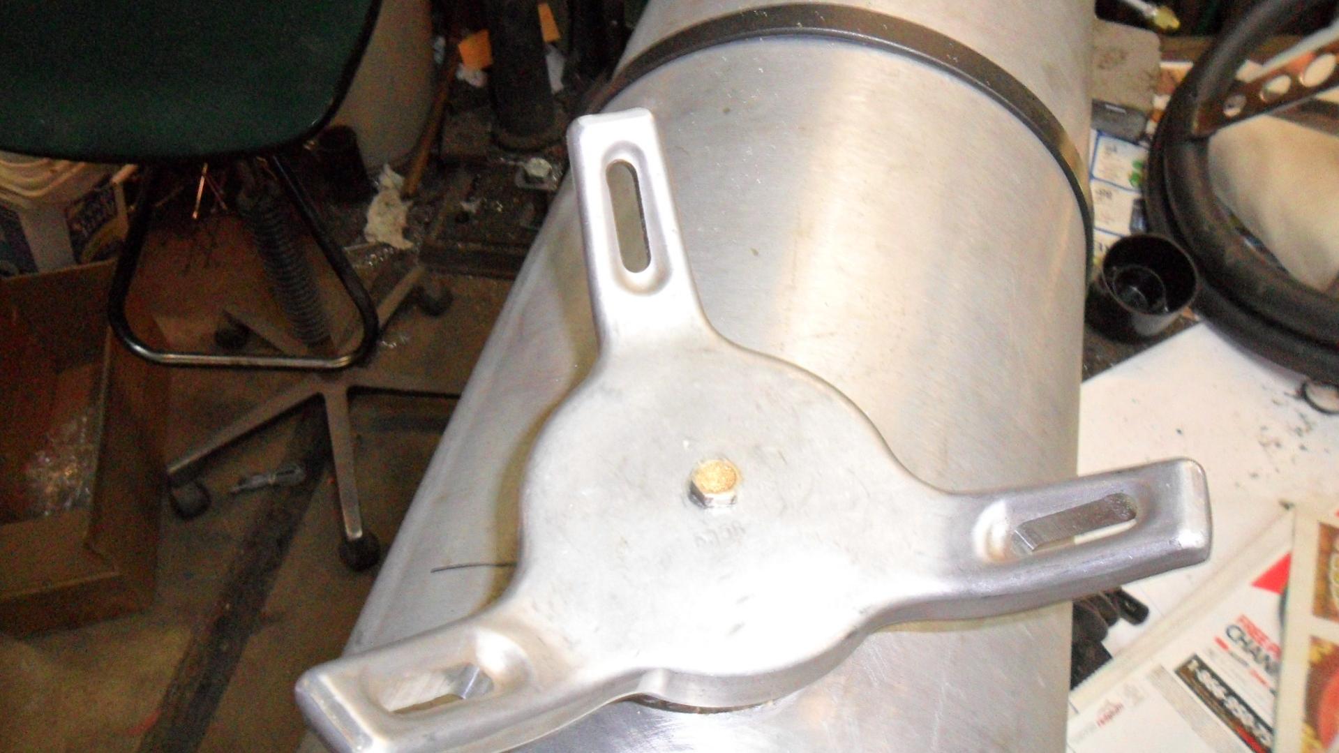

    I told you that I would show a picture of my gas cap vent solution the other day. I managed to remember to sneak out to the shop yesterday before loading all the cruise photos and capture a shot of this little gizzie... Stainless outer with a sintered bronze inner core that p***es just enough air the equalize the tank inside and out, and really shouldn't be a major inlet for water. Also looks like stuff that I have seen in lots of sixties sporty car type caps over the years. I'm going to grab a second one in the next couple of days, as the stainless was a bit softer than I thought it would be and the corners of the flats 'dragged a bit as I cranked it pipe threads tight...

    The aftermarket tank I mounted in my roadster came with a rollover vent. Not sure if you could use something like it.
