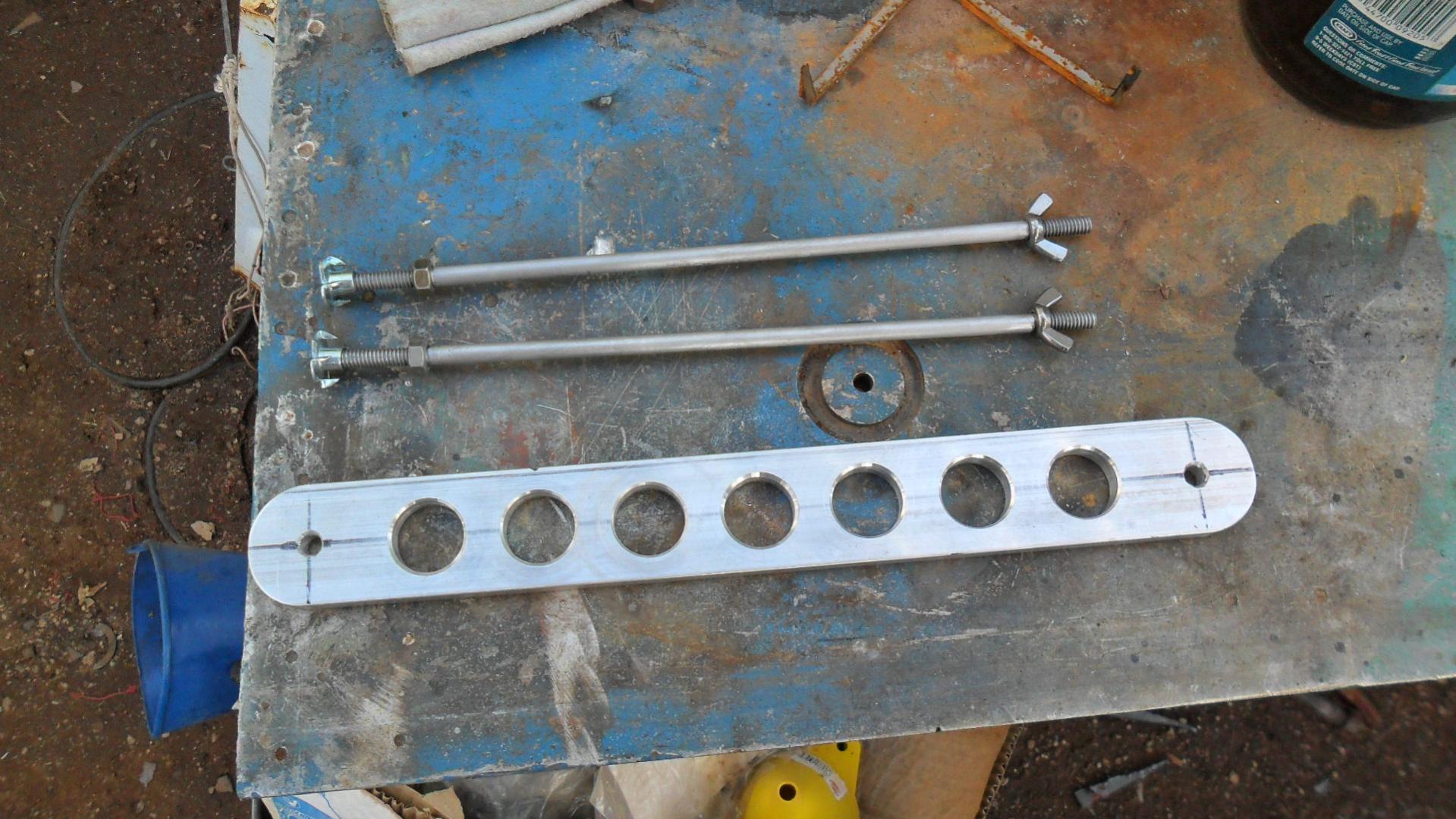

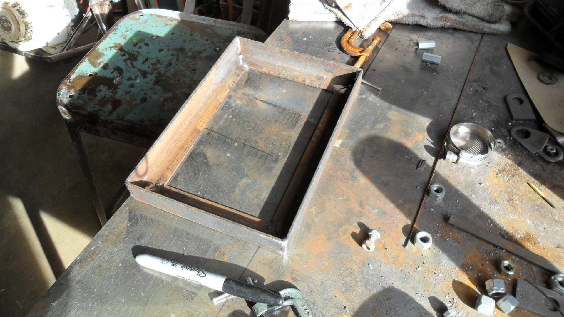

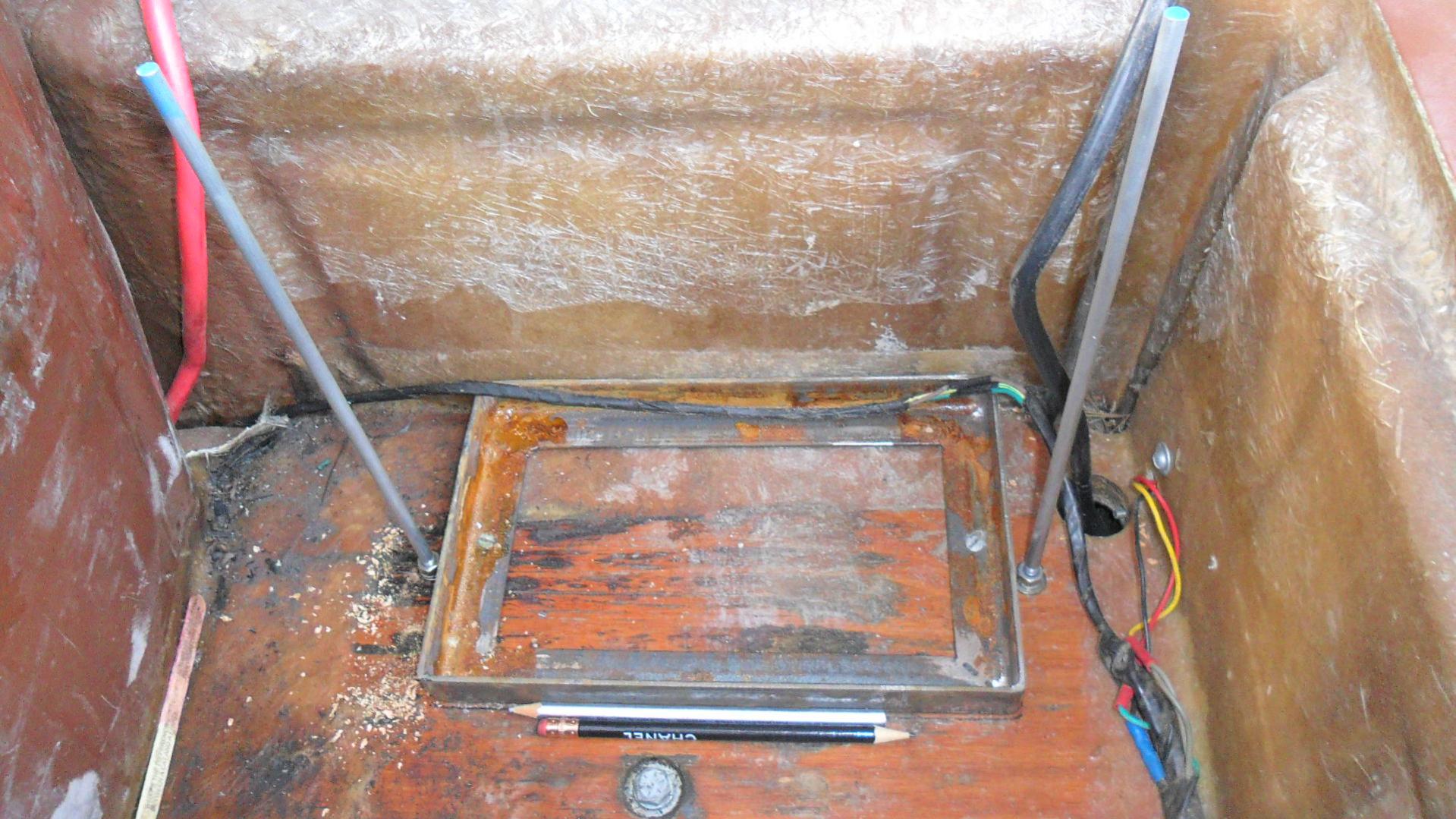

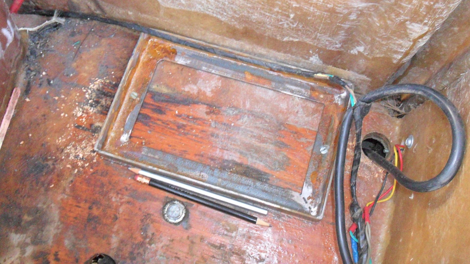

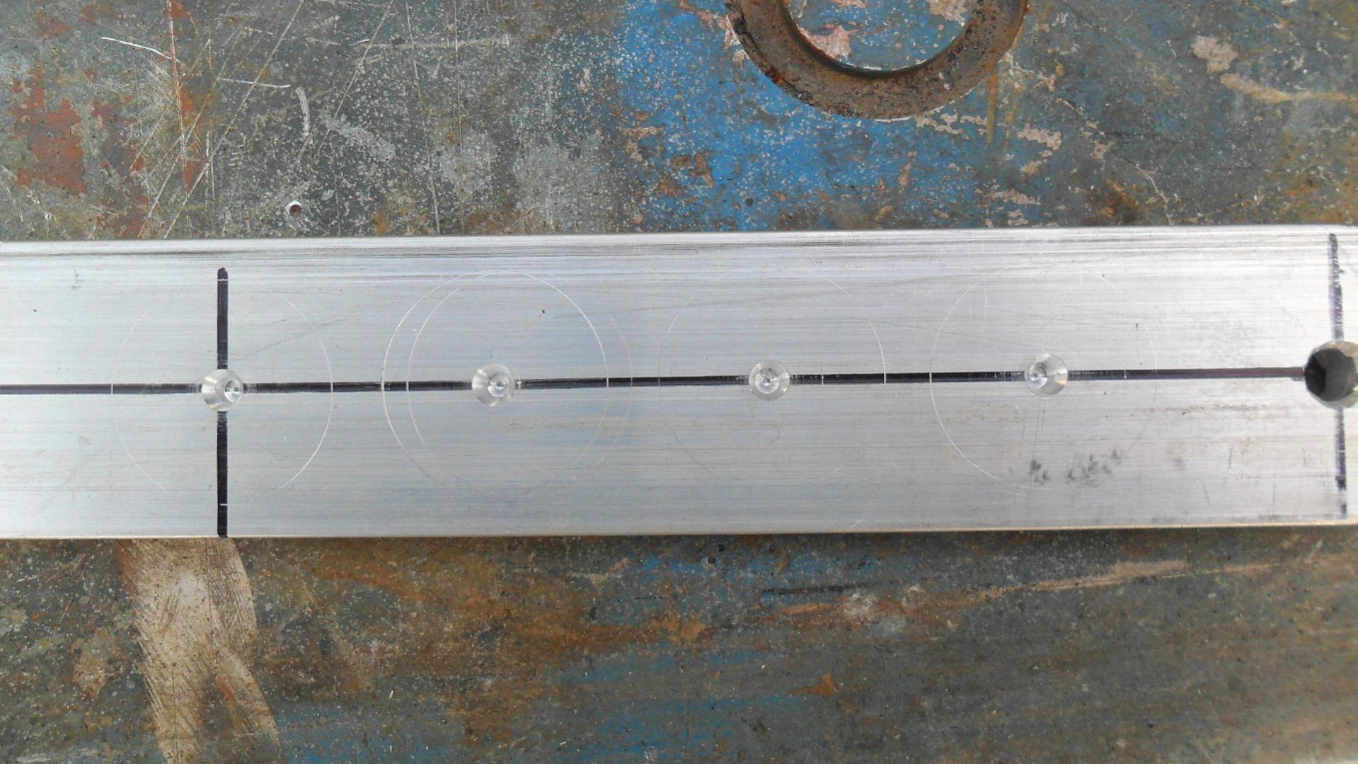

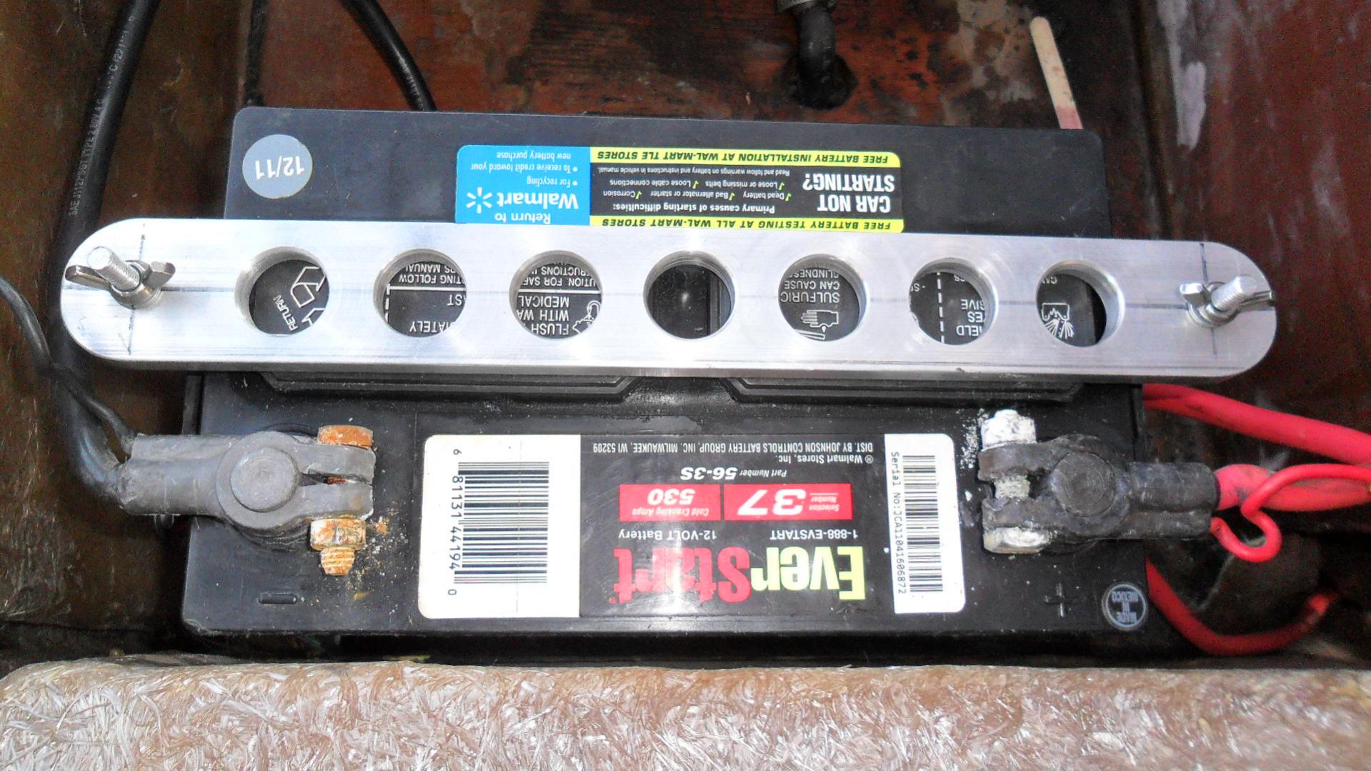

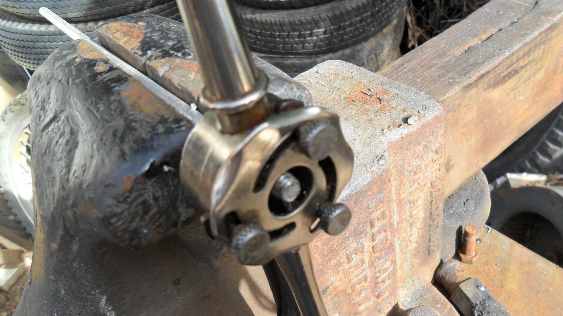

    Okay, back to my battery situation! On the last page someone was concerned about my hold down. Not gonna be a problem! This type of box/ hold down is what I do in damn near any car I build. One of my pet peeves is aftermarket battery boxes that take up tons of acreage in a small car. No matter what you buy it's either an inch too long, or an inch too wide. Here is how I solve that...
    The very first pictures are of the base I made from 1" angle iron. I didn't think at the time to photograph the complete cut and weld up, but you guys all do this stuff so you know what's involved.
    The next photograph will be of the base bolted into the floor of the bed with two flat head counter sunk 1/4" 20 bolts with fender washers and nylock nuts holding stuff down on the under side. The battery is a snug fit into this so it positively can't move around or come out.
    The next shot is of the 1/4" 6061 aluminum hold down bolts being threaded. I HATE all thread for this, and the aluminum has always proven itself more than strong enough yet easy to thread properly, plus it was left over stuff so it was basically free...
    The next shot will be of the hold down rods installed for fitting. They thread into blind nuts on the underside of the floor, then are tightened securely from the top with a large washer, lock washer and 1/4" 20 nut to hold them in place and not loosen up.
    Next, I measured and made the hold down out of 3/8"X1 1/2" aluminum stock. I trimmed up the edges to give a nice finish on each end on the belt sander, but these always look "billetty" if you leave them plain.... So, break out the dividers and Unibits!
    Holes, ya, that's it!
    The last is installed, and virtually bomb proof! Oh, stainless ****erfly nuts look nice too! All of this came from either my s**** bin, IMS's remnant room, or the local ACE hardware. There is a grand total of about 5.00 in it all together. When the car comes apart for paint, I'll spend some quality time with the belt sander rounding the edges and polishing stuff so it looks a bit more "organic", but remember, in my write ups from many pages past, one of the things I really like about the early '60s cars WAS the use of aluminum on everything.
