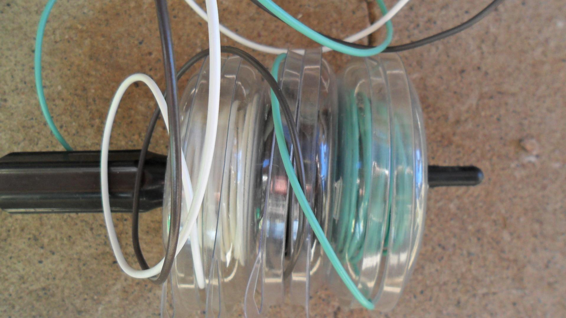

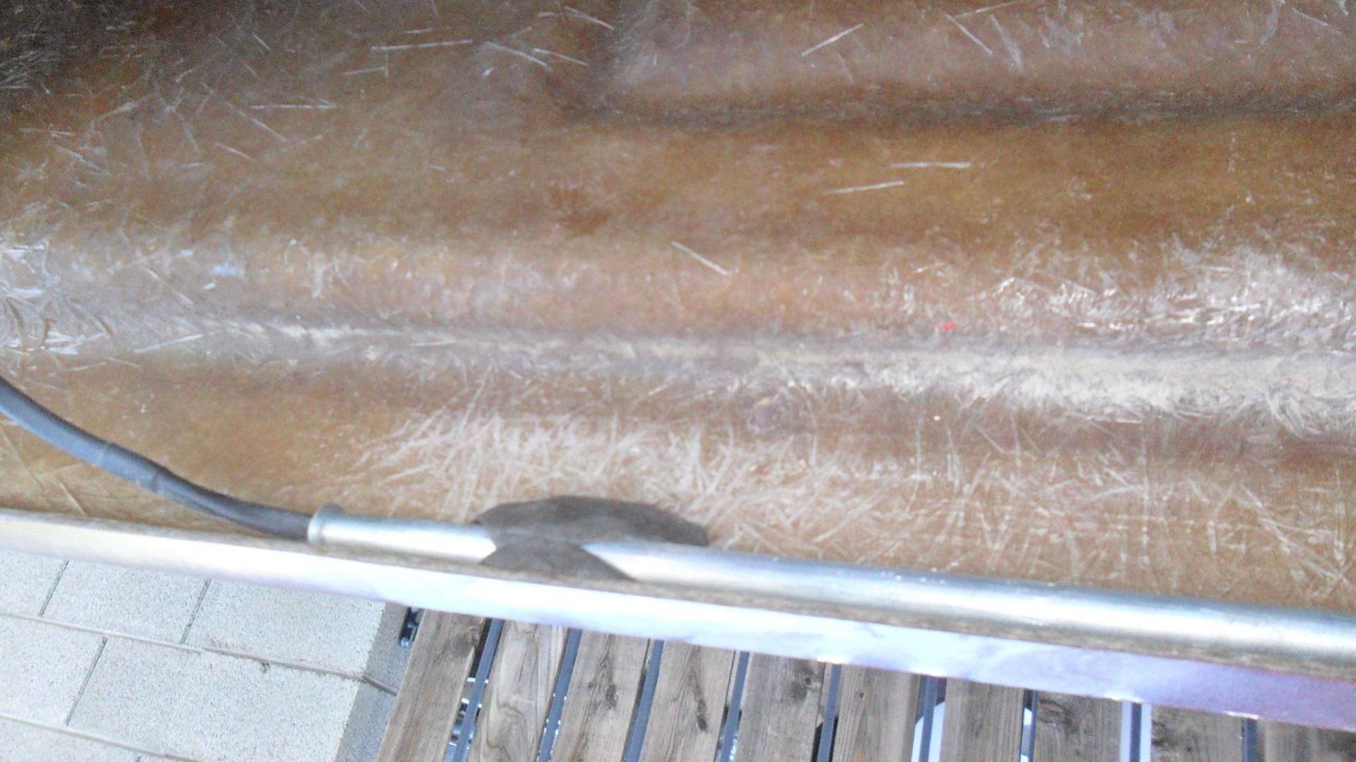

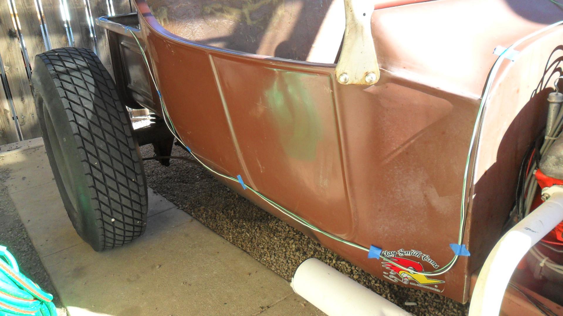

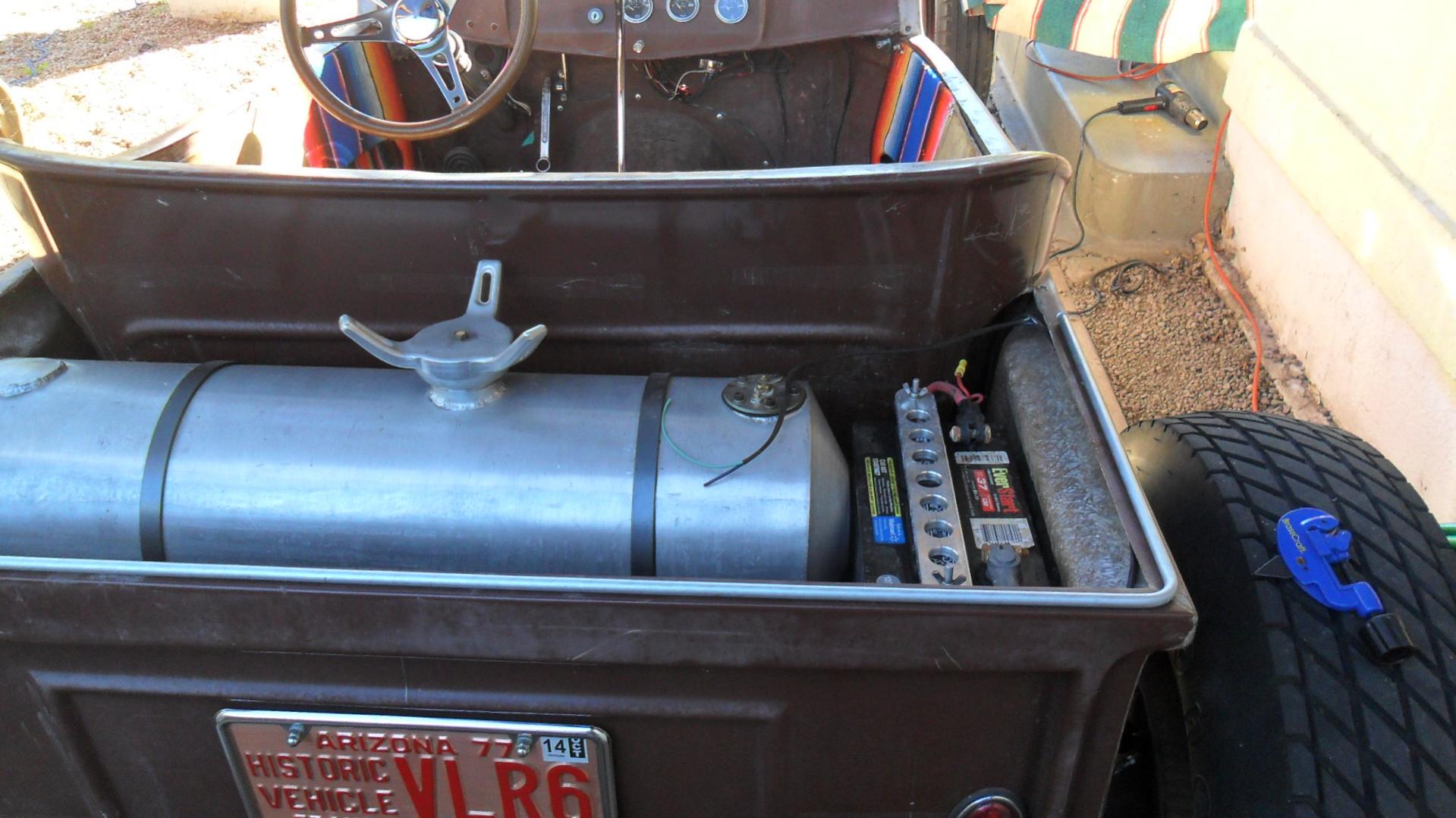

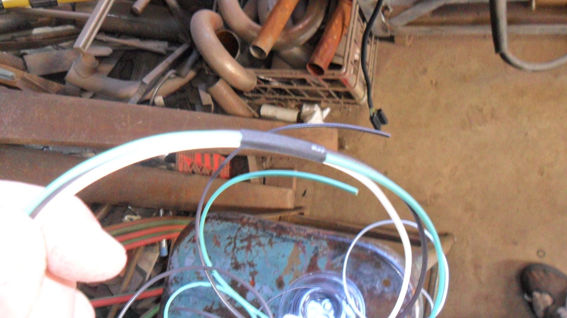

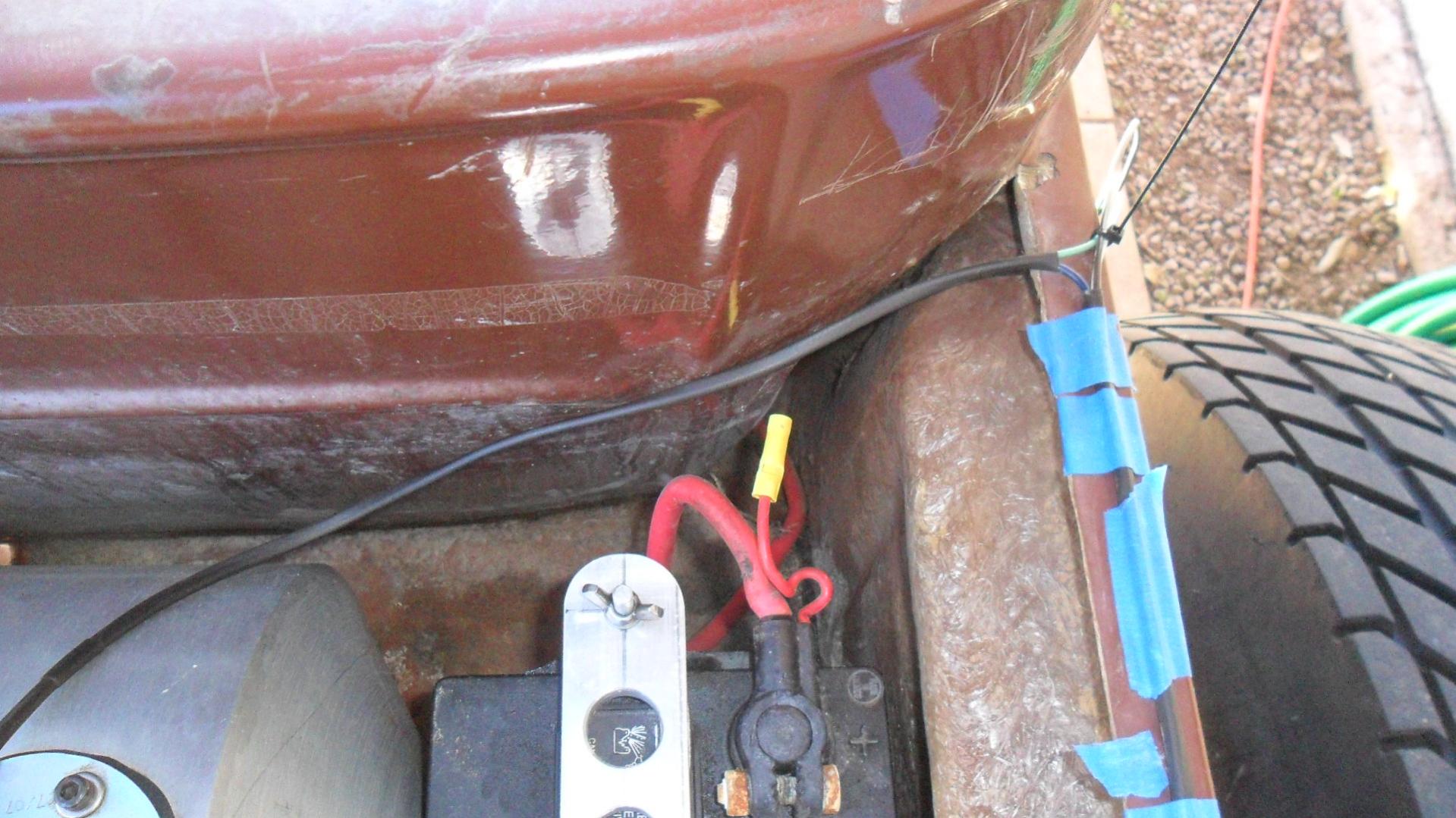

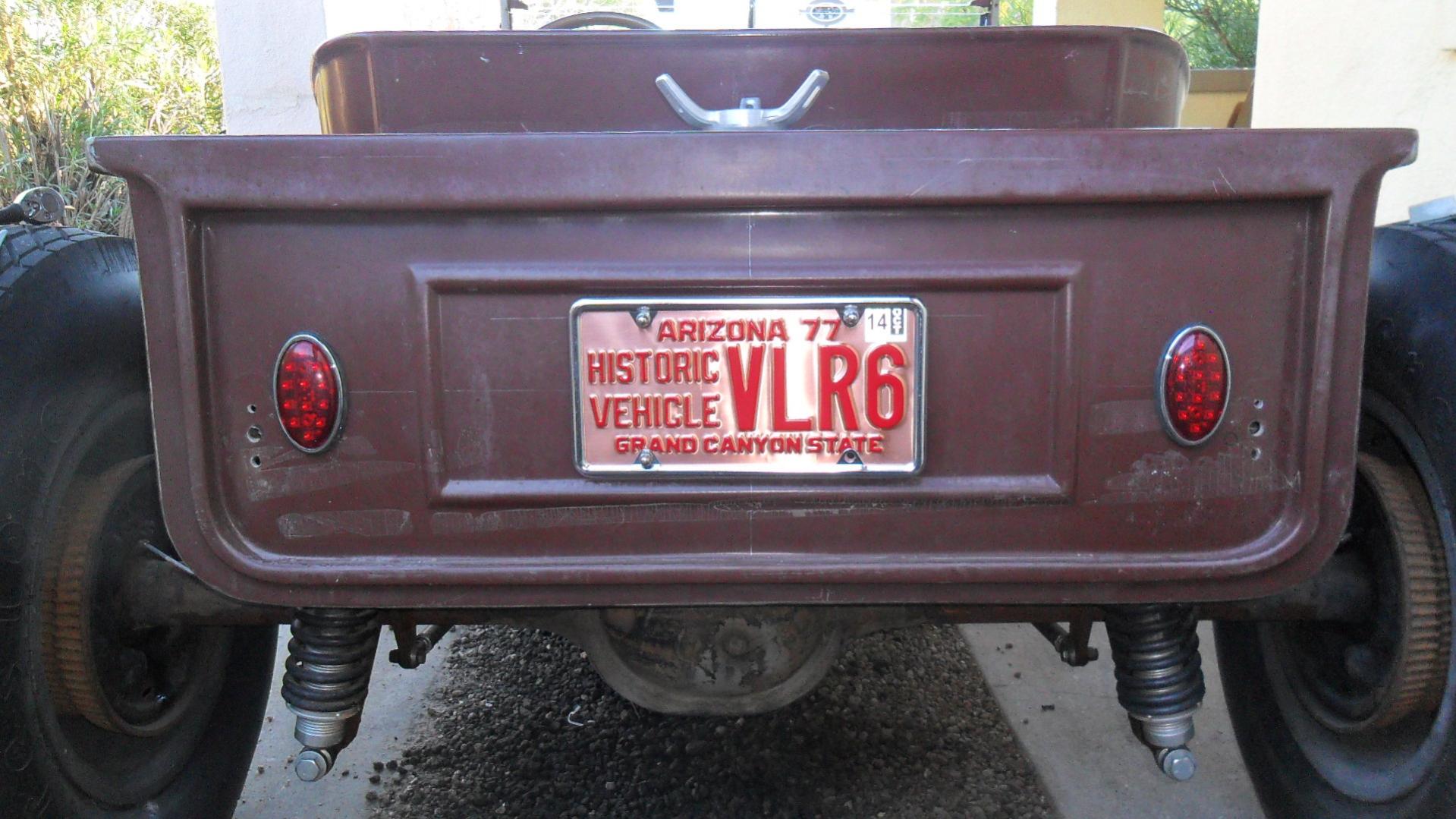

    Well, I was going to hold off on posting this until tomorrow, but I got a major bit of forward motion on the car finished today! Besides, all three of the doglets and Judy are conked out sleeping already, and I have a bit of time.
    For the last couple of weeks, people have been driving up to me to tell me I have no brake lights, I have one tail light, I have NO taillights, or no lights on the back of the car period... Or any combination of the above. The wiring done on this car was beyond atrocious in anybody's book, and I knew I would have to do something about it at some point. I already corrected the charging circuit a few months ago, but with the addition of the fuel tank with sender, and the deletion of those F**KING turn signals, plus all the issues mentioned above, it was time to do the rear of the car.

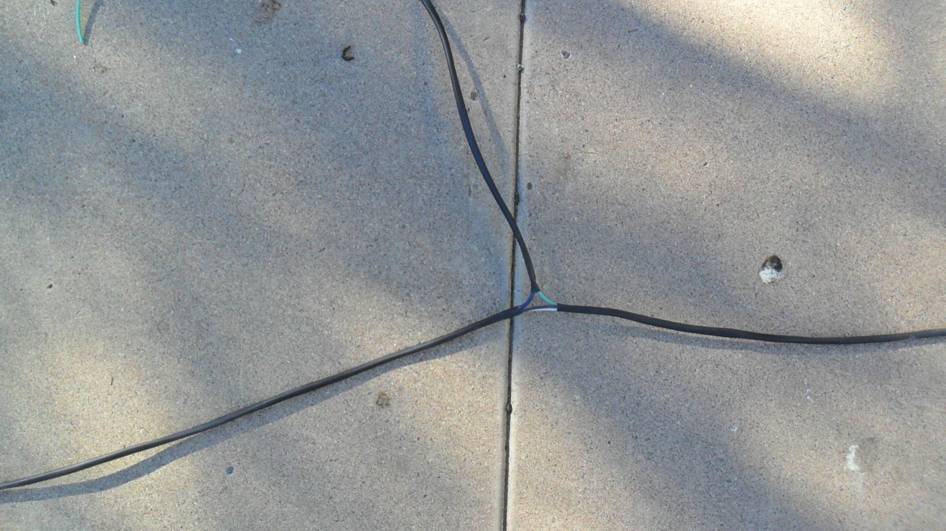

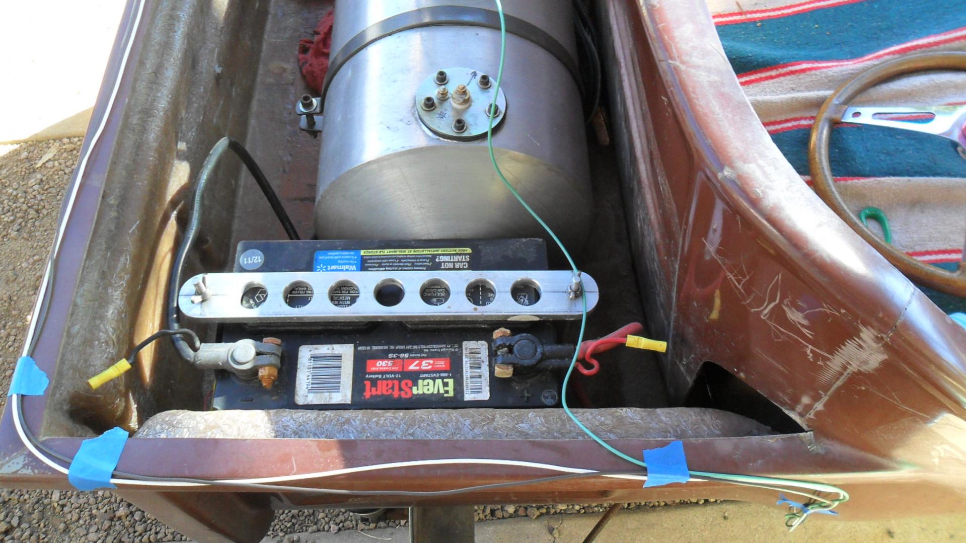

    I knew I wanted this one a bit different that others I had done in the past. I usually use hundreds of tiny tie-wraps the length of each harness to keep the wires straight, unbraided and going where they need to be. Not real conductive to keeping within the given era of this project, though. Moreover, most T-Bucket wiring ends up simply dropped on the floor of the bed and hooked up to the tail lights above. That means that when Judy puts her two shoe boxes in the back, they rest on those wires and eventually abrade them or literally pull them out of their connections. Not good. I had a plan though....
    First, I determined exactly how many wires I would need, and what their routing would be. I figured for my situation I would use a 16ga. white for the brake lights, 16ga. brown for the tail lights, a 16ga. light green for the fuel sender, and a 16 ga. black for the ground. Since there was already a ground point in the center of the car, the ground wire for the rear harness would start at the fuel sender ground point and work it's way backwards to the tail lights and finally the frame. After procuring the right amounts of what I needed, here is where I started.
    1. I figured out the routing of the harness and taped it on the outside of the body following the places it needed to run inside the car, then made my course cuts to length.
    2. I decided that instead of doing the tie wrap thing, I would take advantage of one of Judy's gifts from Hong Kong - I giant spool of 1/4" shrink wrap tube! At first, I made small cuttings of the shrink, and installed them at 1 foot intervals to help hold the wires in place and unbraided. I then figured out how long my first chunk of shrink tube needed to be, and cut it. Then it was time to feed the wires through... Easier said than done! Another thought brought me into the front bathroom (or Miss Judy's) of our home. I knew I had seen a small bottle of Baby Powder in there! Powder up the wires, put a little powder down the tube and blow it through so that everything was nice and slippery. I worked from the dash panel end to where the fuel sender line exits first, then incorporated the ground wire into the rear harness and did that section from the other direction. shrink it up and I had a basic, form fit harness that was bomb proof and made to fit my car! Mission accomplished!!
    3. The next problem was how to keep this stuff from simply laying on the floor and being destroyed.... A chunk of 3/8" fuel line tubing was laying on the porch for future fuel lines that I haven't got to yet, and gladly gave it's life to the cause. I cut it to length, removed the tube nuts, and turned a flare on the cut end. With a bit more of Judy's baby powder, I worked all of the harness through the tube, scuffed up the upper inside of the bed rail, and used some good old JB weld two part epoxy paste to glue the tube into the top of the bed rails. Now all the wiring drops from the top of the bed rail down to each light that it serves so it doesn't have to fight gravity OR Judy's shoe boxes! The ground went through an existing hole in the bed floor to an existing threaded hole in the frame were it will ALWAYs do it's job - no more weird grounds! I took a bit of time to move the taillights to the position I was talking about a couple of months ago, and I am liking the rear view of the car lots better now!
    As always, the pictures are what they are, and using the system I use I can't individually caption them. But you guys will get the idea. All of the removable stuff was fitted with quick disconnect bullet type plugs, and each was shrink wrapped for protection. What do you think? Sure is nice not having to worry about not being seen!

  9. Nice job, Chip! Love the idea of running the wire through the tubing. Nice, clean, and safe.
    Wiring is definitely one thing that will either leave you stranded far from home or get you pulled over. Oddly enough, it's treated like the Black Arts and most guys either shy away from it or do horrifically dangerous wiring jobs because they just don't care or don't understand it's importance from a safety aspect. I've seen more cars burn up from wiring than any other cause. Wiring usually starts the sequence, and fuel always finishes it.

    I get the metal tubing, but wouldn't the shrink wrapped wire be a bear to trace and or replace, if only one or two wires needed it? Or am I over thinking this?
  13. need louvers ?
    Joined: Nov 20, 2008
    Posts: 12,901
    need louvers ?
    I left several inches at each end so you can see the colors used and trace each one. The other VERY important fact that I didn't really explain was that I started with BRAND NEW wire of the proper color code and length so nothing was patched together over it's length. It's one solid white wire from the brake light switch to the left tail light, and one solid brown wire from the light switch to the same. It's my experience that wiring only gives you trouble where it has been spliced together, or joined to another wire, or terminated. I do my level best to make each piece of the proper length to get to the car's furthest point, then make a sub-harness to come back to points between.
    The tail light wire I took out of this car started at the switch in light brown, changed 1' out to red, 2' out that became green, another 1' out that finished in black.... All of different gauges! ...And completely encased in electrical tape that was already sticky and oozing...And all was joined by improper crimps! How that was supposed to actually conduct electricity reliably is completely beyond me, but it just serves to prove that you don't wire something with "what you have around", you need to get the right stuff! I wish I had taken a picture of Judy cutting the old wiring out! She did it quite enthusiastically, but a sinking feeling set in as I heard the snippers go "click"... Did she just cut the new stuff?! Thank fully no!
    I haven't taken pictures yet of the completed job, but the sub harness that services the right tail light is all new wire too, matches the other stuff exactly, is shrink wrapped, and runs up over and to the right tail light. The only reason it isn't also run through a tube is that I still haven't quite decided what direction the plate and tail lights will go yet. I am liking this deal much better with the tail lights in their current position, but the siren song of Chuck Penry's simple Lucas single tail light and plate light still burns in my head. In either case I still have to figure out a plate light...

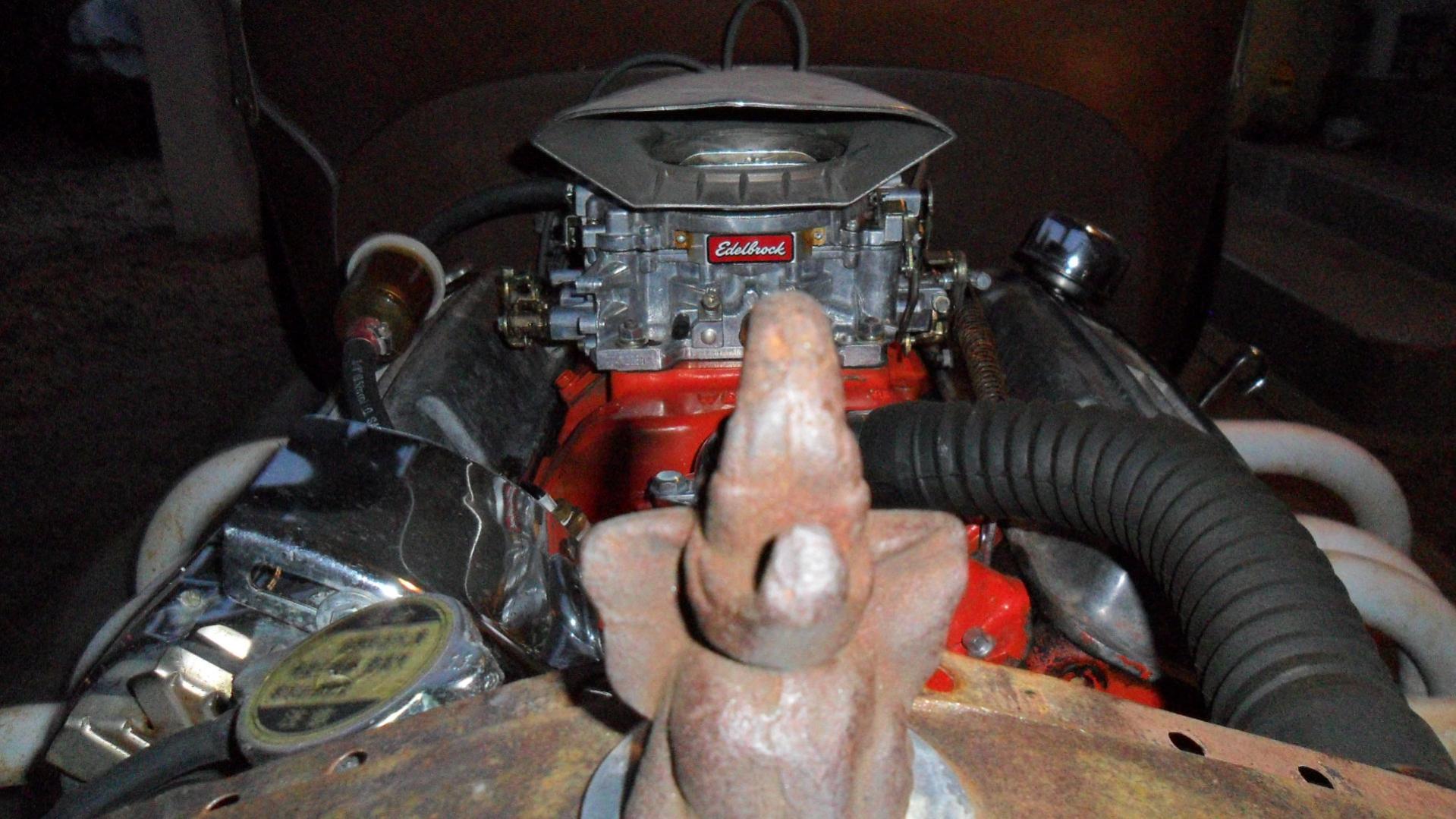

    I need to show you guys something else, and give a hearty HI-Ho to JERRY here on the H.A.M.B.! See, about three weeks ago he summoned me to our local cruise night 'cause he had something to show me... A scoop! It was pretty rough, but absolutely *****in'! Turns out it was made by Cal Custom in '64 or 5, and I think it is absolutely perfect for this car! It looks a little like a "Surfer Scoop", but on a smaller scale that is perfect for this car. I've had to do some creative, gentle bending, (wasn't that a bear?) 'cause it was at one point stepped on by Godzilla, and the chrome was beyond No Bueno so I sand blasted it away. The plan at this point calls for more gentle bending (there's that damn bear again!!) and possibly some loving persuasion, followed by some tenderly applied hammer bashing to get the shape even closer to what it is actually supposed to look like. After that it is the task of figuring out how to mount this thing and keep it low with out a goofy inch tall adaptor, then bright hugger orange when the rest of the car gets squirtified, then some vibrant striping....

    but where does the airfilter go? or is it not as small as it looks.
