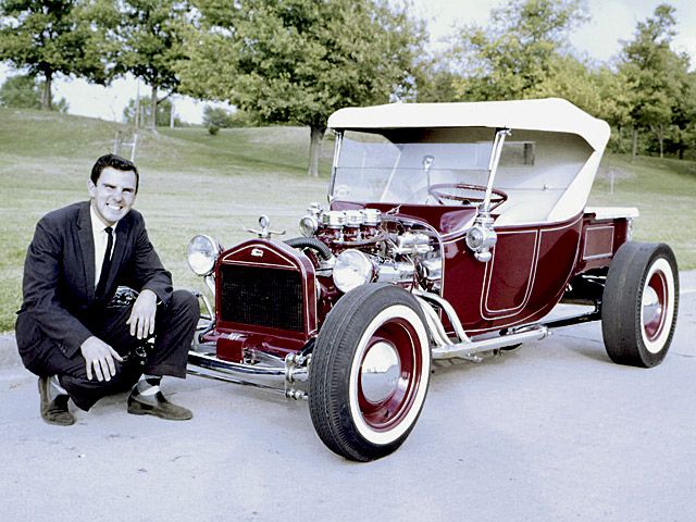

    This one is out of M***achusetts isn't it? Still looks the same. Bob [​IMG]

    Nope, that was Monogram Models full scale pattern for the "Big T" kit from about '61 or so. Starbird built it, and he was out of Kansas.

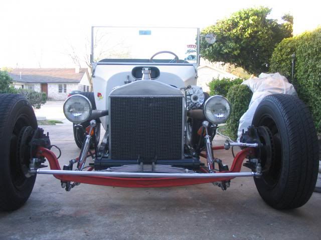

    I think a chopped Deuce shell will fit the look you're after. As to your other question, I'm running a Speedway radiator and while I don't run a genie T shell, I'd say it wouldn't fit. The measurement difference is VERY close. That radiator is meant to run as is or with their gl*** shell. I run without a shell. I probably should have sprung for the polished version for the bling, but I hate polishing aluminum and it would have ended up looking brushed anyway. The brushed version fits the stripped down look I was after.
    I may be swapping mine out due to cooling issues. I'm not sure it's the radiators fault, but I'm in the process of narrowing down the issue. It's a 2 core and warms up quick. You being in Nevada, I'd say go 3 or 4 core.
    Oh, my radiator is 1" below the cowl line. A nice evil rake.;)

    Found a pic.
    Measurements from mount edge where it meets the frame to the other side of the frame is 21". From top of mounts to top edge of radiator is 19 1/4".
    Side view with photo shopped WWW's.
