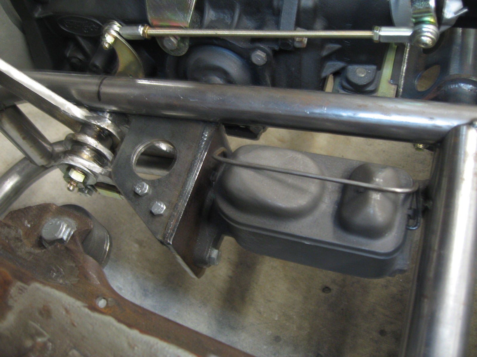

    I went for a bit of a wild ride in the 'Bucket on Wednesday! I jumped into it to head out and grab some more parts having not driven it since Saturday evening. Clipped the wheel on, fired it off, backed it out and just kinda slide it into drive as it rolled and headed off down my little street. Got to the end of the street and went to make a right onto Central, and stepped on the brakes to slow up... And they went to the floor! Pumped again and the now dead pedal just laughed. I saw just enough space to tuck it into in the right lane in traffic (The only possible place to go, and about a car length and a half long!) and just flat went for it, fortunately sliding it a bit and scrubbing off some speed as I did. Did the same right turn on the next street up and let it roll to a stop on the long quite street. Sat there and shook for a moment, then quietly pushed it the rest of the block and a half home!!! I don't believe the commuter zombies on central even realized I was having a problem!!! Don't try this at home, I am a trained professional...
    Turns out, the year old, super cheesy, Chinesey Speedway master cylinder had a m***ive bout of non-workability. I guess it was kinda like that old Monty Python gag about the blocks of flats put up by a Hypnotist/magician named Mysterio. They were lovely to live in and very solidly built as long as you believed they were real! If you didn't, they started to fall down until you believed again. Kinda like that! See, the last couple of weeks I have been thinking about what master cylinder I could slide in there that would make life a bit easier and provide better braking feel. That's when the old decided life wasn't worth living, and it would take me with it.
  22. need louvers ?
    Joined: Nov 20, 2008
    Posts: 12,901
    need louvers ?
    ....So, long story short, it didn't kill me. But I had to do something about a master cylinder on the super quick so could get back to driving again. I went straight for one of my defaults, a '71 Maverick non-power, drum/drum master.
    It has a number features to recommend it for this type of use. 1. Ford master cylinders from the early seventies were still equipped with in cylinder residual check valves when drum brakes are present. I can't tell you when they did away with them in favor of those in the combination valve or external, but knowing that little tidbit always makes plumbing a bit easier. 2. it's a 1" bore, which is a good size for a vehicle of this weight and size. 3. It is about as compact as a dual chamber cylinder is gonna get. 4. The reservoir bowls are the same size on the drum/drum version, and although I don't really know why, it makes my sense of symmetry happy.
    With a bit of fiddling and some adaptors quickly sourced from my back yard/junk yard/I never throw anything away hell hole, it dropped right in and is a bit narrower than the Speedway G.M. knock off that it replaced, so the shifter's linkage has a bit more real estate to roam in. The Speedway unit was set up as an aftermarket disc/drum master, and it's lack of residual check valves were what contributed to the somewhat vague feel at the pedal that got me in this mess in the first place.
    Now, as good as this Maverick unit is, I'm wishing that I had had the time to find a Ford drum/drum master that was 15/16" instead of the 1". Due to space constraints stemming from the original owners insistence on a left foot brake pedal, the brake pedal ratio is a bit compromised in my car. The pedal is pretty hard at the moment, and a slightly smaller bore would go along way to helping with a softer pedal. To that end, when I went down to my wholesaler yesterday I asked for an old hydraulics parts book with bore sizes listed, and I'll sit down for a bit and do some research so I can find one by application.
    In the mean time, The Bucket of Ugly STOPS! Oh, soon it'll get a parking brake too... ***mon truck, stop screwing with me!!!

    Hell yes it could have been! I have been meaning to get to an e-brake on this thing, but I just haven't had time to deal with it. I went out today and was looking at stuff in the back yard and realized I had a complete S-10 rear end with some very nice shielded, staggered length e-brake cables on it. Probably will get rolled into this deal soon.

    I am going to use one of the Disc units for the rear end, on the drive shaft, as my roadster has 4 wheel discs.

    Jaguar masters are 15/16" hope that helps you.

    For a 15/16" bore master cylinder you can use an easy to find Ford Pinto master cylinder.
    Probably much easier to find than a jaguar MC.
    1979 Pinto specs: CENTRIC PREMIUM BRAKE MASTER CYLINDER, NEW -- 15/16 in. bore diameter; This is a high quality OE replacement brake master cylinder.
    I'm using one on the build of my 26 RPU.
