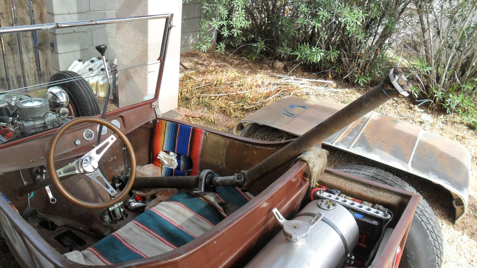

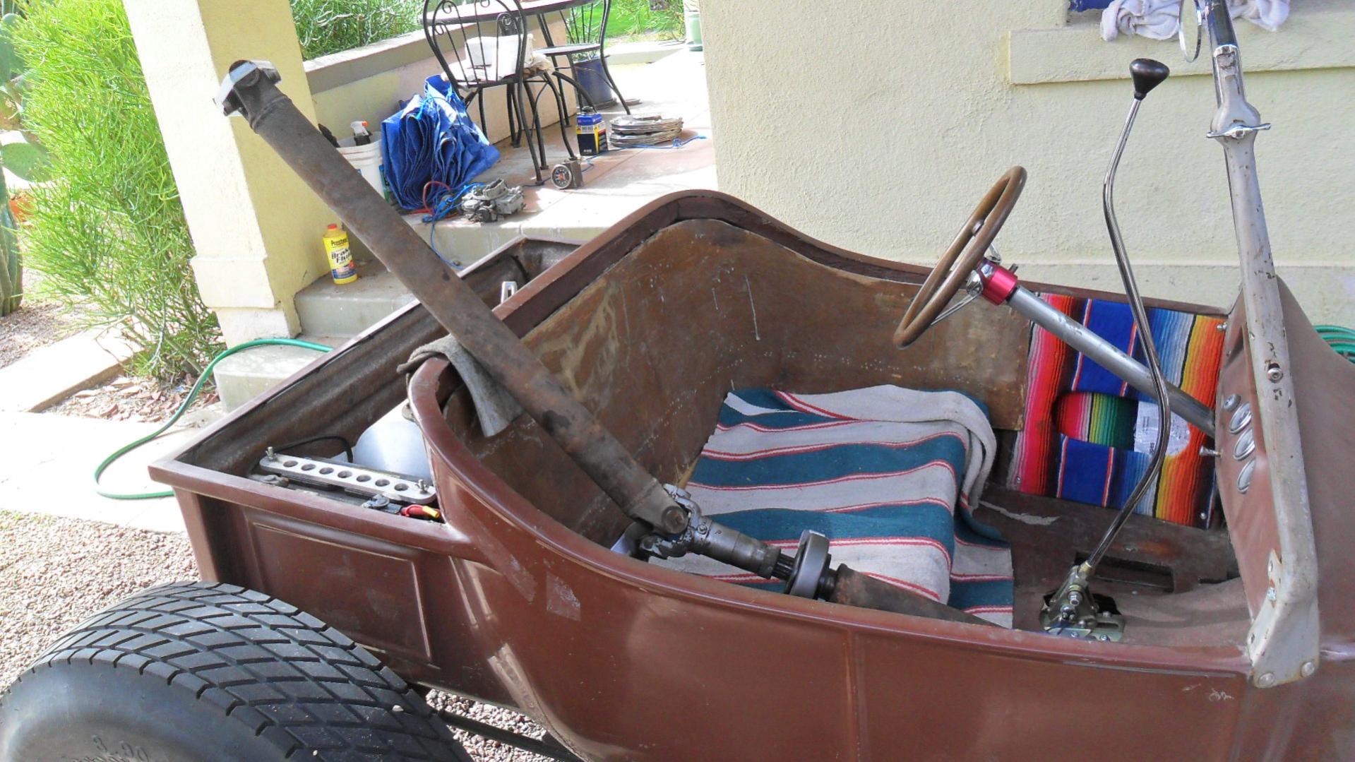

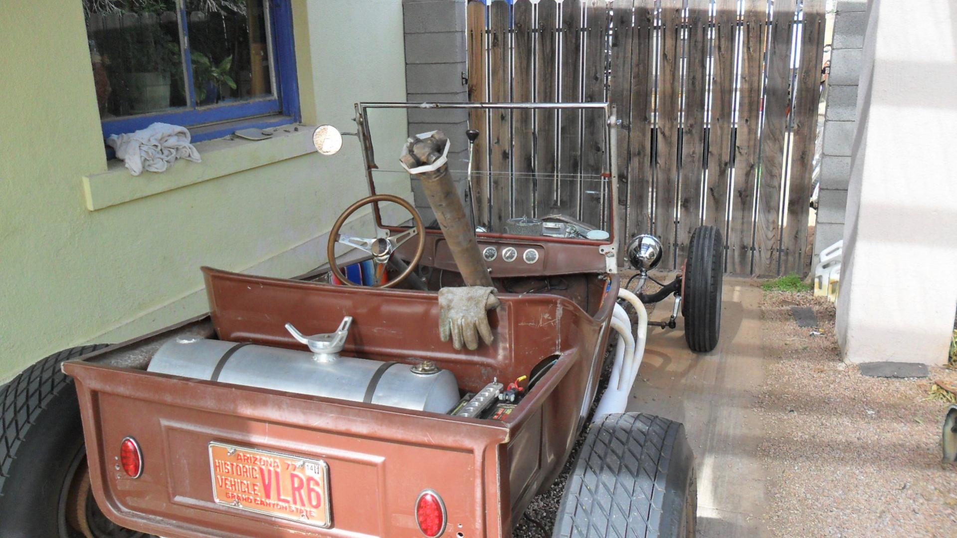

    I promised somebody picture of hauling "endlessearth's" driveshaft home from the driveshaft shop. I shot this Recreation the other day after I got home. You should have seen me doing it AGAIN 4 times while we messed with getting the proper slip yoke... In the rain this weekend... A friend of mine suggested it need W/T badges.
