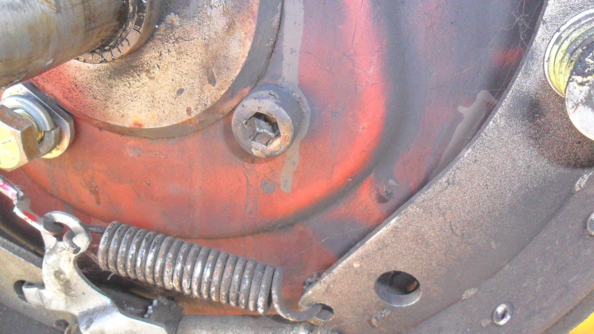

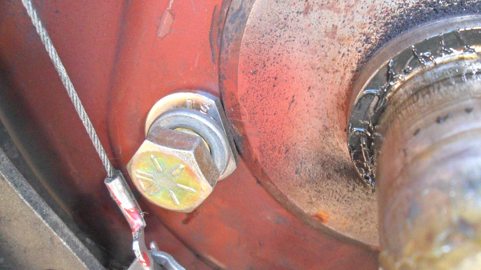

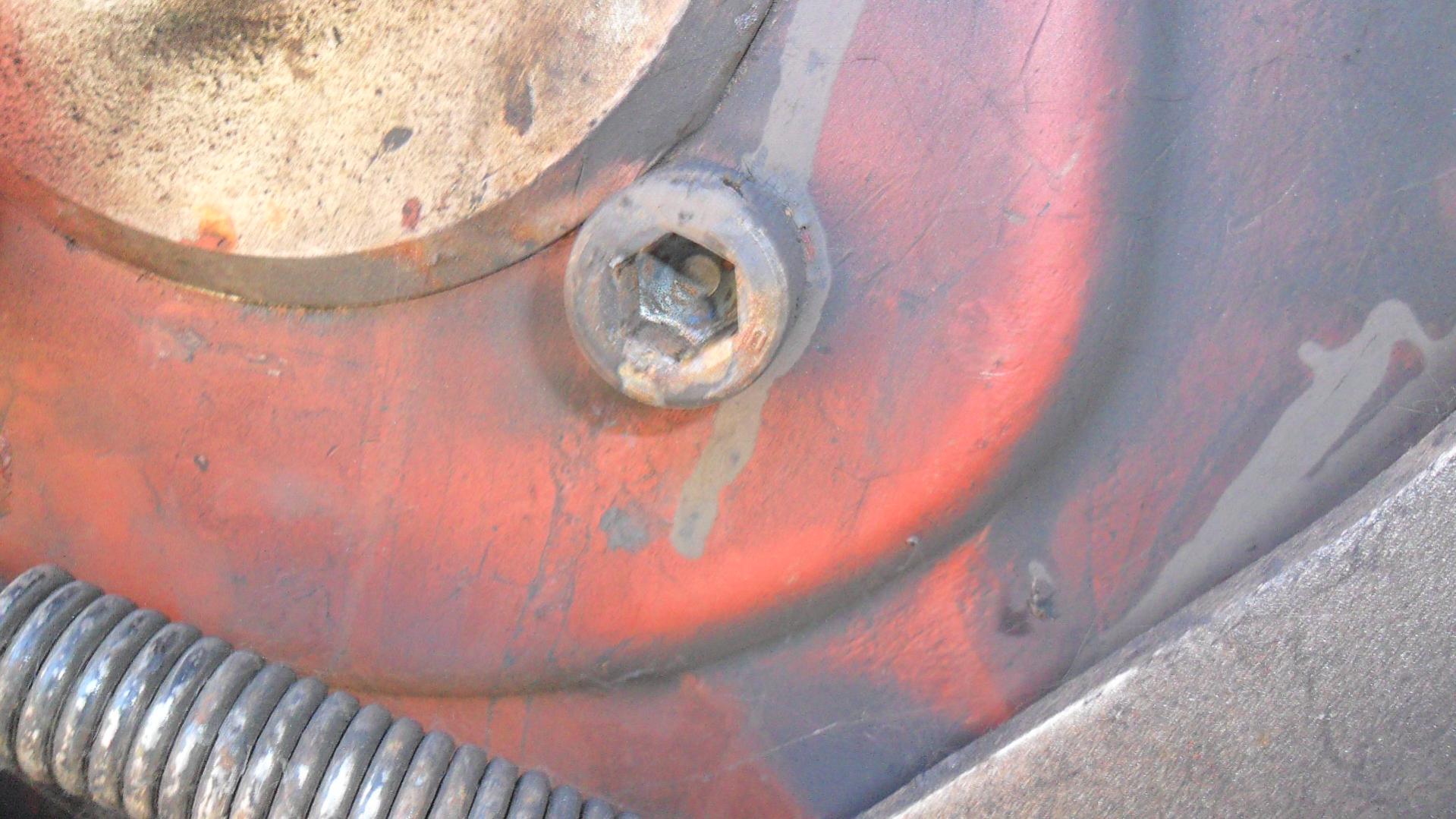

    Hey gang,
    As long as I'm in a kinda tech mode around here, I thought I'd add to another problem solved. Actually, thought I had solved it quite awhile ago!
    See, my car has had a little issue with a low speed wobble for a while now, like ever since I put the Halibrands on it last fall. Nothing terrifying or anything, just a small amount of nervousness at low speeds. Really pretty freakin' annoying in traffic sometimes, but not deathly.
    This got a bit worse yesterday when I put my uncle in the p***enger side and headed out to Good Guy's. The extra weight kinda made stuff a bit more wobbly than it normally is.
    Now, in the past months as I have had time to, I have been futzing with everything I could think of to kill this deal once and for all. Adjusted toe in, switched out my steering box to one with a tighter sector shaft bushing, adjusting the steering box, checked king pins, made sure everything was tight, check and adjust caster, etc.
    Everything made a bit of difference, but nothing really killed the problem, and it just kept annoying me.
    So this morning, I was checking on something else and grabbed the right front wheel, and it gave out a mighty wobble. HHHHHMMMNNNNNNN, Bearings loose? Nope. Tie rod end bad? Nope. Wait a minute, the steering arm is wobbling on the spindle!!! But I thought...
    Here's the deal. Ya know those spindle arms that we all buy from Speedway, So-Cal, Pete and Jake's, and a host of other companies? They have some fairly specific needs as far as hardware to bolt them in place, yet the hardware is seldom ever included with the arms. One that is commonly used is a socket head allen screw. Now I myself said a few pages back that I LOVE aircraft type hardware and socket and ****on head allen stuff... Just not here! Here, a socket head doesn't have enough support around it's head to firmly anchor the steering arm to the spindle.

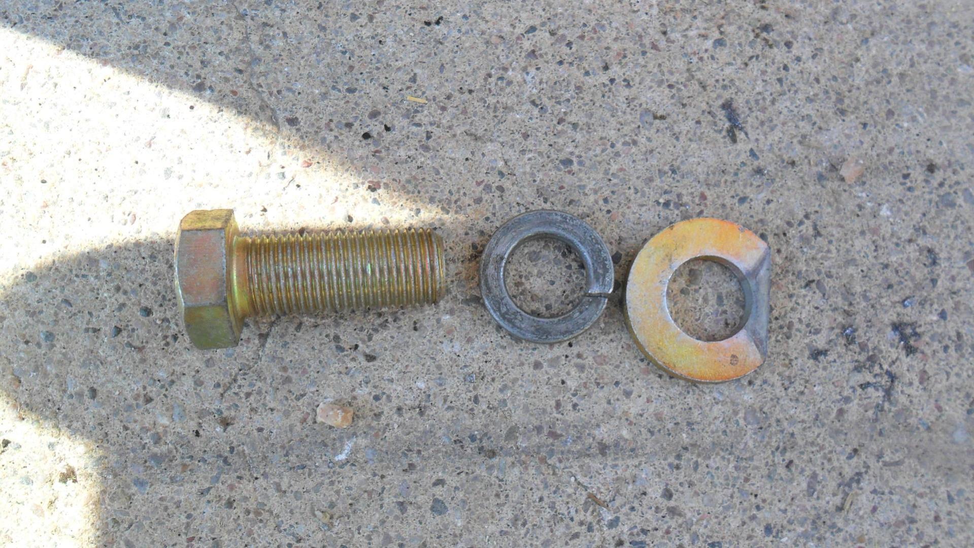

    What's the solution? Some extra thick grade 8 washers, carved for the occasion, and the proper depth 1/2" fine thread grade eight bolts, oh, and lock washers too!
    The net result is Day and night different!!! About half the looseness of the allen head deal! Simple, but it makes a huge difference!
    Oh, the stupid part? See, I had ruled this deal out long ago, because early on I discovered the allens on the drivers side, went out and bought the proper bolts, washers, lock washers, and did the drivers side. I even photographed it and intended to post it here for you guys.... Forgot that I ran out of time that day and didn't get the p***enger side done! Face palm slap! There was the two "extra bolts, washers, and lock washers in the bolt bin, waiting to go.
    Chased my tail for months for no reason... Typical!

    some one famous told me not to use a flat washer AND a lock washer. It is not effective,
    the lock washer , locks against the washer, not against what you want it to.
    I don't make the rules, just p*** it along...

    Hmmmmnnnnnn, never heard that one. I could see it though, especially with hardened stuff. In either case, with the thick washer beneath that has been "tailored" to fit the spindle, there is no way the washer could turn and loosen the whole shooting match in this particular case. That, and I kinda go for the belt and suspenders method myself though, as there is a drop of red Locktight on the threads too.
    The whole idea I was trying to convey, (and none to eloquently, I might add) is spreading out the load on the ends of the steering arms with the large, thick washers and larger bolt heads. You can't believe the difference in rigidity once they are in place! It's so easy to go to the socket head allens simply because they fit the register in the spindle for the brake backing plate so nicely. They just don't provide enough clamping force spread out over enough area to adequately stabilize the steering arms.

  29. I was taught that the use of a flat washer was to increase the locking area of the bolt and the spring washer was to lock the head of the bolt to stop it from working loose. I agree with Chip, one is better to have more surface covered by a good fitting washer bolt combination then rely on pretty Allen head screws which are a higher tensile strength then a grade 8 bolt but don't have the coverage of a bolt head.

    i agree more area is better, and Chip, nipped the flat washer to make it "STAY"
