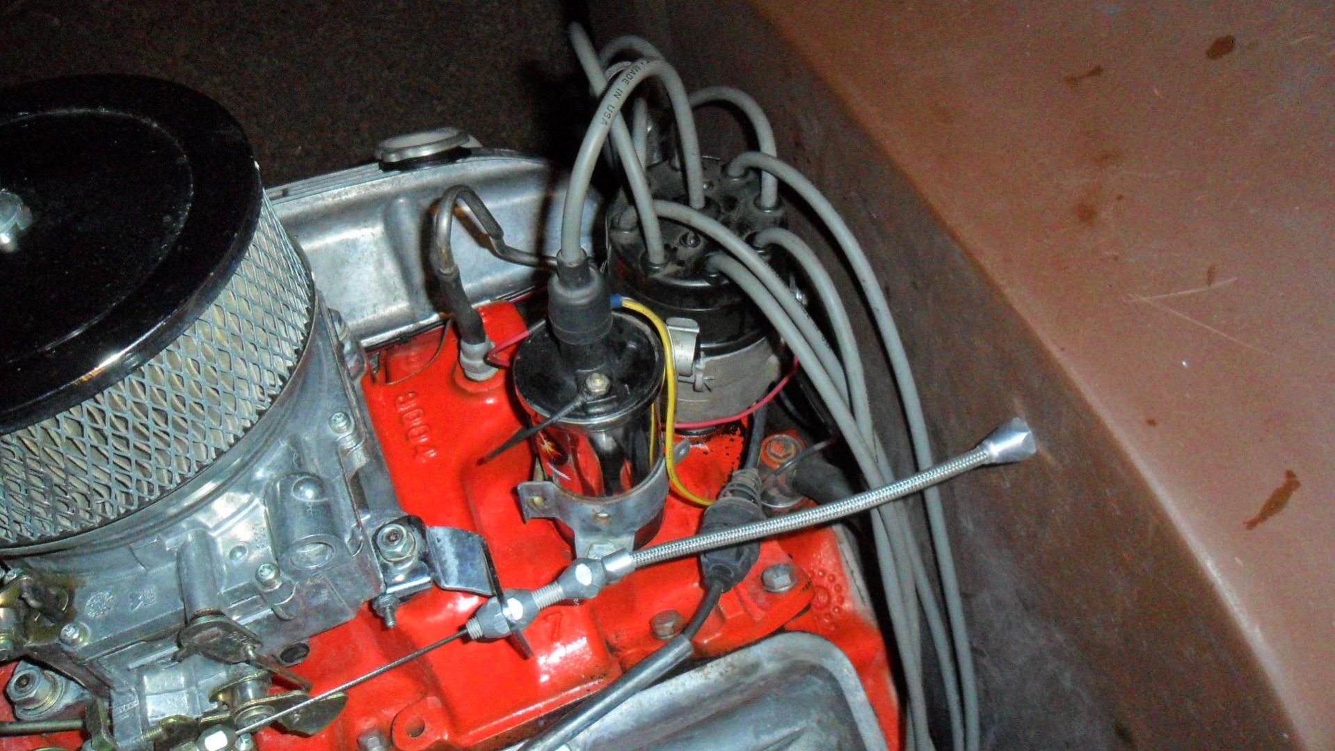

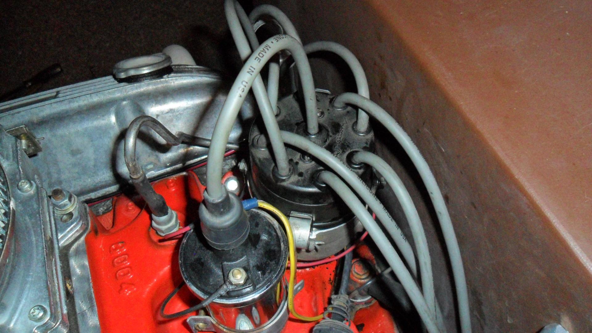

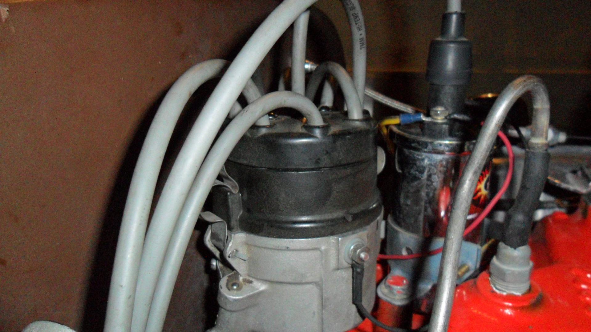

    The other day I took a giant step forward in making the engine bay in the 'Bucket look early sixties. Anybody that knows me knows I have a weird sort of "thing" for old Mallory YC type distributors. I have several in my collection from over the years, and nothing to me screams late fifties or early sixties like one of these at the proper end sending sparkles out to the right places! Oh, gotta have the two piece cap too. GOTTA have that! Not to mention that they were built originally to outlast ANYTHING that they were ever intended to be stuck in, and give a nice tasty happy advance curve for performance duties, too! I submit: It don't get no better than this!
    With all of these around, a good usable YC for a small block Chevy had eluded me for quite some time. Found one earlier this year at one of So-Cal Phoenix's second Saturday get togethers offered by a good friend of mine that swore the Pertronix unit inside was junk. Take it! Was his offer... I can afford free stuff! Now I owe Rick something.
    I checked with Hotroddon here in the H.A.M.B. who works for (or owns, not sure which) Pertronix, and he was kind enough to send me a wiring diagram to check the unit, and to my surprise it checked just fine. I pulled the cap apart to see some corrosion in the base of the cap where the wires insert, and figured that was the culprit. From there it has just sat for the last month or two while Grant's truck has remained on center stage.
    Well, Thursday I had to pull the later, and very happily functioning Mallory/Pertronix unit out of the bucket, as I had promised it to Grant for his truck. Time was made to dump the YC in the 'Bucket, and get things working. A bit more tuning and screwing around with the cap, as my initial "fix" didn't fix the problem, and I'm down the road, looking much more the part! Happiness ensues....
    Quick question to other hapless souls that have played with these distributors. Any body have any luck with reconditioning these caps? My initial attempt included lightly bead blasting each wire socket that was corroded by putting the nozzle of my blaster down in the recess and carefully triggering. Seemed to clean up the ends, but on the inside of the cap I see traces of carbon tracking, probably in response to the resistance caused by the corroded wire out puts. Anybody got a good way of cleaning and sealing that? Good thing I had another clean cap around...

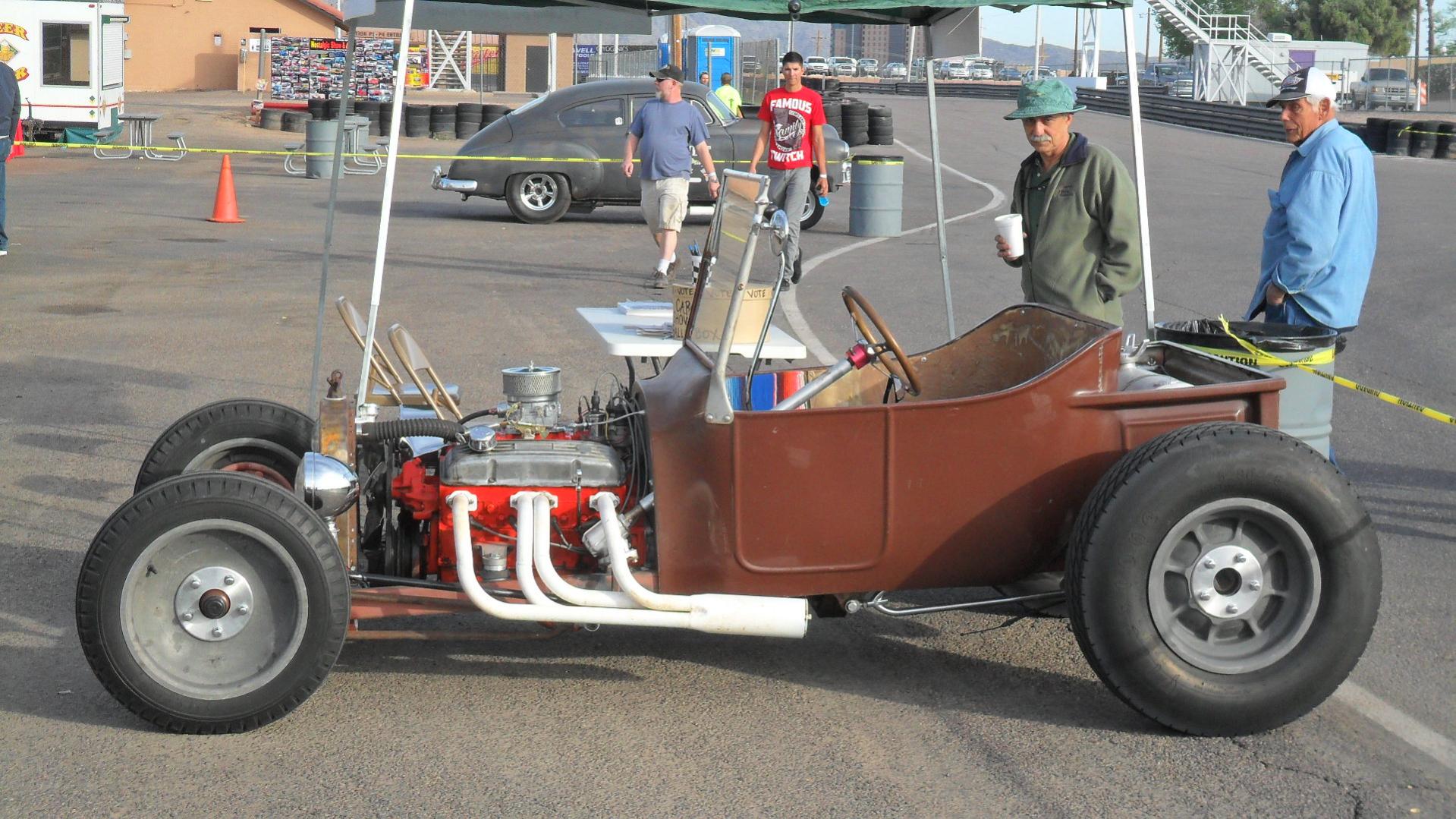

    It was out proudly at what might be the last South West Nostalgia Drags on Saturday coolin' it with a car that has a ton of Arizona history that until 8:30 AM that morning I didn't know still existed... I ran the car show out there, so the 'Bucket was kinda the poster child.
