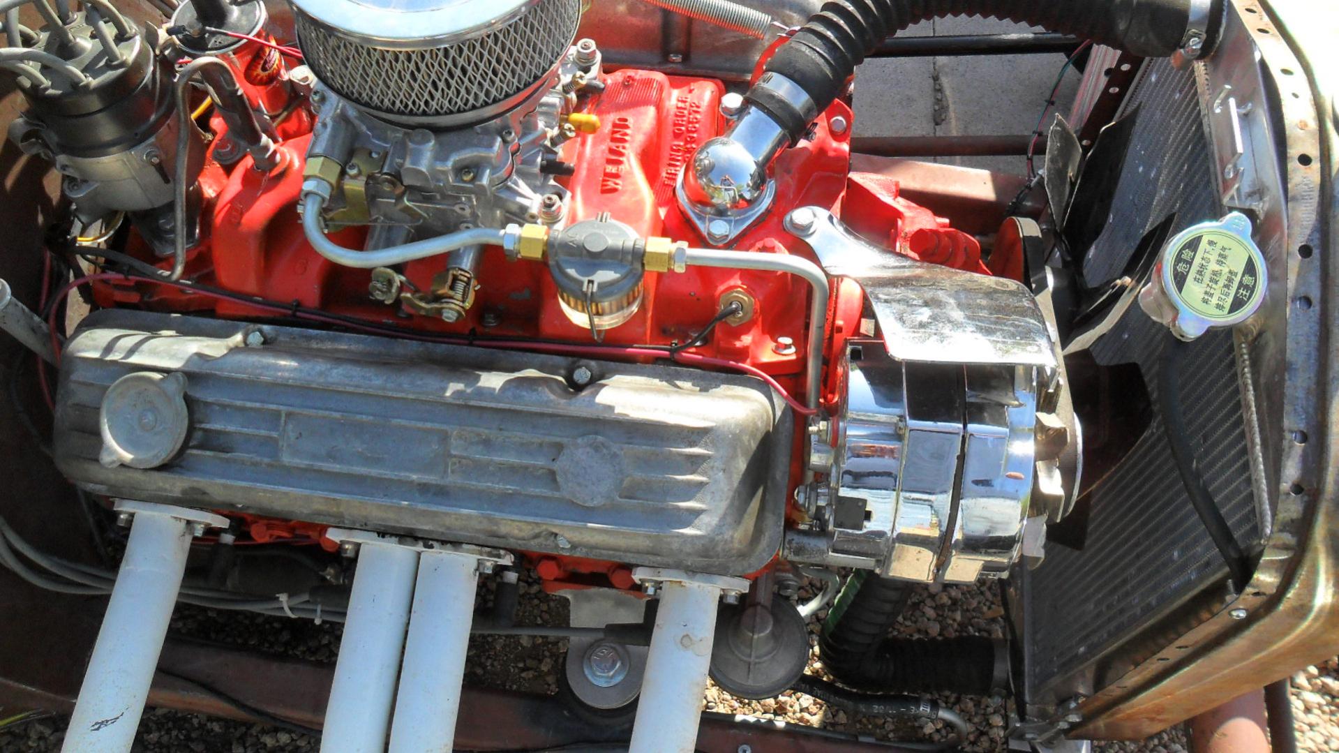

    Just a quick update...
    I didn't share with you guys that my trip home from last weekends South West Nostalgia Drags was damn near shear hell that almost didn't land me home! Fortunately I was being followed home by Tucson H.A.M.B.er and buddy ENFO in his Anglia at the time. I'd pull out of a light soft or hard, and randomly it would just start shutting down cylinders, then magically righting them. Damned frustrating! Especially when I'm being followed by a relatively new friend that has been told I'm a "great tuner"... We got it home, but the pressures of the last ten details of Grant's stuff prevented me from spending too much time sorting stuff out.
    Monday I figured out the new cheapie metal 3/8"-3/8" fuel filter reveled itself as the culprit. Bad news right out of the box! Could no longer stand the floppy rubber hose blowing around in the breeze anyways. It was time for better!
    So, I dusted off a G.M. '50s, '60s gl*** bowl filter given to me by my Buddy John Chambers, and bent the last couple of lines to mate up to what I had already had bent upa couple months ago. The net result is----

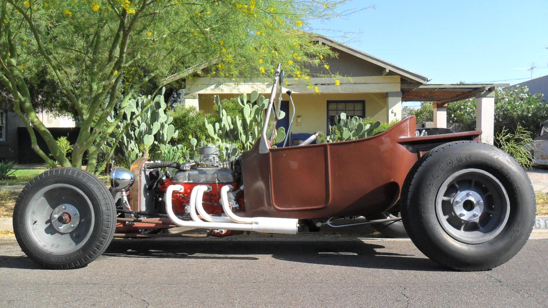

    Chip, I'm sure you covered it somewhere before but what is your wheelbase on the T? It's got a great stance. This is a prime example that a car doesn't have to have the rarest of rare parts, or a $5000 paint job, it's just gotta have the right stance, wheel base , and a decent wheel tire set up helps to lol have you done a before and after comparison pic yet! I'd like to see that since you have been tweaking it for a while now!
  16. need louvers ?
    Joined: Nov 20, 2008
    Posts: 12,901
    need louvers ?
    It's been a month or two, but a friend asked and helped me measure it and I think we came up with 102". Part of the deal on this car that makes it work visually, and also part of what makes a "sixties" car look different than say a seventies "fad T" is where the body is positioned on the ch***is. Look at my car in profile, then look at the rear wheel's centerline. Then look at the bed. The bed is center lined on the axle centerline. That seems to be a common thing on the fifties and early sixties cars, and when I put this one together I did it with that idea.
    Later T-Buckets, as they crossed into "fad car" territory seemed to get the bodies and then drivetrains slid back a good 4-6". I can't really put my finger on when that happened, but even today when you look at a Speedway catalog (for instance), you'll see that is how their cars are built leaving about 3-6" out in front of the grill shell... That to me always looked a bit odd.
    Truth be told, if I had this car to do over again, it would be at least three inches shorter. That would be out from in front of the grill shell and move the radiator back an inch or so. It would "tighten up" the proportions a bunch on this car, but I have resisted doing it this far into things 'cause I know me... It would be domino city!

    I totally agree with ya on that! 96-98 seems to be the golden ticket for the golden era of what I call " CORREC-T's" . But even with yours being around 102" it does not have the exaggerated Pinocchio look that totally kills it! Plus I'm glad to see that I am not the only one who suffers from "DOMINO-itis" . Thanks for keeping up on this thread I hope to get pics of my current project up soon for some proper input! Lol

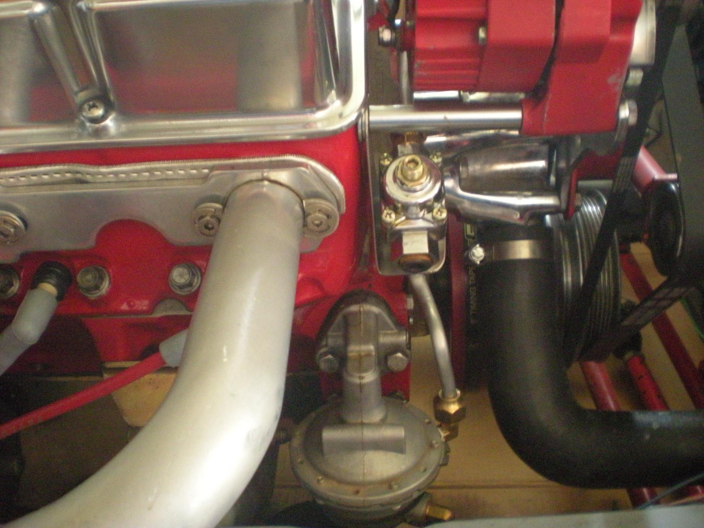

    Here's how I set up my Holley regulator, I like how it turned out. I bent a piece of stainless sheet and drilled holes in the appropriate places to mount it.

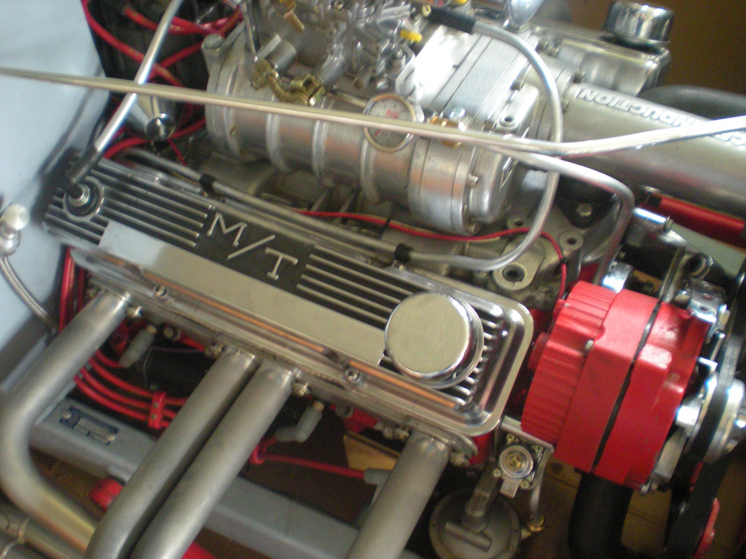

    This is how I set up my Holley pump and Aeromotive (I think) regulator. I searched for a long time for a "Holley style" regulator with one inlet and one outlet with no luck. According to Summit, this Aeromotive regulator has only one inlet and one outlet, so I ordered it (despite the price...ouch!). It shows up and what do you know? Two outlets! Anyway, it ended up on the car. I've since added a pressure gauge on the side of the regulator for easy adjustments. It's not "hidden" by any means, but I don't think it stands out:
