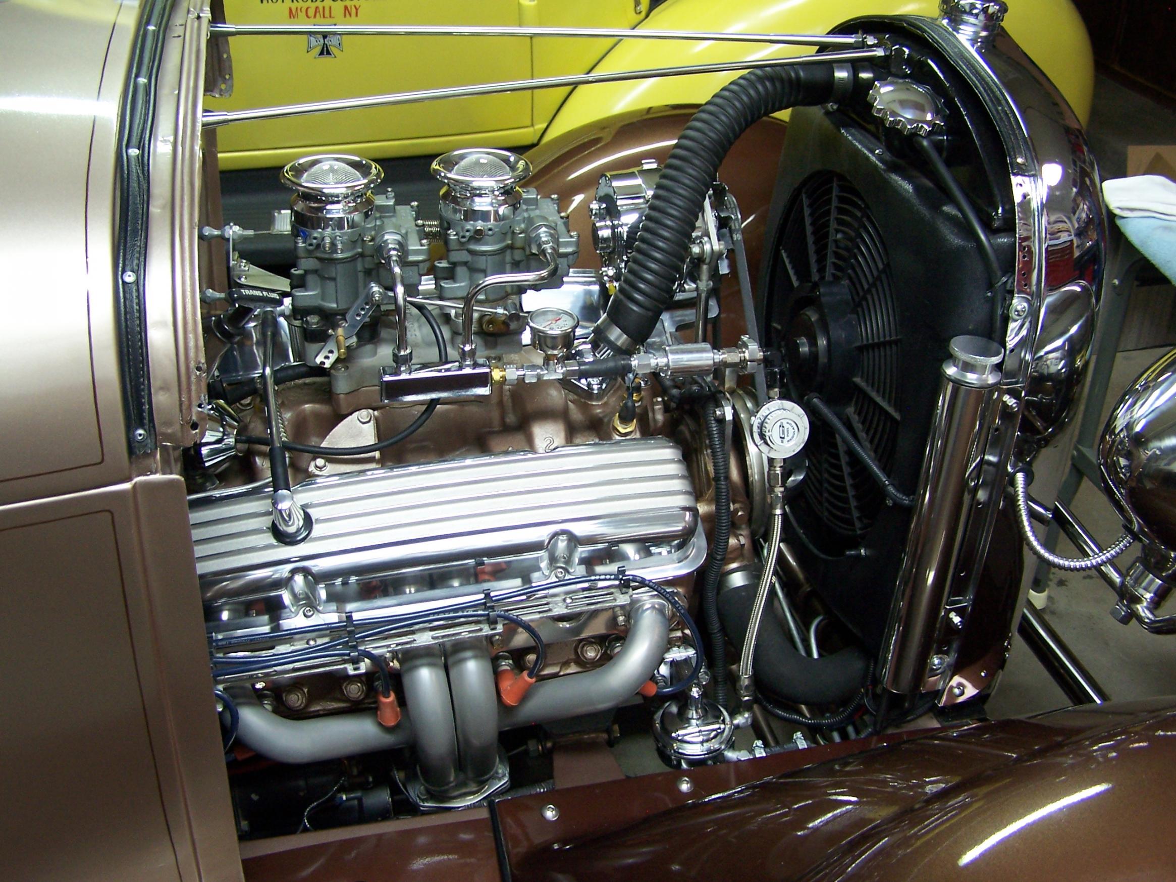

    Here is my set-up with regulator and pressure gauge.

  16. Wow, that is a darn nice looking engine Sir and differently like the twin 2 barrel carby set up.

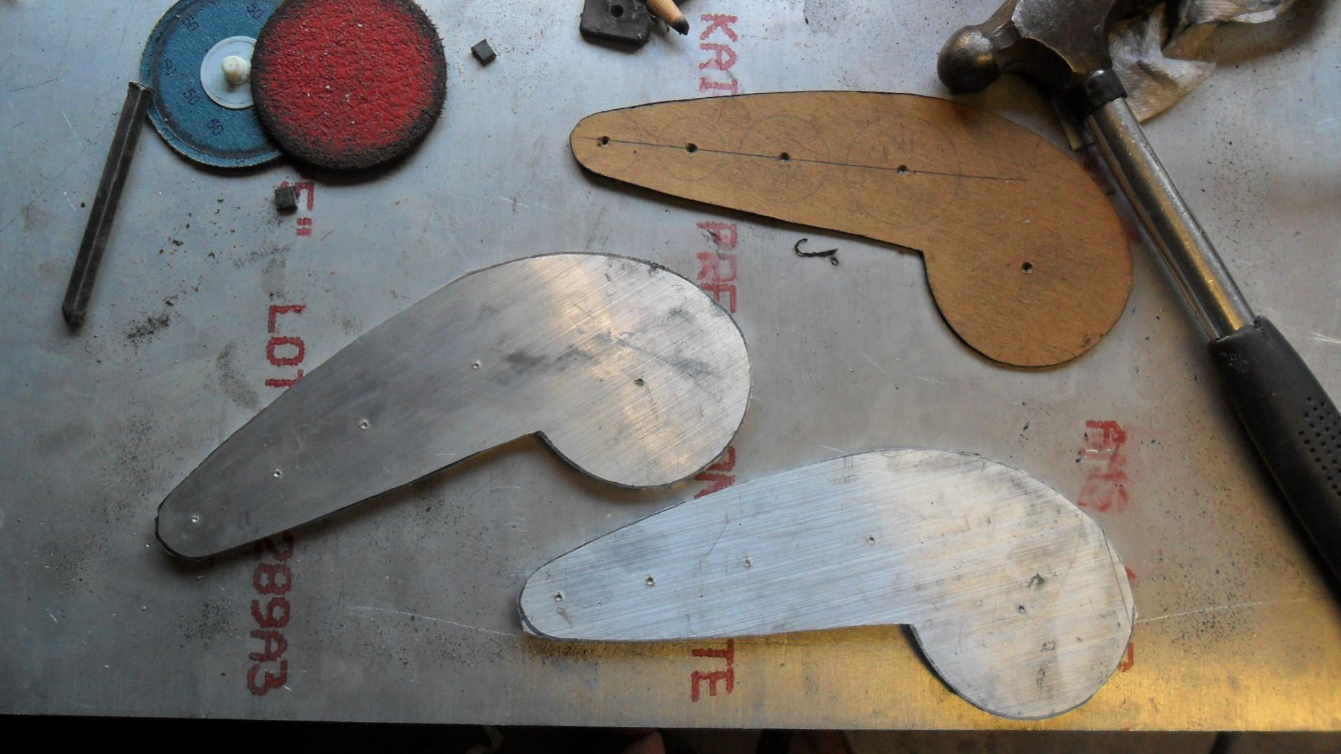

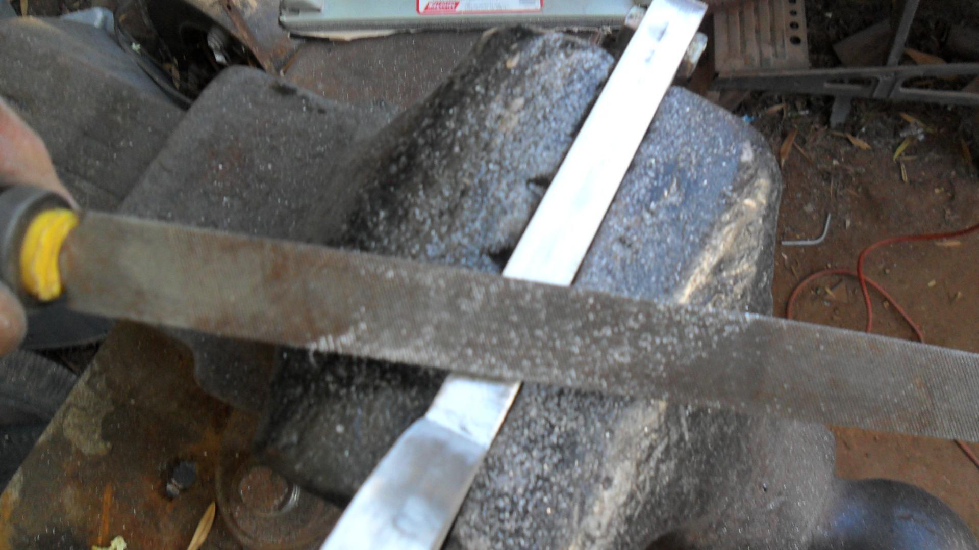

    Had a bit of time today after punching louvers like a madman to work on the 'Bucket a bit. First of all, you guys have to know that my shop almost clipped 100 today... Damn it, spring is almost over! Summer is too long and hot! WAAAAAAAAAAAA!!!
    I've been saying for a bit that I need to make some front shocks for this car. For most of my "small car" builds I have been making a pair of friction shocks now for many years. Always the most time consuming part is cutting out the aluminum arms. That was today's deal. I use 1/4" 6061 for this, 'cause it is of high tensile strength, and it polishes up better than softer aluminum ever could. The harder material resists wear around the tension stud, too.

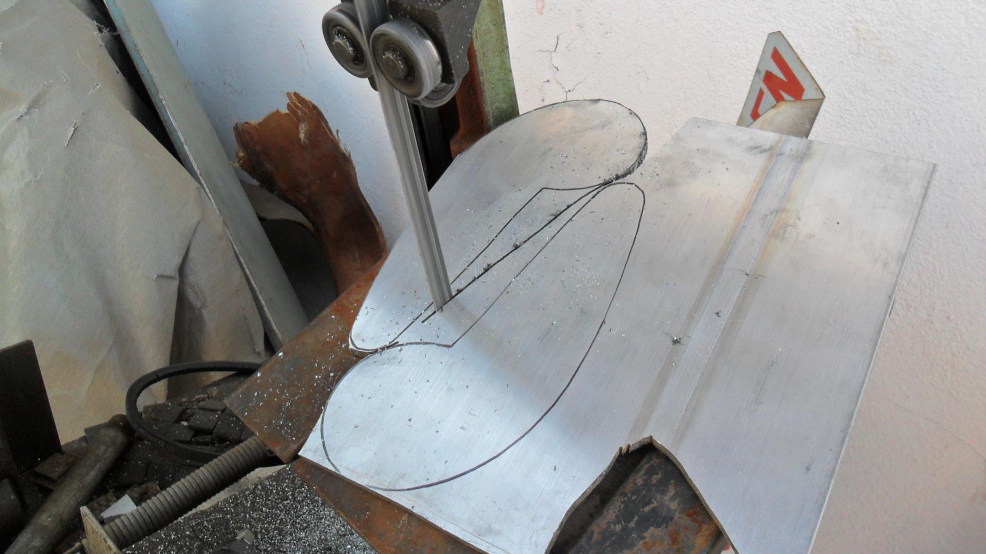

    So, grabbing a cast off chunk that actually came on a mini bike frame, I grabbed my "overhand" pattern and did some fine tracing. ( I should have shown my other tracing fine art from the other night, when Judy asked me for tracing of my hand so she could order gloves... It came out as a turkey, and is now hanging on our fridge. Who says a woman needs to have kids... Forgot a picture of that one!)
    After tracing, I adjourned to my band saw and happily started cutting stuff out that kinda looked like shock arms. One thing that my patterns always incorporate is punch positions for any holes that need to be drilled. Dutifully I punched these back when I did my tracing. After the arms were two and kinda looked like they were supposed to, it was time to make them the same...

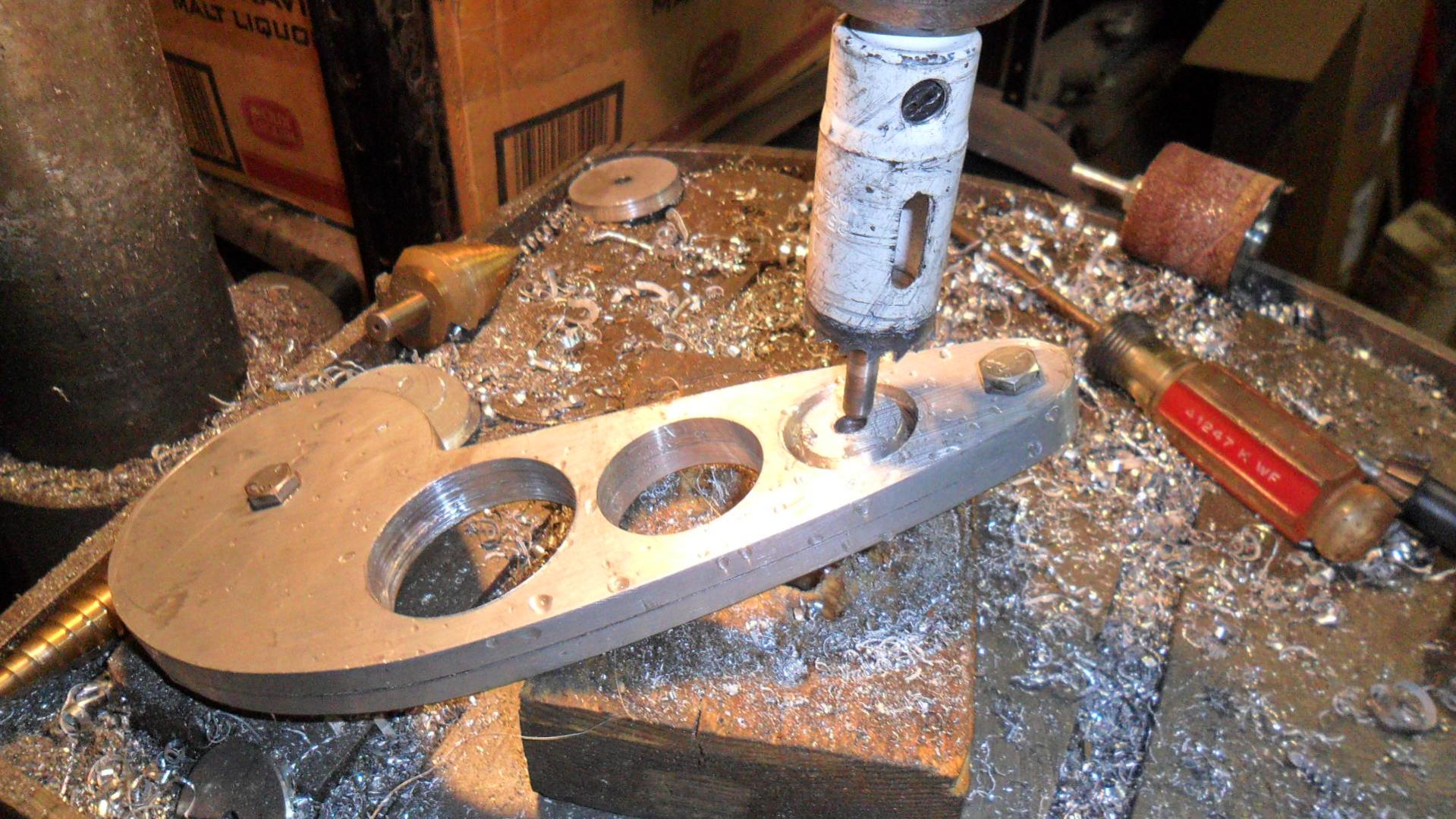

    Holes were drilled on the punch marks, and the two arms were then bolted together. This way I could clamp them in my 100 year old vise and breakout the course disc (36 grit) and 4 1/2" grinder. After a very short time, they matched! But wait, there is more!
    So, once they were roughly the same shape, I chucked my 50 grit 1 1/2" sanding drum into my drill press, and turned up the wick a bit to about 3000 rpm. Using a small block of wood to raise the work piece up, I proceeded to run around the outer dimensions of the arms and smoothed the whole deal down. Something I learned years ago about working with aluminum; when you make the scratches of sanding run the length of the cut edge (instead of across the edge), they always look finer and more "finished", hence using the sanding drum the finish the rough out phase. Next the arms went back out to the vise and the 100 grit and soft block came out. After a couple of laps with that, it was time to hit a couple of rough spots with the file, and a bit more soft block.
    Now, if you remember my short tutorial on polishing aluminum months ago, you'll notice that just like polishing, I have started course and gradually worked up to finer sanding mediums. A few more grits and it'll finish polish with mag wheel polish!
    Next up, hot rods need holes! So ya, we'll drill some here! The biggie is 1 3/4", the medium is 1 3/8", and the smallest is 1". The biggie and the smallest were both drilled with hole saws, and the drill press slowed WAY back down to about 200 RPM. The medium holes were drilled with step drill that just happened to be 1 3/8" total diameter. If you don't have a set of step drills yet, STOP! STOP reading this, get in the car, and go to Harbor freight and get a set for like 8.95! There is a Harbor Freight open somewhere right now, I promise!!!
    So, here is where we are at. Two shock arms that match each other! It only took 2 1/2 hours to get them there, too! All with no exotic tools. Hell, I felt down right luxurious using my hand-me-down band saw for this deal, as I usually use my cheapie jig saw for this kinda deal! Still the best 19.95 I have aver spent!

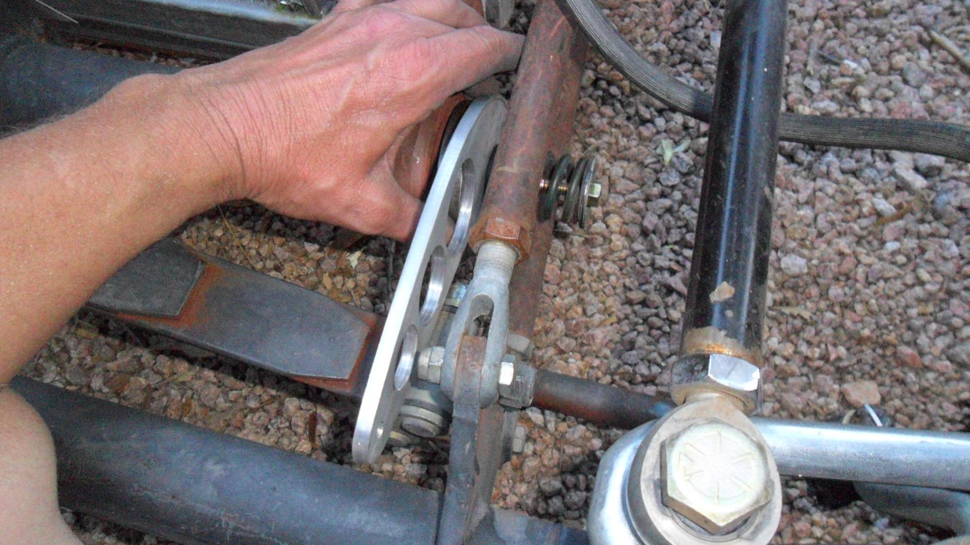

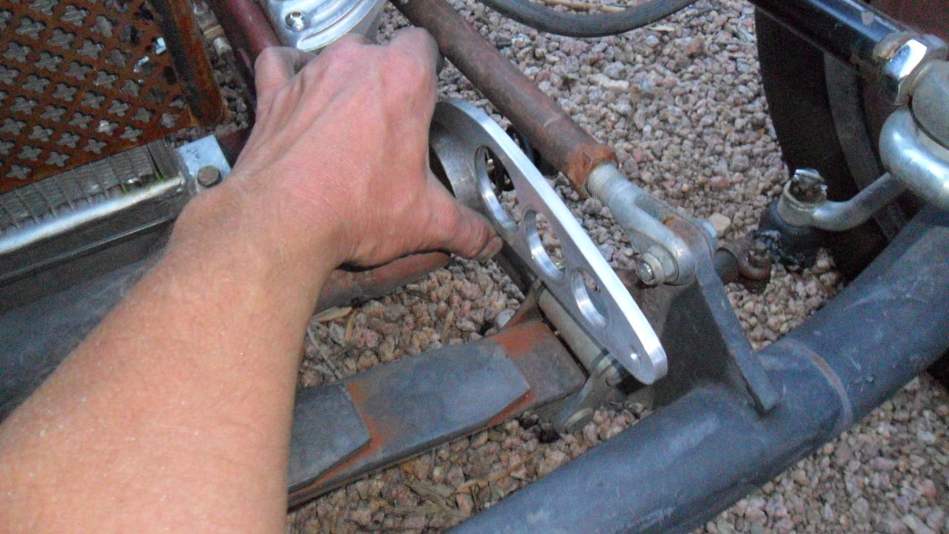

    So, to give you an idea of how this works and fits, here's the deal... The bases are 3"X 1/2" round stock that is sold locally by I.M.S. that I center drilled and counter sunk for a 3/8" counter sunk allen bolt that will get welded to the inside. The friction part is a Dodge 318 valve spring and by the time these get mounted on the car, retained too. Right now I just have the whole deal mocked up with a 5/16" bolt and shock washer so I could show you what it would look like. There will also be a 1/8" aluminum pressure plate in there and two 3" pieces of rubber or leather to create the actual friction. Small tabs will get welded to the axle and 5/16" Heim joints tie it all together.
    All in all, it's a very simple shock system that has it's roots back in the race cars of the twenties and thirties, and carried through to the late fifties and early sixties as drag car and T-Bucket stuff from the likes of Moon, Dragmaster, and Ch***is Research... And they look *****in'!
