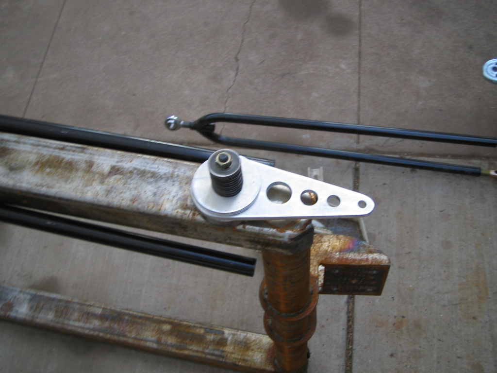

    Very familiar! Matter of fact, a pair of MG Midget rears are going on the front of the full fendered touring project we were talking about this morning.
    On a T-Bucket though, and again, MY OPINION, they are just a bit incongruous and kinda clunky looking. I'm sure they would work well though.

    On tube shocks. I run Pete and Jakes tube shocks. They work great. My car weighs 2308 lbs full of fuel. 18 Gallons. I run the long ones in front and the short ones in back

    It's funny Fuzzy, In my experience the tube shocks work absolutely spantacularily at the weight of the typical Hiboy "A" or Deuce. That 2200-2700 lbs range they all seem to end up in. When you go down the scale and into the 1500-1900 weight range, (and my car tips at 1720) they seem to me to get a bit over powering. I have for many years run a top quality VW link pin type shock in that situation which is valved just a hair lighter than the Pete and Jakes stuff that I have also used in similar situations.
    But truth be told, I really don't like the look of tube shocks on a T-Bucket front end. They just always seem to stick out being so vertical and usually chrome. I really like the low profile of the frictions tucked close to the end of the frame rails and down out of sight. Maybe this comes from my obsession with early sixties dragsters when Scotty Fenn was putting some damned ***y levers on his stuff, or maybe my minor obsession with vintage circle track cars has done the deed. Not sure. But if you flip through the old magazines of the time period I'm shooting for, you do see them fairly frequently.

    Given the weight distribution of a T-bucket there may not be enough weight on the front suspension to "work" a normal p***enger car shock absorber, thus causing it to ride like a log wagon. Unless, of course, as some have mentioned, the shock was worn out - but this would lessen the amount of jounce and rebound control it could provide.
    Most p***enger car shocks provide more damping on rebound than on compression, and this may or may not be best for a lightweight rod. My guess is that this characteristic might cause some really spooky handling on rough surfaces in a T-bucket.
    I admit that I do not know the jounce/rebound ratio of the various hot rod application front shocks by manufacturer, but that would be my first question to ask before I stepped up and bought them for any application. There's a lot more to shock absorber technology than compressed length, extended length and end style.
    One must also consider the angle at which shocks are installed, as was mentioned here earlier. The angle has a huge effect on the amount of damping provided in both directions. A shock loses 50% of its ability to dampen suspension movement when it is installed at a 45-degree angle as opposed to being installed straight up and down. The greater the angle, the less able the shock to do its job.
    Friction shocks such as those Chip is making are by nature 50/50 - providing equal damping on both compression and rebound. It wasn't until the mid-'50s that NASCAR and road race builder/drivers discovered the benefits of 50/50 shocks in some compe***ion cir***stances where roads were neither straight nor smooth but where suspension control at high speed was crucial to both performance and safety.
    The beauty of friction shocks is that they infinitely adjustable to suit both the car and the driving conditions. Not only is the amount of friction adjustable by virtue of the materials used and the clamping pressure applied at the center pivot, but also by the length of the arm in terms of applied leverage.
    I'm glad to see someone working with friction shocks as an alternative to tube shocks in lightly loaded applications. Seems to me like Chip is on the right track.

    Got to admit, your response made walk out back to the "island of misfit Hondas" and pick up a front shock unit from a sixties Honda C90... You would know it if ya saw it 'cause it's the one they always show in videos of Asian countries with an entire family and ten pigs aboard, and the kid with a scooped out water mellon for a helmet on the handle bars. I got one for Judy.... She was "thrilled".
    Any way, this is a nice little coil over type deal that the coil can be removed from. It would probably work pretty dam well if I wasn't so whacked on getting my friction shocks together.
