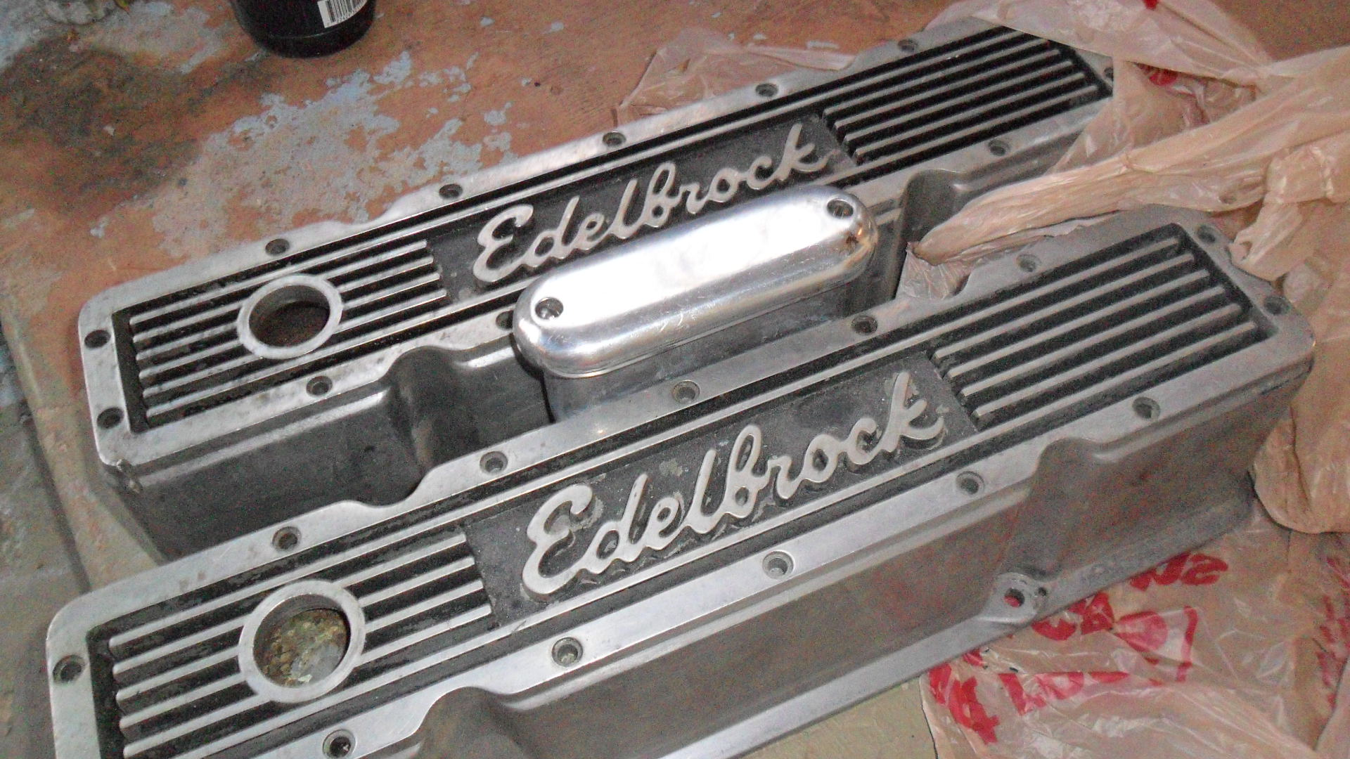

    Well, ya, one! It's a uni-Vette for tonight until tomorrow! I had to go out and get a 1/2 Phenolic spacer to control fuel boil anyway and today was the first chance I had to do as such. Tomorrow "endlessearth's" truck gets it's tach, and the bucket gets it's spacer and it's second Corvette Valve cover and offy breather thanks to your keen eyes.
    Just so everybody is up to speed about what Nitrobrother and I are yammering about, My sole purchase at L.A.R.S. was a pair of the ugliest late eighties spec Edelbrock valve covers for 35.00. They were so heinous I didn't notice the Offenhauser 90 degree 5 1/2" breathers hanging off of them that I had been hunting for since last fall! Andy pointed 'em out to me!

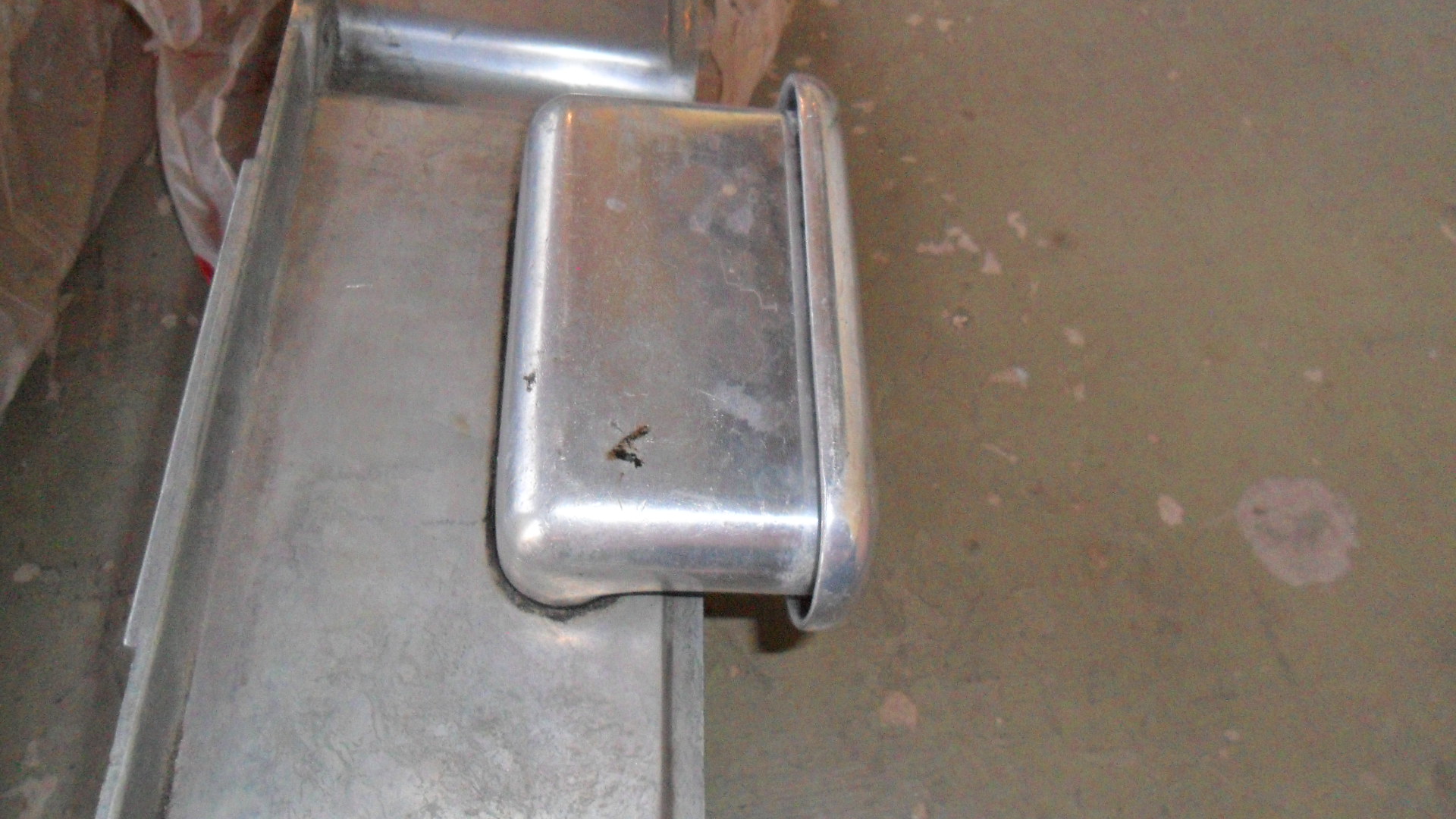

    I warn you, the next picture might just cause you to loose sleep... Be ***ured that the valve covers them selves have already been committed to s**** where they will never have a chance at darkening another small block Chevy! And, yes there are two breathers. I just got in such a hurry to get them free of the ugly valve covers that I forgot to shoot them before taking them apart. I only had the heart and stomach to mock one back up! SAM_6359.JPG SAM_6361.JPG

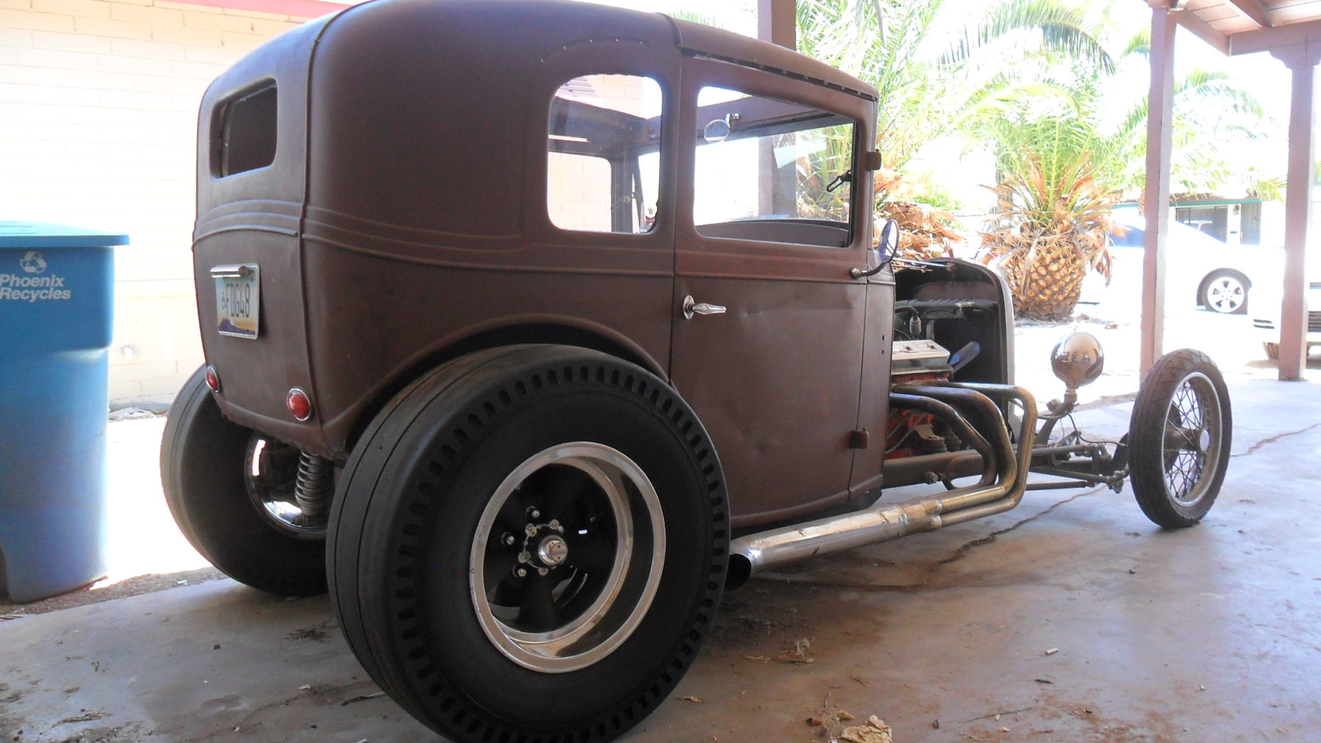

    SAM_6363.JPG Now, a quick bit of other business.... Anybody remember when I posted a gathering of a couple of friends car's on my street this spring? The little Bantam that some one cut out of the picture and said would be *****in' if it had the right tires and wheels? Ring any bells?
    Well, Roy finally let me loose on ordering tires and finding wheels! Vintage Fenton "Hustler IIIs" and Towel City radial recap in 10x29.5 to the rescue!!! See, this was my evil plan all along! Now I'm working on him for a pair of Rebel Wheel co.'s Halibrand spindle mount look alikes...

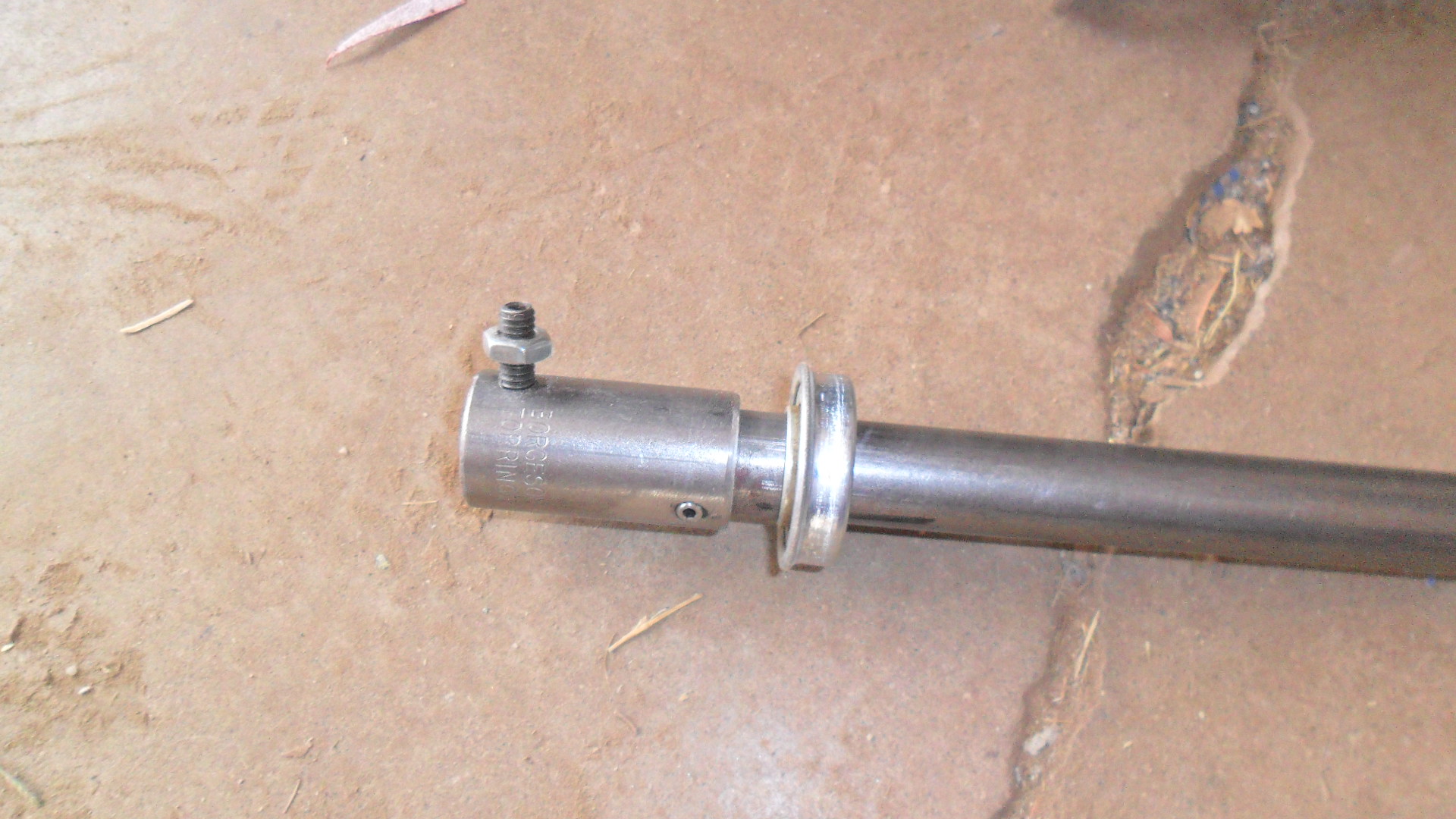

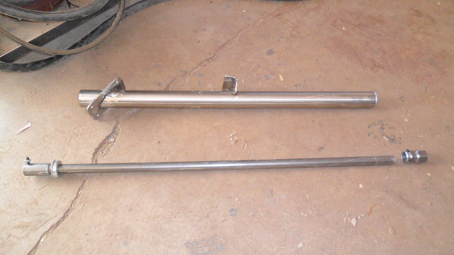

    Blownfuel, earlier you asked about steering columns for these. I just finished Roy's today for the gl*** touring. This time around we went stainless steel, and please keep in mind it hasn't been fully ground out yet.
    I make them from 1 1/2" exhaust tubing most frequently, then trundle my **** down to Ace hardware or Az Bearing Belt and Chain and pick up 8.00 worth of bearings. The shaft is a chunk of 3/4" cold rolled, the lower is a 21.00 Flaming River Corvair coupler, and the upper is a Wilwood 25.00 quick release for the steering wheel that gets roll pinned and set screwed (with sh SAM_6370.JPG allow detents drilled in the shaft for security) in place so that it can be removed for service. This one will get a bit of presentational grinding from me, then get down to Fernando's metal polishing for shine...
