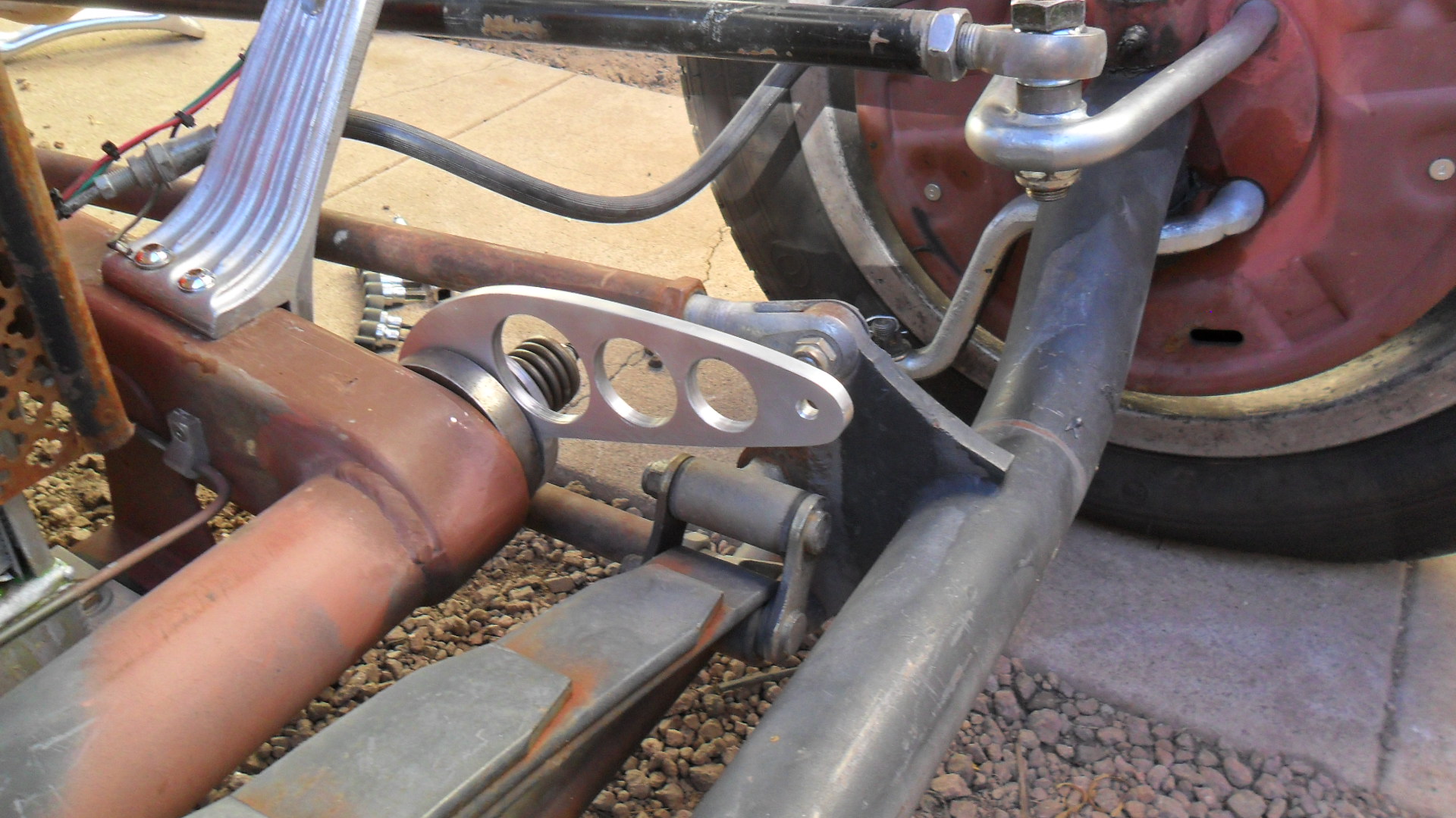

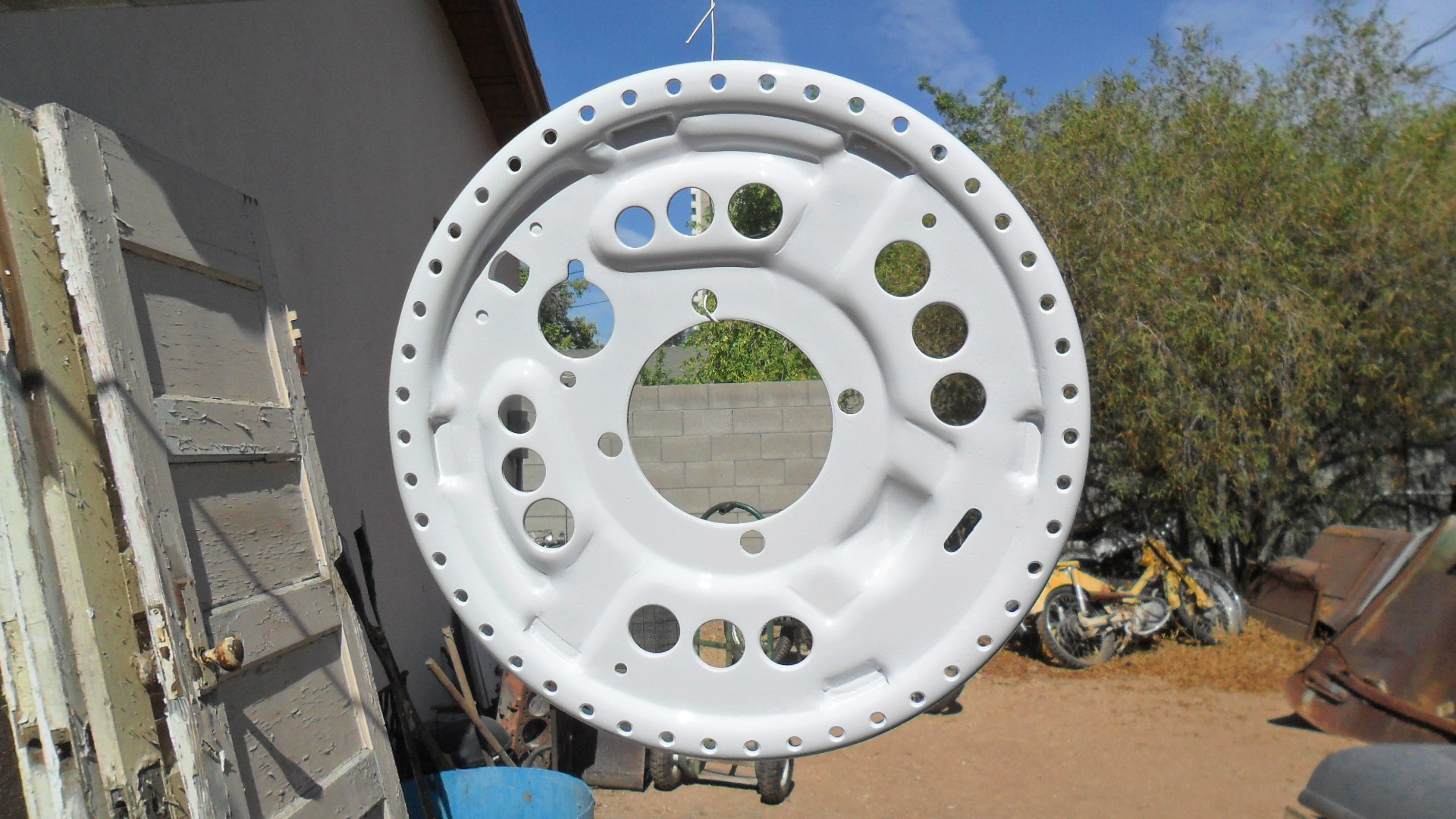

    Well, my 18 year old ****apoo, Mr. Heihei Chan decided that he needed to go out at least twenty four times I can remember last night. Being that he can't get back up the stairs by himself, and that Judy sleeps the sleep of death, I had allot of time to think. Sometime about three A.M. or so, (second or third showing of Squidbillies on Adult Swim) I had an idea about how to mount my shock arms without pulling the whole front end apart! Then it was just trying to sleep enough have the energy to do it first thing! Out at five, it was only about 90 this morning, so I decided to paint the one backing plate I have prepped, too before the heat of the day set in.
    I kid you guys not, if you haven't used RustOleum's Appliance Epoxy for small stuff you are seriously missing the boat! This stuff comes out nice and thick, then lays down and fills in very nicely. It looks like very high quality powder coat when all is said and done. It does take a few days to truly cure, though. But after that it's rock hard and close to indestructible. Color sands and buffs nicely too. I have a pair of fifteen inch early Ford wheels that I sprayed with this stuff about ten years ago, ran for about a year, then dismounted and kinda put in the wheel pile. Although the outer rims have some abrasions, they have retained their shine and aren't nicked up enough that I wouldn't put them on some thing I care about. Hell, one of the four I harvested the center from for some widened rears, and it took a couple of hours in the blast cabinet to clean the paint off. All that for 3.97 a can at Home Depot!
    The reason for that little out burst is that I'm going to do the front brake backing plates for now and torture test them. If it works out well, I might actually paint the suspension components with this paint... We'll see on that though.
    The trick to get the arms on consisted of two minutes of grinding on the bottom of the arms, a bit of finagling with a jack, and holding my tongue with my teeth in just the right position to make it all work. Now on to tabs and Heim joints to do the deed.

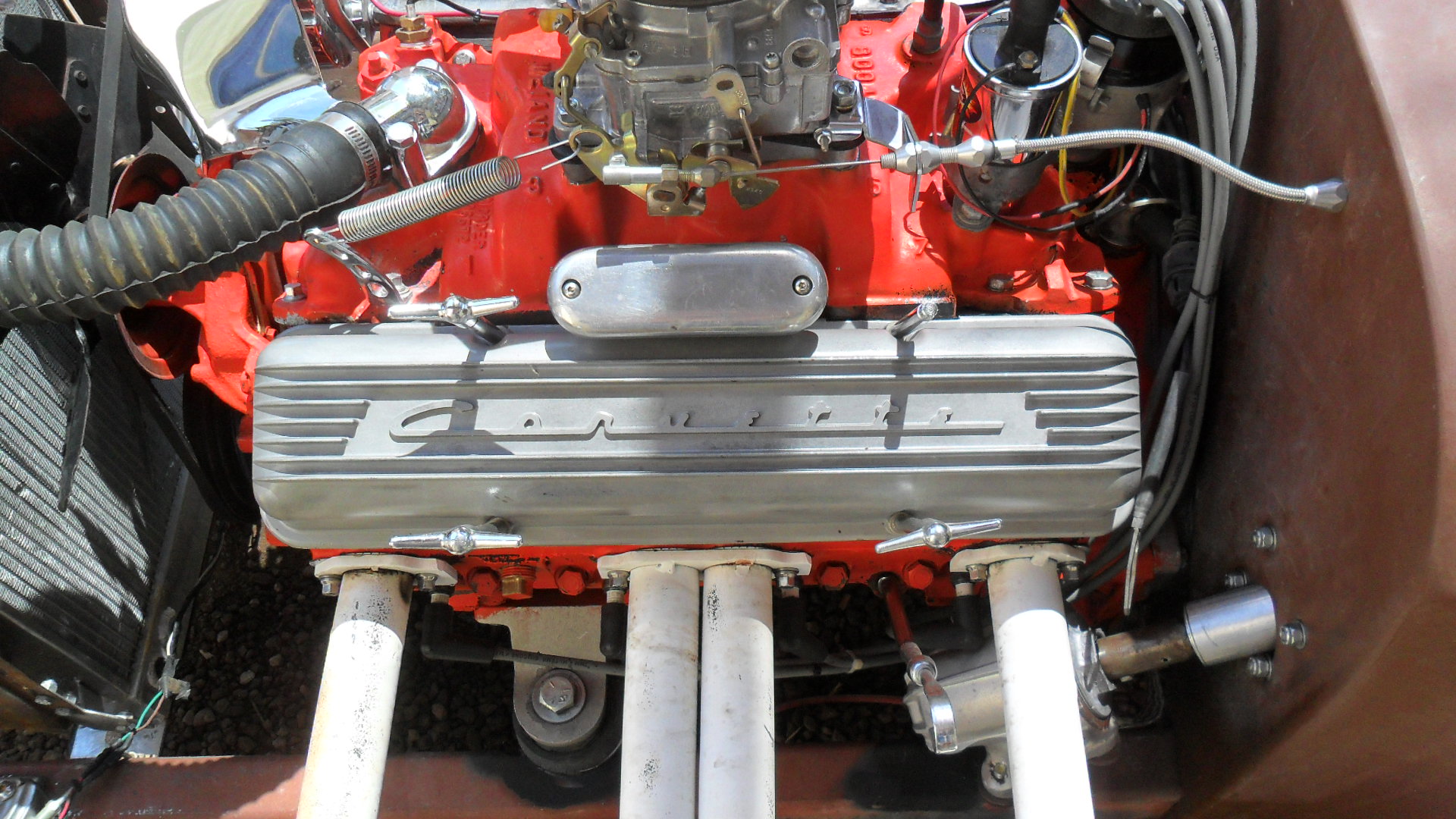

    Oh, got one of my Corvette valve covers and cheapie breathers on too! the other side is forthcoming soon SAM_6426.JPG SAM_6427.JPG SAM_6418.JPG SAM_6431.JPG

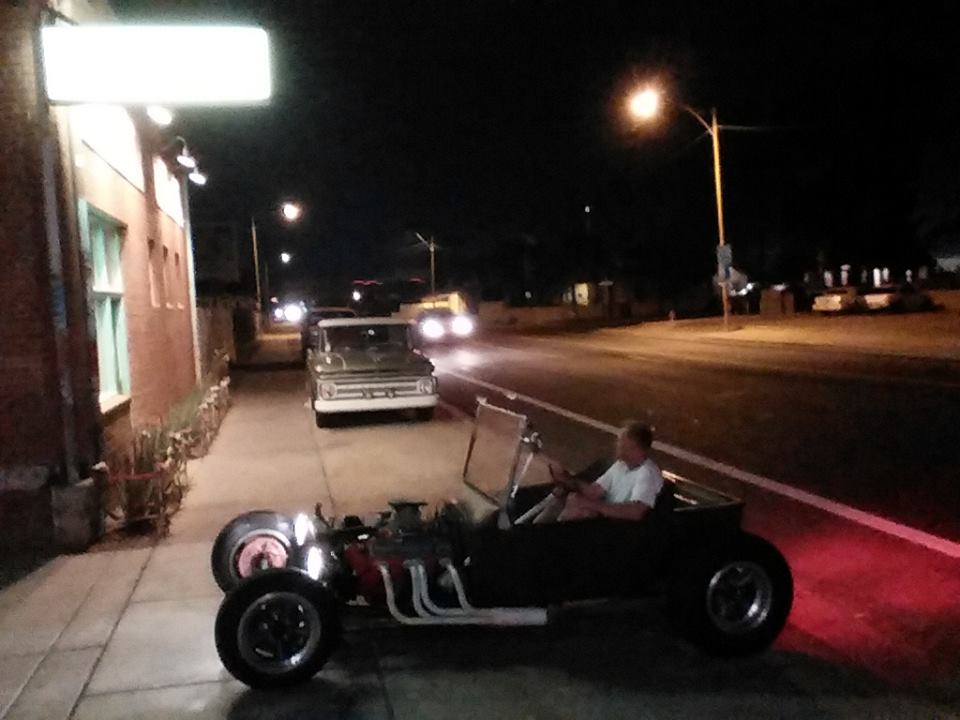

    Damn, new favorite picture alert! H.A.M.B.er Bodi and I stopped at a favorite dive bar this evening for drink after some damned good pizza at a new place down the street in this still somewhat "dodgy" part of Phoenix... This is a little Tiki bar called the Bikini that has been in it's turn of the last century building UNCHANGED since the mid fifties. Ten years ago, ElPolacko and I used to occasionally kinda push the career drunks aside at the bar long enough to have a drink (gin and tonic, if you must ask...) at this then crumbling ins***ution. It was purchased by a fellow hot rodder locally and now is breathing comfortably again... A beer tonight was a must to celebrate Bodi's seasonal migration north in a couple of days (Check out last years thread "The ****er Knife of Patriotism Tour, for a fun read). Bodi snapped this *****in' "City Nocturne" shot as I left.... You can almost feel the 100 degree evening temp in this shot. bodi and me at the bikini.jpg
    God, I love my friends! My city too...

    That IS a GREAT shot. I was just thinking when I picked the wife up tonight, perfect night for an open car.

    In my old and grizzled opinion, there's an element of the "stance" concept that is almost never addressed: what the car looks like with the driver/p***enger in it.
    A lotta times the car (this applies to motorcycles as well) looks like pure art all by itself, but looks well beyond awkward when the driver is added to the mix. It's a variation on the "why-do-really-fat-chicks-always-drive-iddy-biddy-cars" concept...if ya' know what I mean.
    Closed cars are just as likely to suffer from this syndrome, but open cars seem to be even more so. Perhaps it's because the driver is right out there for everybody to see - and that's often the problem. T-buckets seem to be the worst - probably because of the raised seating which almost everybody adds to make 'em more comfortable - but "east coast-style" channeled roadsters of the A & B variety are all too often guilty as well.
    Chip has addressed this before in this thread, but it's refreshing to see a bucket that's fitted well to the owner's presence, not to his absense. Chip's car looks "right" with a driver aboard, a fact which underscores his plan to add minimal padding to the ****ox area and backrest. Harder on the glutius maximus but much, much better for the visual balance.
    Good eye, Chip, good eye.
