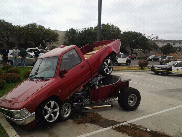

  1. Not to sure what happened here, but
    a) It's amazing how well the T held up (looks like the T's driver probably walked away, but I haven't been able to locate any other details )
    and b) Things can go wrong in a hurry! Be careful out there guys!

    Power parking at a car show?

    boy, I know there are some mini truck haters on the HAMB, but thats going a little too far!

    Eh...... just brush yourself off, get a lawyer and make it better the second time.
    Got hit by a City of Houston police car. The cop failed to yield on a right turn green light. Hit me doing about 35 MPH. No seat belts, but the steering wheel kept me inside.:eek: It took almost a year to be fully compensated.
    Even though it was the cops fault, the city wanted to low ball the cost of repairs. I p*** that intersection about once a month and just smile.
    The settlement allowed me to build my car as I originally planned. Looking back, the accident was the best thing to happen to my car.

    Blessing in disguise. Your bucket has such a better look now.

    Theres something about getting your t bucket rebuilt at the expense of the local cops that REALLY appeals to me...:D
