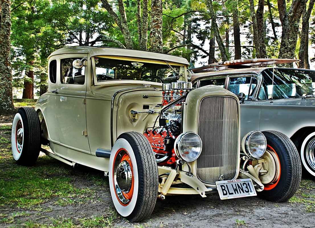

  5. Wow, Mr Falcon George, first thing in the morning for me over here and with my brain still in neutral I have a headache trying to understand what you wrote, but, yeah but, they look darn good aye ? o_O:);). Will see if I have another photo of the car Chip. 8671524236_ac37d0d367_o.jpg

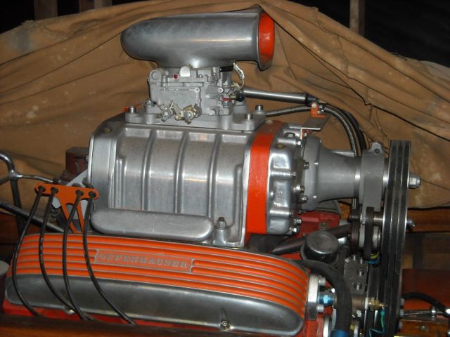

  7. It's a Weiand blower in this photo but sorry it doesn't show much. I do have a better photo of it somewhere so will try and find it.

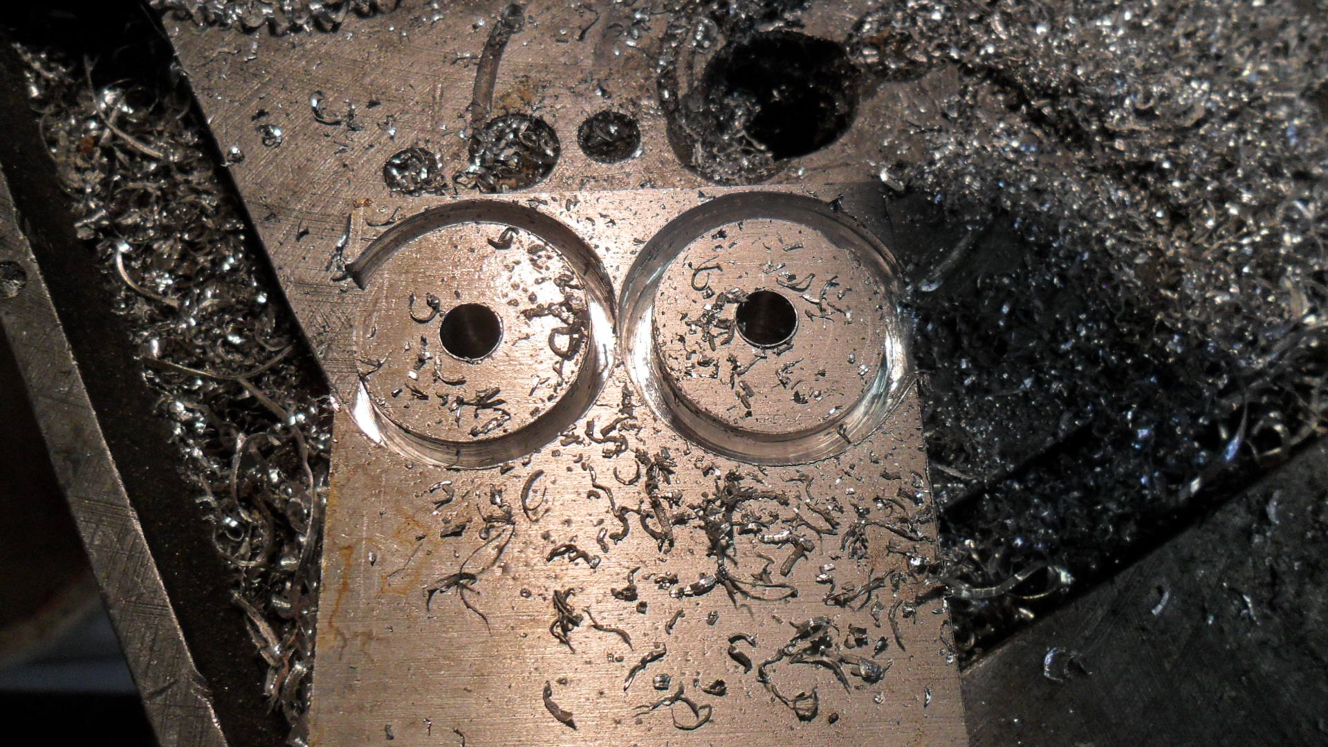

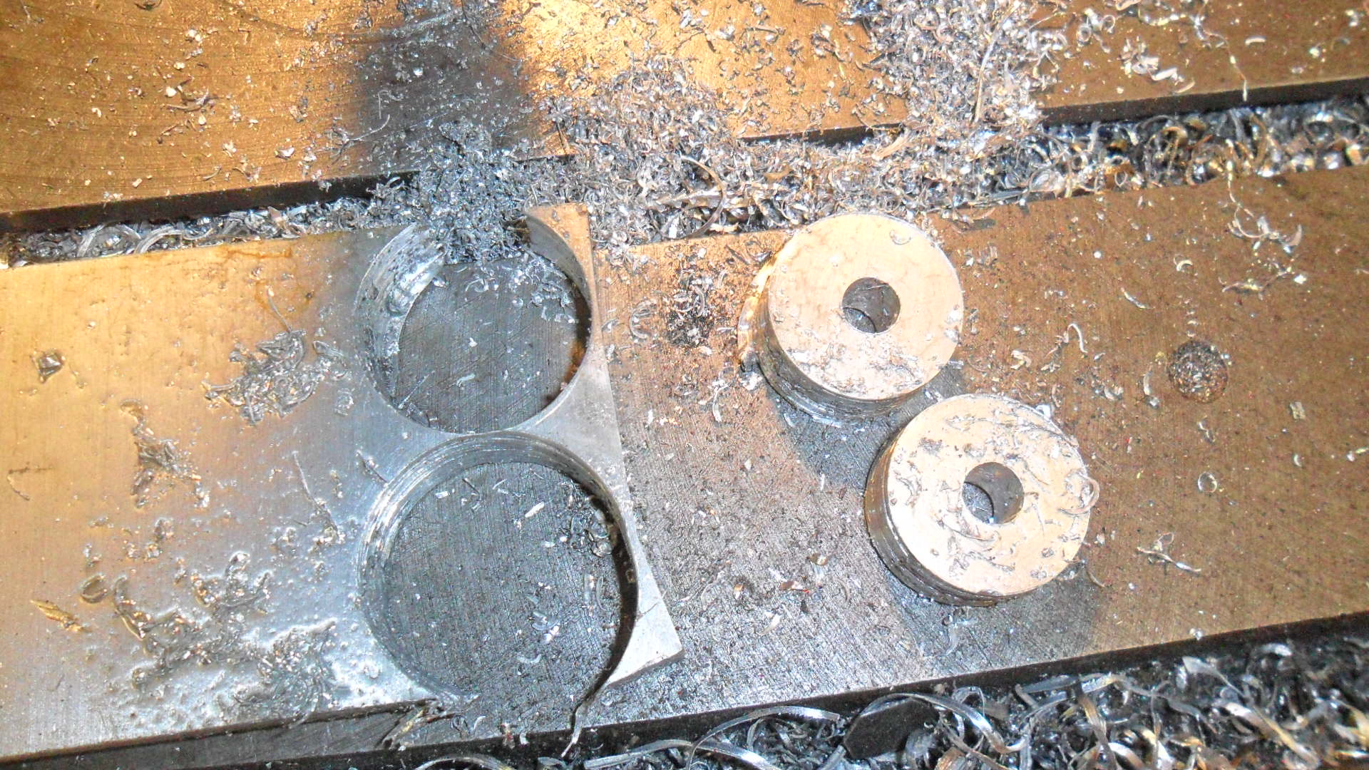

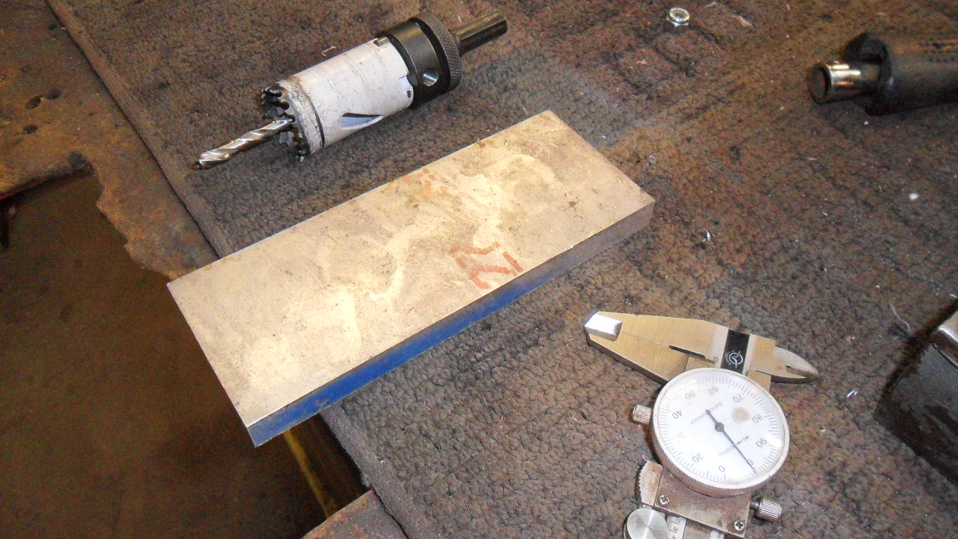

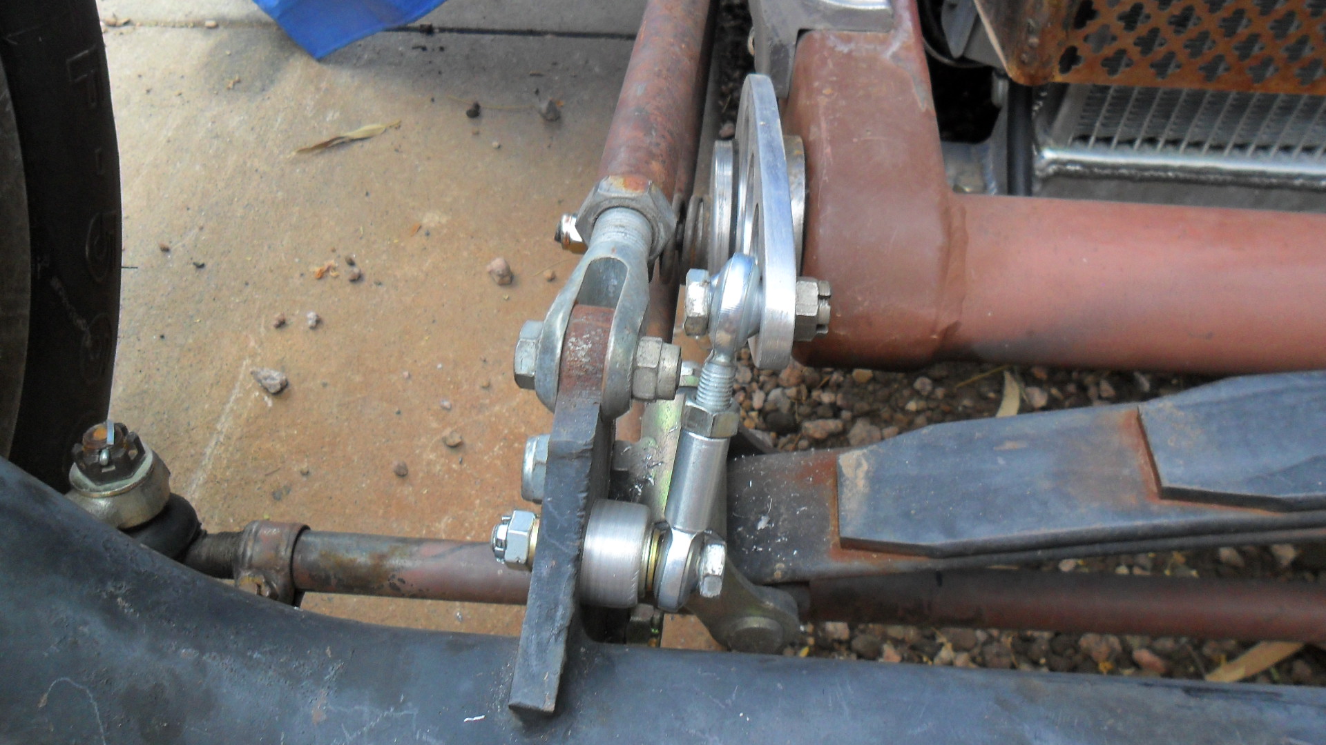

    Okay, so I got more done today! Woke up early and got out in the shop and worked a bit unimpeded by the need to do customer stuff for once! Last night as I was dropping off to sleep I came up with an idea of how to go about hooking up the lever shocks with out resorting to kinda tacky weld on brackets. Not that the brackets would have been too bad to look at, but to make the welds look nice, and to do a good job of grinding to detail the welds I would have to pull the front end off of the car, and that something I just don't have time to deal with right now. So, in the pictures you'll see what I came up with. to do this I needed a couple of turned spacers. Now, I have a very nice lathe. It has no 220 volt service to power it, but damn it's cool! So that would be of little help today. I went with "plan B", or is it "C" at this point?
    Basically, I'll make my bushings with a cast off piece of 5/8" aluminum stock, an 1 1/4" hole saw, a 5/16" drill, and 4 1/2" angle grinder, and a bench grinder.... Oh, and about 1/2hour of ****in' around time! The photos should be somewhat self explanatory, other wise ask and I'll explain. SAM_6480.JPG SAM_6486.JPG SAM_6490.JPG

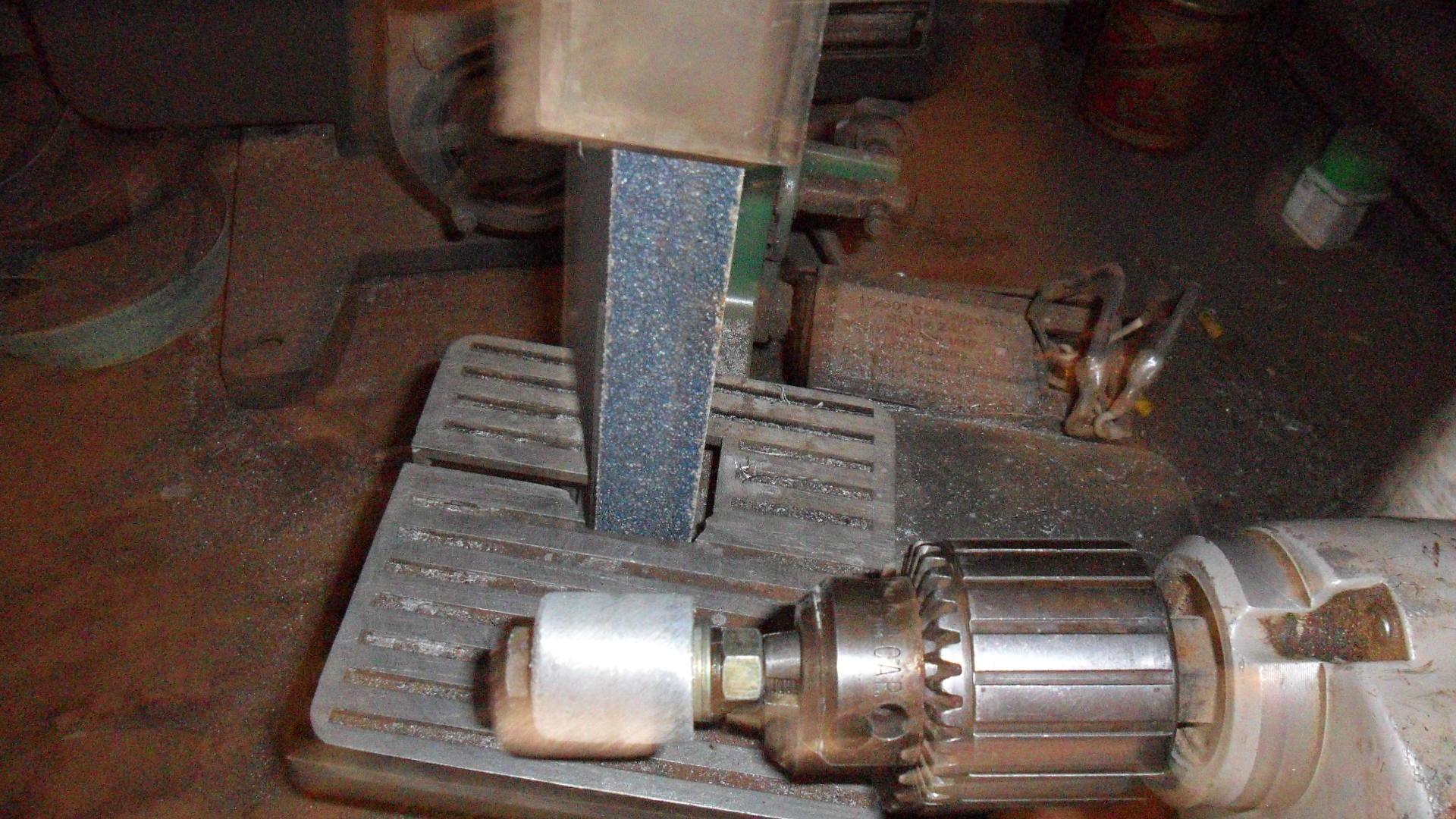

    SAM_6492.JPG I threaded the two blanks on to a 5/16" bolt and locked them down with a lock washer, and chucked them in the drill press. speed it up and turn on the small angle grinder and for the love of God, wear safety gl***es! I followed that with chucking them in a hand drill and running them over my small belt grinder to put just a small amount of taper and rounded edge on them. Then quickly back to the drill press and some fine emery cloth to finish... There, done.

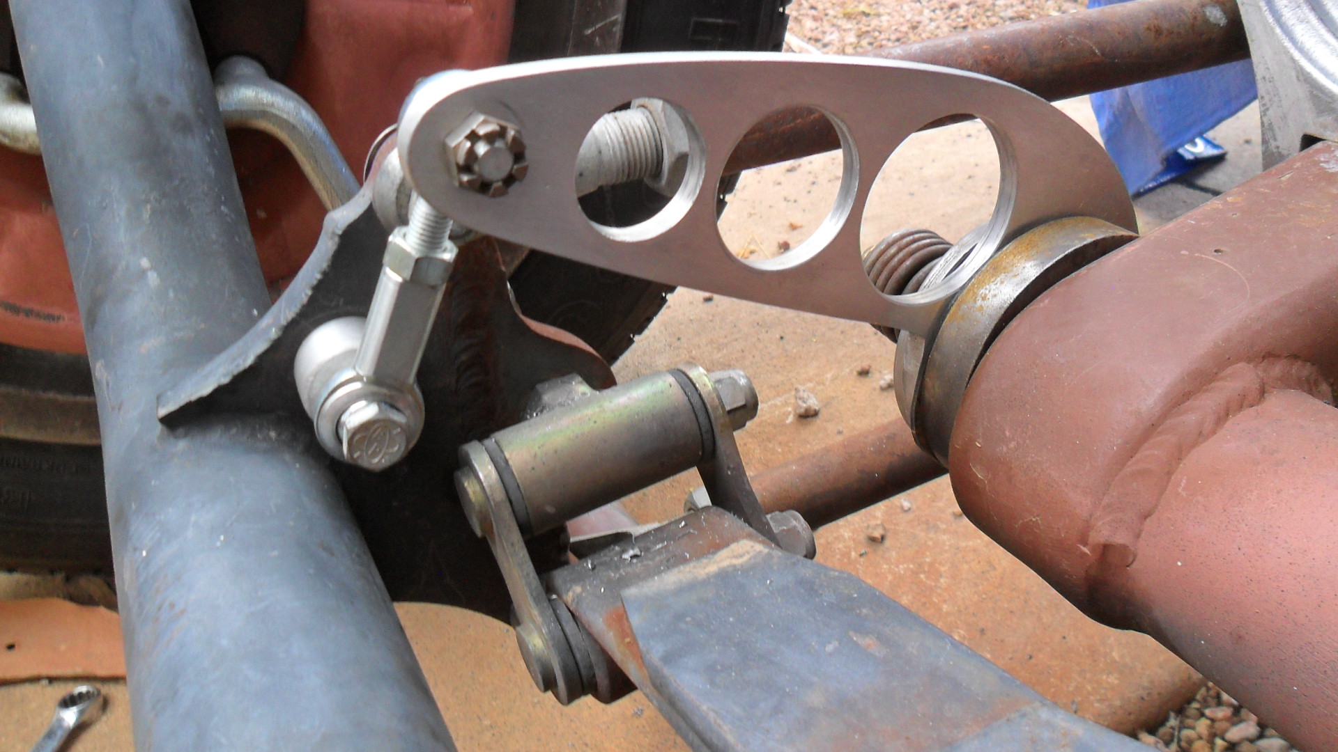

    SAM_6495.JPG SAM_6499.JPG Pictures are giving me fits again... Boo! I'll skip to the chase... It's all help together with cool little aerospace hardware that a friend of mine gave me along with a nut and bolt bin that came from Garret/Airresearch back in the seventies. The heads of each bolt have a cool little rocket orbiting a planet motif, and soon all the lock washers will be replaced with drills and cotter pins, just for fun.

    SAM_6502.JPG SAM_6504.JPG ...And, the money shot! Now, if someone would have told me how much better this thing would ride and handle with shocks on the front of any sort, I would have done it earlier! Ya, I know better
