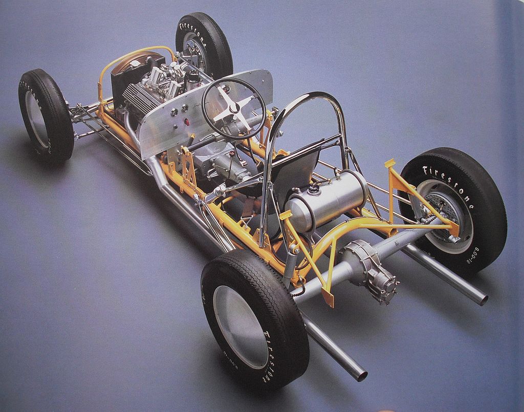

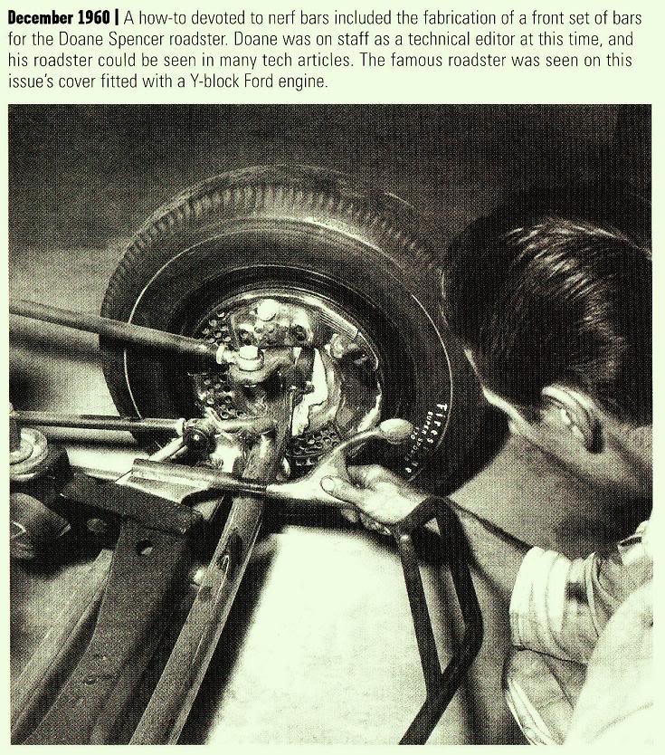

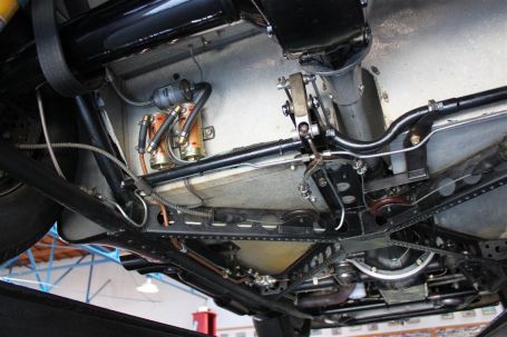

    My take is a little different. The stuff that really turns my crank, and that I really hope to someday emulate, is period stuff built built by the "****eras" of the forties and fifties, the Kurtis' Vancichs, Spencers, Hagemans and Ingles. In hot roddings infancy, there was a LOT of crossover between indy car and road-race builders and the more sophisticated hot rods of the era, and alot of the work, while done with period tools, equipment and techniques, was very well engineered and sophisticated. Thats the stuff I really like to look at. As a young man, I trained and worked as a machinist, and have always dreamed of the day I would have enough shop space for a lathe and a mill, that time is now close at hand. Everybody likes to carry on about the crudity of some of the cars of the era, no-one ever really seems to want to talk about the really GOOD stuff, and there was a TON of it.
