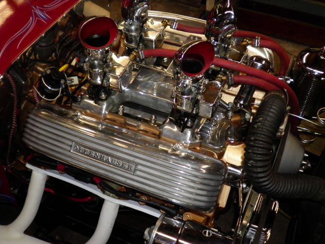

    I love that carb set up. I have the same intake but with Rochester 2 jets, and 2" offy risers.

    You know Chip I can't remember what kits I used when I rebuilt my 97s but I know I didn't pay anywhere close to $50 a piece for them and the needle valves although neoprene tipped were nothing special. I do remember all the sticking needle valve troubles I/we had in the '50s and '60 with 97s and my chrome tops are riddled with indents from being banged on by who knows what in the past, but I have never (knock on wood) had an overflow since I put the four of them together and I have run as much as ten pounds pressure at times. I now try to keep it down to four or less. I just have to think the new stuff is far better than the old stuff. I do run a good filter though.

    I tell you what Gary, just that little bit that I drove yours around at L.A.R.S. I was super impressed with the carb set up. I have never been in a multi carbed V8 that had a throttle response that nice before.

    Yeah Chip I was pleasantly surprised when I got everything together and worked out how good it ran with the open plentom Horne. Guess I just got lucky and got everything right. Thinking maybe the roller tappet Isky cam makes a difference too. Make sure you do a search and get all the info you can before you start rebuilding your 97s. I learned a lot here before I started working on mine.

    This'll probably provoke cries of out-rage, but personally, if I was doing tripps, I'd way rather use rochesters than 3 bolts. And they've been around since '55, and in common use on hot rods ever since, so unless you are doing mid-fifties or earlier, they may not be as "traditional", buut they are certainly just as period-correct.

    George, George, George, Come on, think about it. If you had these three 97 tops and enough parts to build them would you not use them? 97s were still in use up into the '60s and they are great carbs if rebuilt correctly. Nothing would be kooler on his roadster than these. It's not about what is really best here it is what is koolest.

    But let me put it this way. If I end up doing tripps on an olds, I will be seeking out a 4 bolt offy intake, not a three bolt. Now, on the other other hand, if I had a Horne or Cragar 4x2, well, I guess I'd have to live with those antiquated 3 bolts...:D

    Kinda blew my brains up working out in the heat this weekend, so I spent some quality time yesterday and today reading up on setting up these carbs. I'm almost convinced that I am going to do a synchronous linkage for it. I found on Stromberg's websight CFM figures for these carbs, and the explanation that they were still rated on the same scale as a four barrel would be. Long story short, with just 150 CFM per carb, three of them would give me 450 CFM all up. That's a bit less than what my Edelbrock is providing now, but I'd wager that it would give better mixture distribution than the single four barrel. It makes the linkage super simple, and I never liked the idea of a single center carb feeding the outermost cylinders of an engine anyway. Seems a far easier deal to me to feed idle with all three synced to where they need to be.
    I know the late model ideal is a progressive linkage with end carb's idle and power valve circuits disabled, but with the relative small over all CFM I just don't see the need for the complications. What do you guys think?

    It seems that, intake design will be the defining factor. A 4bbl intake "looks" like the end chambers would be starving, but the insides are designed to compensate. I would pick a 3 carb manifold with flow design in mind, when it came to progressive linkage or not.

    Seems to me Chip with the smaller venturies you'll have higher air velocities and better fuel atomization spread out over a wider plenum area should equate to Better throttle response , of course I'm reminded quite often at home I'm wrong in my logic .

    Well you drove mine. Nothing simpler than one two barrel over two intake ports. No flat spot. Smooth acceleration through the whole RPM range. Despite what some call "antiquated carburetors" they perform flawlessly.

    You could start with all three hooked up, then later move to progressive if you're not happy. It seems like it would be easier to do it that way then vice versa. You could maybe try to set it up to idle on the outer two and tip in the center? Who knows? I think that this subject could be discussed to death; eventually you gotta throw something together and give it a shot. I did quite a few "mods" to my Rochester 3x2 setup, which have not been put to the test yet. I cringe slightly every time I think about the headaches ahead of me lol. Only time will tell!
  27. Chip
    I run a "Factory" Tri power on my Falcon Ranchero. It is rated at 730 CFM total. 200 center carb, 265 on each end carb. That is on a 260 V8. Factory set up is progressive and it works well. With the small CFM that you will be running it will get good mileage plus have great throttle response!!
