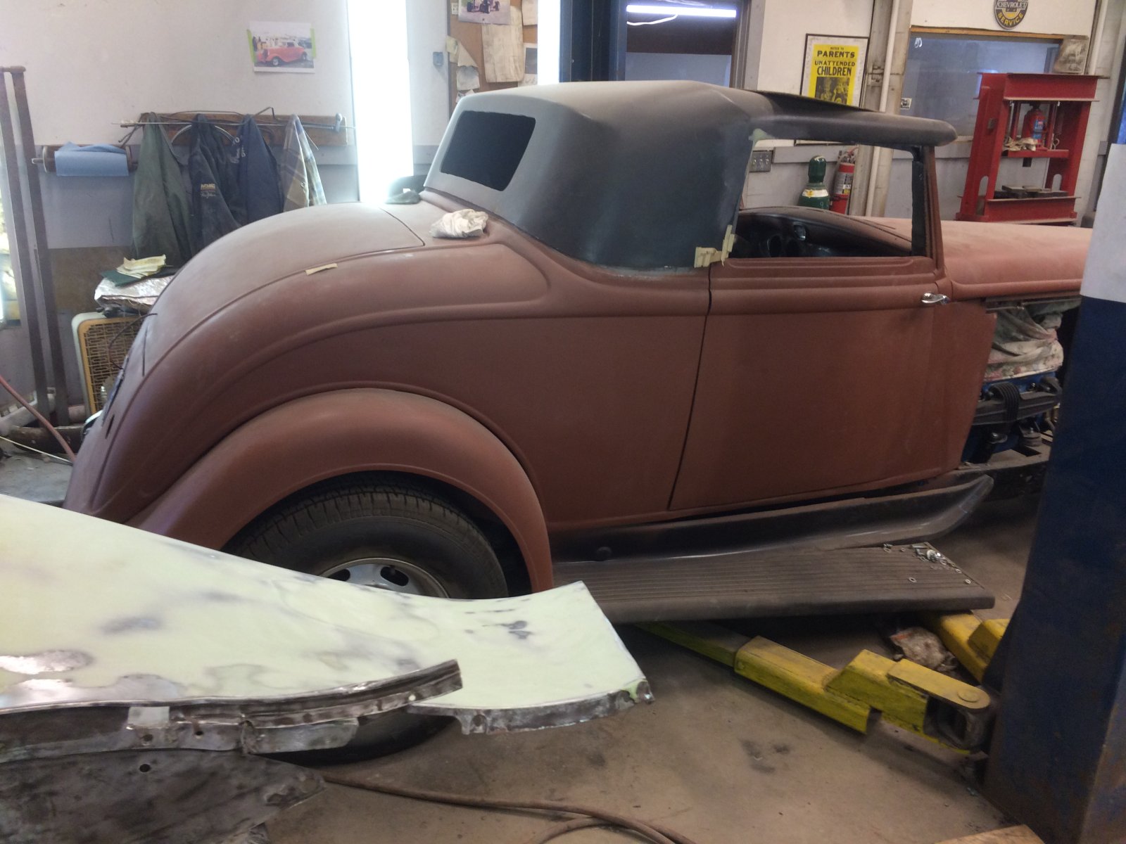

    My black 40 Ford Standard coupe was built before my time began here on the HAMB, I was one of the few who had hooked up a 5-speed to a flathead in my area, 8" w/3:50 ge****t and parallel leafs, DB up front, dropped axle, reversed eye front spring, and so on. A bit of a street rod but great car that I enjoyed very much. But, I wanted to build a 32 in a more traditional style that I could go long distance with. I was more of a street rodder back then but right about the early 2000's I was introduced to the HAMB and, as you all know, that got my juices flowing. Anyway, I started searching around for a roller to start with. After several dead ends I came upon an add in Street Scene magazine for a 32 "roadster" that was not exactly a true roadster. For that reason the price was a lot less than I had been experiencing so that tickled my interest. Talked to the owner who was out of or near New Ulm, MN and I sent him a deposit saying that I would find someone fairly local to him to take a look at it for me.
    So, I went to the Fellow Pages and came up with a guy about 100 miles away that was willing to make the trip. When he found out where it was he had, low and behold, bought a couple 32 from this same guy. It was a welding shop and the man that ran it collected all types of 32 bodies in any condition. His son actually ran the place now and every year or so he would put one together as a roller to sell. I told this gentleman that I did not want a show queen as this was going to be a driver, no street rod stuff - just traditional or traditionally styed. His report was that this indeed would make a perfect driver, not a show car, it had no shortage of body work done to it, and it had all the right stuff. With that in mind I made the deal. This Nov-Dec - I had a car trailer and a truck to go get it with but when?
    Here is what I started with:
    It was all 32 suspension, dropped axle, some juice brakes installed, stock 3-speed, dead flattie with a 2-deuce carb intake, steering (which ended up going to Corkie Coker for his roadster), all steel save for the f-gl*** lift off top and trunk lid, dropped axle, nice headlights and headlight bar, hood top and sides, aftermarket grille shell but original grill insert. The lift off top was attached by a couple of latches, I had windshield gl*** - with the top off it's kind of weird looking and the top rear window was waaay too big. I mean it was all there really just waiting for me. I could not wait to get it home.
    To be continued .....

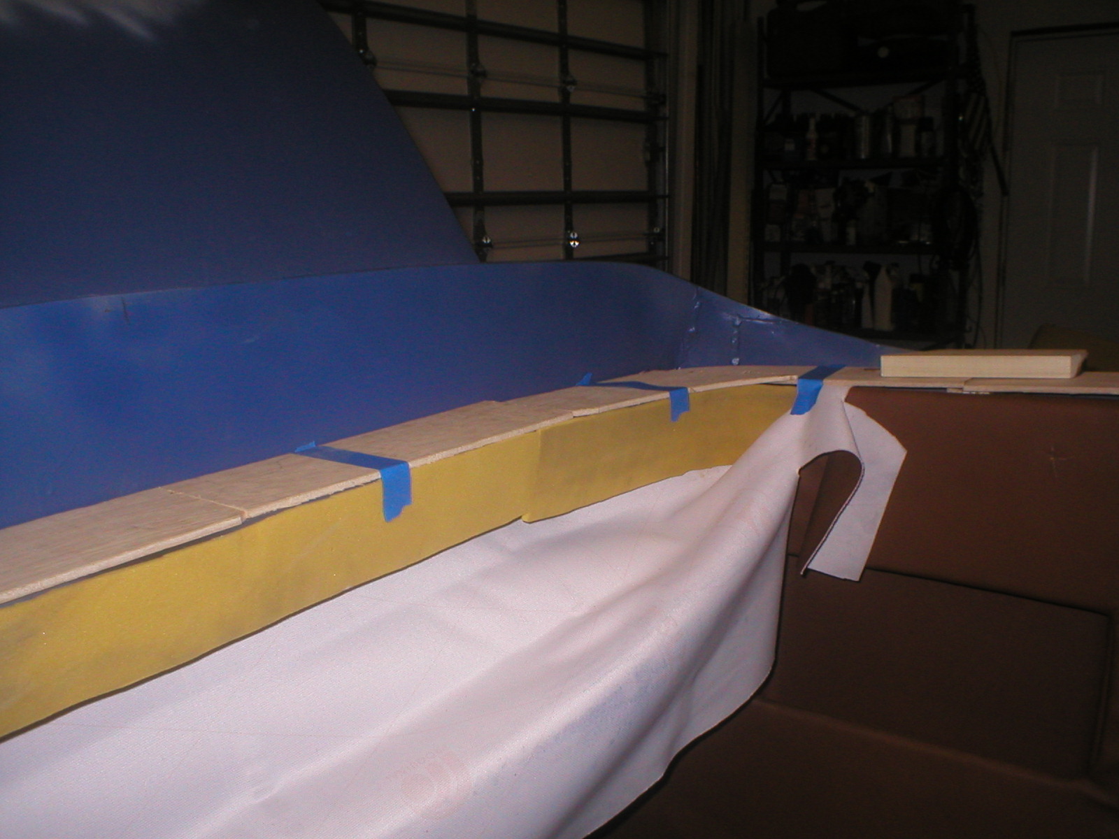

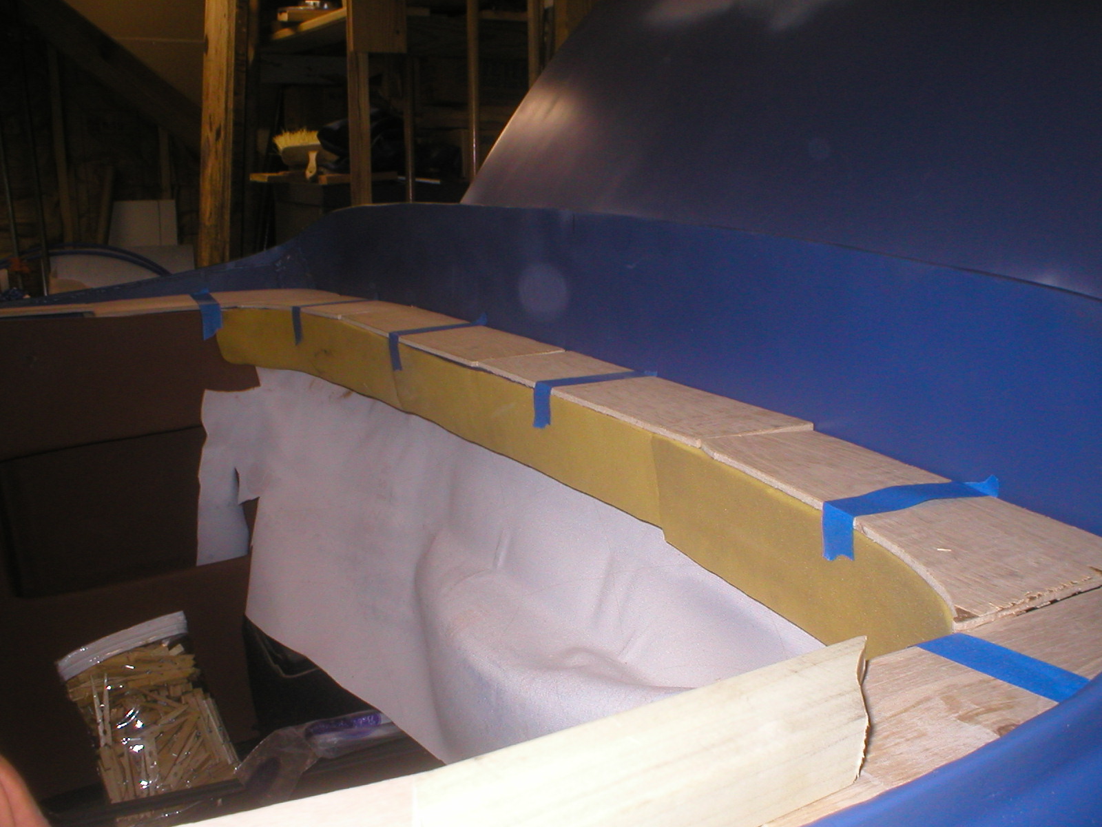

    Couple things I forgot to mention in my last post, when everything got welded up I made some minor changes/additions
    - I extended the front door post to just p*** under the top. It looked more “finished” that way
    - I instructed the welder to glue in a 2” piece of aluminum angle to form something of a header top support. The vertical portion would bolt to the top windshield crosspiece by some tapped holes
    - I also glued in a piece of hardwood that would reside in front of the ws top piece forming a “pocket” so the top would stay home at all tines up front. I eventually put in a rubber seal so no water would “push” through in bad weather. It’s worked out pretty well over the years ….
    Since by budget was busted with all my money being spent on welding, the motor, seat, and top upholstery, I needed to paint the car. My welder used some spray bomb thatcactually looked kinds nice. Now, I know many will not agree with this but I finished up whatever body work was needed and I bought Krylon grey primer and top coated it Krylon Oxford blue. I know I can never go back to automotive paint without stripping the car but I was building a drive everywhere, park anywhere, no wax or polish hot rod. It has held up for over 15 years and it still looks good. I also still have extra paint to paint the steel trunk lid I have to replace the fibergl*** one. I will see if I have any pics but I do not think so …..
    My seat is a Dodge Caravan 3rd seat I took 2.5-3” out of the center, sleeved the tubing of the seat and welded it back up. I cut down the original seat form and added some dense cell 1/2” fosm like a yoga mat to the hd brown vinyl upolstery plsted to the original seat pleat pattern. With Mustang bucket seat slides and the seat one notch before fully all the way back, I have had sone big guys in this car like 6’2” 250 lb kinda guys. Yes, it takes a bit of folding oneself (not me - I’m 5’2” only), it rides “hot rod”comfortable. I also like it because it folds down and I can reach the deep area of the trunk. At 5’2” I can't reach anything!

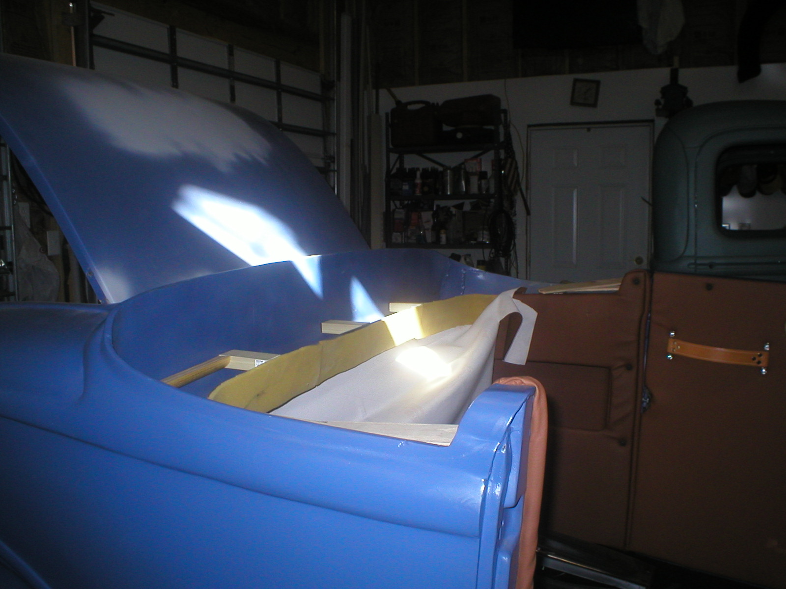

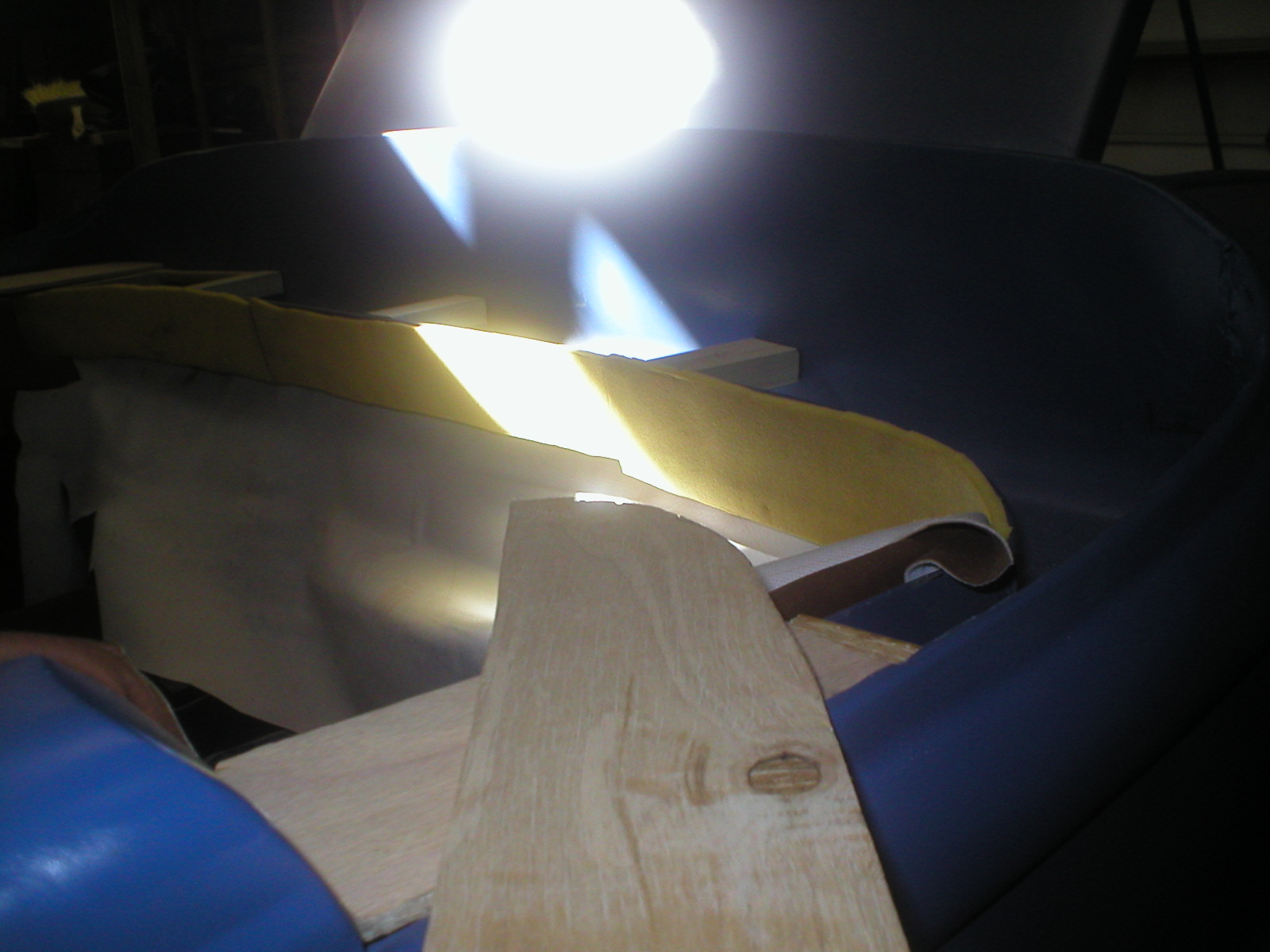

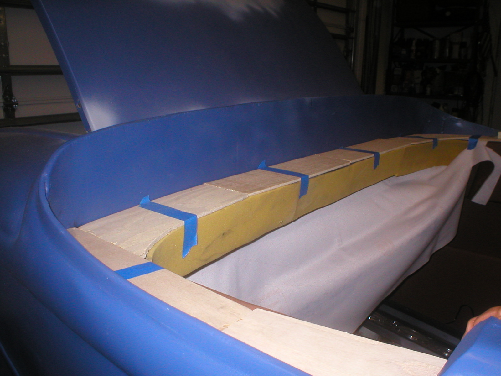

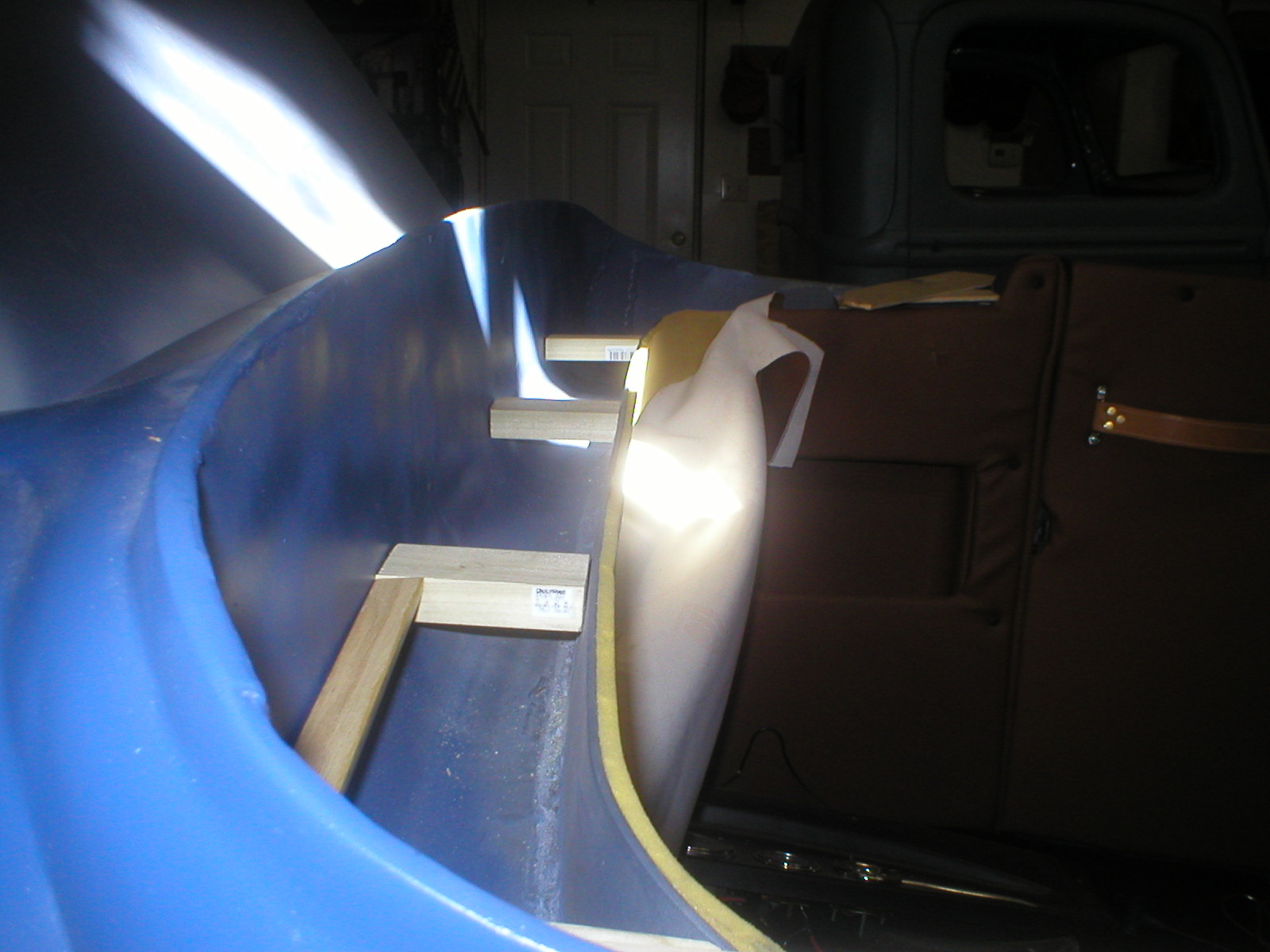

    The floor kickups. the floor in front adn under the seat were all done in 3/4" plywood, primed and painted top and bottom in black with felting where wood met wood or metal. The metal strap across and over the ****** has threaded bolts welded on for its removal. Exhaust goes under the front crossmember which nade things fairly easy, the pipes are under the framre rails and we don't need no stinking mufflers!
    I like my cars to have some kind of interior - I like it and the wife likes it so that cinches the deal. I did it all myself and got a little creative with the package tray as it came form the PO. I made some covers and Hot Rod Leather made up a bunch of straps for me as per my specs and it has worked out great ....
    This last pic shows the package tray finished with its compartments, the cutouts I made for items in the 1/4 panel, the door post extension, and how it looks better with the top than without. THe cut down and away sloping up to the back is what I do not like seeing - future plans call for an idea I have to "hide" that.
    Those two floor strips are for installation of the battery box ....
    Still looking for top pics ....
