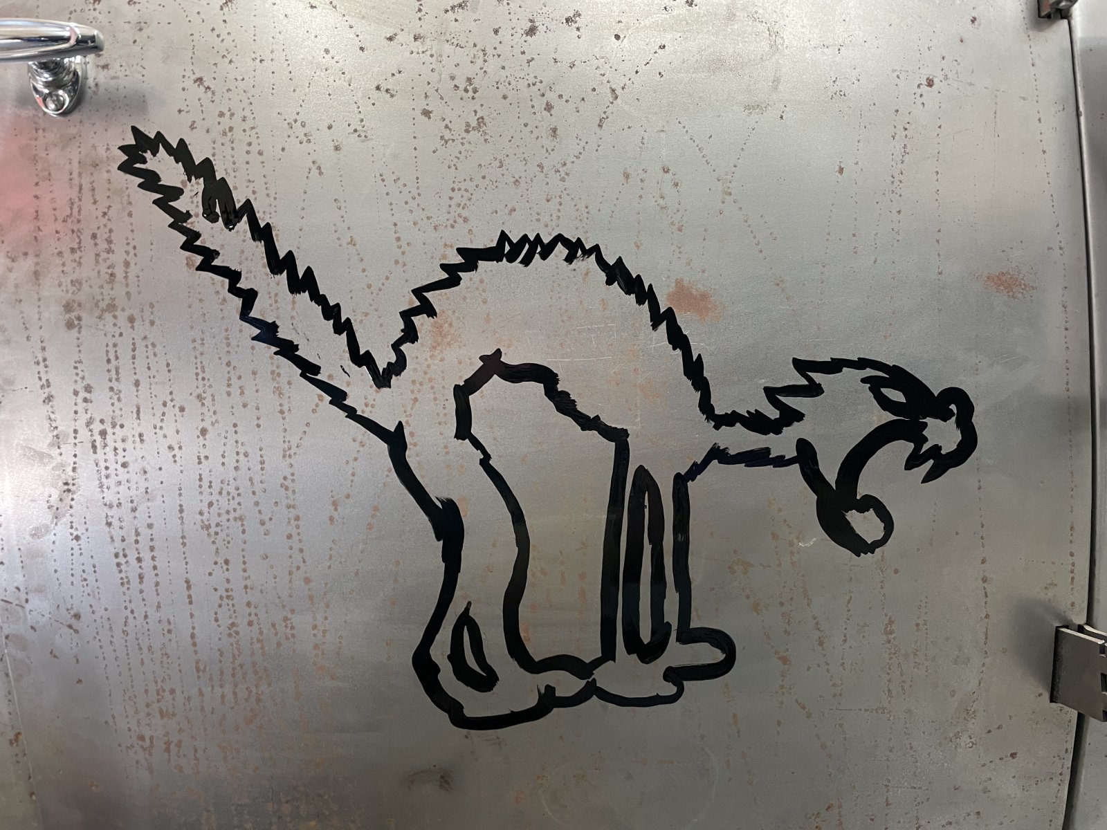

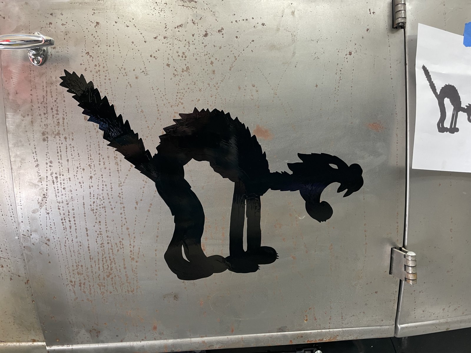

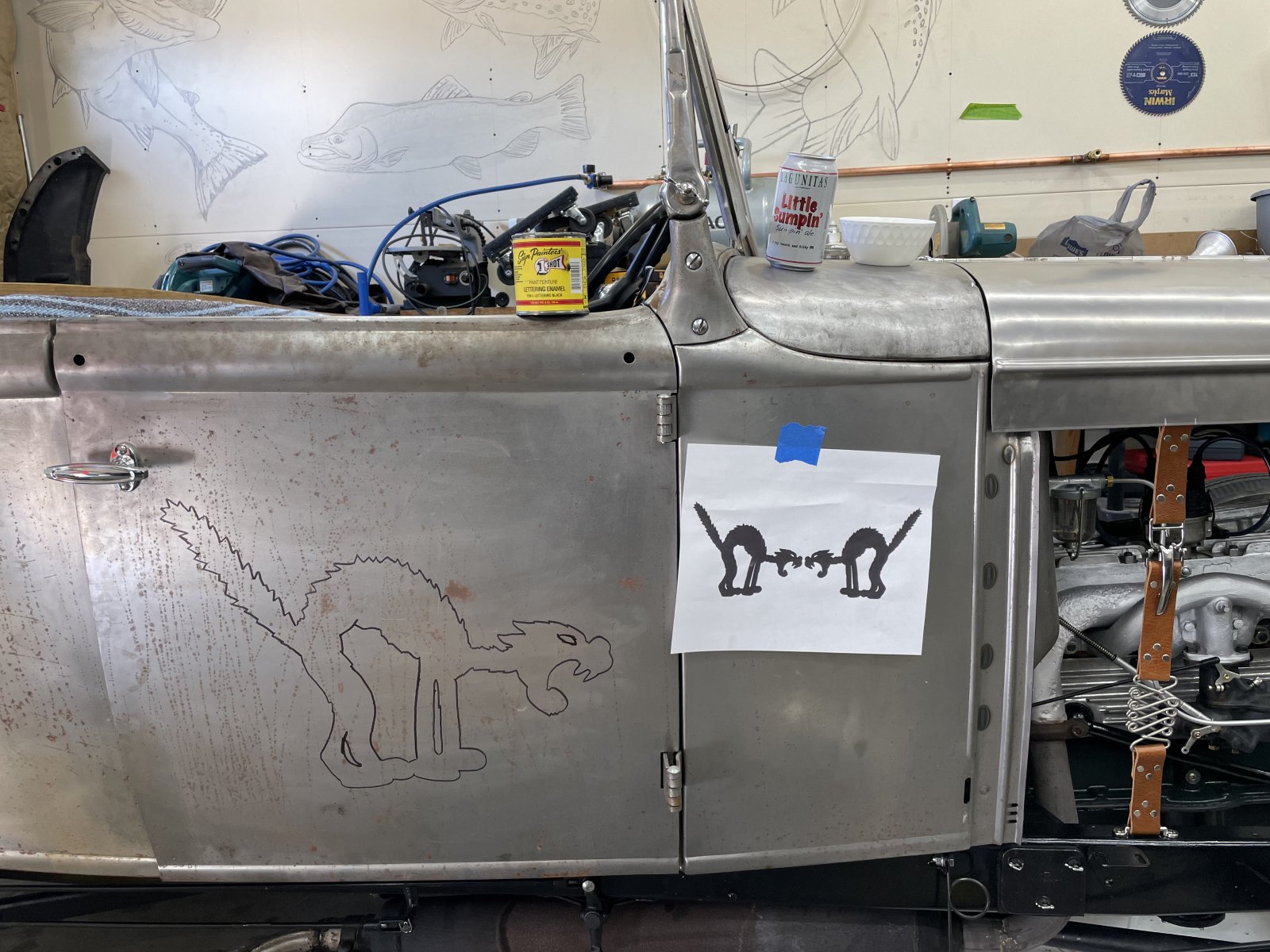

    I guess 1 shot never goes bad. Found a 15 yr old can in the basement and got a great idea from the picture of my cat walking on the hood. Too bad I couldn’t find my old brushes and too bad I found my wife’s. Pro tip, don’t load your wife’s good art brushes with enamel and let her catch em soaking in paint thinner you poured in a bowl that may or may not have been retrieved from the cupboard. Anywhoo, felt good to load up a brush after umpteen years and paint something cool (subjective). The cat I painted is an old Disney cartoon from 1929 called Skeleton Dance….so for all you snots that said my car is straying from being period correct, this is for you. Wanna do some lettering but man, it’s been a long time and I wasn’t all that good at it back then. 19BAE56D-722D-4F71-8204-576ECEBB07FF.jpeg ACA19F2E-B449-408E-984E-E0D18B589020.jpeg 4F1D714C-F56E-48BE-B67A-A1CEC1B31812.jpeg 6CE7AAAC-BF50-4FC7-97D2-F044844D63C9.jpeg 2FC53DBE-A58E-4671-838D-FBA7F58113A4.jpeg

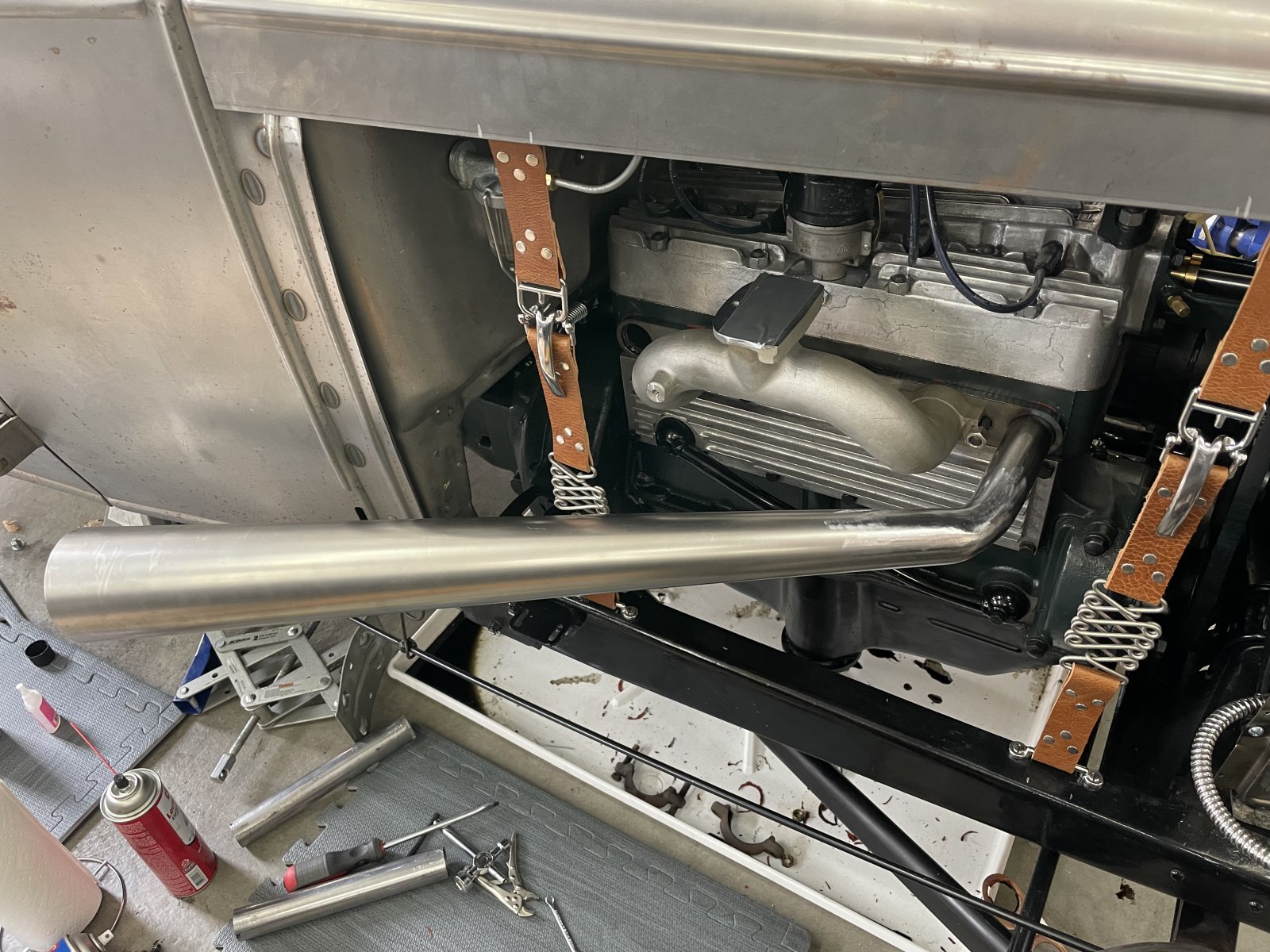

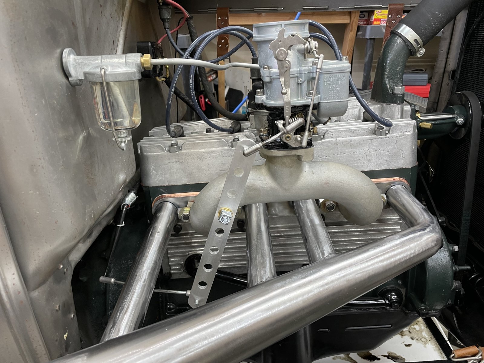

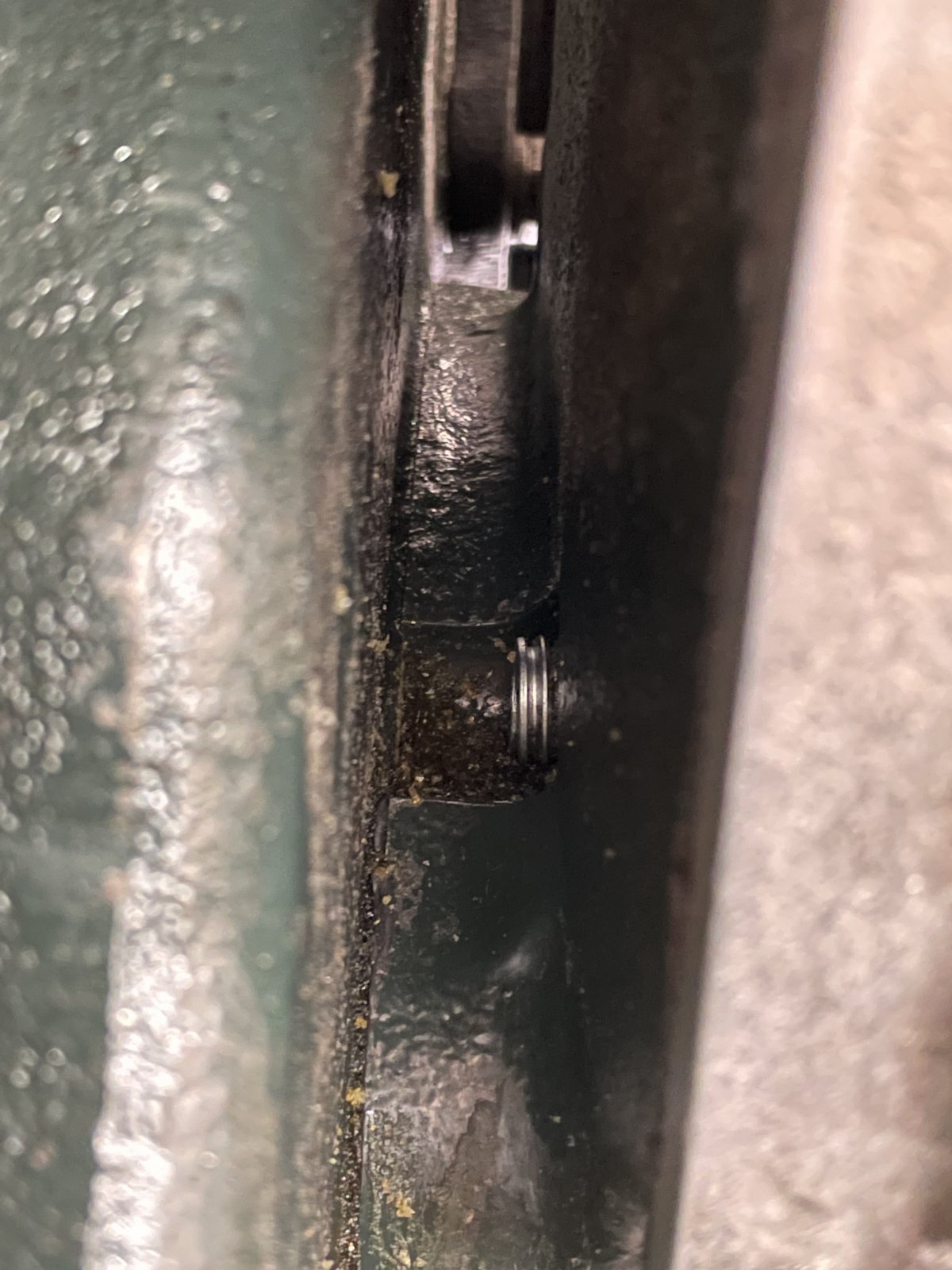

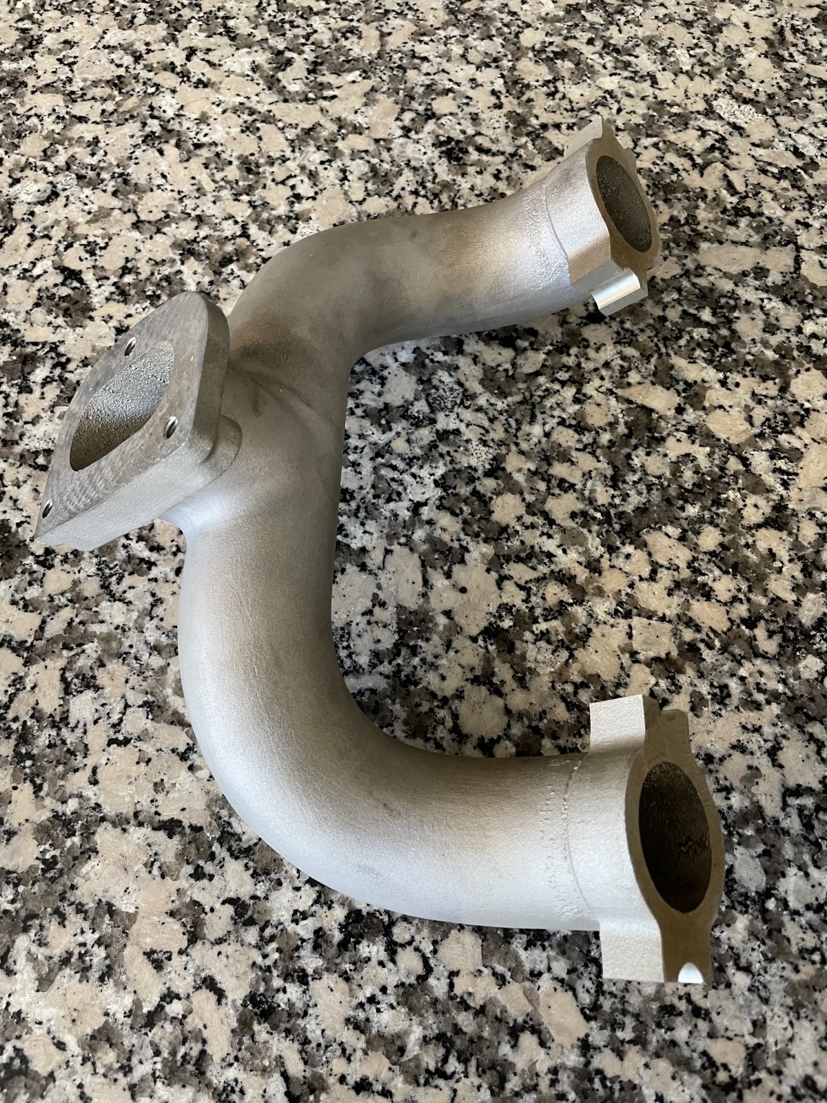

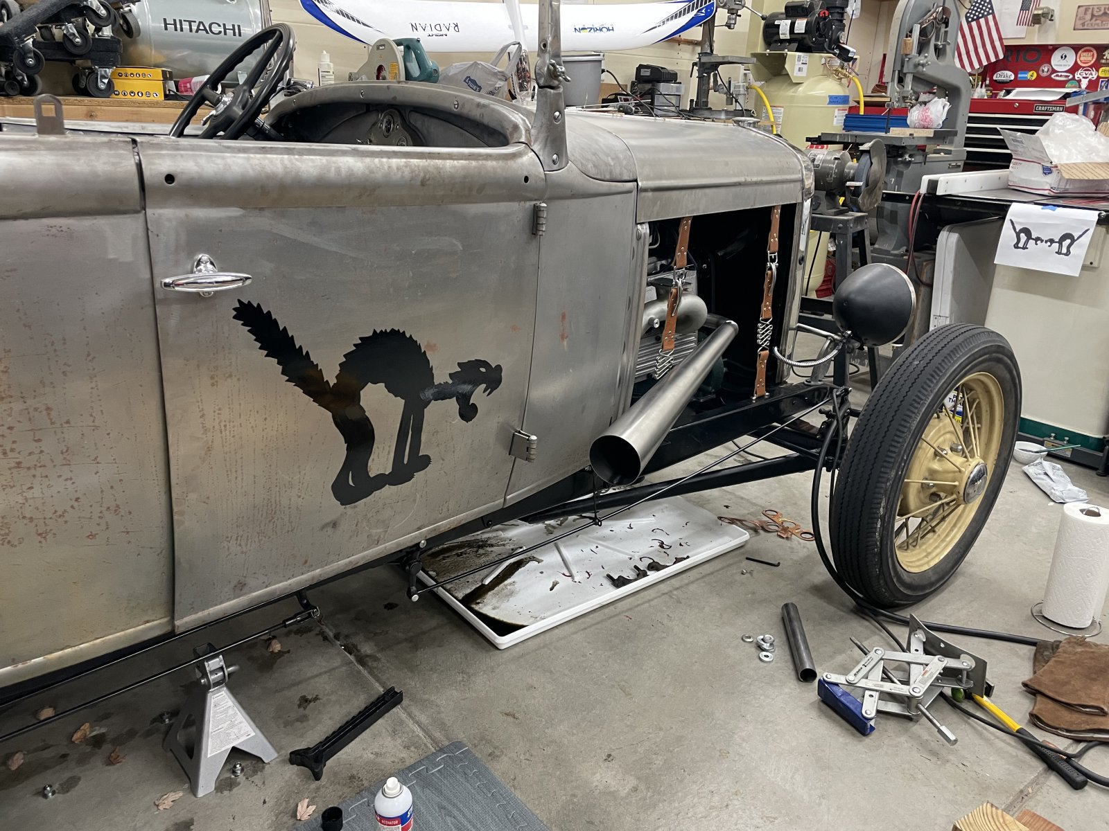

    More things a happinen. Got my downdraft intake today so of course I had to start on the lakester pipes as well. It’s starting to look a bit faster. Never mind the booger looking welds on the elbow…building up weld to smooth out that junction. The Hell’s Gate 4” cones are a bit crude. The Strom 97 should be here tomorrow. Tried to hold out for an 81 but I found one of those new 97 carbs for a price I couldn’t pass up. Oh yeah, found out where the torrent of an oil leak was coming from. I forgot there was an oil passage set screw behind the motor. Guess I didn’t put enough goop on it the first time. It was a royal pain getting it out, cleaned, gooped and put back in but I did it. Can’t wait to get this thing running again and also to see if the leak has been corrected. Besides nearly slicing the tip of my finger off removing the old copper manifold gaskets, tonight’s been a good night.
    Anyone got good intel on a baffle for the 4” cone? This thing is gonna be ridiculous loud! F163E2F6-D98A-4623-858C-A96665A76A5F.jpeg 27E1EDFB-C241-4239-B70B-ACFE7C40D53B.jpeg 6CF1496C-D42E-445B-9774-DEA2B05377DD.jpeg 9F66B18A-74F8-4EEB-86AB-CDBC4BCDA527.jpeg 4D5DF0BE-A1EB-4D71-AA24-76523292986A.jpeg

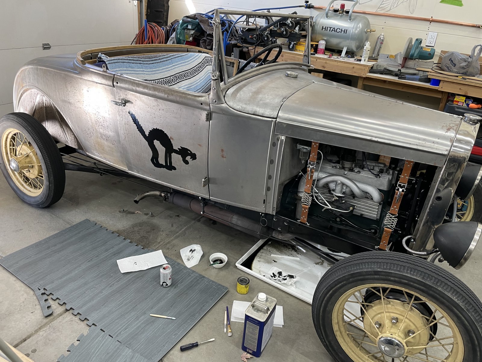

    Guess it’s been a damn long while since giving an update. Winter is here with her panties all in a wad and cold as a witches, well, you know. Pulled the car out today to dust off the cobwebs, she ran ok, still needs some tuning love. Got sick of the damn oil leak from the rear oil galley so I busted out the hand files and went to town on a 1/2-13 x 3” bolt, whittling down to just the right size. No leaks!
    DMV update, still at it. About 90% of the way through obtaining a new title. I’d rather have a kidney stone and new kid at 40 rather than traversing this process again. No matter what, they’re gonna desecrate my car with a new vin plate, no way around it.
    Itching for paint and interior. 697A73B5-B83A-4BEA-8A50-2464287BAE24.jpeg 20011D61-0A65-4569-B580-C11F5783B02A.jpeg
