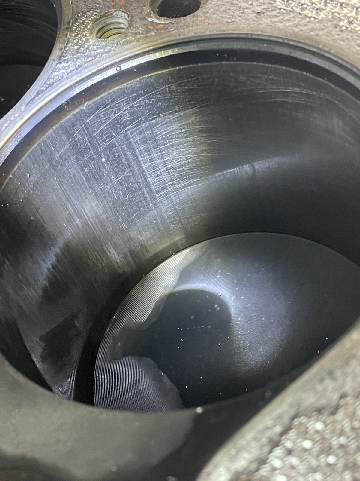

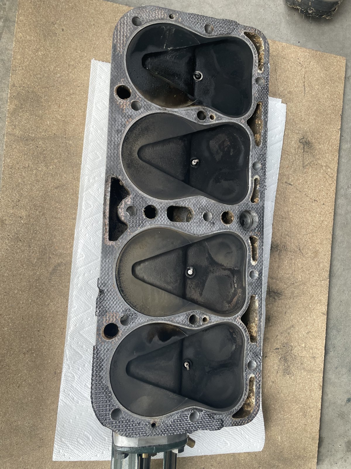

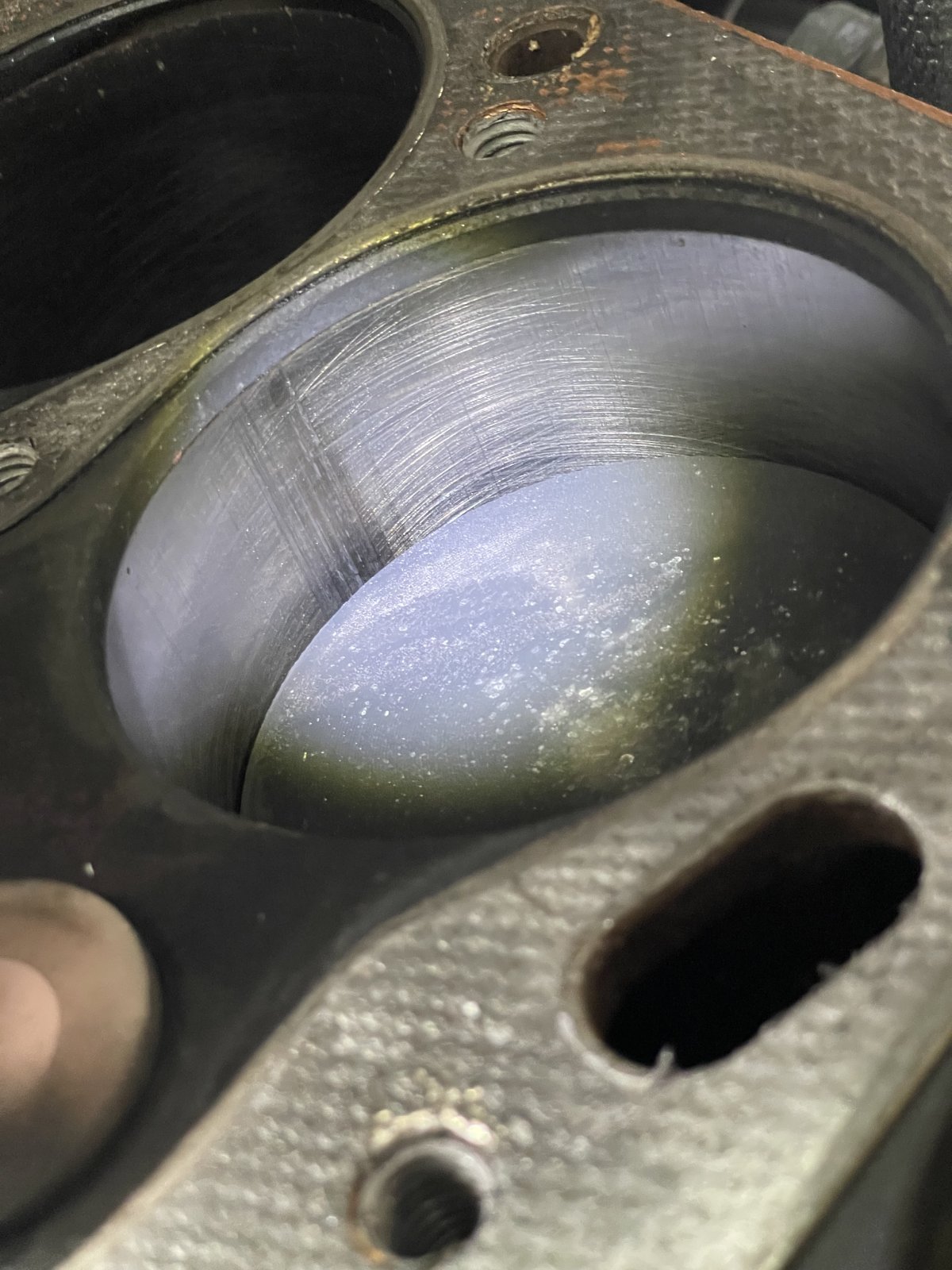

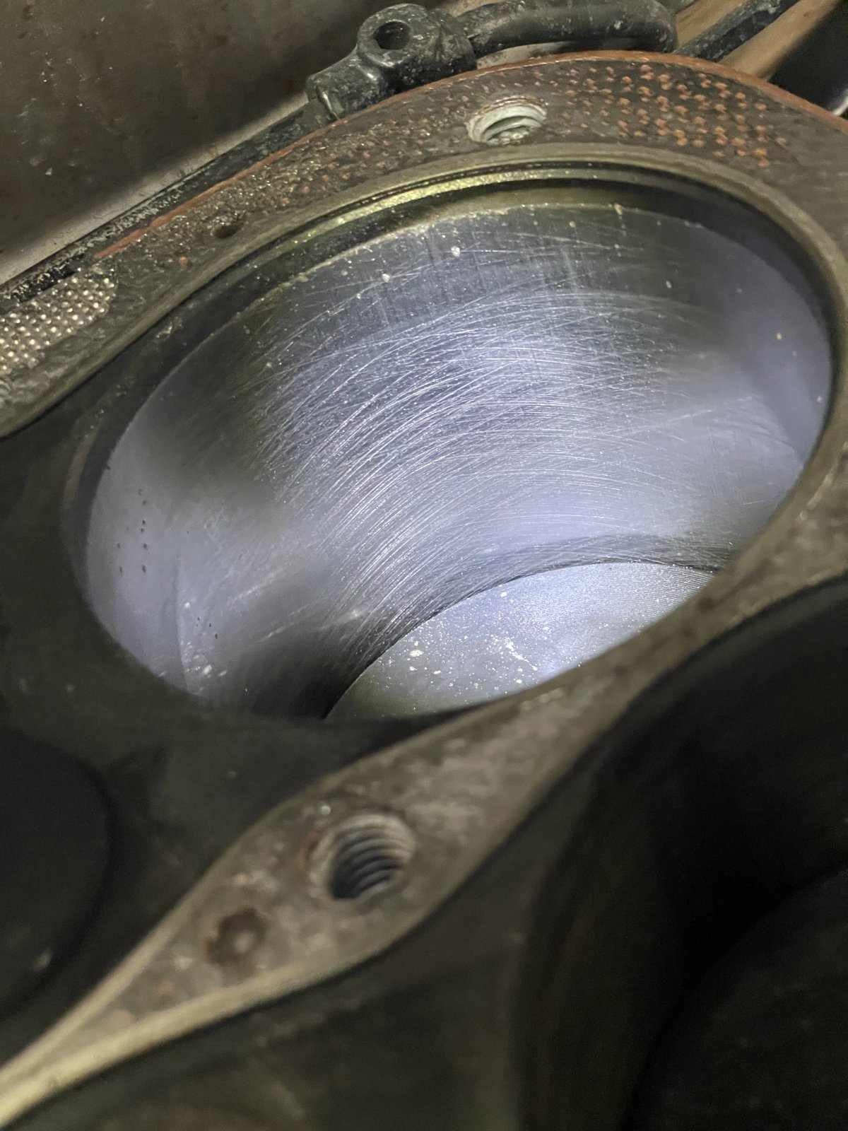

    Welp, went from the motor running great to not so great. On a 20 mile trip, slightly uphill, the motor started to lose power so I pulled over. I was puffing white smoke out of the oil breather and billowing the bluish stuff out of the exhaust. The motor felt pretty warm but not overly hot so I sat there a bit and let things cool down so I could get home. The next day I did a compression and leak down test, everything p***ed. Took it out again today and experienced the same issue within 10 minutes. After some head scratching and a couple beers I decided to pull the head. Cyl 1 and 4 had evidence of oil (white smoke) while cyl 1 plug was certainly fouled. Cyl 1 and 3 have some rough spots on the cyl wall but no evidence of major failures. Pretty bummed at the moment considering it’s the start of the driving season here. Thinking that I need to get all cyl honed and new rings. While I’m in there, might as well grind the valve seats and install new valves. I’m more interested if finding the failure mode. This was supposed to be the end all bullet proof model A motor. Whisky night it is!!!!

    White smoke is coolant and blue smoke is oil

    Sorry to hear this. The cylinder that is clean in the head got "washed " with antifreeze

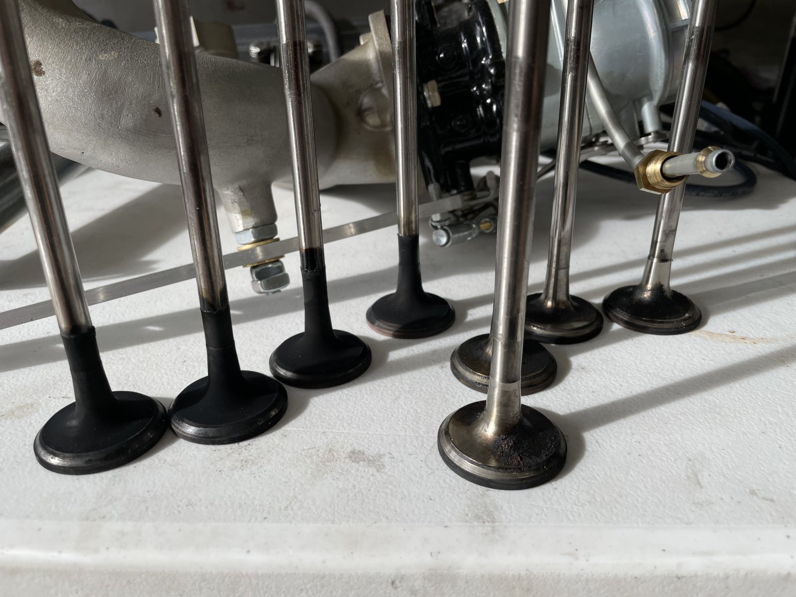

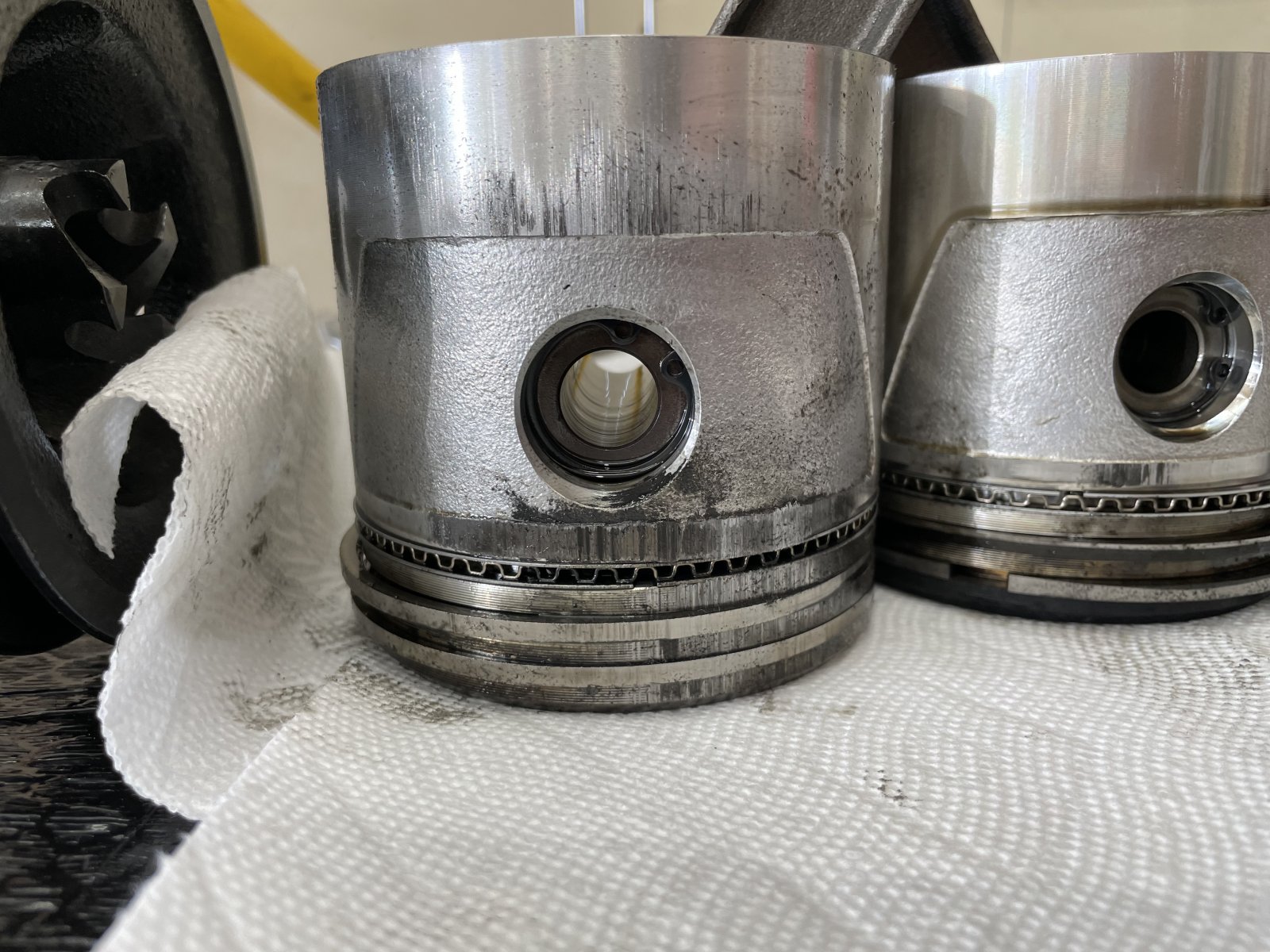

  12. LostInOC
    Joined: Aug 5, 2009
    Posts: 179
    LostInOC

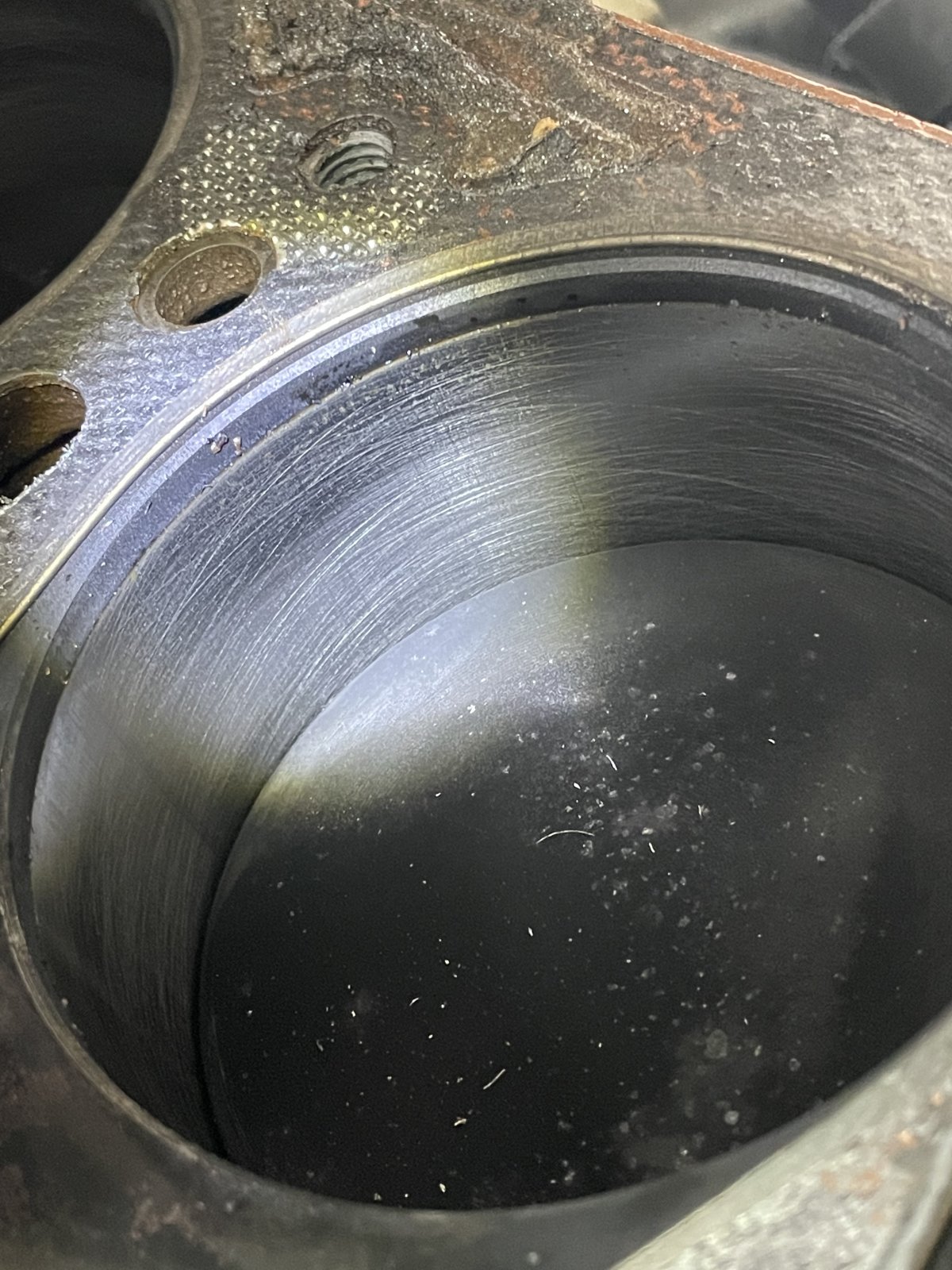

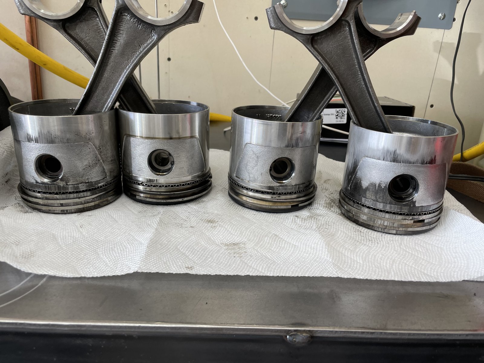

    Got it all apart and found my issue. Piston scuffing on 1 and four with a little on 3 (all on one side of each piston). Didn’t think the motor got hot enough as my coolant never got to boiling but that may not be the case. I sure as hell wasn’t pushing too hard. On a side note, there weren’t any signs of a blown head gasket, bad water pump, excessive bearing wear, or debris. The valves look a bit crusty.

    Is it all on the same sideline front or back? Could the crank be moving? Pulled to the rear or pushed to the front under load?
    Outback likes this.
  14. LostInOC
    Joined: Aug 5, 2009
    Posts: 179
    LostInOC
    Front of one piston, back of another. End play on crank was .007”
  15. Six Ball
    Joined: Oct 8, 2007
    Posts: 6,957
    Six Ball
    from Nevada
    .007" with just the crank , no pistons installed yet. Was the coolant low? Was there coolant in the oil or oil in the coolant? Could too much fuel have washed the oil from the rings & cylinder walls? Did the oil smell like gas? Just thinking and recalling past engine failures.

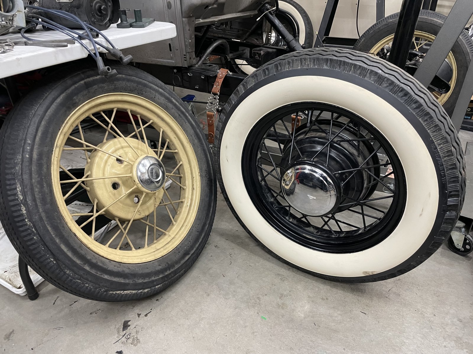

    Dropped the motor off at a reputable engine shop today. Before I start guesstimating, I’m going to wait until I hear from them. At a minimum, I’m looking at re-boring, grinding valve seats, new pistons, new bearings all around, and a crank balance. Fingers crossed that’s all we need to do. On a positive note, got new wheels and tires. 32 18” wheels with new old rubber. E9FBF63A-89D3-41C6-A112-E5CB6CEFA1BE.jpeg

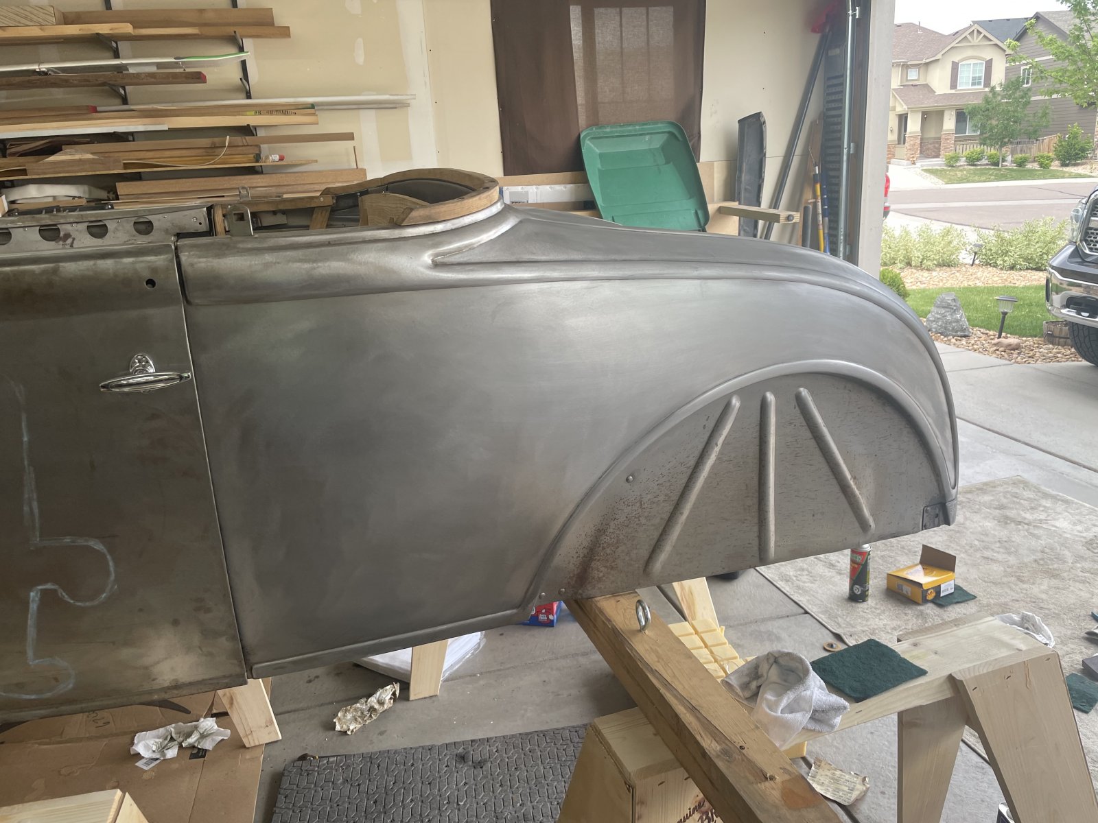

    Current state of affairs…
    getting ready for paint.

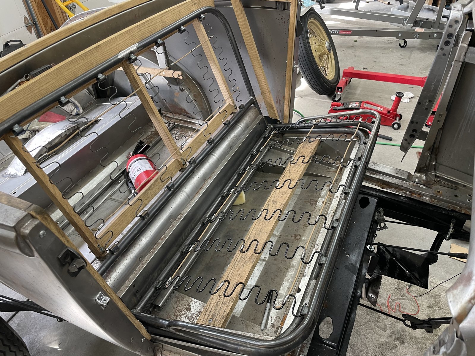

  19. LostInOC
    Joined: Aug 5, 2009
    Posts: 179
    LostInOC

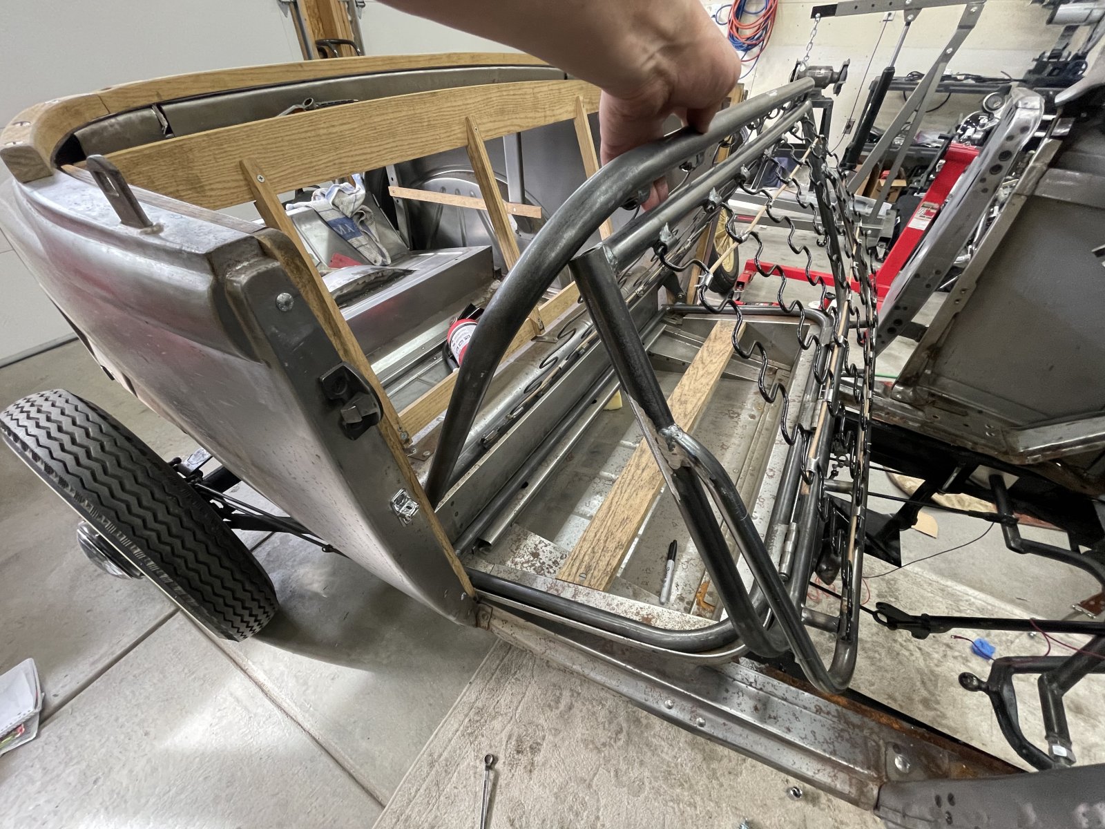

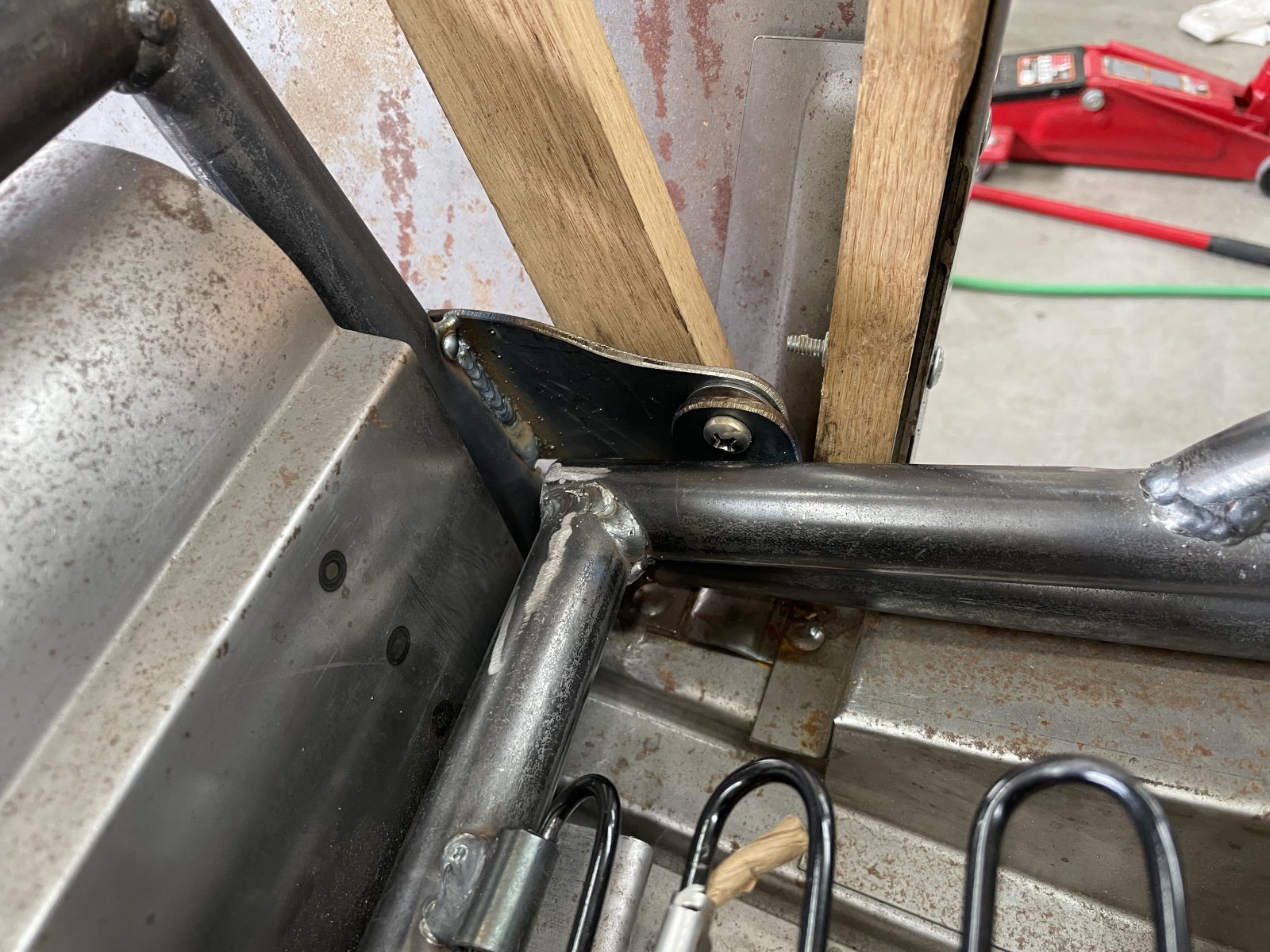

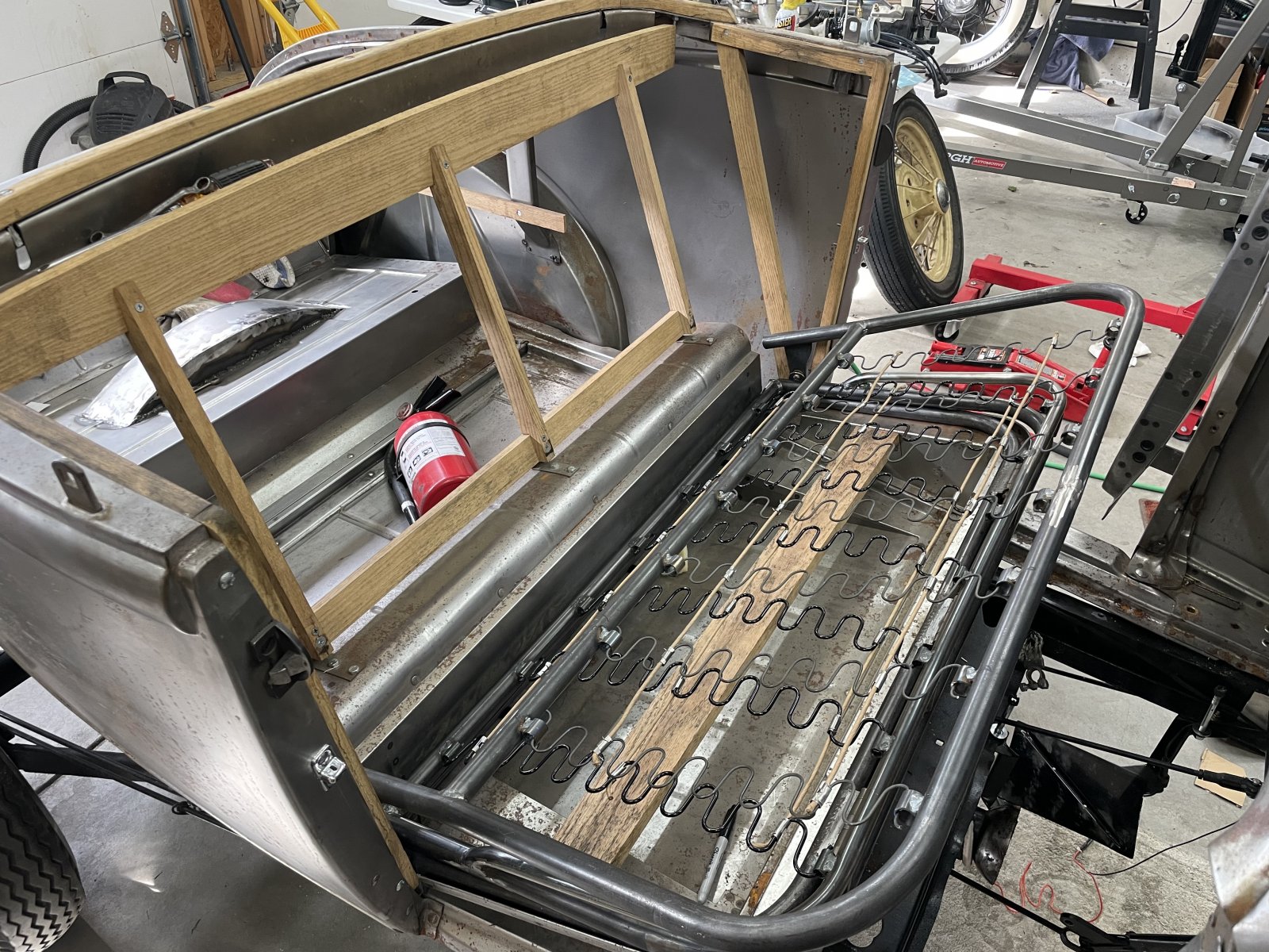

    This whole engine debacle sure is good for the rest of the car. After a year of a semi finished seat frame, finally got to fabbing the backrest hinges. Now you can take it both ways, front and back…….
    F9752209-69BB-4EA4-863E-EC0AB22B9BC9.jpeg 4298B723-6103-4FDB-85E8-8FF49DA76F65.jpeg 4B921739-9743-4331-9688-9AA14C74092C.jpeg 1632C217-4E51-4FC4-967E-DFB43FD4EC1A.jpeg

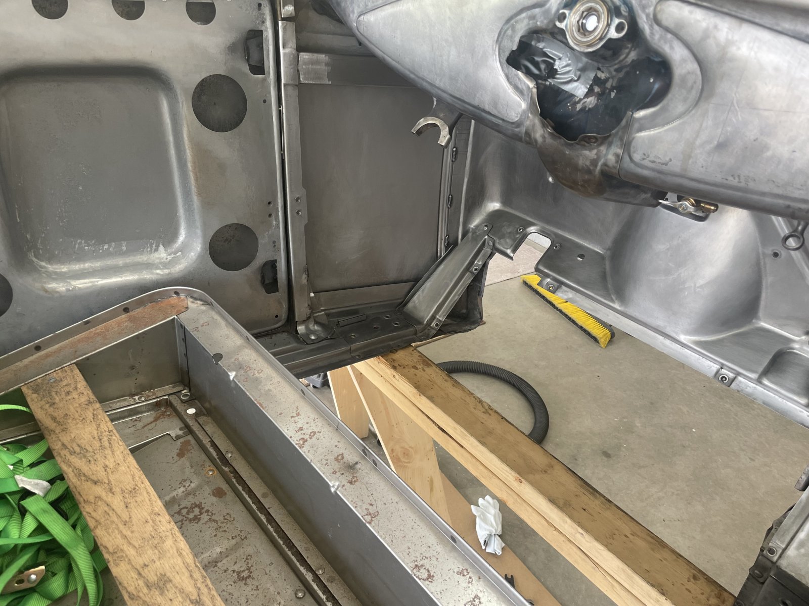

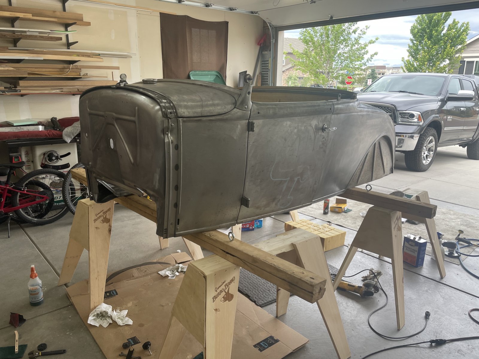

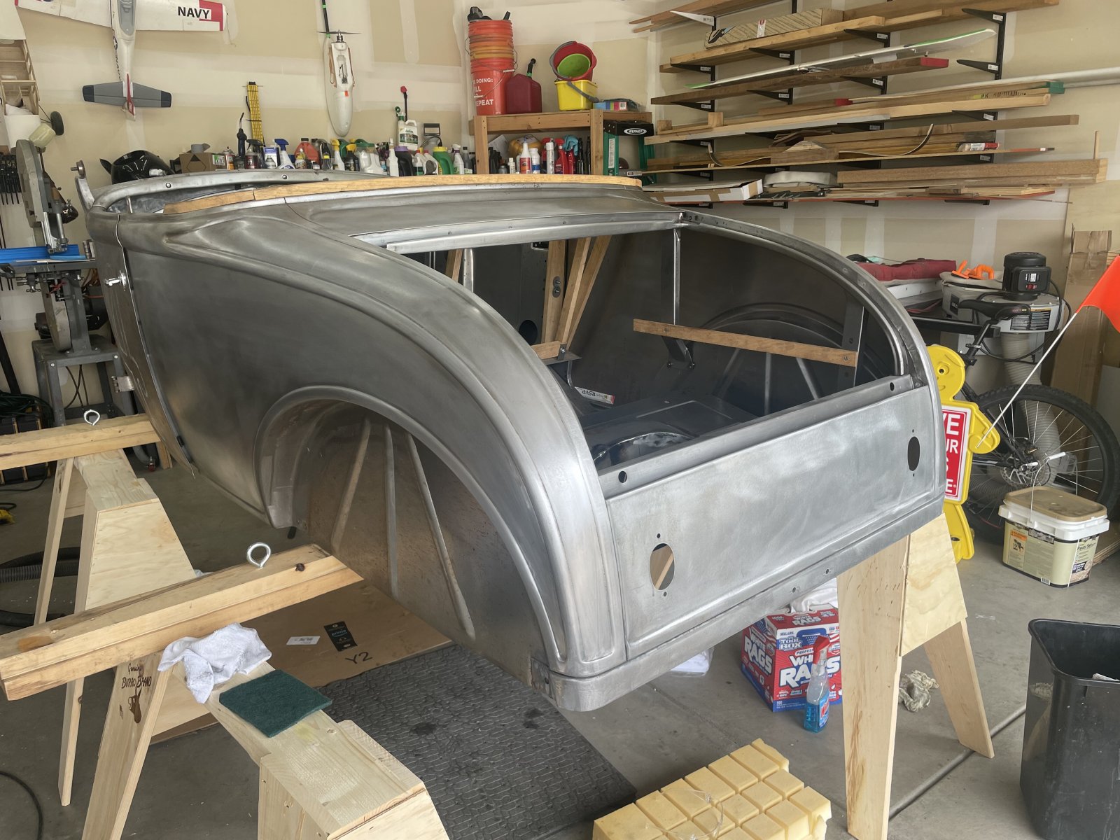

  20. LostInOC
    Joined: Aug 5, 2009
    Posts: 179
    LostInOC

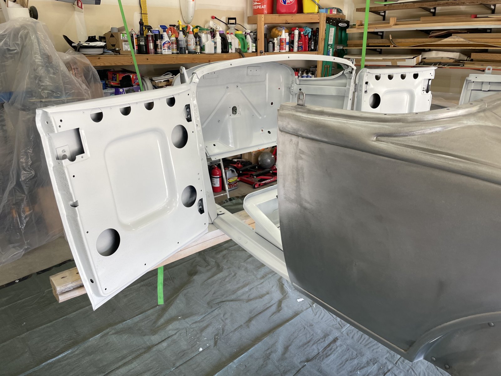

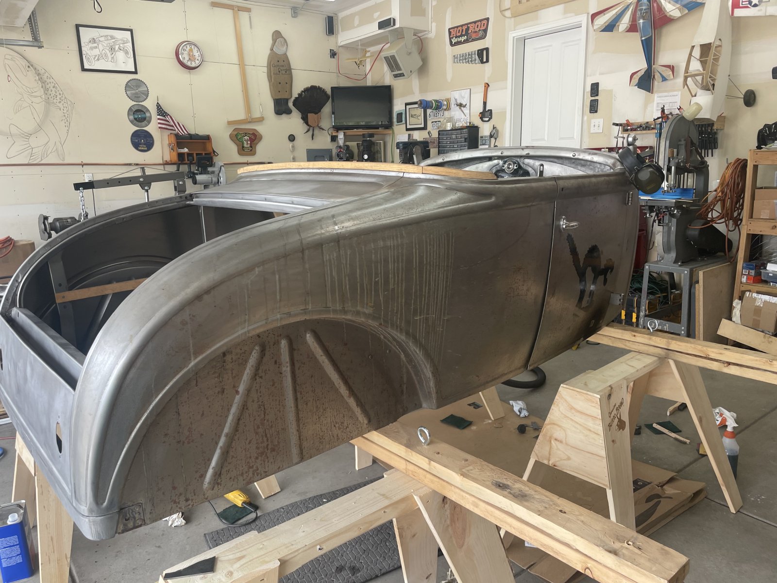

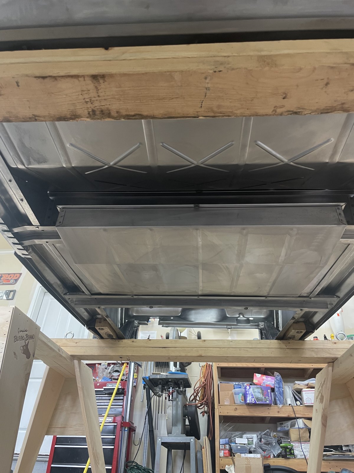

    Waging chemical warfare and a pneumatic ***ault!
    Getting prepped for paint. What are you doing for those impossible to reach rust bits and what undercoating do you all recommend?
    50E2EC6B-78B4-445E-8473-463515DE91E0.jpeg 02BA6BD3-FD3D-401A-BDCF-1C6871D60C79.jpeg 4BE40701-616E-4389-933B-8A4192E1AE01.jpeg 880E56AD-9415-42DF-8514-A7559B2610AE.jpeg BF0B8F66-CE7E-4008-B935-051EC189B89C.jpeg 3263B642-DDA4-421D-9F9C-E8A28A0A7DBB.jpeg

    from Nevada
    I have had good luck with Rust Mort. It is liquid so it gets into small cracks & hard to reach places. You can paint right over it.

    Needs to be fully neutralized with water and dried quickly to prevent new rust formation.

  30. LostInOC
    Joined: Aug 5, 2009
    Posts: 179
    LostInOC
    I was running Snyders pistons and Hastings rings. All the numbers checked out when ***embling but the engine guy said things were a little tighter than he’d like. Snyders pistons don’t give much room for expansion, so we think that was the issue. Egge pistons are designed to provide more expansion and have thinner rings for less friction/heat. Terry recommends Egge pistons for the engine but they were on back order for many many months when I needed them. I went with Snyders pistons because the tests engine built and ran here in Colorado used them and ran just fine. This time around, Egge .010 pistons are on back order until November so we’re going .020. The engine guy should be done boring, honing, installing new cam bearings, and grinding the valve seats in a week or two. He also recommended boring .001” over to give just that extra bit of room. He’s a well respected builder of flat heads in the Denver area so I’m going with his recommendation. I’ll let you know how it goes.
