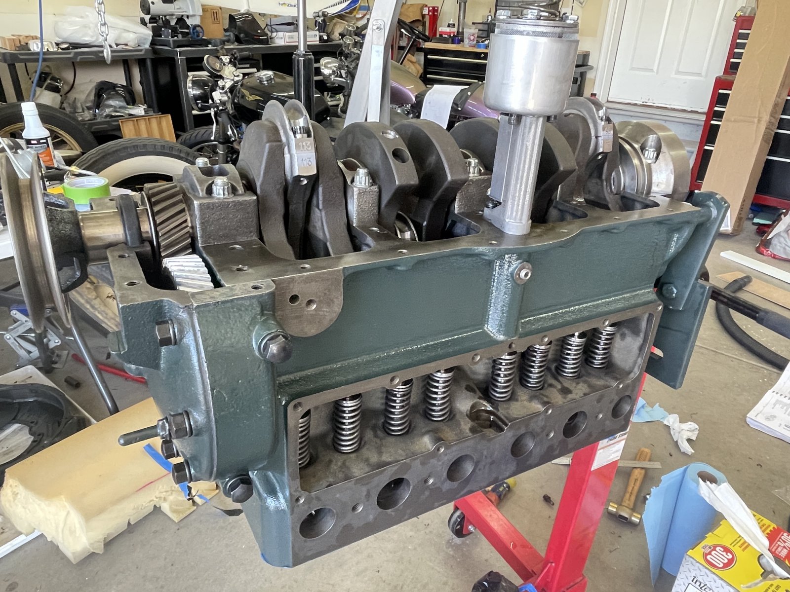

    The bottom end should be wrapped up tonight. Luckily I realized that I installed a bad main seal that had a pretty difficult to see defect in the molded lip. Disaster averted!
    Everything went together within tolerance specs without any major m***aging. Won’t be long til I hear her sing again.

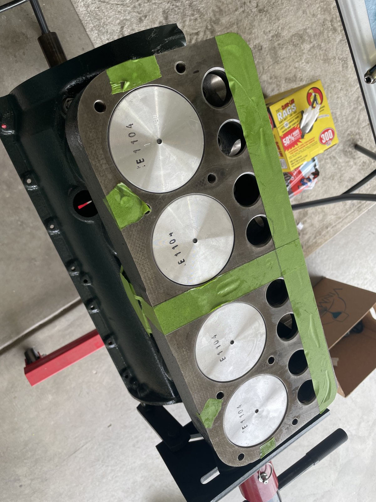

  9. 4bangerbob
    Joined: Jun 29, 2013
    Posts: 152
    4bangerbob
    from AB, Canada
    they went .030" over on the piston bore?

  11. LostInOC
    Joined: Aug 5, 2009
    Posts: 179
    LostInOC
    I ordered .020” pistons because .010” weren’t available until November. I had them sent directly to the machinist. Egge sent .030” instead of .020” and the machinist did his thing according to the pistons that showed up on his doorstep. Not super excited about it but what’s done is done.
  12. LostInOC
    Joined: Aug 5, 2009
    Posts: 179
    LostInOC
    Damn it, you gave me a heart attack….After responding, I thought to myself, what if I just installed 020 rings on 030 pistons!!!! I literally just dug to the bottom of my trash can to confirm I did in fact install 030 rings. The numbers checked out during ***embly but holy ****, that gave me a good scare. B74756B4-8B3B-4CD8-A22A-1C8148346230.jpeg

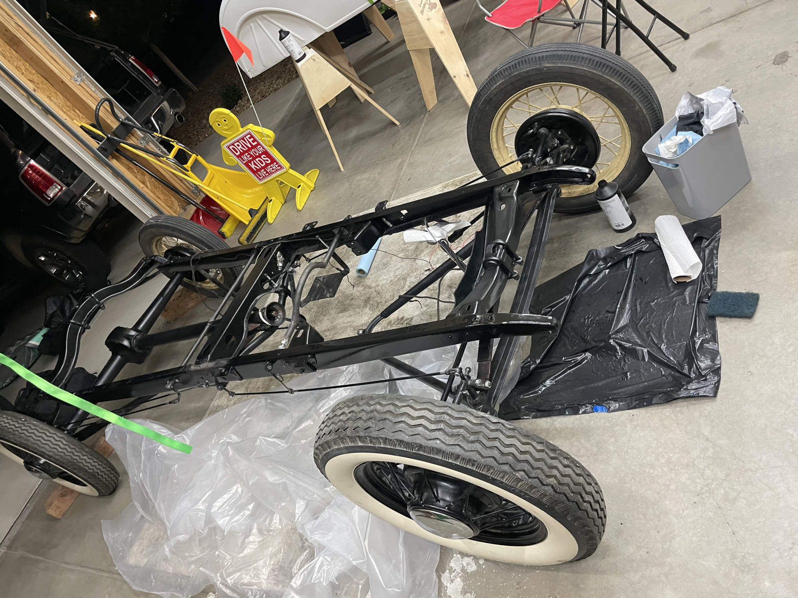

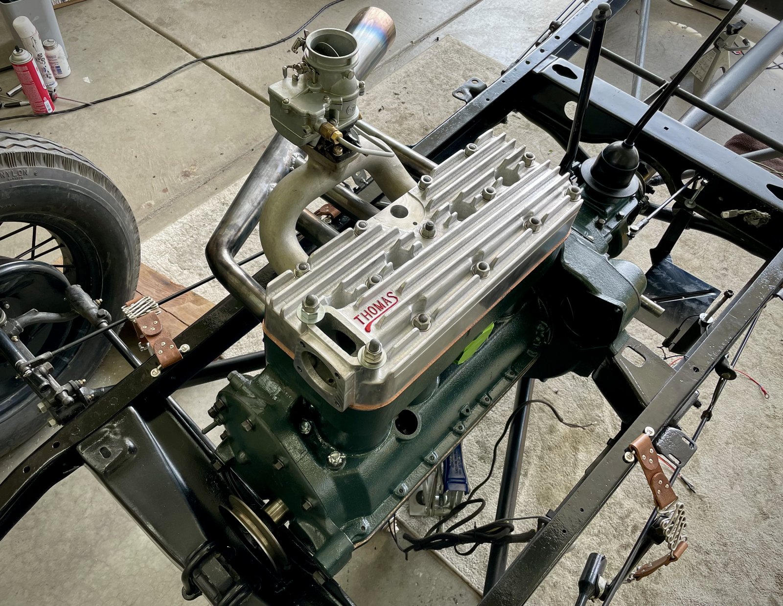

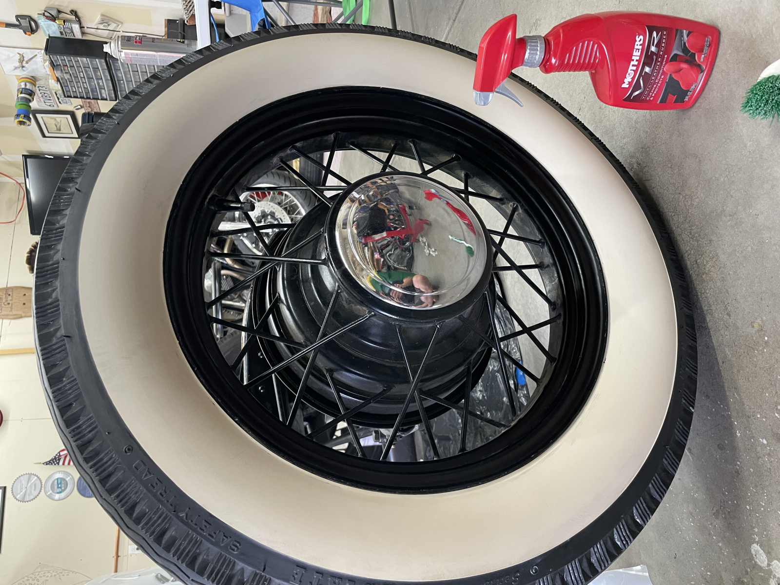

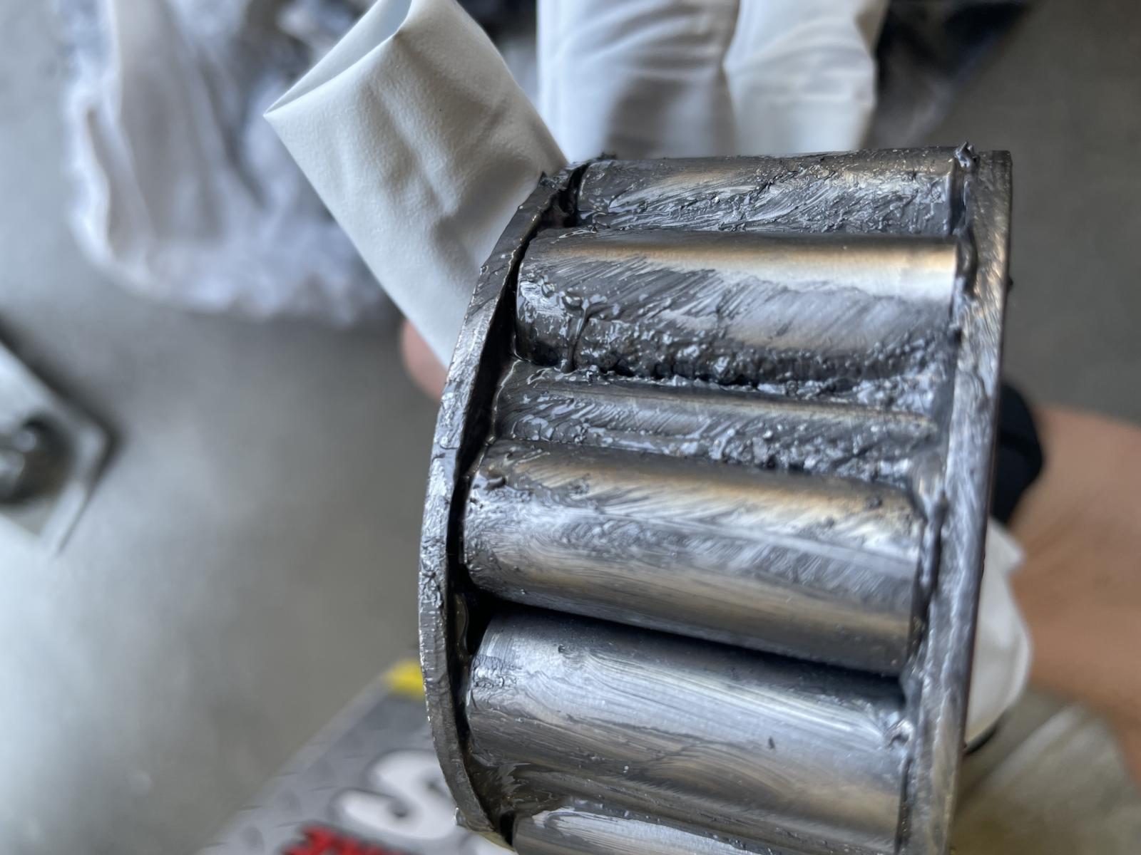

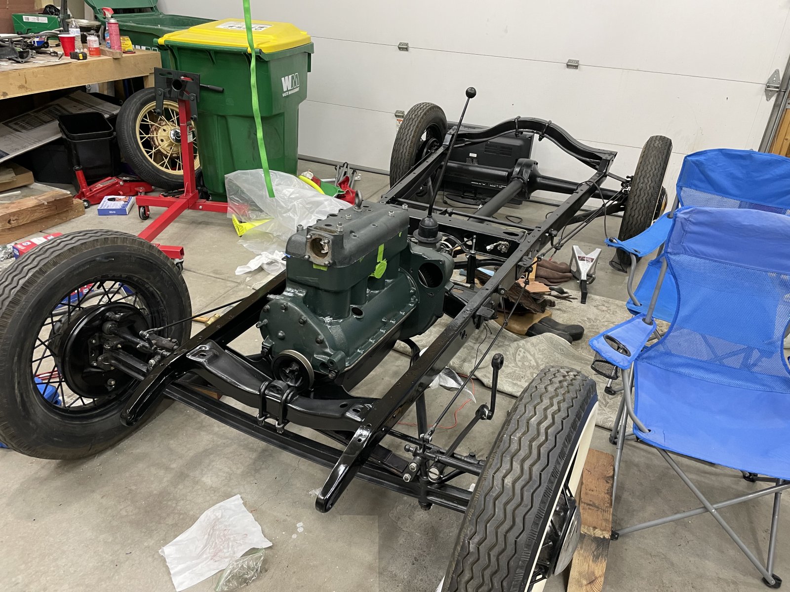

    Got one of them fancy Leonard Nettles high volume oil pumps, man that thing is nice. Pan is on and the valves adjusted: intake- .011" exhaust- .012". Spun a stud trying to put the new wheels on. While taking the hub off to weld the stud, figured I'd take a look at the bearings. Well, you know what they say....it ain't no problem unless you can see it. The rear bearings had that secret magic sparkle dust. New seals, taper shims, and bearings later, the rear should be all set. The frame is now cleaned with some paint touch ups and ready to party with a banger and shifty little ****** this weekend. On a side note, VLR works great for cleaning up those white walls. Body work continues..... tempImageRXg7Ki.png tempImageP8eTb1.png tempImage4D9IQU.png tempImagefMm1MP.png tempImageb1jOPx.png tempImageFoDB4L.png

  18. LostInOC
    Joined: Aug 5, 2009
    Posts: 179
    LostInOC
    Many swear words to get here. The frame spreader I whipped up saved my life, errrrr, I mean marriage.
  19. Six Ball
    Joined: Oct 8, 2007
    Posts: 6,959
    Six Ball
    from Nevada
    That looks great. What paint did you use for the ch***is & the engine.
  20. LostInOC
    Joined: Aug 5, 2009
    Posts: 179
    LostInOC
    Thanks Six.
    The engine in Snyders Ford Engine Green, running gear is VHT ch***is and rollbar gloss black, and the frame is good ol’ Krylon. The Krylon isn’t super tough but it’s a snap to touch up and it seems to hold up to oil, grease and gas pretty well.

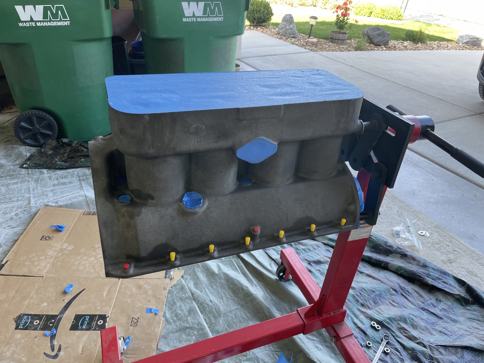

    Cleaned and polished the head and side cover for go not show. The power washer really worked great for getting the crud out of the jacket and blasting away the black gook left over from polishing. Finished cleaning and reinstalling the output shaft clam shell thing-a-ma. Mocked up the intake and exhaust, because why not. Starting to get pumped again to get her moving. Seriously contemplating painting just the firewall so I can get the body back on to take the old gal for a spin. Figure I can finish the body work and paint with the body on the ch***is. BB3A0D39-BA23-438E-BCFF-CBB7D8733347.jpeg 3EA662CC-B368-4239-B5FF-B6E64EC41A47.jpeg

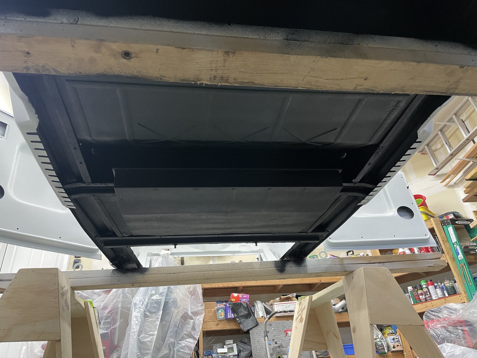

  23. LostInOC
    Joined: Aug 5, 2009
    Posts: 179
    LostInOC

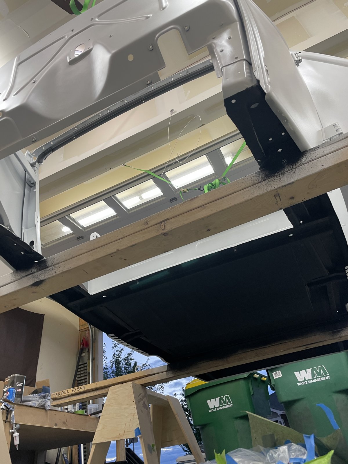

    Paint gets shot on the inside and firewall tomorrow. My helper says peekaboo. 268F4B77-C0E9-4B2E-99A9-0F4528F4EE2D.jpeg Wish me luck!
    41 GMC K-18, Okie Pete, brEad and 3 others like this.

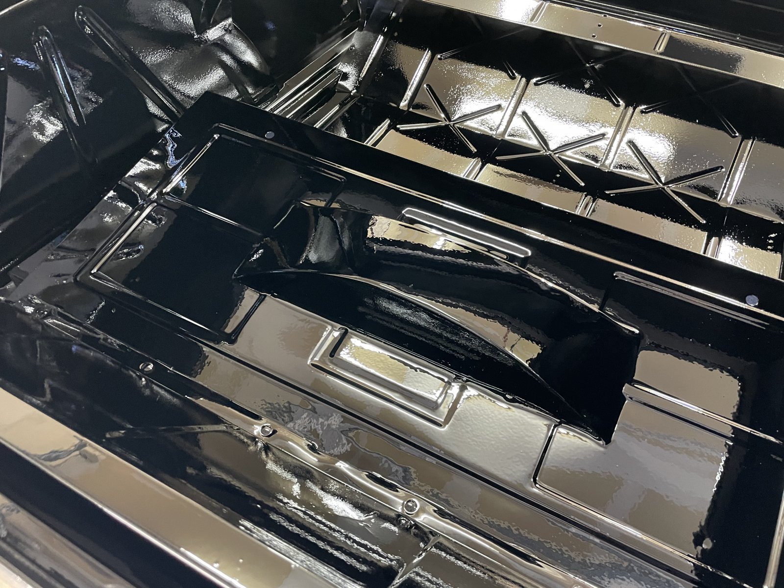

  24. LostInOC
    Joined: Aug 5, 2009
    Posts: 179
    LostInOC

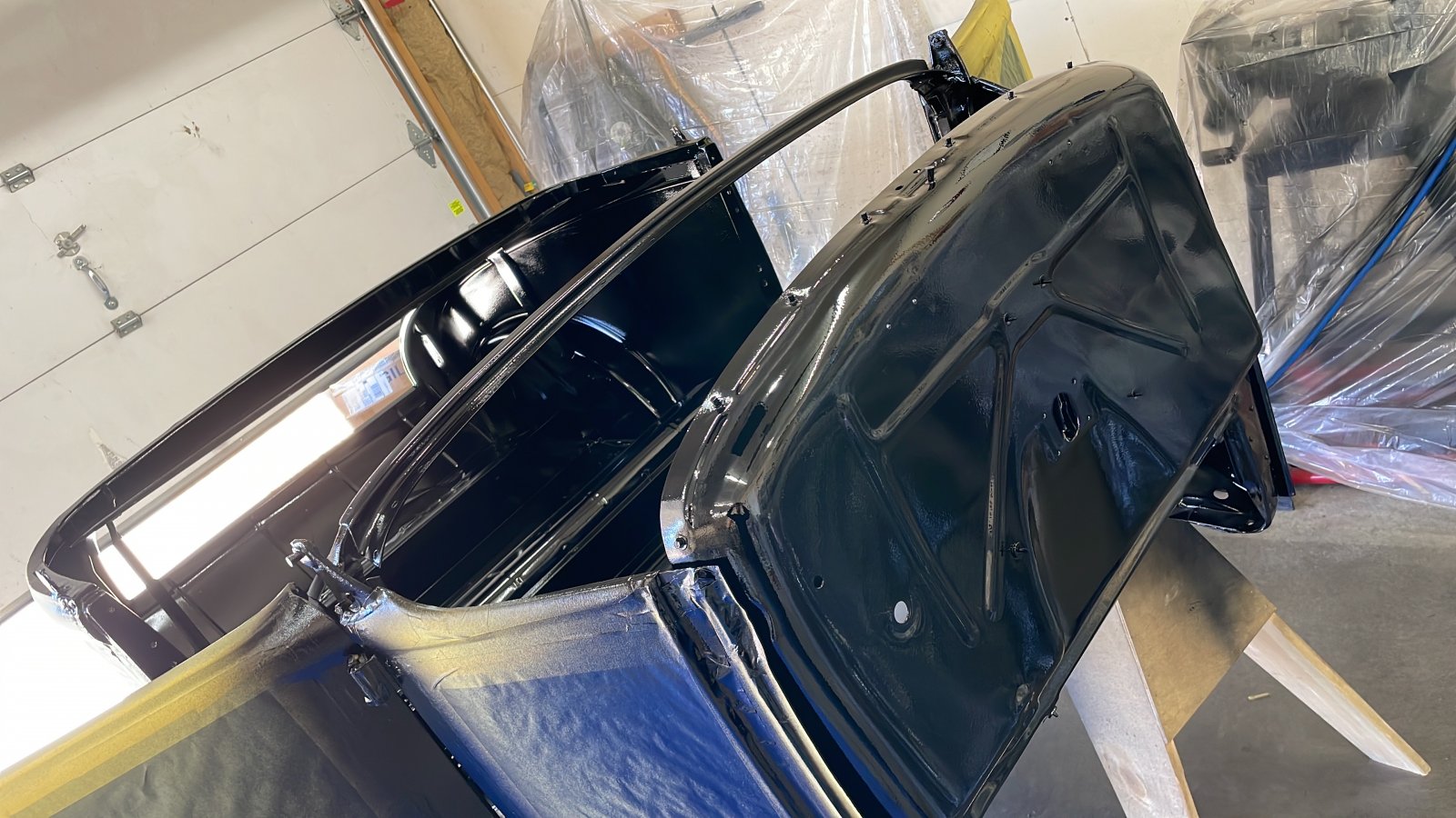

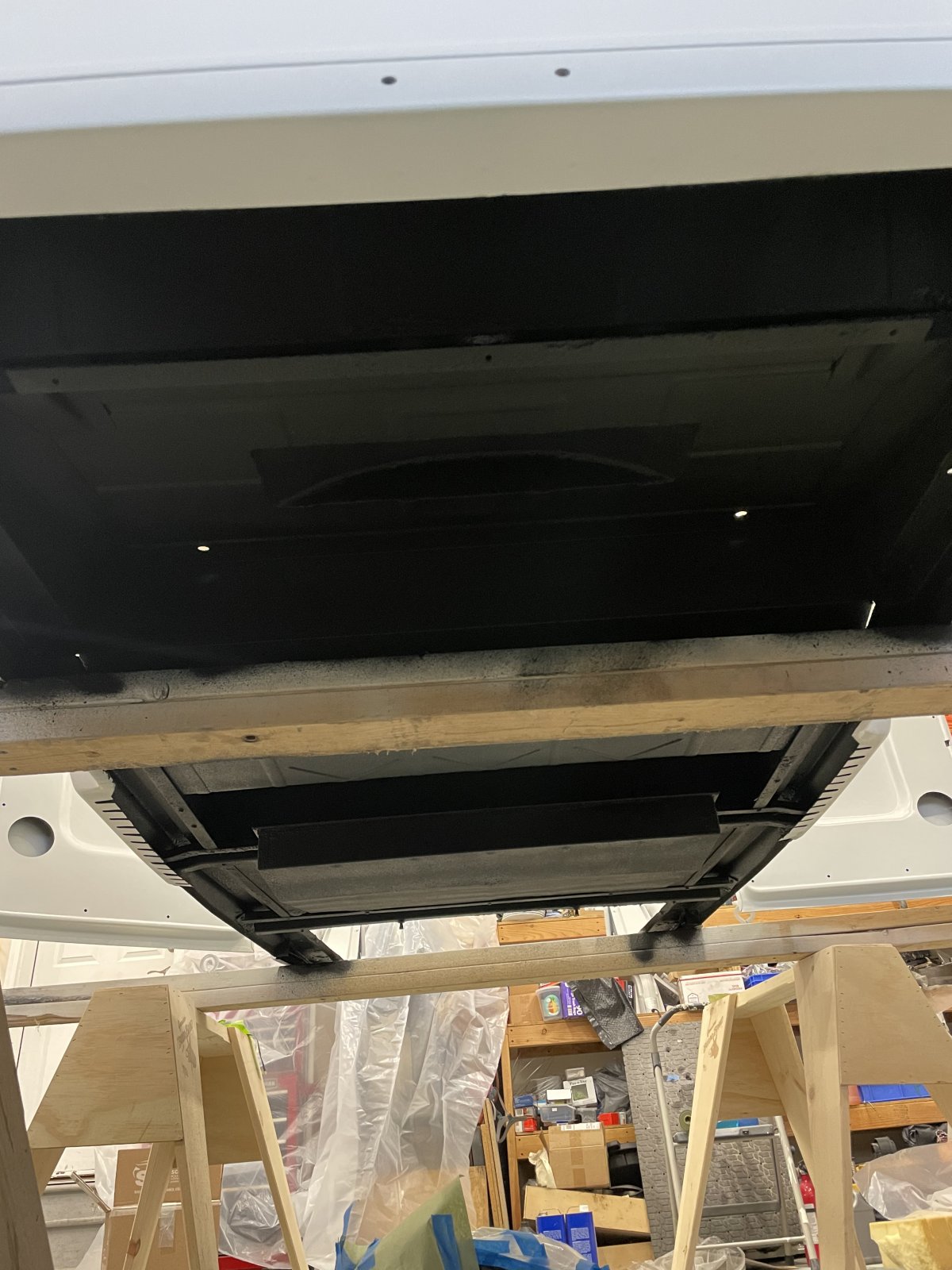

    Lots of fun and 75A76898-0E86-40F1-8439-547AC660CF6E.jpeg 5EE74651-FA91-4079-B246-1486A533F6D2.jpeg 2AC1C86B-F435-4AF9-B91F-3A770CDB63B1.jpeg I learned a lot. Glad I’m doing this on the inside before attempting the outside. All the funny angles and nooks n crannies made this difficult. Some runs, some orange peel, and some really great spots. This is black magic I tell yah!
    41 GMC K-18, Tim, Okie Pete and 4 others like this.

  26. Six Ball
    Joined: Oct 8, 2007
    Posts: 6,959
    Six Ball
    from Nevada
    That looks very nice! It will give you some peace of mind to know all of that is protected.

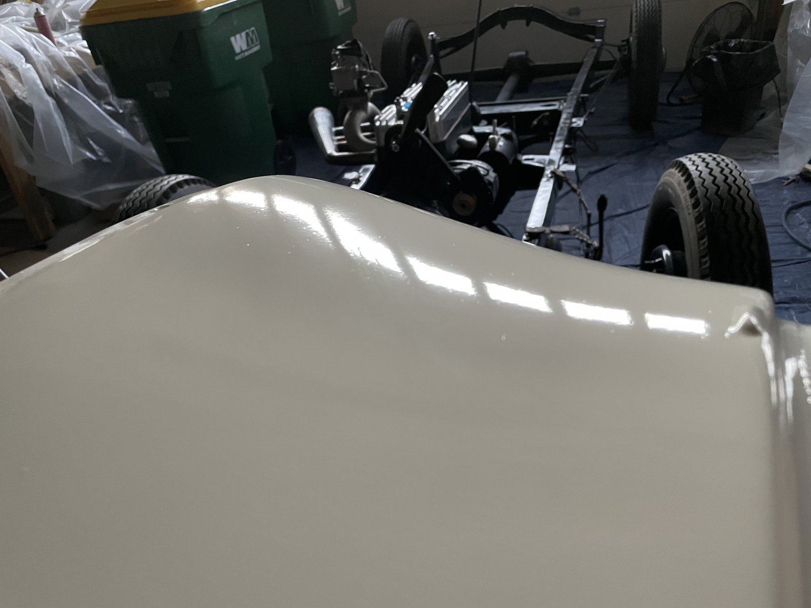

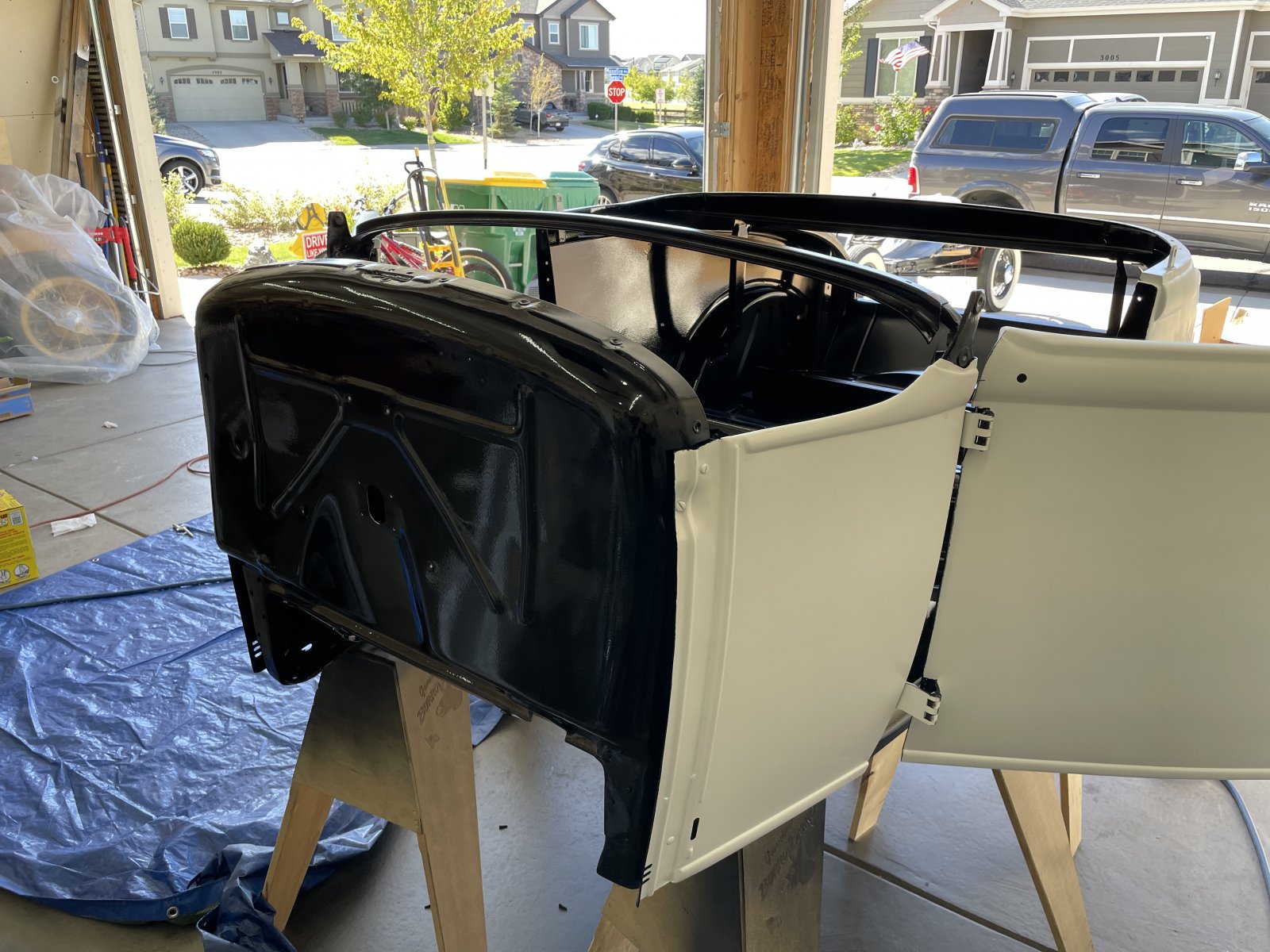

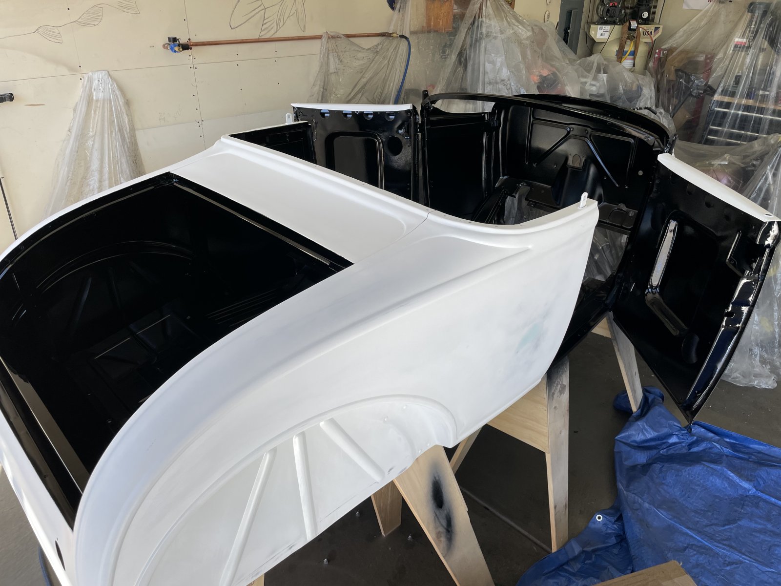

    More paint. Wish the black stuff laid down as nice as the white stuff…

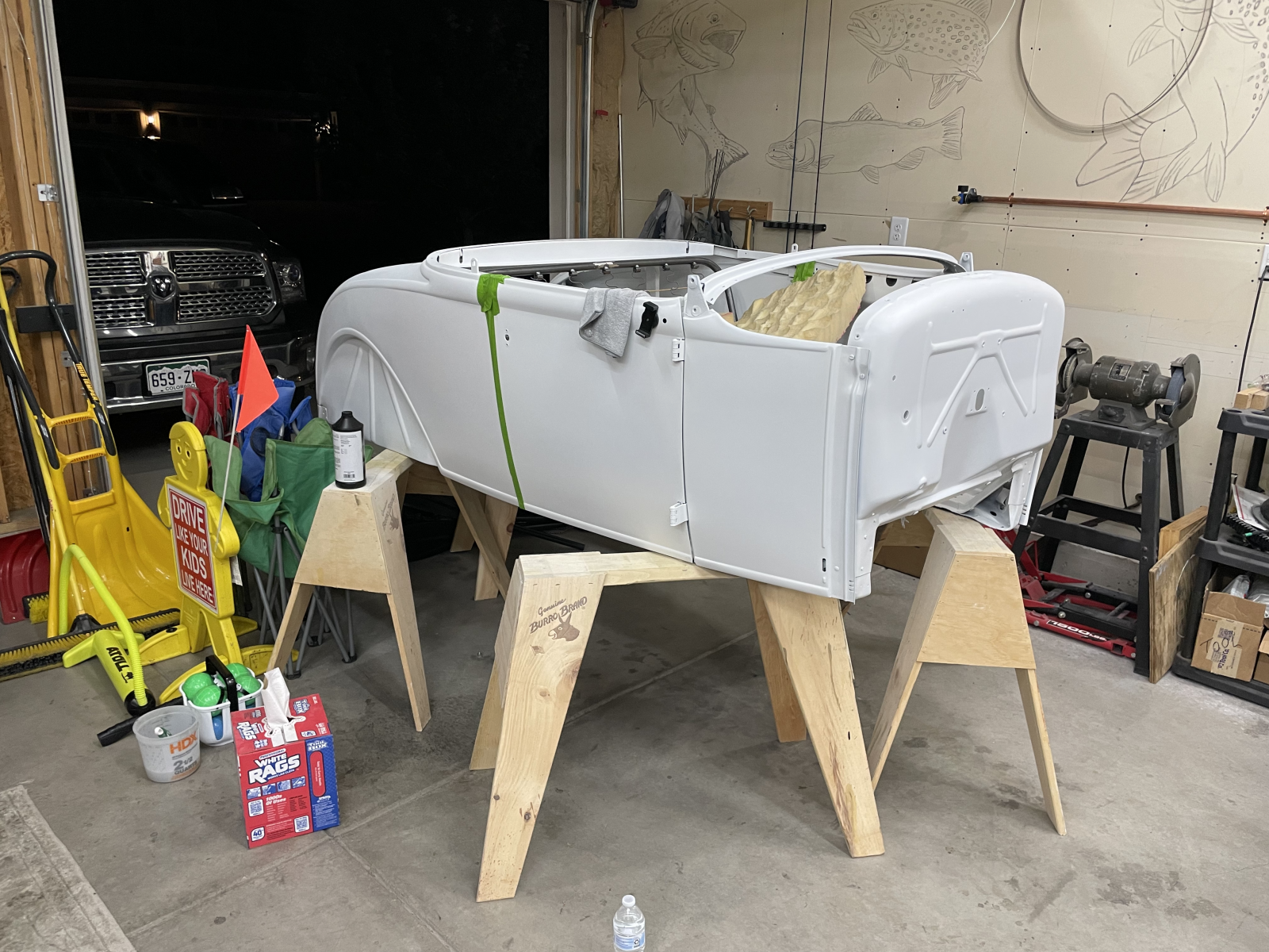

    So this happened today. What the hell is going on over here? 138CEB92-C326-4FF7-951D-6DAEF3D29864.jpeg

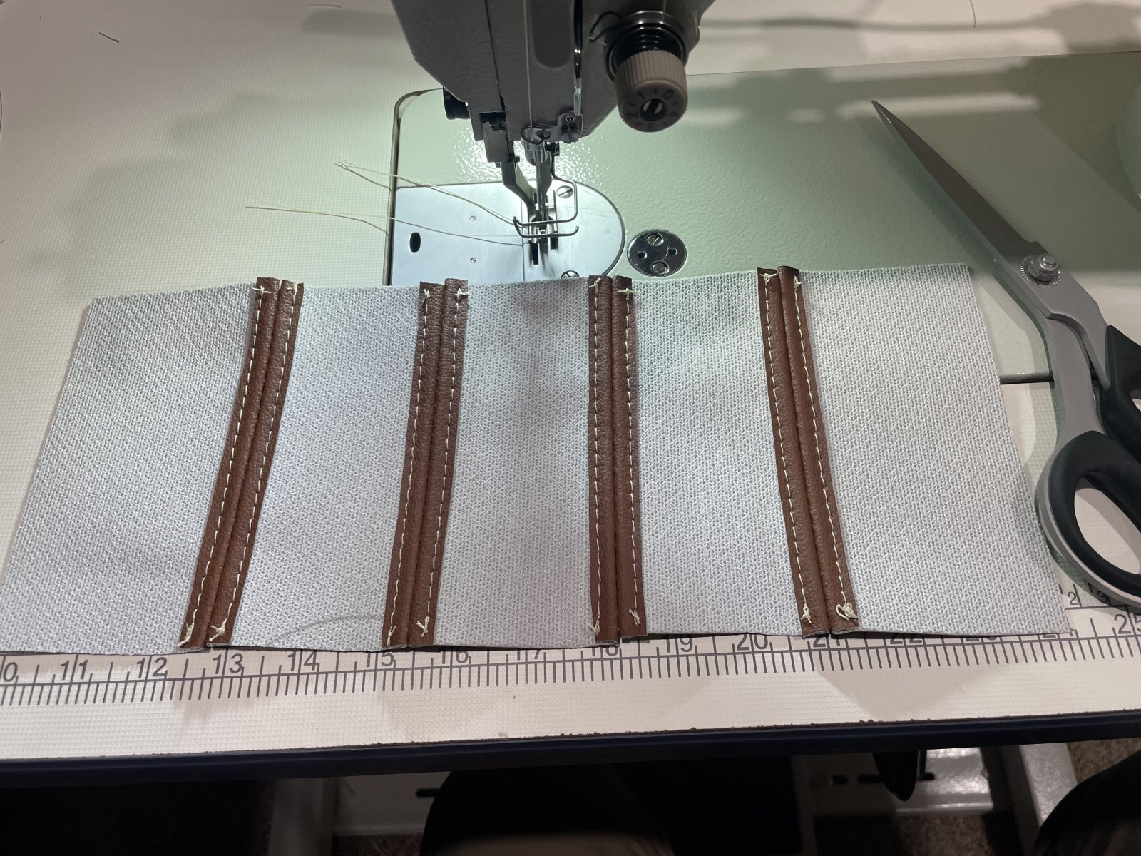

    First test panel.
    It’s not the best but certainly not the worst. I think this is doable.
    Funny thing….my wife is on a business call while I’m sitting at a sewing machine.
    “You know, times are changing. Ladies can do stuff now and you're going to learn how to deal with it.”
