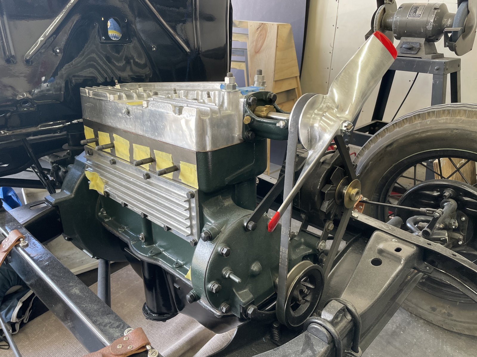

    Now it’ll fly!

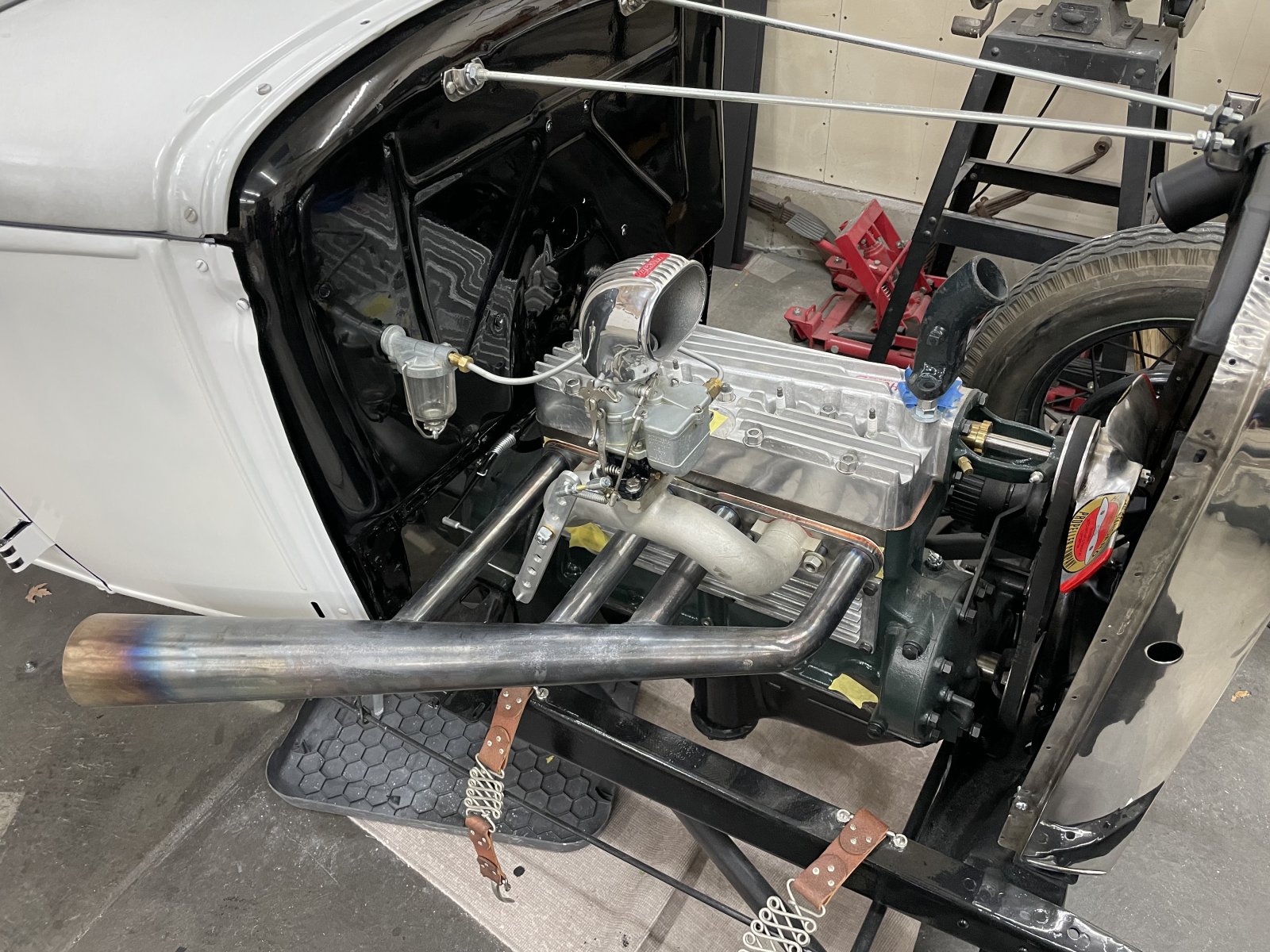

    Got a wild hare to strip the fan and polish it up like an old prop. Made sure it wasn’t too blingy. Body is on for good and the doors close nicely. Running out of time to paint before the cold weather sets in. May need to wait for spring to lay down some color. 0BEAF632-DEFB-4841-949F-E1DEF6D47A4D.jpeg

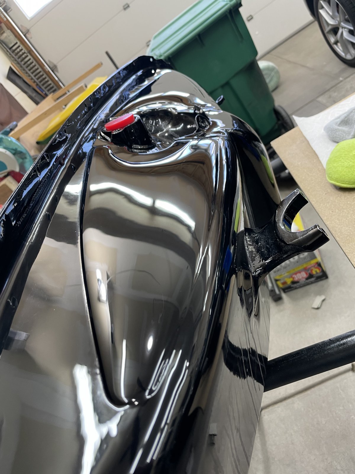

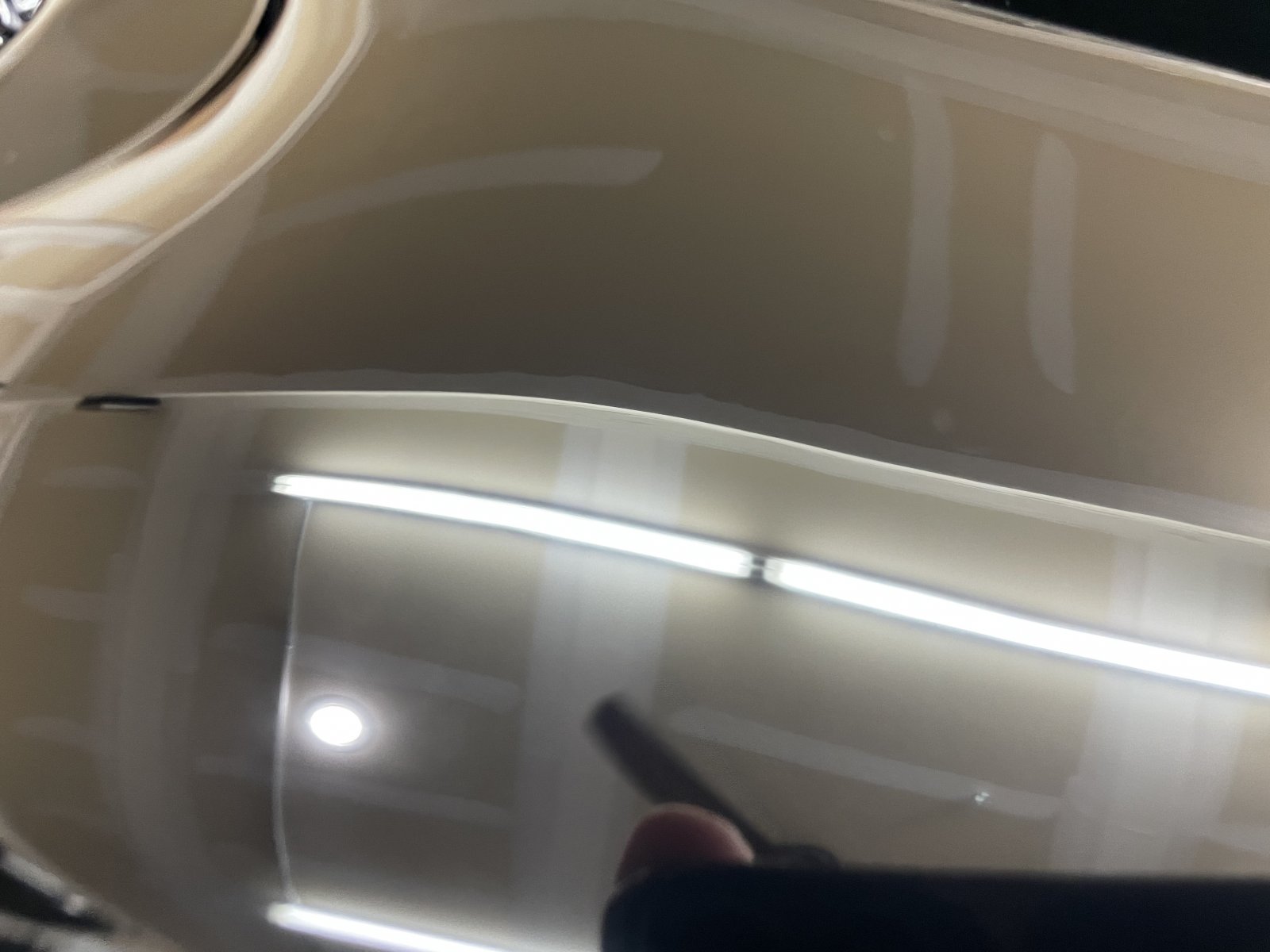

    Cut and polished the tank. You can polish a turd!!!
    Got rid of all the fish eye and 99.99% of visible scratches from 4 days of sanding.

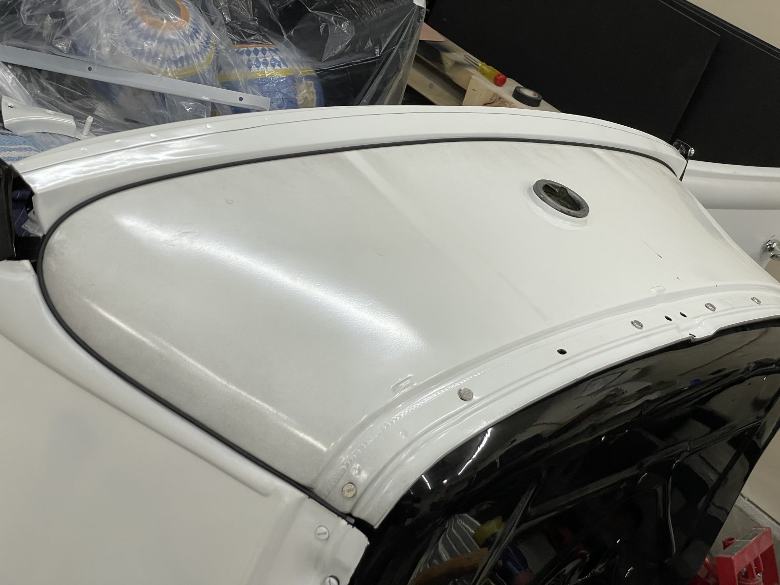

    Tried to install the tank welt tonight. What a pain in the ***. Contemplating leaving it off. Worried the the welt line will crack after painting, like every other A I’ve seen. What are some good options?

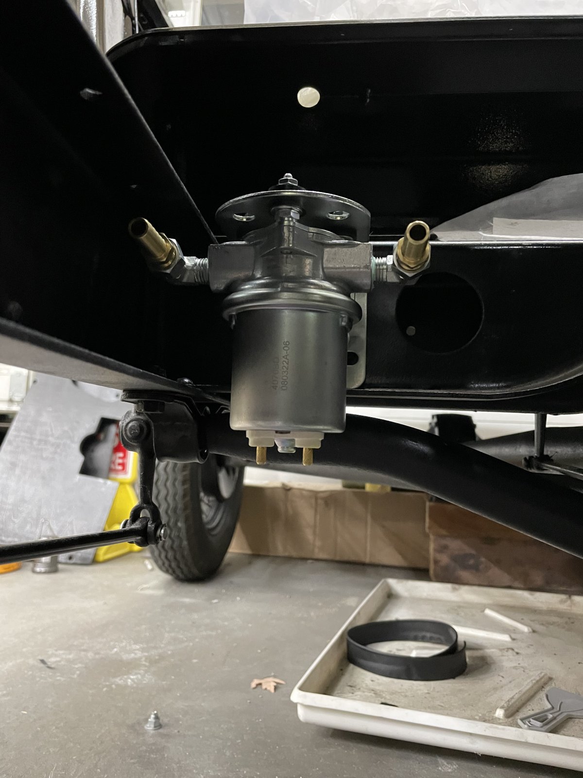

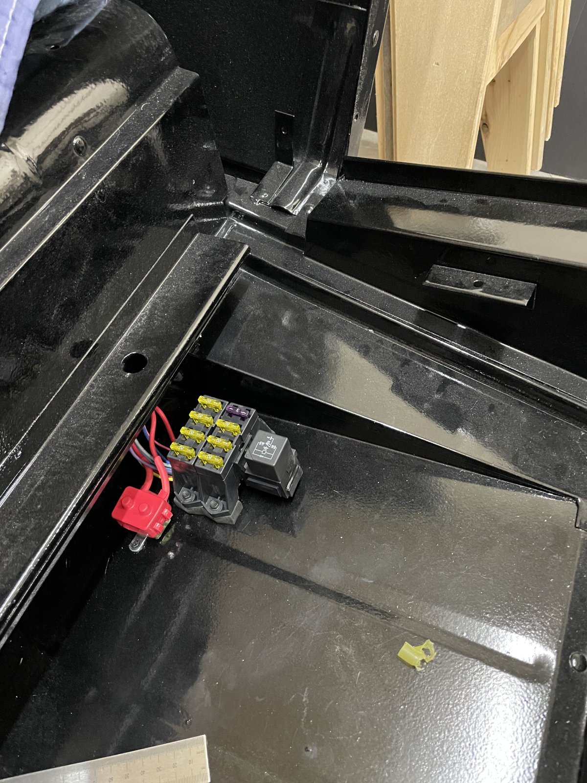

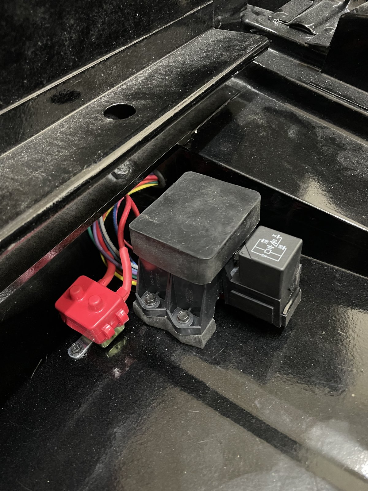

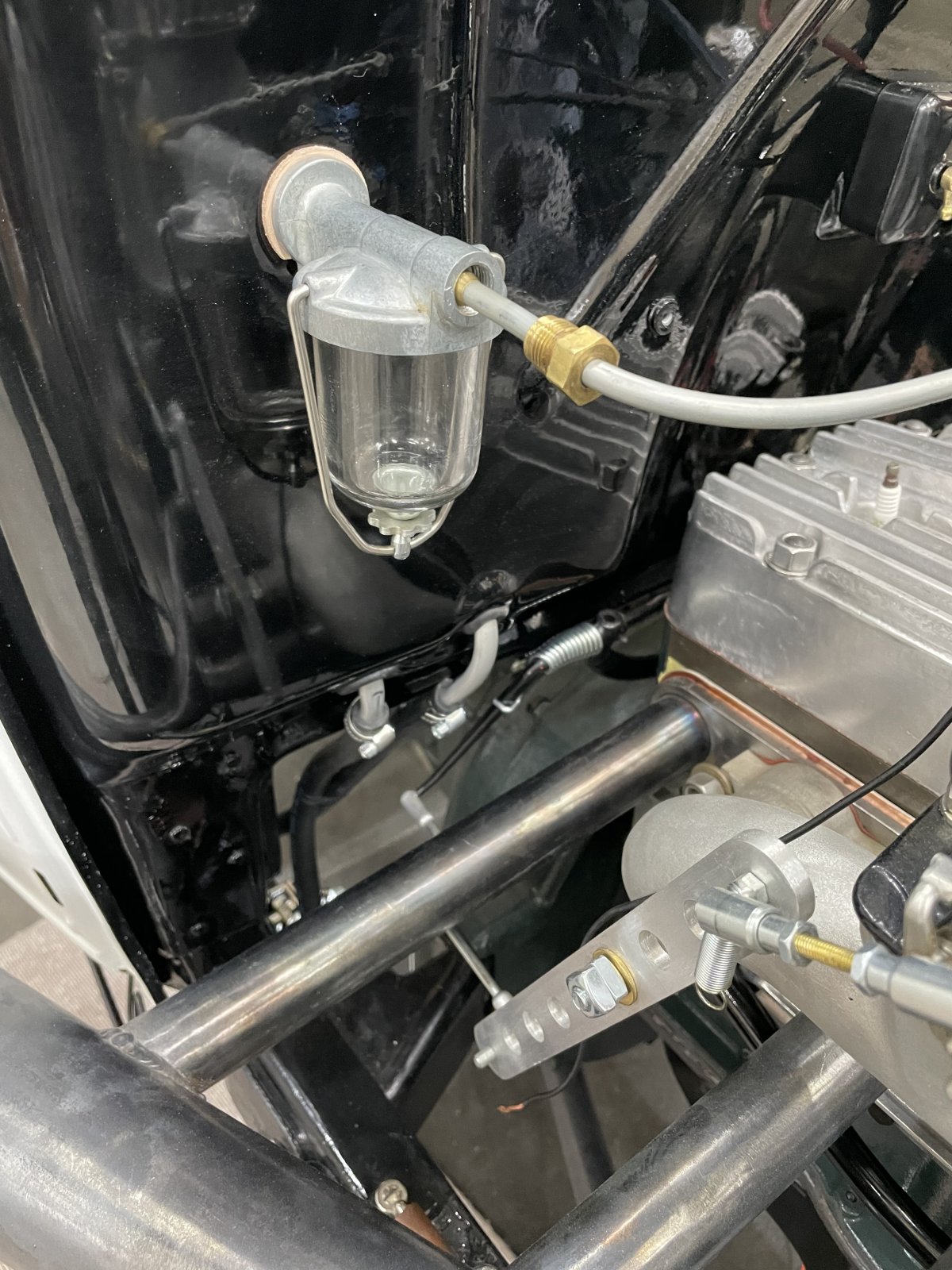

    Installed one of them fancy *** Carter fuel pumps and now have all sorts of fancy *** challenges to get everything plumbed. The goal is to hide the pump and regulator behind the firewall so all you see firewall forward is the gl*** bowl and fuel line. Got the new radiator in and polished the shell up a bit. Couldn’t resist mocking up the intake and exhaust with the newly scored Thickstun air scoop. Damn it, I’m getting antsy to drive the car!!!!! Figured it might be a good idea to put a small fuse box up in the drivers side cowl area now there’s a bunch-o-e-lec-tronic doodads going in.
    Looked at all the old receipts today, that was dumb.
    She needs a name, whatcha think? 404ED875-30A3-4B96-A503-44B3F7D67EF8.jpeg B4596543-4345-4AAF-9CE2-12E732629B00.jpeg 2002BE4B-867A-4A27-BD9F-2B0FC1CC974F.jpeg 6E104005-EB34-4D41-896C-928160369096.jpeg 944CE16A-2789-40B1-8967-2F2D674AB2C0.jpeg

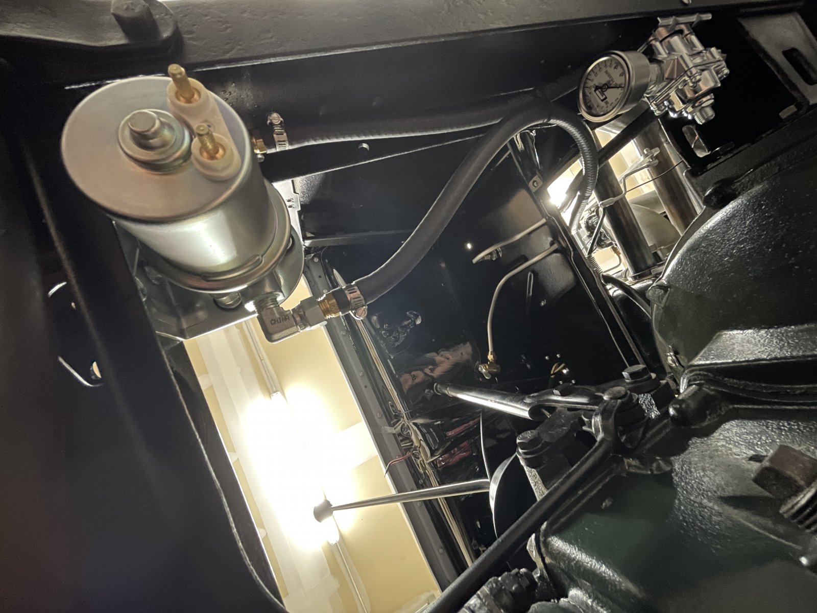

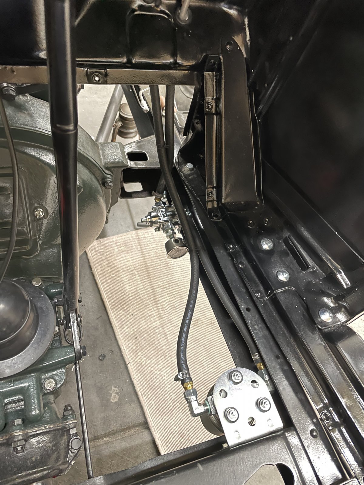

    Fuel system is in place. Tried to minimize the visual impact from outside the car as much as possible. You can just barely see the fuel in and out lines exiting the firewall below the gl*** bowl, outside of the firewall.
    The routing is as follows:
    Tank valve>Hard line through firewall>soft line>carter pump>soft line>Holley fuel pressure regulator>soft line>hard line through firewall>fuel bowl
    All the hard lines through the firewall are protected with rubber grommets. Not super excited about how pliable the aluminum “hard line” is but at least I have great patterns for future steel lines if the aluminum proves to be an issue.
    Bought a fancy *** Optima red top battery and installed it, electrical to come. Cooling gets plumbed next, then it’ll be time to start the car.
    Good luck making heads or tails of the pictures….
    9EE1EF21-0D32-439A-B551-1C790610B491.jpeg 4E7EDC49-55FF-4C2A-AB45-1FFA9C0FD0F4.jpeg 2F28E232-74A7-48DE-9153-DBDD61961D7A.jpeg

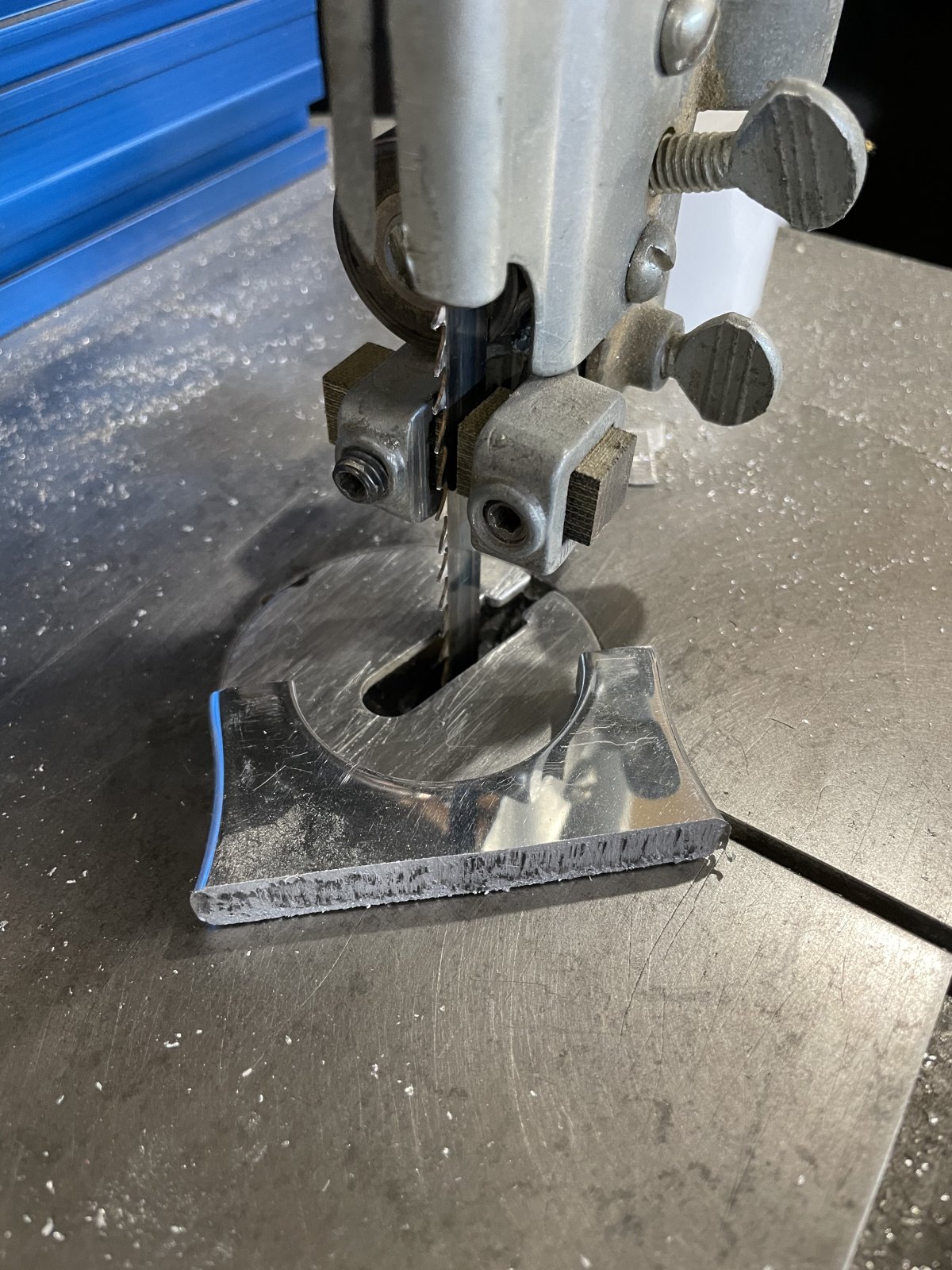

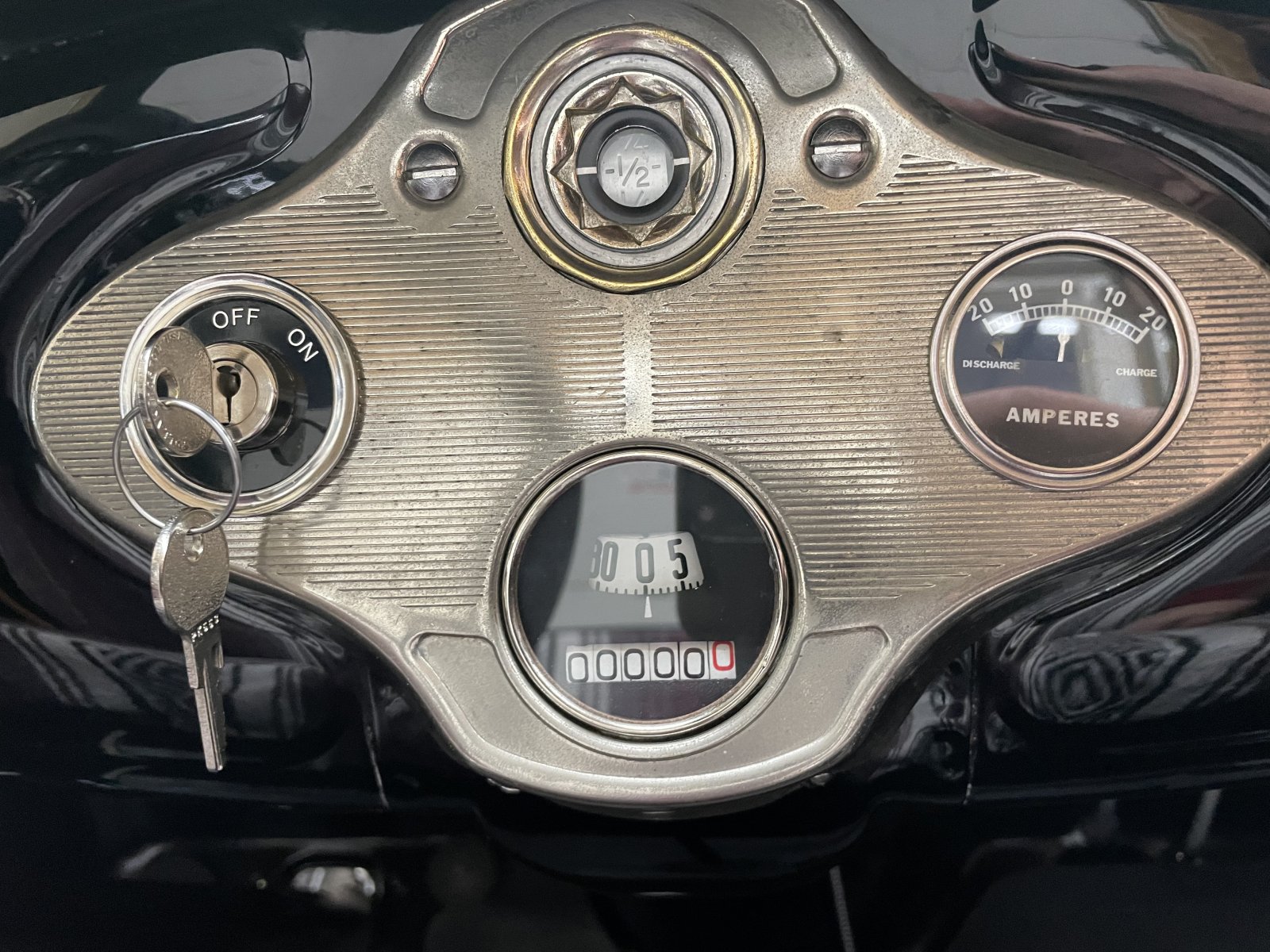

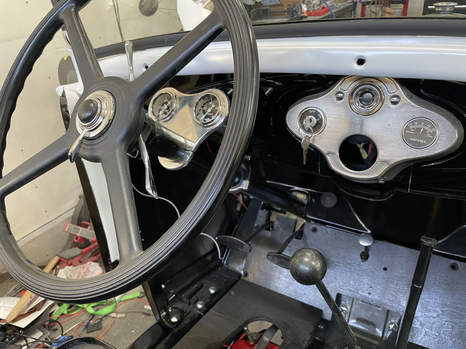

    Gauges are in and wood is stained/finished in spar urethane. Bought a fancy polished aluminum column mount but it was too tall. A quick trip to the bandsaw, grinder and drill press solved that. Everything works as it should. Now just a little tidying here & there and she’ll be ready to cruise around the block. 21BEF477-FED4-4E39-8453-E8D2DB225E5D.jpeg 7EA0E90F-0B43-43F3-A86E-BC6906443A51.jpeg 4C79B2A8-7D42-46DB-A891-ECD4B014F951.jpeg 54F744ED-5D42-485A-A0E8-46B0A8E3245F.jpeg

    At least when I don’t get pulled over for speeding, I’ll know how fast I’m going (speedo installed). Also, replaced the brakes.

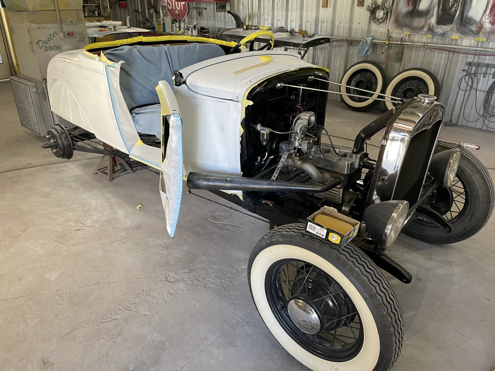

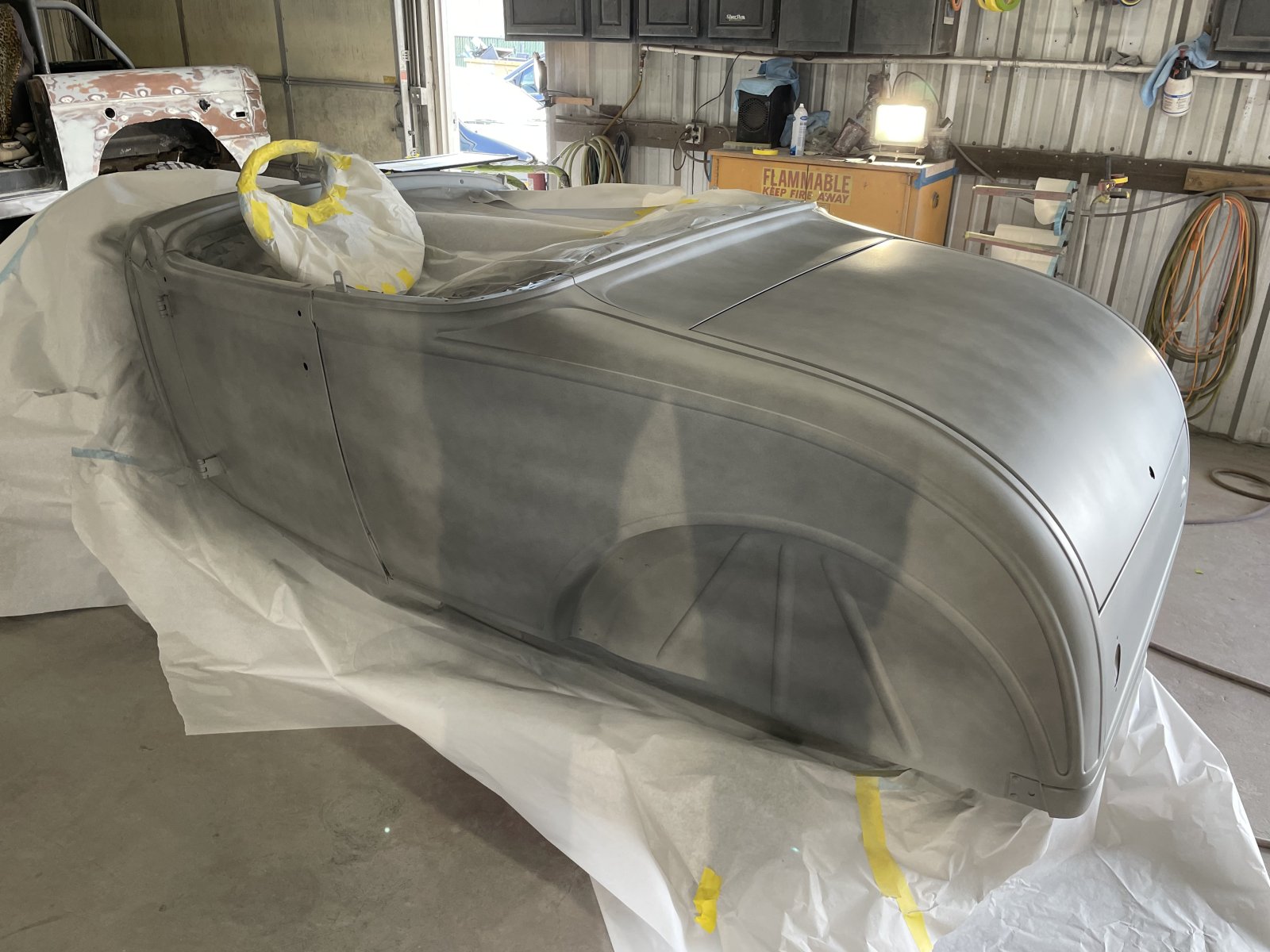

    Still not certain the car should be black. Found some vinyl wrap in blue grey for poops n grins. Tried a spot to see how it looks. Whattaya think…..blue or black? C172B4E4-00DF-4576-B69A-307FD7834606.jpeg CF59191C-7D9B-4211-A18D-E395B2C7313A.jpeg

    MY basic rule is that real hot rods are black. At least it is a safe bet and saves an otherwise nice build from being spoiled by a stupid color choice. That said I like that blue. You could vinyl wrap the whole thing and avoid runs & over spray. :rolleyes:

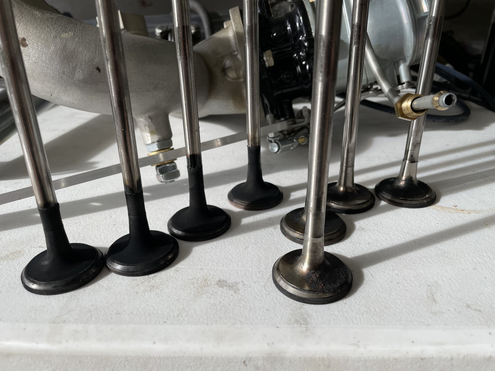

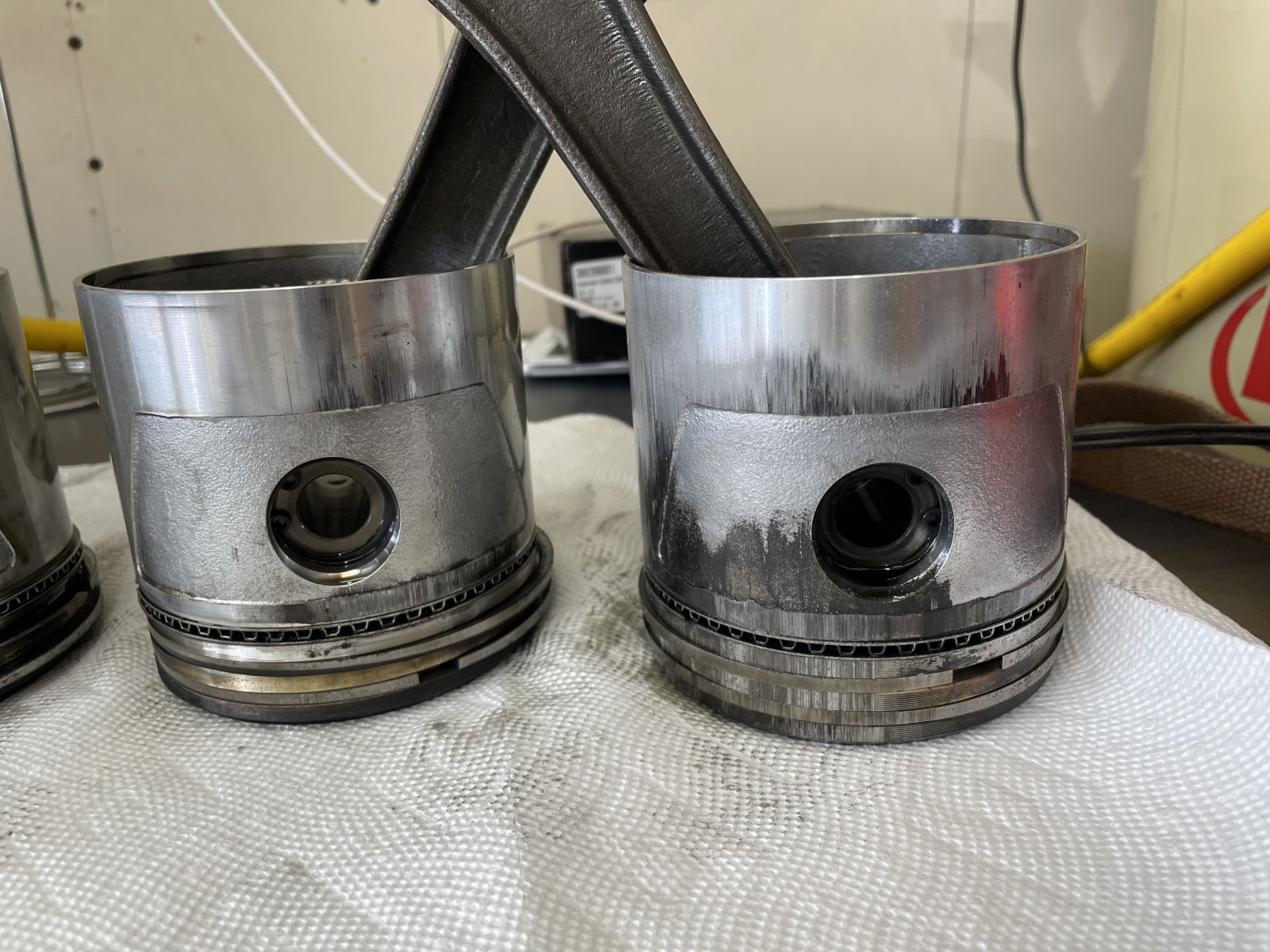

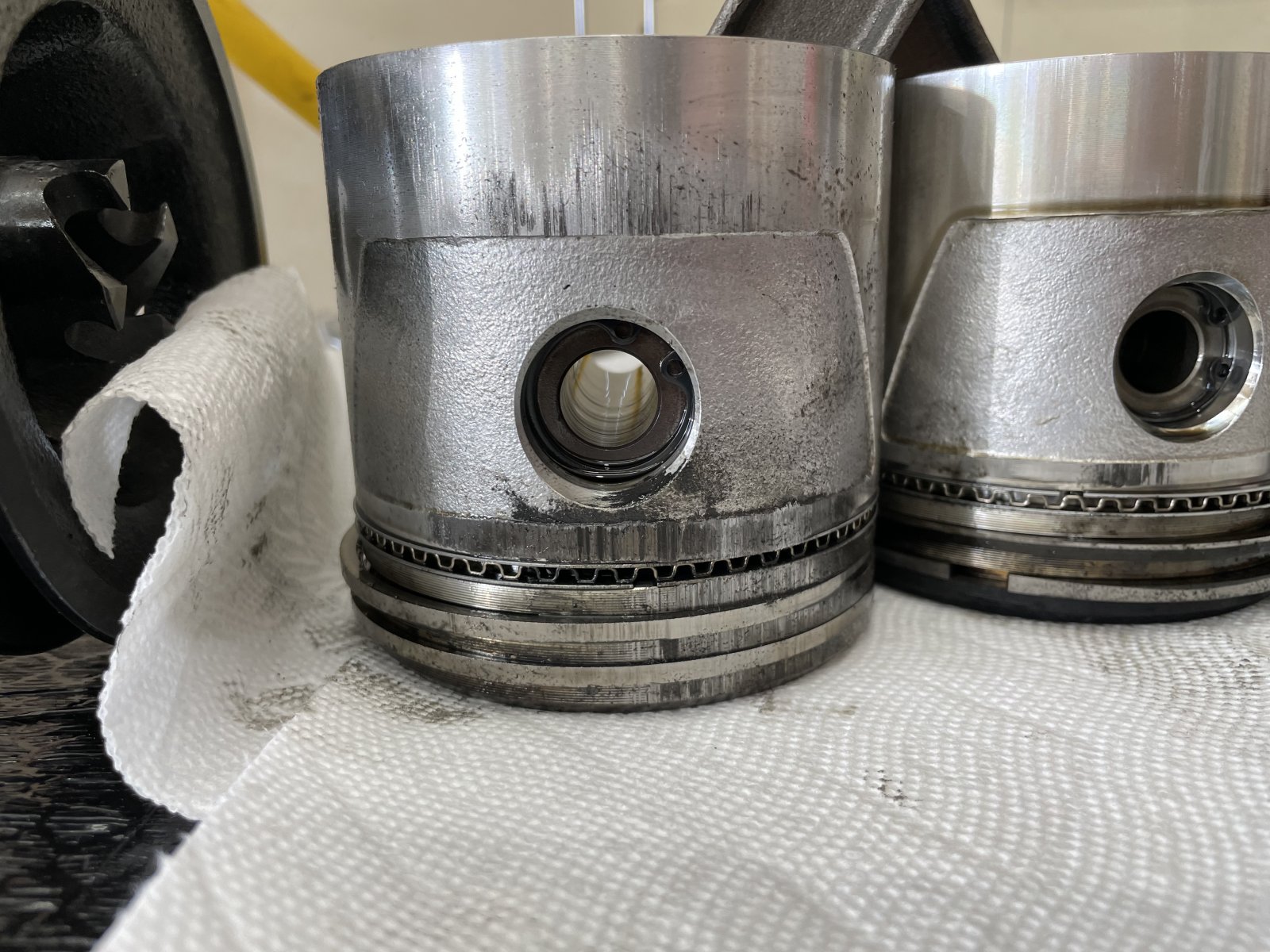

    Maybe mixture to lean....
  24. LostInOC
    Joined: Aug 5, 2009
    Posts: 179
    LostInOC
    Fully rebuilt the engine and am now running the same mixture, never gets above 150°. I replaced the radiator this time around. I believe the old radiator let some **** go and clogged while I was driving. A combination of heat and pistons without expansion slots led to the issue. I now have Egge pistons with expansion slots and a temp gauge to keep an eye on things. Knock on wood, haven’t had a single hiccup since the rebuild.

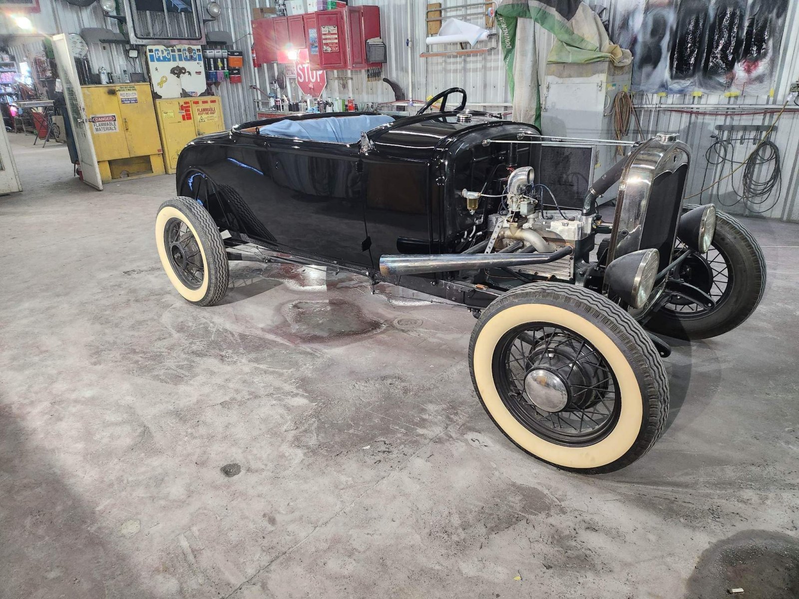

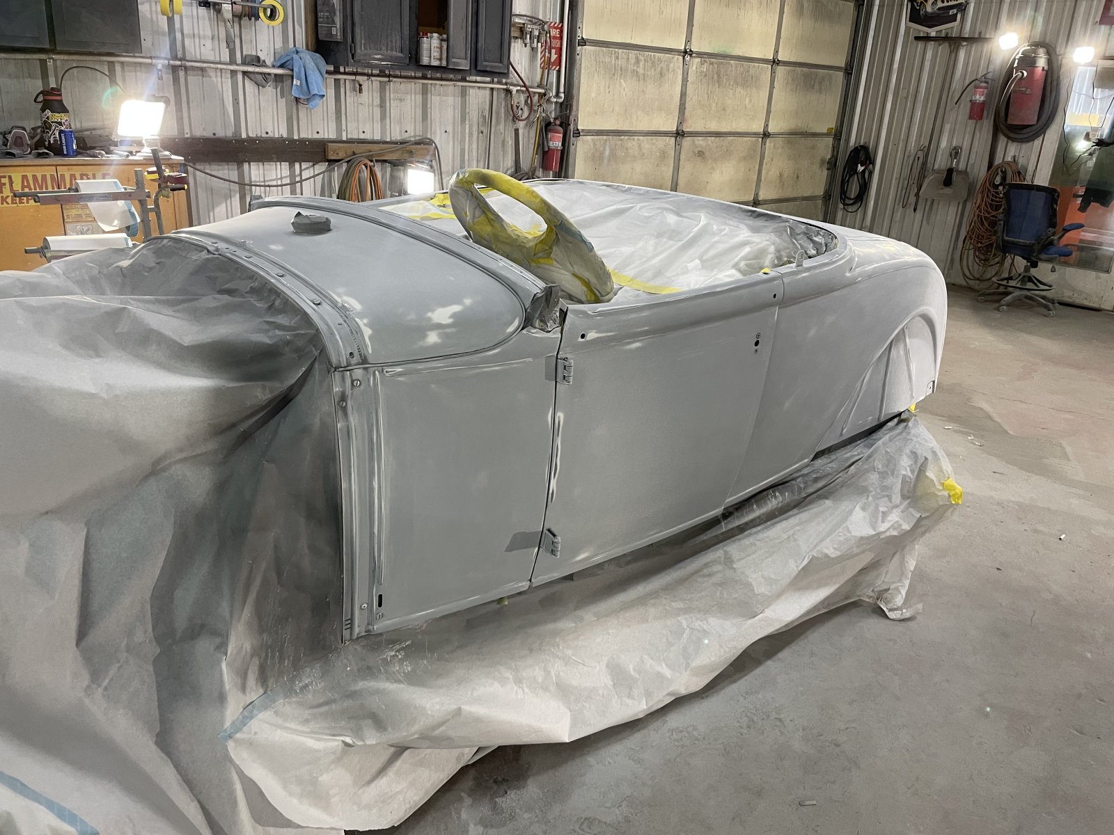

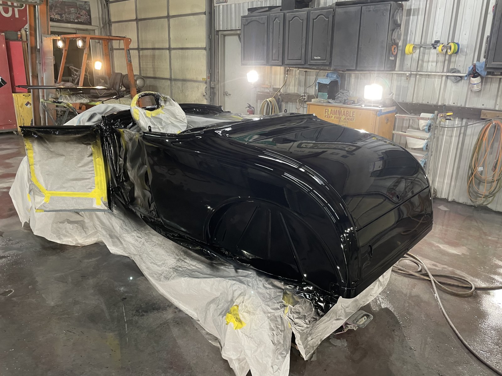

    LostInOC

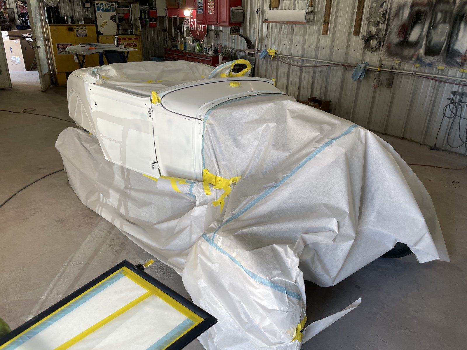

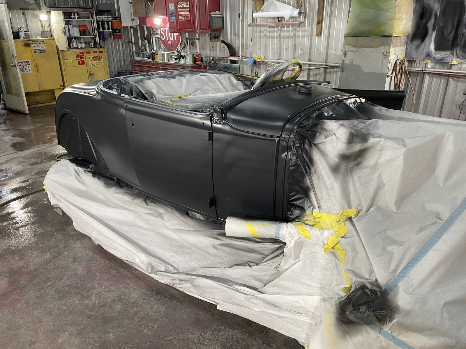

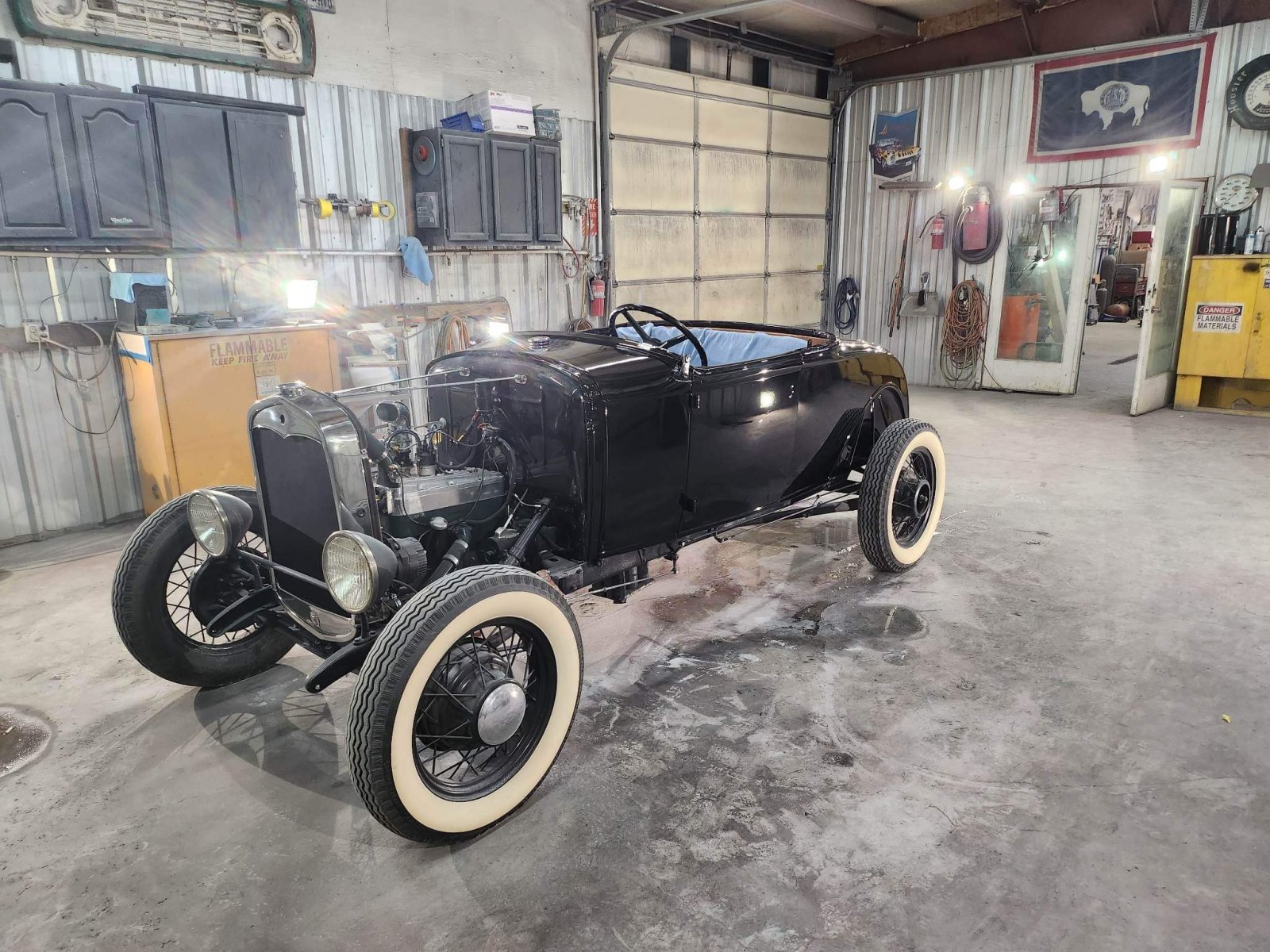

    Finally getting some color on the car. Pretty cool brother team that owns a local old skool shop with some really neat stuff on the property shot it. Cut and buff this weekend. 75AB34A8-AECB-4B20-BD46-C0B67819E827.jpeg 27BC22FF-71E1-4C41-88F4-F65B3AD0440A.jpeg 6CC351DB-632C-4843-BE10-F939EB51782B.jpeg C2A36940-10C7-4CF4-AB3C-36D45A818175.jpeg 31A06BB4-08FE-4DFF-9EEC-E103DFCBF0B1.jpeg D52F314F-16FF-4BB6-A636-DC5C74C56403.jpeg

  28. LostInOC
    Joined: Aug 5, 2009
    Posts: 179
    LostInOC
    I see the pics on my side. Here’s a couple more. Just about to roll it outside. C6739C13-E823-41DC-809D-D820B7B3A9D7.jpeg E63EC57D-F7A4-4921-B540-1EA0BC9D3072.jpeg
