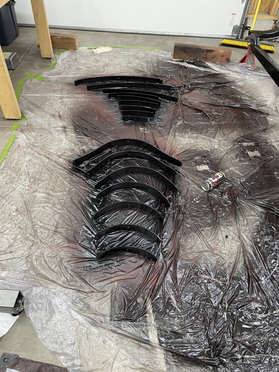

    Aaaaand more painting. My wasted glove had something to say about all this... 0AADFD77-C07F-4BF8-B56B-178C79149360.jpeg 974C1830-FFF6-48BB-986F-66A16EB62315.jpeg DBCD2ADC-6CCE-4CDB-A0E4-21115616DB03.jpeg

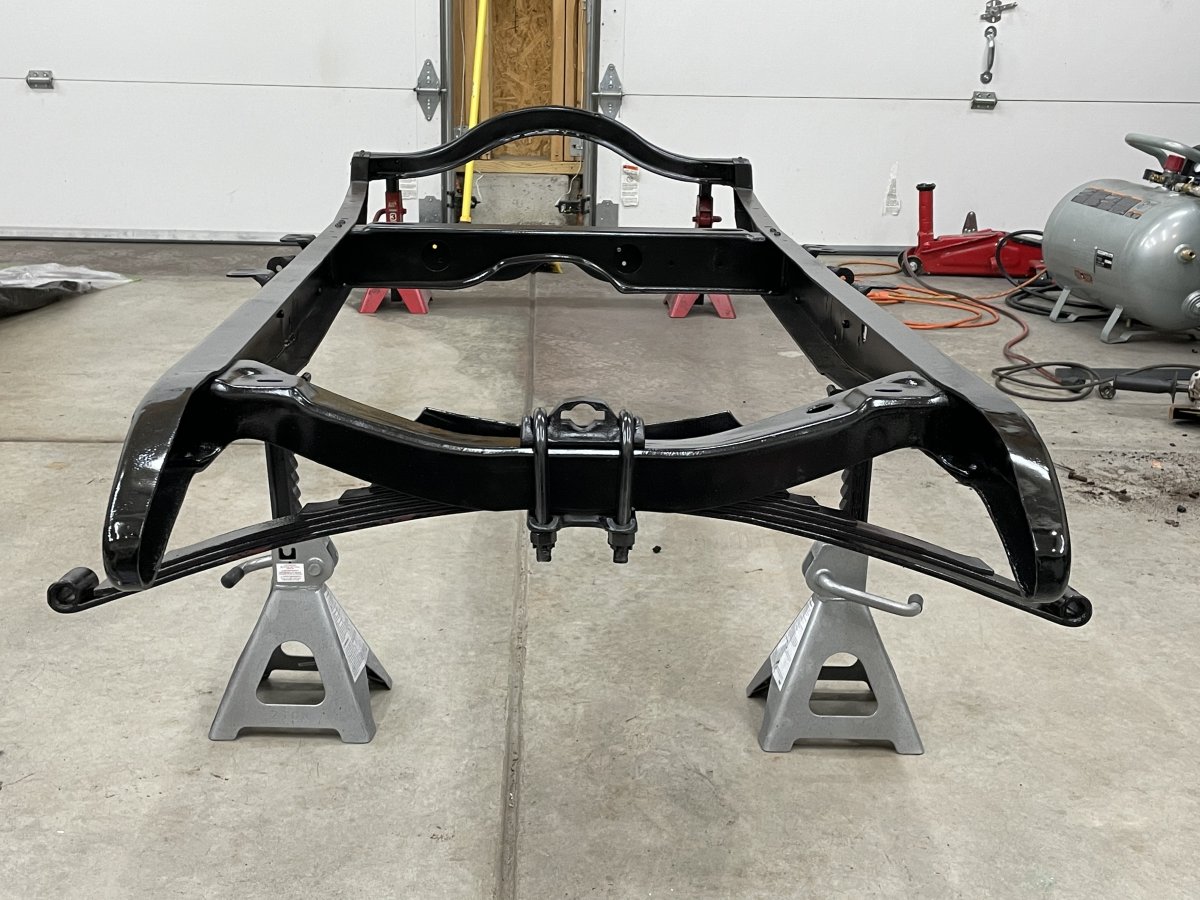

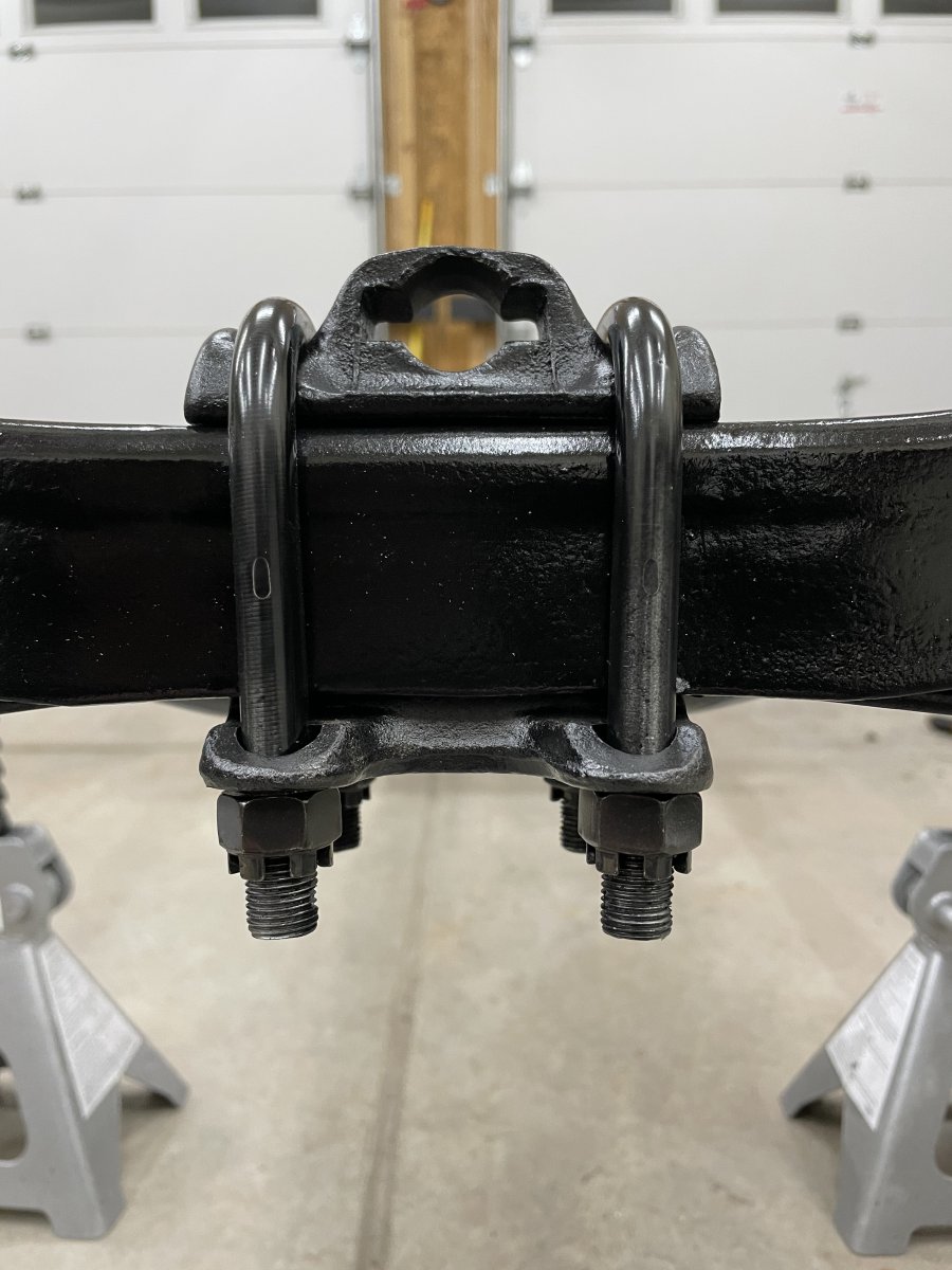

    It’s a small victory but I’ll take it. Had a few minutes to spare in the garage so I flipped the front spring and got it hung on the frame. Right away, I realized the spring doesn’t have all it’s leafs as the u-bolts are a bit long. When I took it all apart, I noticed a bunch of washers on the original cross threaded U-bolts....I now know why. What are some thoughts on sorting this out? I’m thinking: run a die down the u-bolts and re-drill the cotter pin hole, fab up a leaf spacer, add washers, or just buy a new leaf. BF7CF8D9-8198-45A0-982C-E05CCAFE5517.jpeg 92451401-84E6-4348-BBAF-98C946057904.jpeg 64167194-A59B-44FC-BCD3-A04125336B9E.jpeg CDB30DE8-B71A-4983-84D1-83A853BD4144.jpeg

    A spacer like one of these should take care of it upload_2021-1-31_21-26-11.png

    Problem solved, thanks for the tip. DEBC6F4B-2893-41F1-BA56-14D10C66D70B.jpeg
