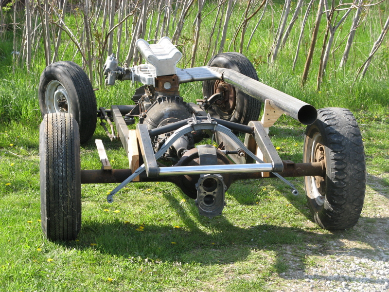

    Nice project. On my champ car build I was not sure I could pull off making a champ car body. So I built the chassis first to accept a '27 T body. In case my efforts at making a body were a bust, I could slap a '27 body on it and call it done. That is why I did not pinch the chassis in the rear.
    I still may acquire a T roadster body at some point and make it interchangeable with the race car body. Good luck with your body acquisition.

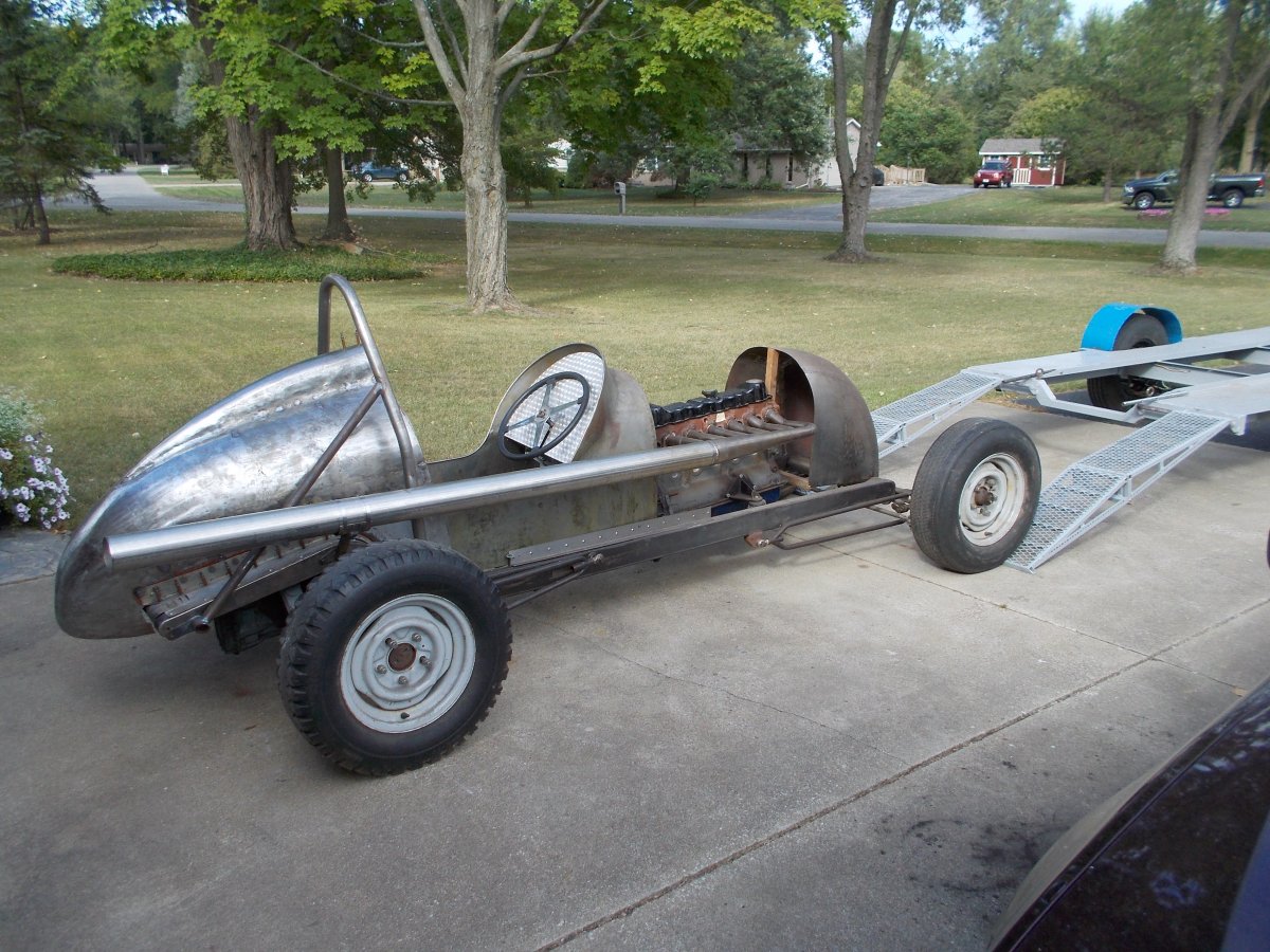

    How I started. Originally was to be a speedster with a hopped up banger. Horse track said I could not run the car there , I changed direction. Picked up several cowls till I found one on Facebook. Doors were a hard find, had several, swapped and sold till I had the right ones.
    You are doing well.

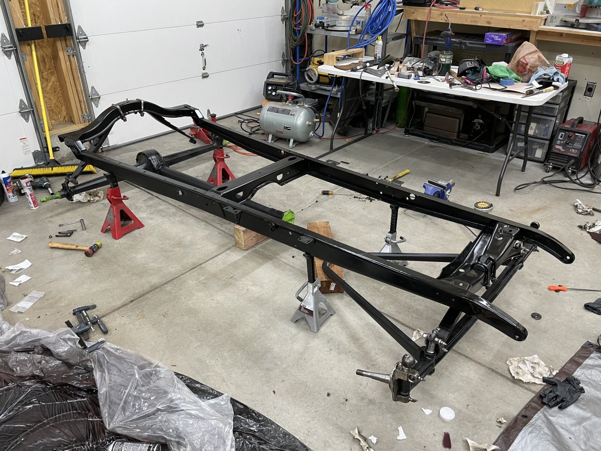

    I’ve decided to go with a Brookville body. Just need to sell a T5 trans adapted for a closed model A torque tube and some pews to fund the damn thing. Sad to see stuff go but this thing needs to get on the road!
    Finished the transmission and installed it today. Well everything but the top. Man, work keeps getting in the way of this build. BC135638-35CF-4A5E-AB83-48EEDCB80E55.jpeg 8A5553DD-9794-441F-A3E2-BD861A077230.jpeg
