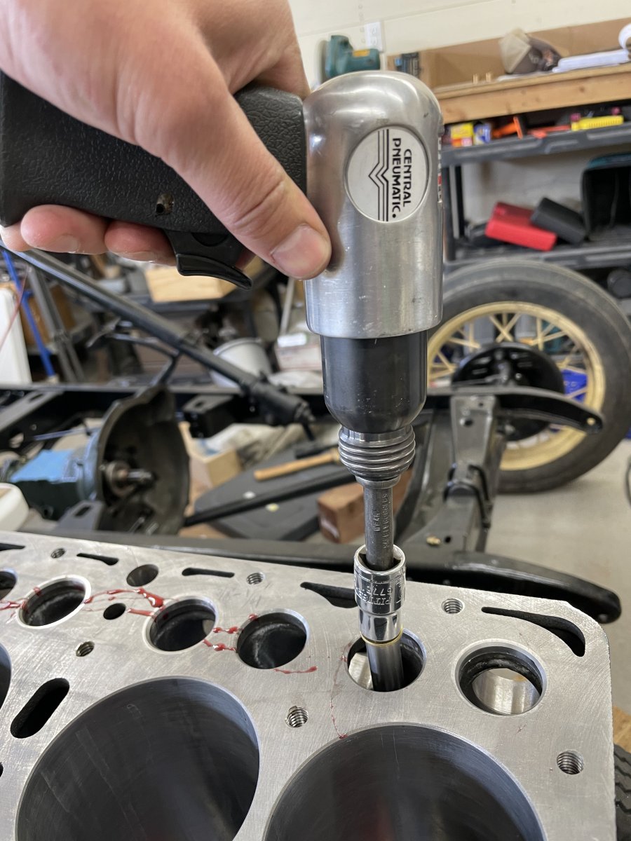

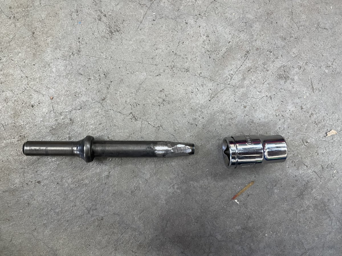

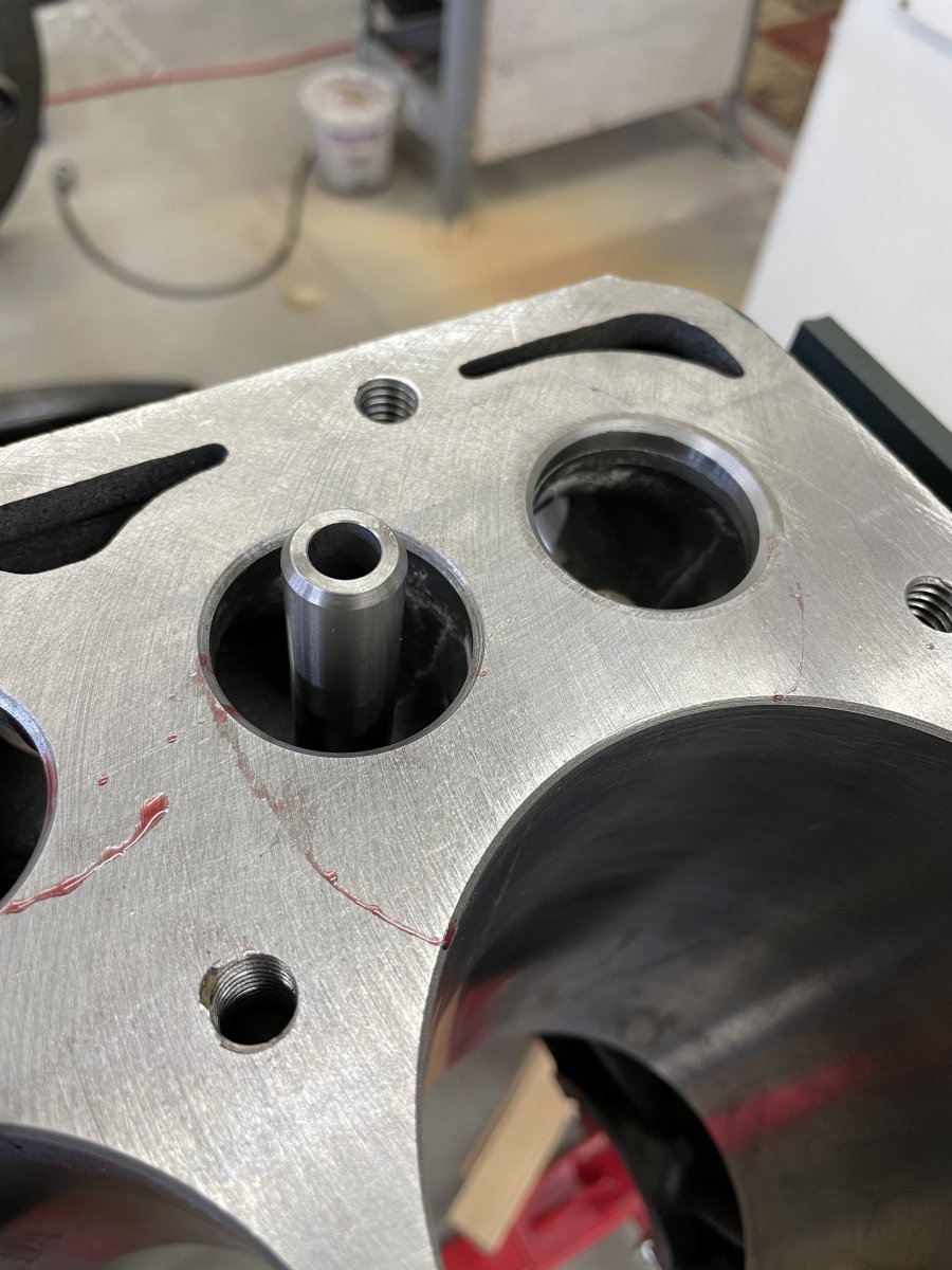

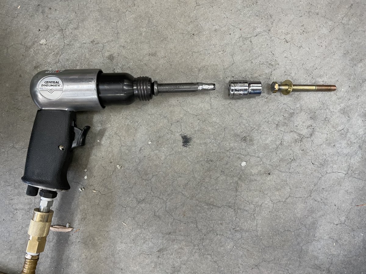

    Finally got a little time to start ***embling the motor. I sat and scratched my head for some time how to drive the valve guides in and how far to drive em in. Steve over at Berts was awesome and had the number needed in a couple minutes. He also recommended using an air hammer to drive em in. now the new dilemma; how to drive em in without marring the valve guides or having the air hammer slip off. Time for a little garage engineering.
    Ended up grinding the air hammer bit down to fit through a socket that would keep the bit centered over the bolt that went in to the valve guide. A br*** washer on the bolt kept from damaging the valve guide. I used some tape to mark the depth but that ended up being a PITA to remove. I was surprised how well this worked. Took more time to set everything up then it took to drive in all the guides.

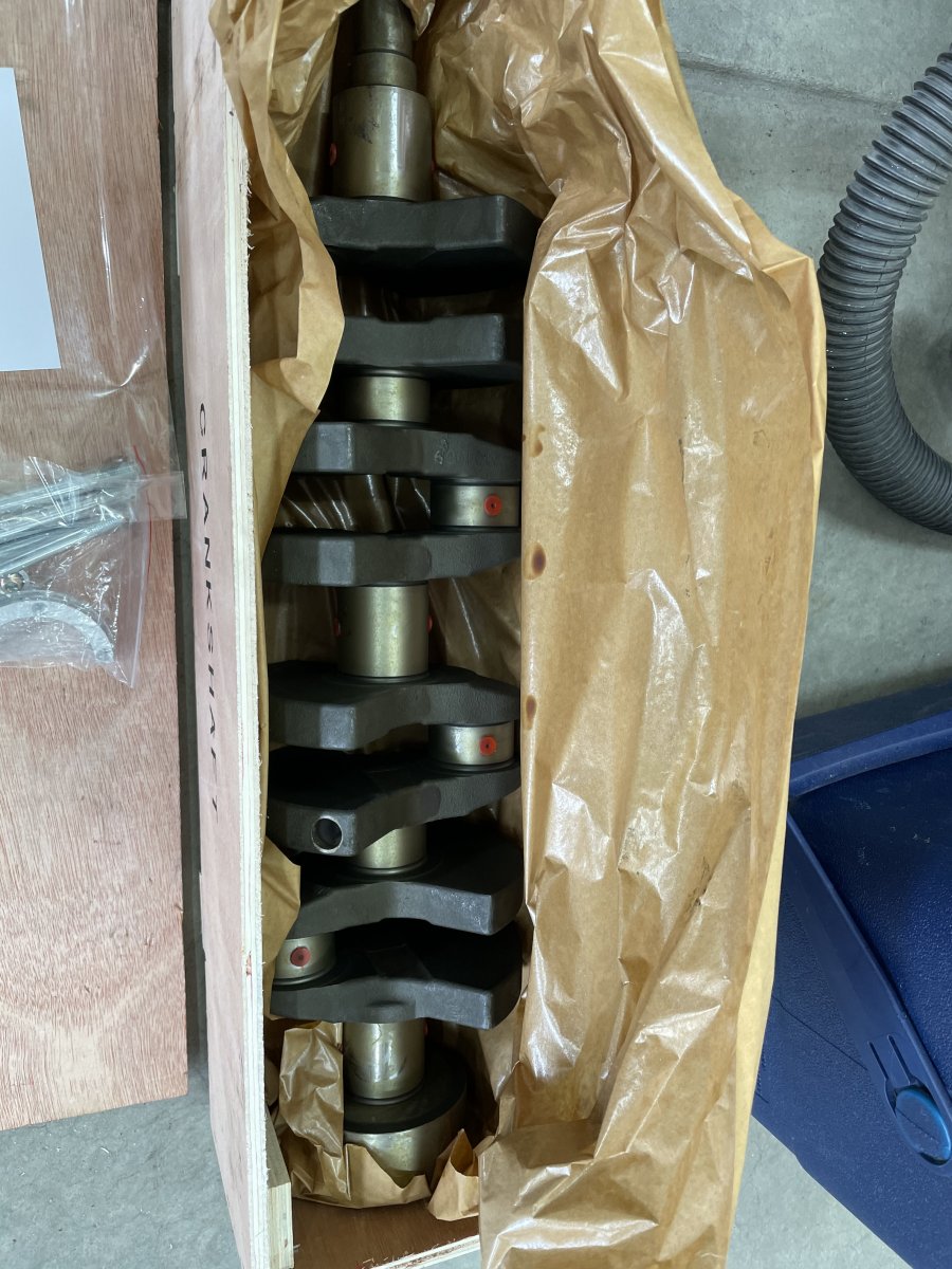

    And it shall be done. Oh boy, what a headache sorting out the bearings. Let's just say they all required individual m***aging to get the crank to spin somewhat freely when torqued. Not 100% happy about it but it'll do.......hopefully. Not much of an engine guy, done a few but this was certainly the most challenging. 10 hours of muckery took place with a few choice words and trips to NAPA. IMG_3688.jpg IMG_3690.jpg IMG_3693.jpg IMG_3697.jpg IMG_3698.jpg IMG_3700.jpg

    Thats too bad that things did not fit as they should. I am sure the block n crank was not cheap. The s****e on the one shell looks like a bad grind on the crank? I wont brag that I am an engine builder expert, but if a new bearing s****es like that something had an incorrect finish, the crank, or the shell. the s****e is mostly off to one side, poorly machined/ crooked bearing seat in the block? Time savor is a product made for fitting babit bearings. Invented for final fit of prop shafts going thru the hull for navy ships. I never hear of anyone here mention it, but good stuff. Its an abrasive like valve grinding compound, but breaks down to nothing so it needs not to completely washed out. You mix a little bit with oil, spin the crank, and look again to see where it is removing material. Never heard of it being used with "modern" bearing shells, but if it were in my shop, thats what I would have done...because its on the shelf. Too late now, have you plastigauged the clearance? the link, good stuff for fitting lots of stuff https://ws2coating.com/timesaver-lapping-compounds/
    kidcampbell71 and loudbang like this.
  17. So what does the block/crank supplier have to say about your issues?
    ottoman and loudbang like this.
  18. LostInOC
    Joined: Aug 5, 2009
    Posts: 179
    LostInOC
    We got it figured out. The bearing anti-rotation notches in 3 of the bearing caps were undersized. A dremel and needle file solved the problem with a set of new bearings. My inexperience led me down the path of filing the bearings, which I've come to learn is a big no no. Customer service from Terry Bertz (engine manufacturer) is awesome. Crank is now rotating freely and I learned a bunch. Win win!

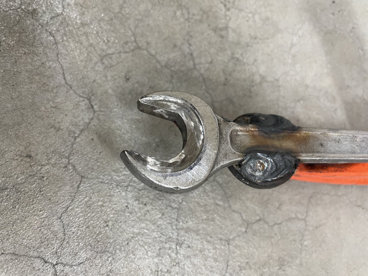

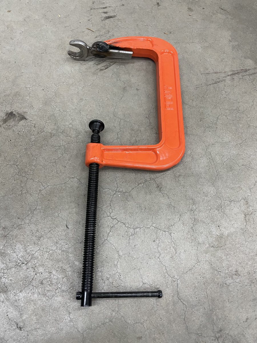

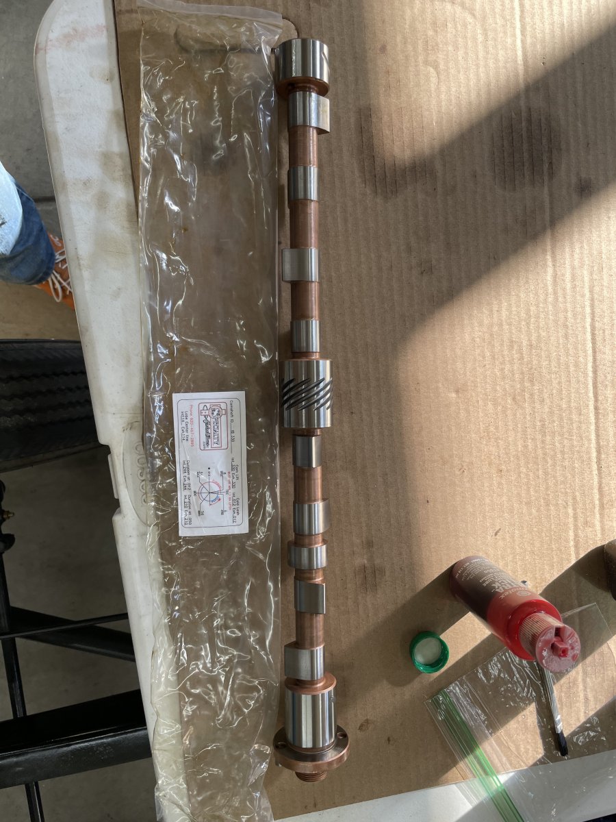

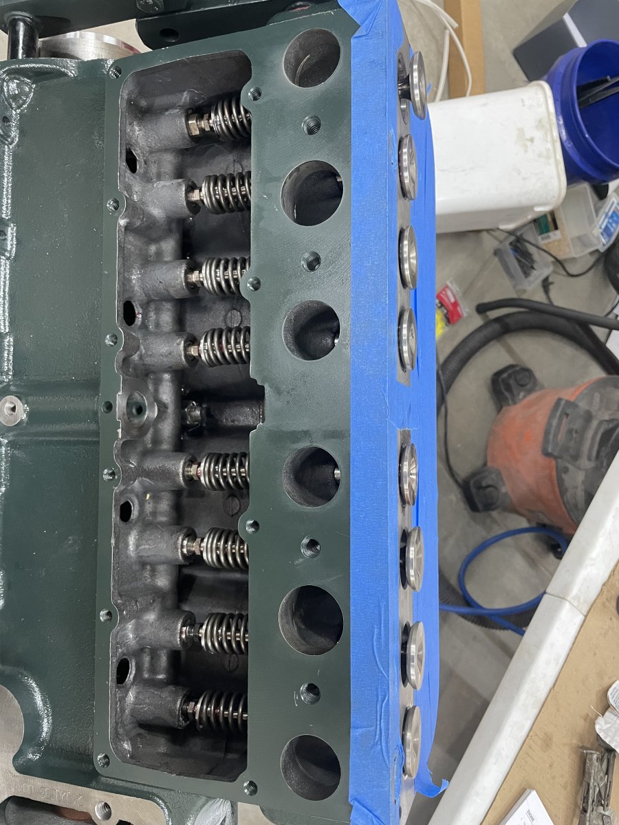

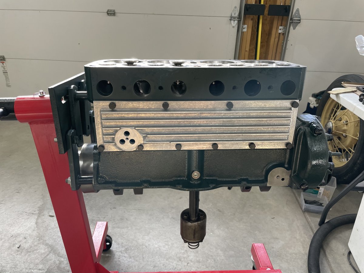

    Finally got my Stipe IB 330 cam delivered, that thing is gorgeous! Really wanted the 340 but beggars can't be choosers and I didn't want to wait. Valves are in, lapped and adjusted. Had to backyard engineer and fab a spring compression tool to get the modern valves in with the tapered clamshell keepers. Still waiting on a finned aluminum Thomas head and side cover from Snyders. Last I heard, they just got a supply of fresh heads in. Hoping to have all this ****oned up and running by the end of the month. IMG_3752.jpeg IMG_3754.jpeg IMG_3755.jpeg IMG_3756.jpeg

    That 330 will be just fine.Not sure if you would even be able to tell it from a 340.I have a 330 in mine and it rips pretty good but it has plenty of other mods as well.

    The cam is a thing of beauty! And the spring tool is cool!
