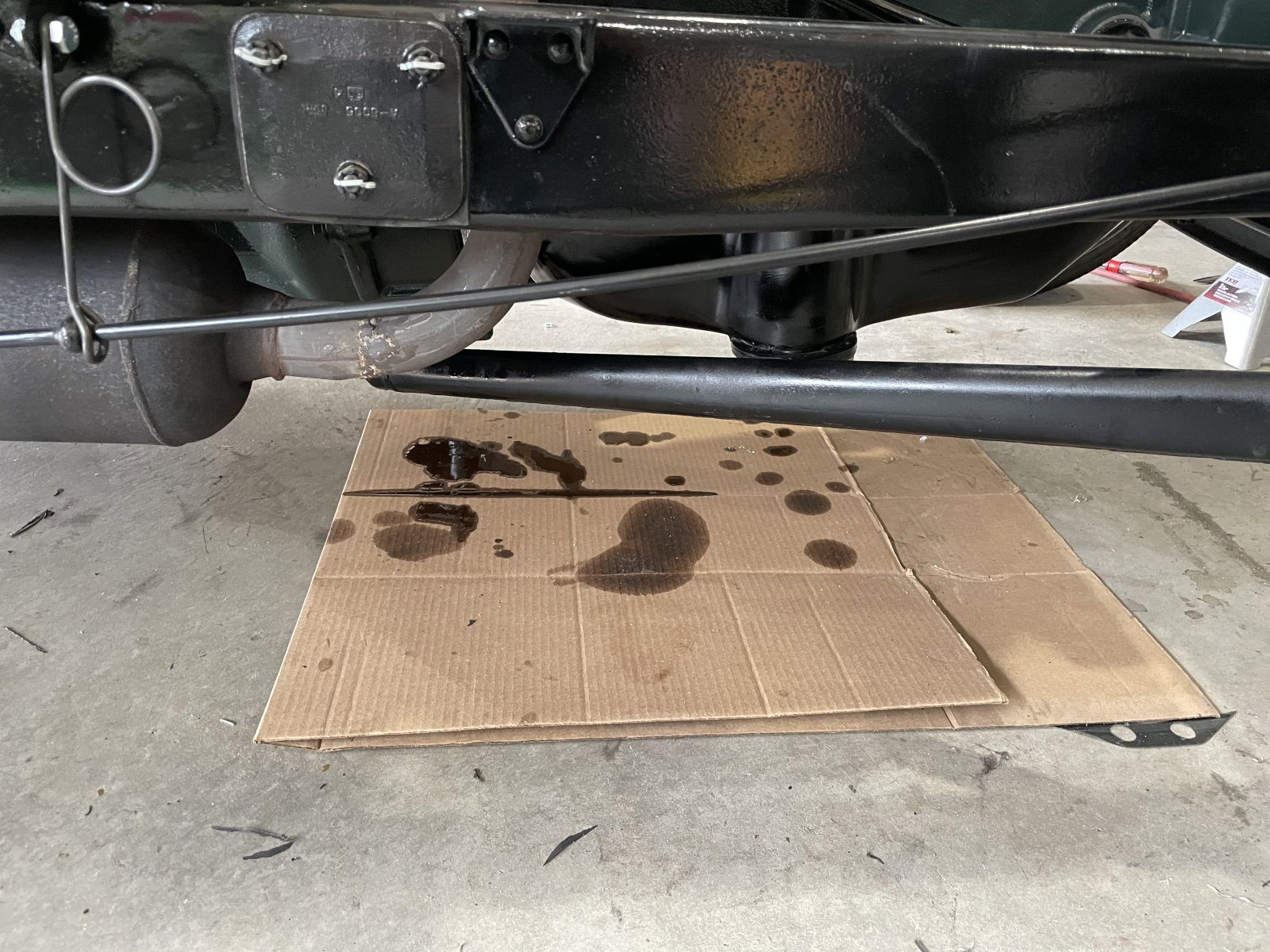

    Gave in and pulled the pan to properly fix the oil leak around the studs/castle nuts with Permatex Ultra Black. While I was in there I checked on the bearings and made sure everything was still torqued. The bearings showed some signs of wear but nothing alarming. Thoughts?
    Everything is back together. I’ll fill er up tomorrow and see if there’s any leaks fingers crossed.

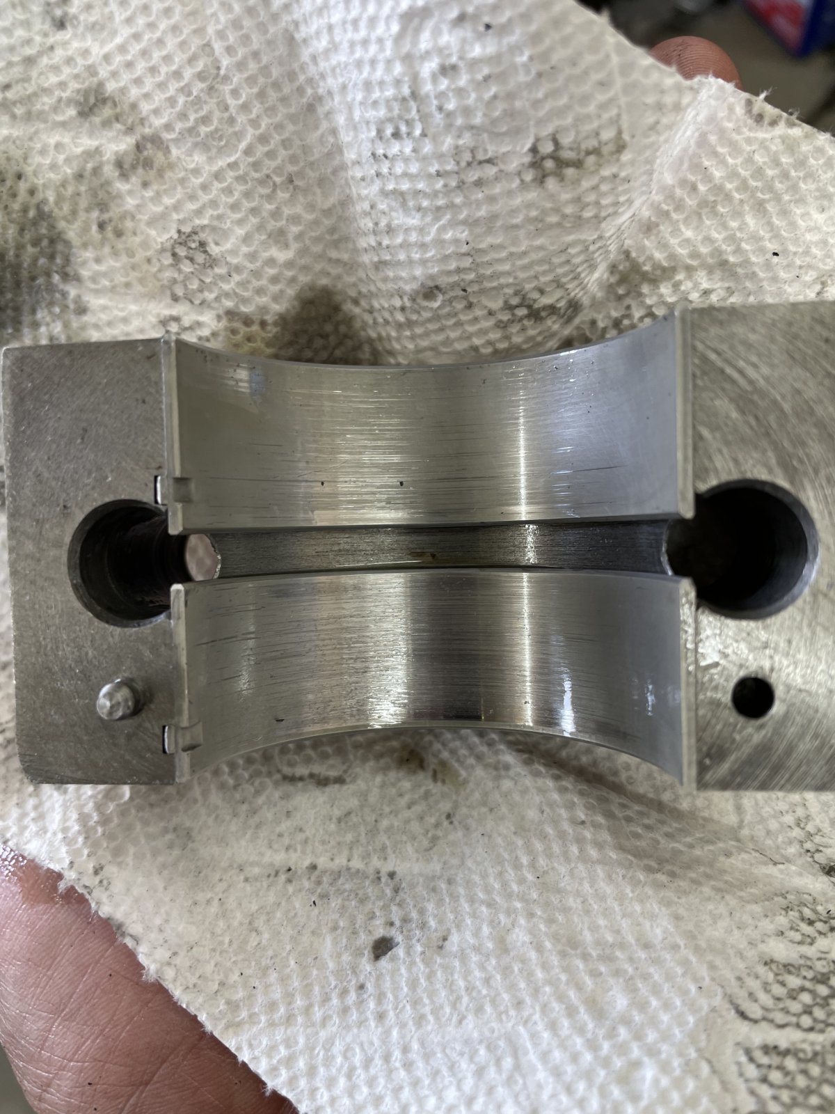

    Could you feel the wear marks in the bearings, did your fingernail catch in them? It's hard to tell just by looking at a picture but it is probably just normal run in between the bearing and crank.
  5. LostInOC
    Joined: Aug 5, 2009
    Posts: 179
    LostInOC
    No wear marks that I could feel which was a big relief considering the headache with installing the bearings during the build.

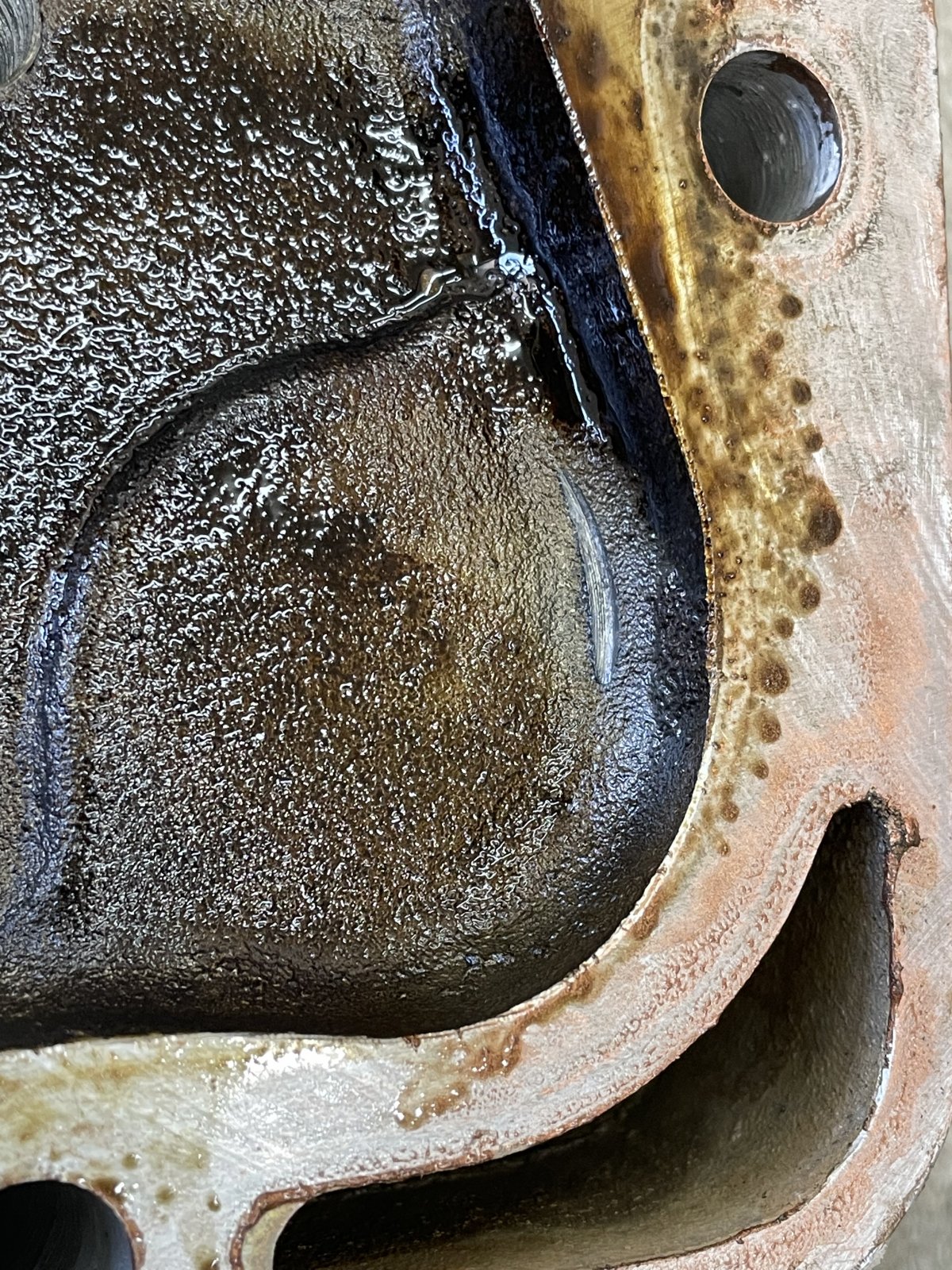

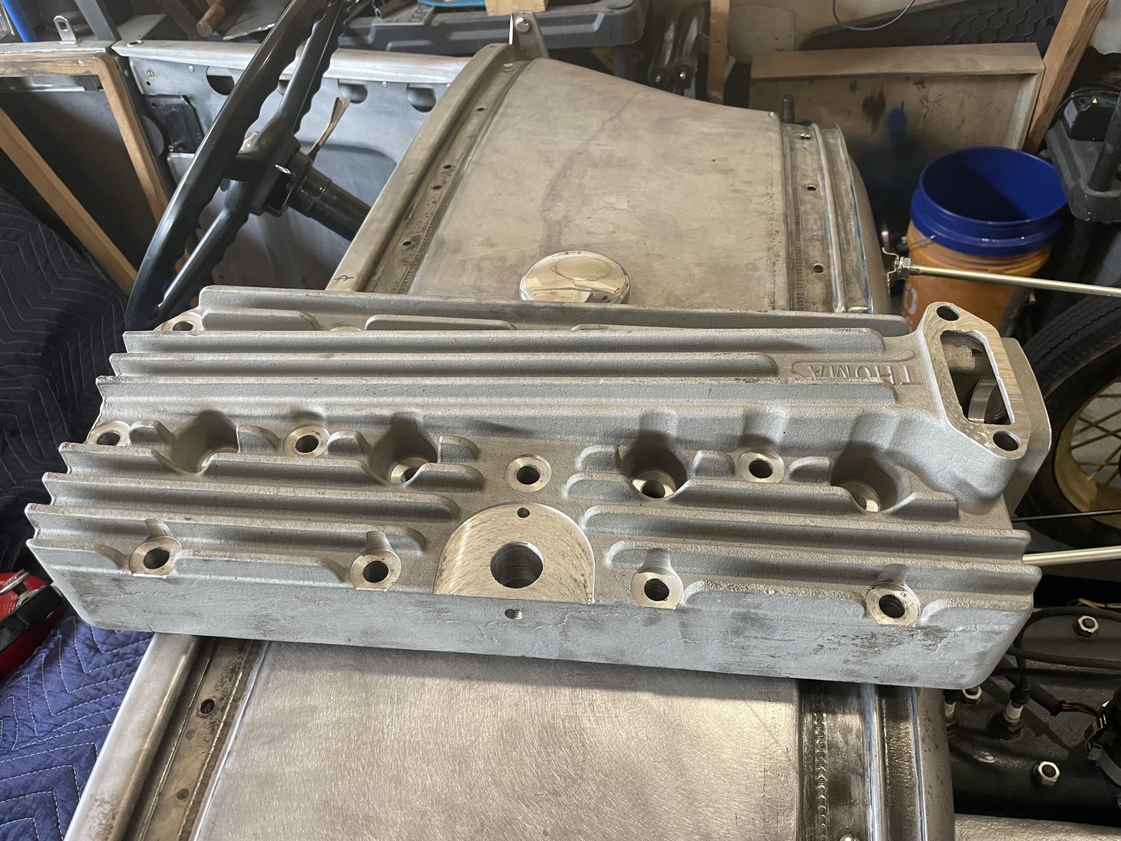

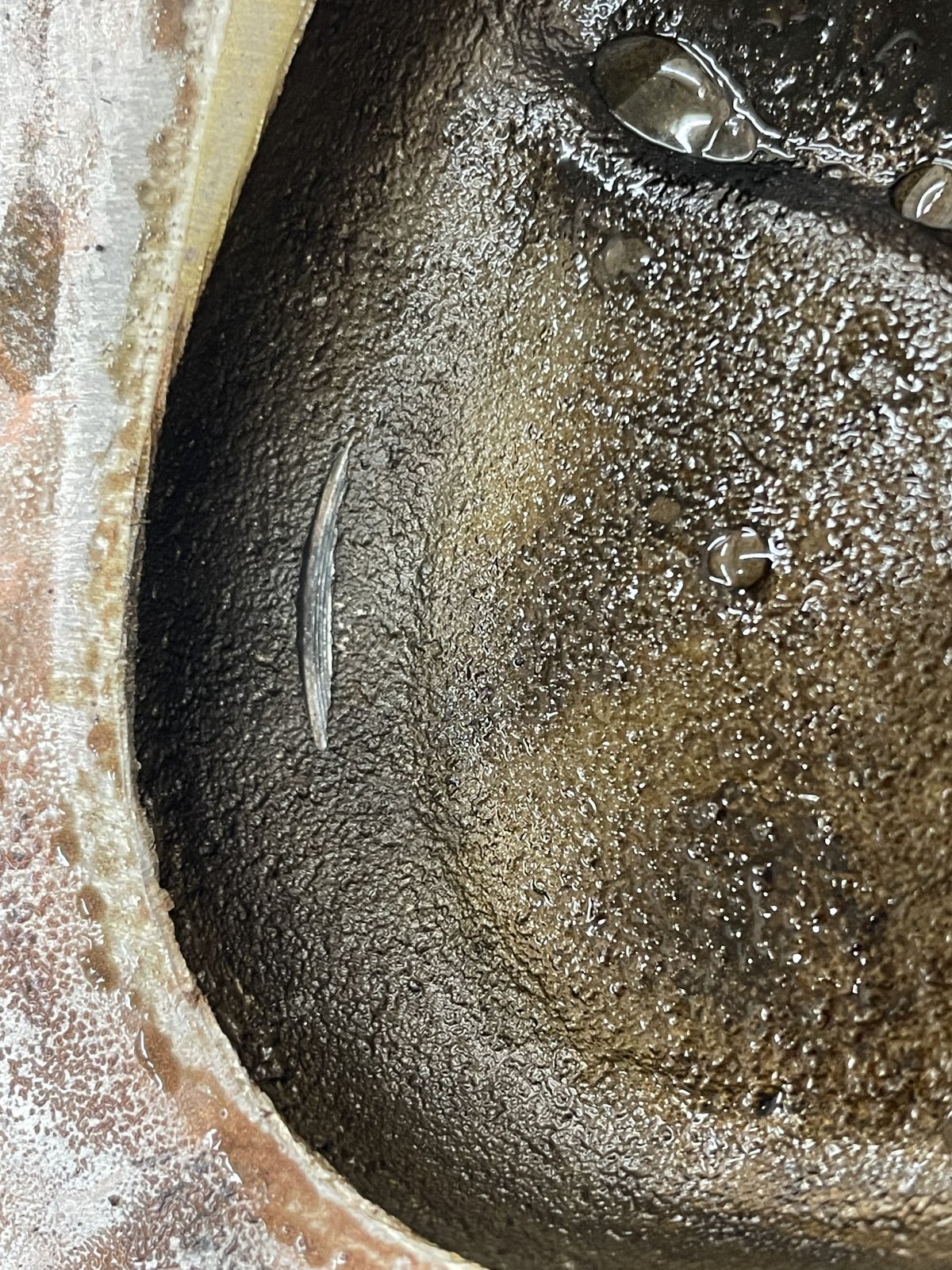

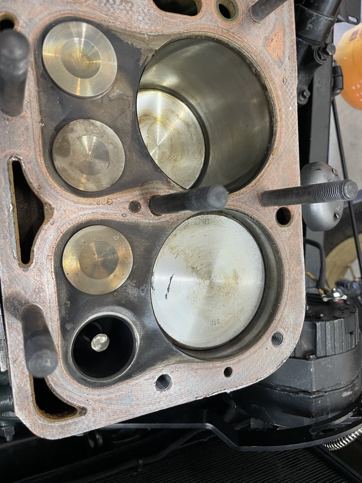

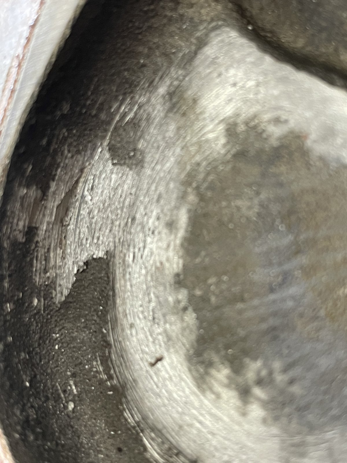

    Exhaust valves were hitting the radius in the aluminum head’s combustion chamber. On first start up, I couldn’t hear it, the engine was running smooth as can be. Let the engine warm up and cool. Re torqued the head nuts to 55 lb*ft after it cooled and took her out. Wow she ran great with tons of power for about 20 minutes until she didn’t. Limped around the corner and started diagnosing. Cyl 1 was producing much less compression than the rest so I pulled the head. That’s when I discovered the exhaust valve snapped below the taper! Not only did it snap but it beat the **** out of the valve seat as well. Turns out the 1,2 and 4 exhaust valves were making contact with the head. I’m now trying to figure out what the next steps are. I really don’t want to pull the motor but I may just have to. Looking at Neway seat cutters to possibly try to salvage the seat but would like to hear some opinions. There’s about a 1/32” gap from the seat to a new valve that needs to be cleaned up. Really disappointed that a “bolt on” head created this much trouble. 6C16C317-13E0-4AFA-A1D7-D4C2FB026382.jpeg C0CACFF2-4523-4EA2-A4A2-86EFADD17F3D.jpeg E7FFF428-2694-4C76-94D7-5453865FCAD9.jpeg 8B443BB8-F7EB-48E6-907E-CF7A8F885B3D.jpeg C77AE35F-4AFE-4AEB-995D-FCD9509392A9.jpeg

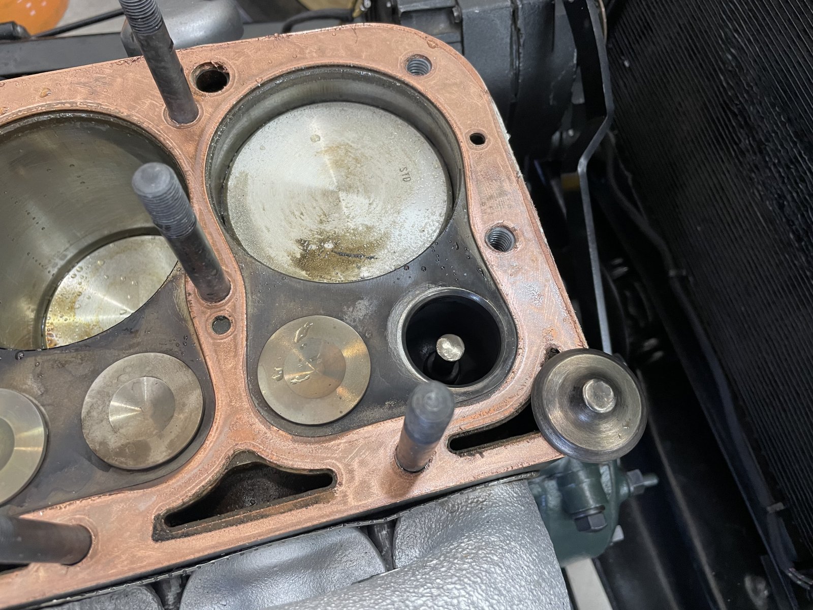

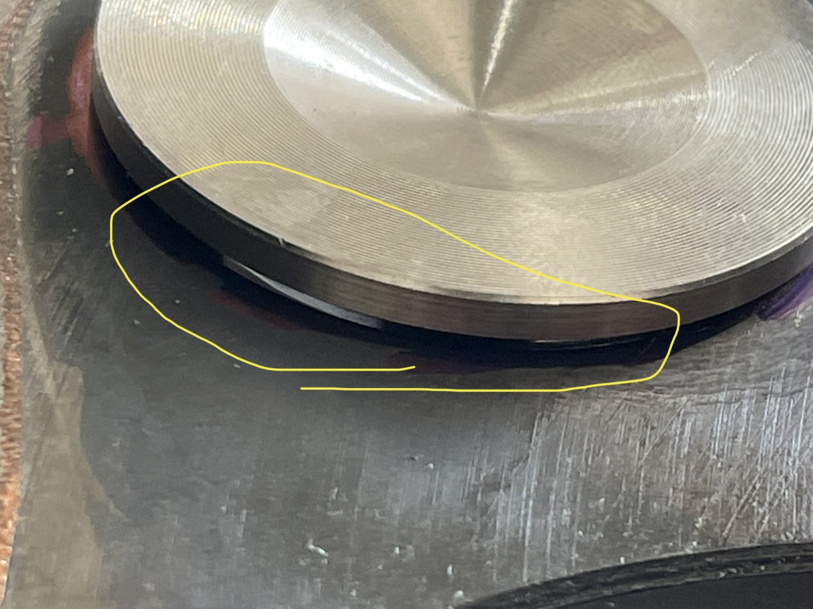

    That valve circled in yellow is bent I believe. Take it out and spin it in a drill press or sumthin to check it. All that touched the head should be checked, then have a machine shop do a tiny fly cut for clearance

    The valve circled is a new valve. The light you see under it shows the beating the seat took. I'm curious if one of those Neway manual valve seat cutters could provide a new seat surface. Seen that they work wonders but not sure how it would work without a perfectly concentric surface to cut. The fear is that it would make an oblong cut.
    The two other cylinders that had contact witness marks both showed 128 psi of compression and the valves show no sign of wear. Not too worried about those. Although the intake valve next to the broken valve doesn't look harmed, it's getting replaced for good measure.
    Not quite sure what you mean by fly cut for clearance…where?
    The plan is to take a die grinder to the places on the head that need clearance, pretty much the radius in the chambers. After, I’ll smooth it all out and maybe polish if I’m feeling motivated.

    I thought maybe that was the new valve, after I posted my comment. Fly cut the head where the valve touched the combustion chamber. Next time, the 20/20 vision of hindsight, a guy could place the head on with no gasket and turn the motor to see that there is clearance. I think to fix that seat, you will get too deep and not have the valve above deck where it should be. And, it will be messy. Not what you want to hear, but, there is a lot of money in that motor, perhaps its best to tear it down so a machine shop can put in a new seat on the mill and have everything back to perfect. Hope to hear more from some pro motor builders here, best wishes

    New way style cutters work well... should correct this valve seat as long as you get the correct fitting pilot. The problem is you wont know how deep you will have to go until you try and its hard to tell from picture how deep the damage is. If its too deep it will have to come out and have a seat put in.
    LostInOC, Six Ball and rusty valley like this.
  16. rusty valley
    Joined: Oct 25, 2014
    Posts: 4,328
    rusty valley
    Agree ^^^^, and, that seat is a a removable insert. weld a short 1/4' bead on it, let it cool, and it shrinks and pops right out. hammer in a new one and fit your valve with the new way cutter.

  17. It might be the camera angle, but the head of that exhaust valve looks pretty thick to me. I would track down some dimensions and verify before going farther. Find a (s****) shorter valve and lap it in a bit to actually see what shape the seat is in. When re***embling, put a glob of modelling clay on every valve head, install the cylinder head, and hand crank it over. The deformed clay thickness will tell you the clearance. Good luck.

    Bearings look like they had dirt running through them. That would make me want to do a full cleanup, but would run it if that was the only issue. You also need to fix the main bolt leaks. That can be done in ch***is, but the fixes are stacking up. Also, call Permatex tech line and see what they suggest for the studs. RTV has it's place, but it is not typically for oil drenched studs. This looks like a better selection, but I'd get suggestions directly from the guys that develop it.
    www.permatex.com/products/thread-compounds/thread-sealants/permatex-high-temperature-thread-sealant/
    With the amount of gap on that exhaust valve and required machining on the top of the block (while minimizing the additional grit and dirt), you are getting into the point where I'd want everything out of the block, including the crank, which points to pulling the engine.
    60 years ago, a basic shop would do an in-frame rebuild, but the engine also wouldn't last much more than 40-60K before needing a redo. I doubt many shops have the equipment used back then to machine in place. I also doubt many machine shops now have the space to have the whole car sitting there.
    With the effort and cost these days, pulling it and having the work done on the block, lapping in every valve and checking/fixing head clearance, then doing a full-on scrubbing and clean room ***embly is more typical.

    Main studs leaking. Pulled the pan and properly sealed them with ultra black. I’ve had no leaking for about 30 miles of driving.
    Leaking in general. Still have a small leak from the flywheel housing. Dip stick shows oil right up to the full line. The leak has been slowing as I drive the car so it may just be overfilled. If that’s not the case, perhaps if the motor gets pulled, this should be addressed. Might just drop the oil level after everything is back together and see if it stops leaking.
    Other valves. All other valves look good. Cylinders 3&4 that had exhaust valve contact both measured 124 lbs of compression while cylinder 2 had 118. I’m pretty confident they’re ok.
    Snapped valve. The new replacement valve is a little taller so I lowered the lifters which reduced the valve gap significantly, duh! The new valve was lapped twice and revealed some interesting things. I won’t go into my detailed thoughts but I’ll let the pictures speak for themselves and see what you guys think. Below are pictures of the valve and seat after lapping twice, cleaning up and being rotated 360° in the seat with some blue sharpie.
    Clay. That’s an awesome idea and will be done after I work the head for clearance.

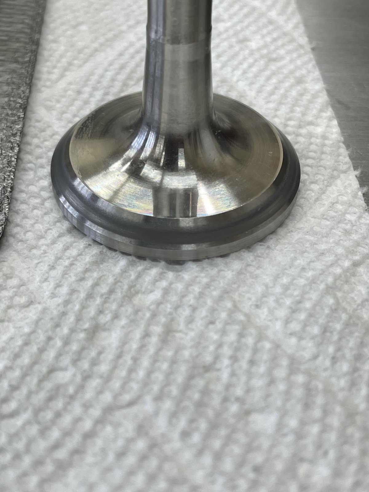

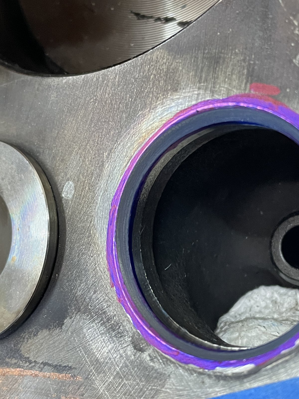

    6CCC436A-6B83-49F1-9647-BD105908D6A3.jpeg B5048B2F-60EE-45A9-9FA1-97853554A397.jpeg 3E359F0A-9DEF-4829-90F8-41C8BFA1105A.jpeg 5F359250-6EE8-4FE4-86D8-F53AA92C2413.jpeg EF26FB5B-4A2A-4922-8727-AB5DF1E9F7E4.jpeg

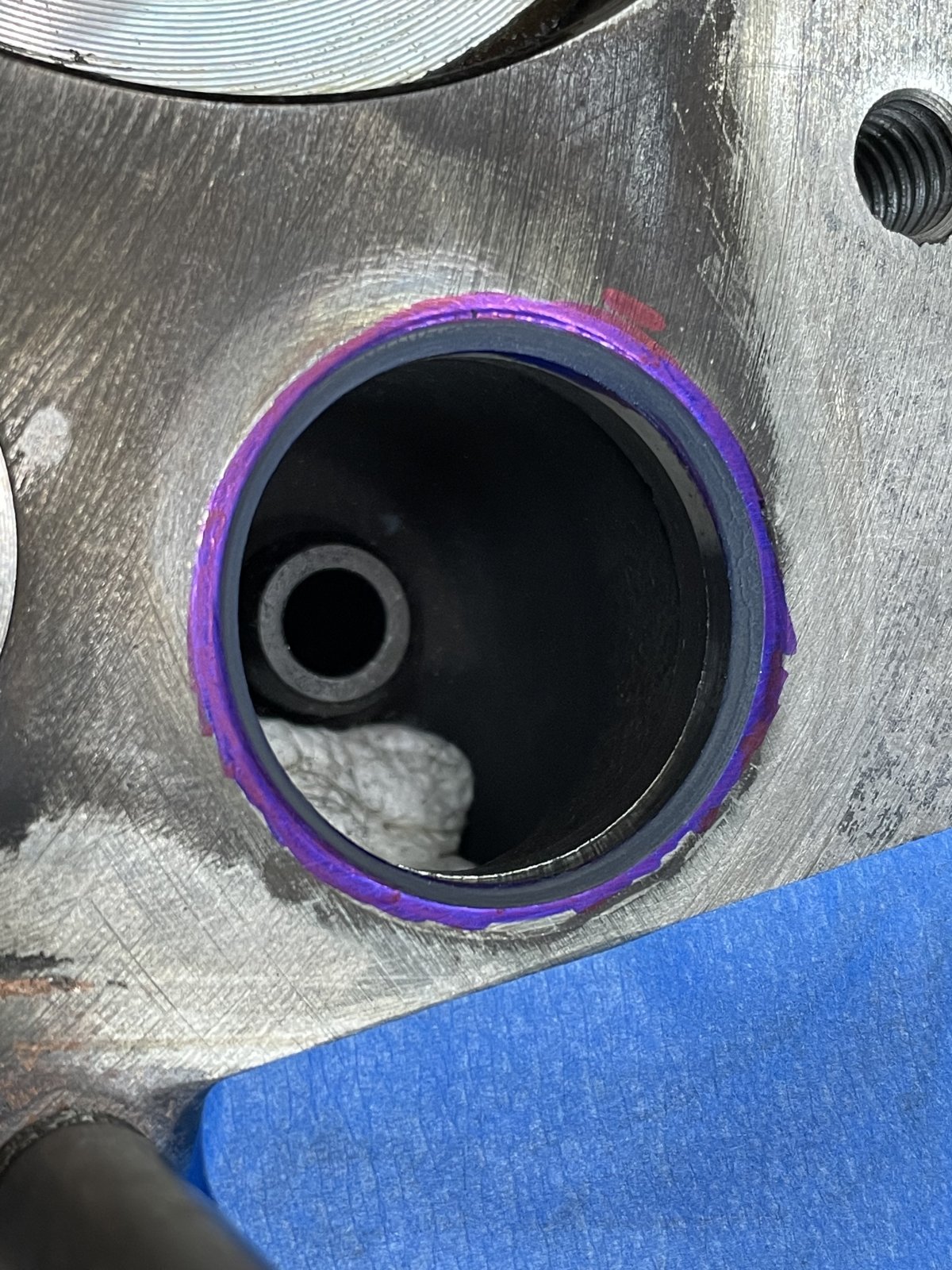

  20. It's hard to tell (camera angle maybe) but the first seat picture looks like the lapped area on top of the pic is kinda slim.
    Have you been able to verify the specified thickness of the valve heads? Those things sure look thick to me! It's been damned near 60 years since I rebuilt a Model A engine, but I don't remember any valves being that thick-headed! I would verify before I clearanced the head! YOMV

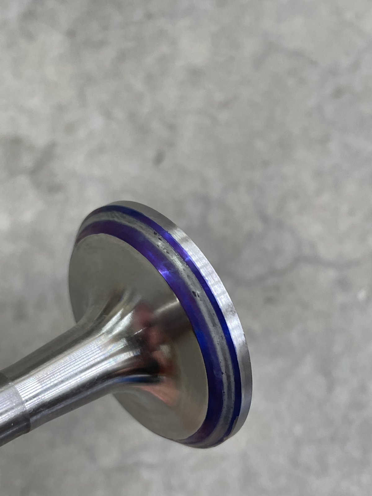

    You’re spot on, there is a super thin strip on the seat after lapping. The other pictures are of all sides of the valve. I have not been able to verify the thickness of the valve heads from do***entation which is damn near impossible to find for generic unmarked model A parts from the big suppliers. Measuring the vertical flat thickness (what I think you’re referencing) is 0.100”. Stock valves are muuuuch thinner.

    That ****s' always use a little hy spot blue to check the valves to the head clearance. Easy way to spot any interference and adjust with a little hand grinder work.I have always run bigger valves so i know to check every time i change heads.

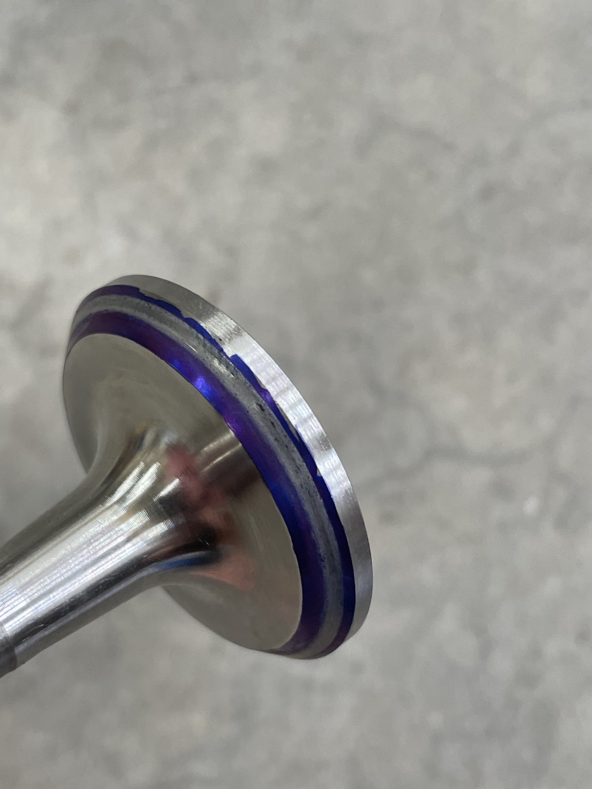

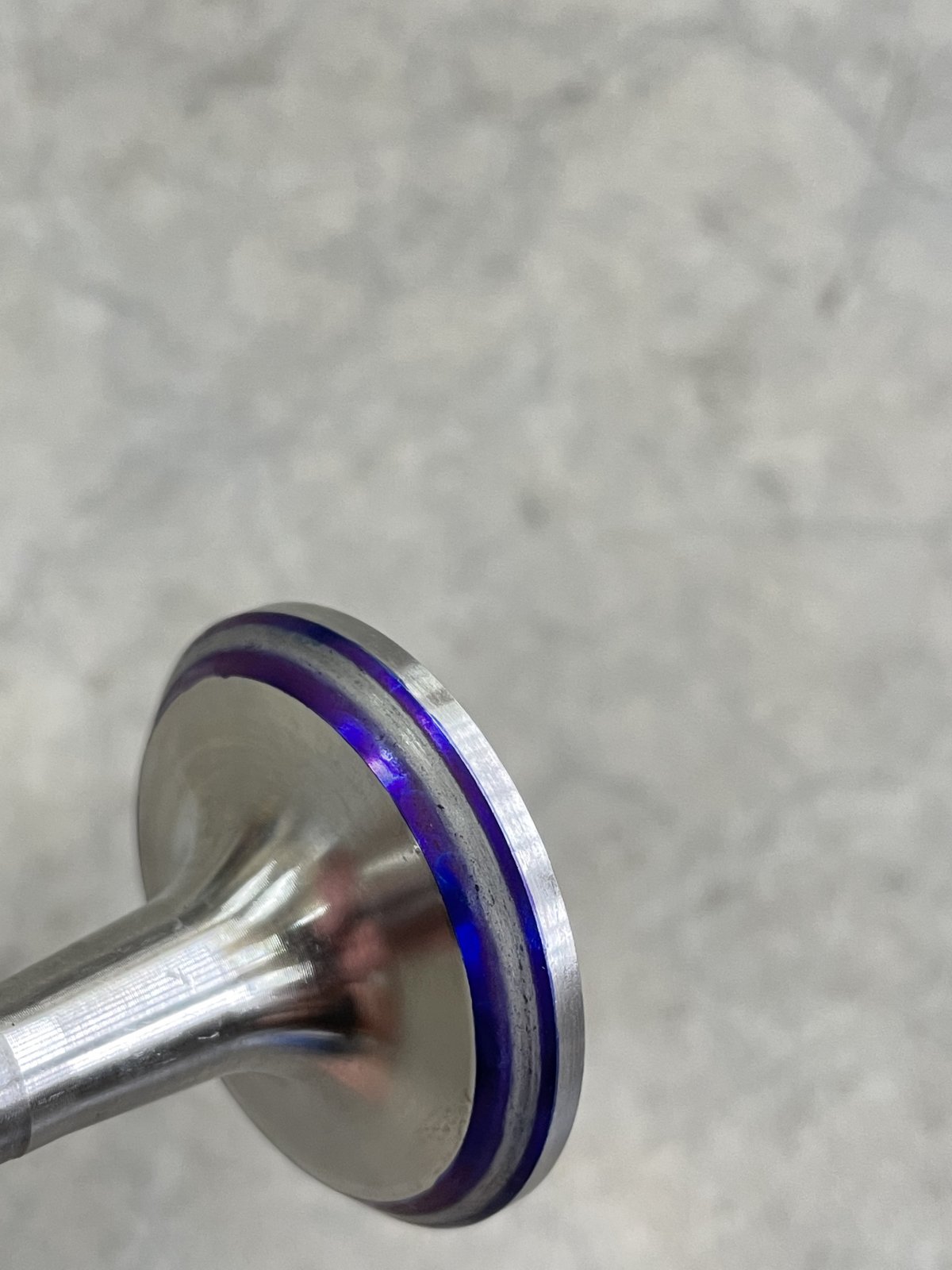

    So after an extensive lapping session, this is where I am. The thin ridge on the seat created by the old valve hammering it has been smoothed out. The valve with blue is the valve used to lap the seat. The second valve was lapped on the seat after the ridge was knocked down. Would you call me crazy if I ran it? 78F4D196-72C7-4A7A-9DF1-606BA61BB38A.jpeg 47C6CBC2-A521-43B6-BF93-D6BB0F40C6C3.jpeg 36AD746C-0668-4FA9-880F-5CBF7D6641BF.jpeg A518F345-C34D-4556-A4A1-D0EEE00F9556.jpeg
  27. rusty valley
    Posts: 4,328
    rusty valley
    Now it looks like you have too wide of a contact area on the valve. should be more like the thin blue line at the top, or about 1/16 to 3/32 wide. A cutter could take a light cut out of the 60 degree angle at the bottom of the seat to correct it. It would run like that, just a narrow seat is preferred to keep it cool and clean
    Six Ball and loudbang like this.
  28. rusty valley is right. I'd run it. You're not cranking 7500 rpm with it. It was designed and built as a slow speed engine, and as long as you don't trash on it you'll be fine.

    rusty, Wider seat = more contact area to transfer heat from valve to head.
    It does also mean less PSI to clean the mating surfaces, since more surface with the same pressure is going to decrease Pounds per Square Inch.
    Here is a Mopar flathead discussion about width.
    p15-d24.com/topic/44321-valve-valve-seat-contact-width-questions/
    Provided OP has a good cooling system, not a bunch of old parts, I'd run it, after confirming those thick valve heads are reasonable.

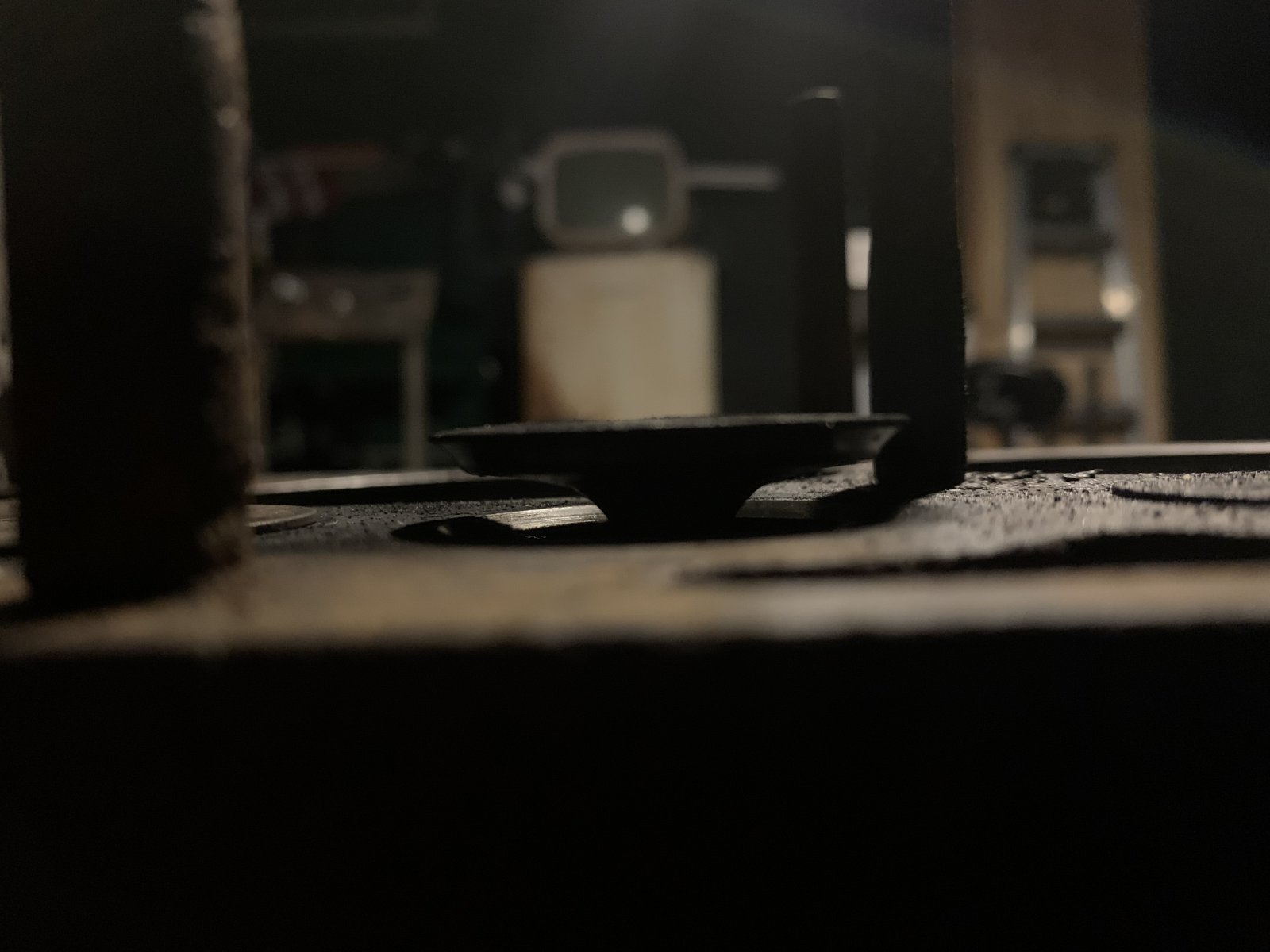

    Here is a profile shot of one of my valves fully opened. Might be helpful, might not be. Yours look way thicker than mine. Let me know if another angle might be more useful.
    I wouldn't relieve the head to clear the valves. Either have material machined off the valve heads or just buy another set. They are pretty cheap compared to the head.
