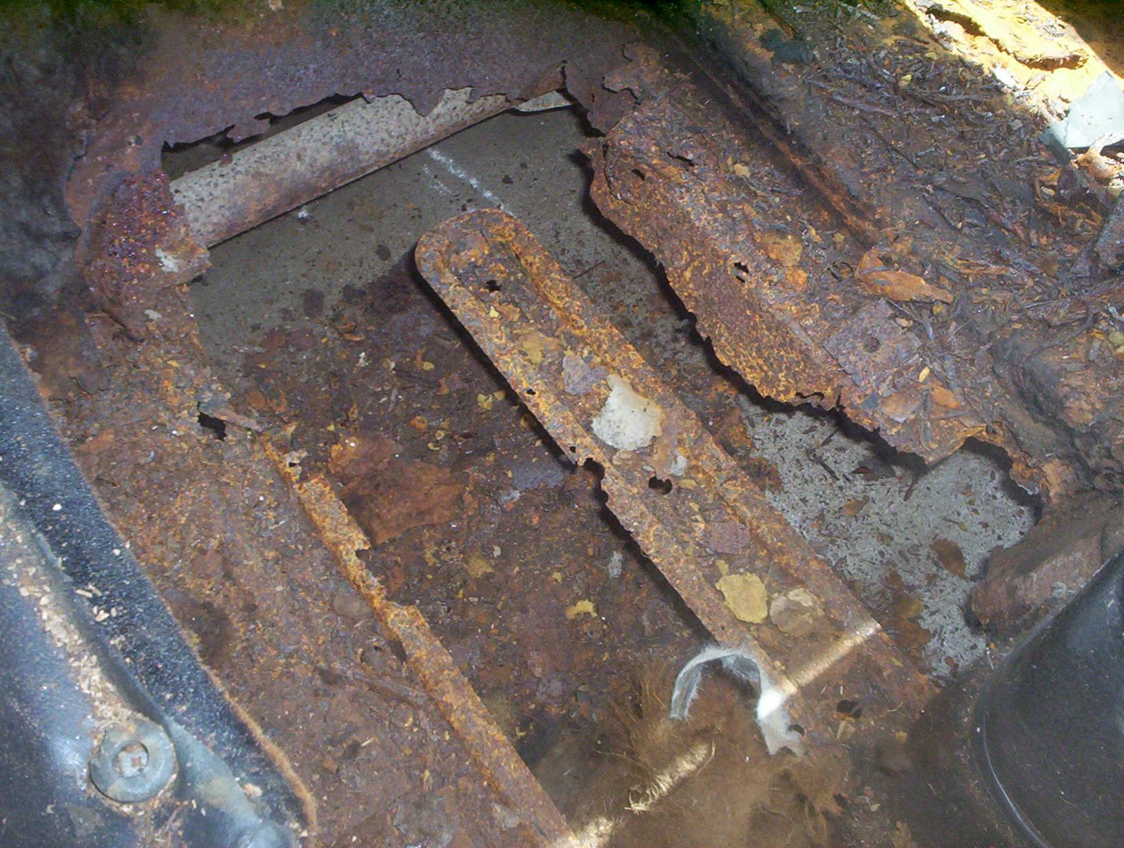

    Well used the shop vac on the Caddy's floors today and now their gone.Cool....I think?By the way that little job burnt my vac out.Looks like besides the floor pans (front/back)the toe boards are F'ed up as well.The parts car has toe boards that still have factory grey paint on them,so thats lucky.Out of all the interior the seats are the only thing worth saving unfortunately,not a crack in those bad boys and the springs will work for now as well.This is slowly but surely becoming huge.Now to get those seats out ought to be fun.

    Well I got the drivers side fender off with ease today and started cleaning up in the engine compartment and suspension.All was going well until I decided to move inside the car and take the back seat and rear carpet out.It is a new can of worms.This is a real rust bucket.Looks like all the floors,rockers,toe boards and ****** tunnel need replacing.Some floor braces will have to be made as well.I don't think they repop those braces.The back seat is past the point of restoration,the springs were all rusted through or gone.The trunk is going to be another project in it self.Talk about a ton of bicks.Its hot as hell , I'm broke and this project is turning into quite the undertaking.Here are some of todays pics.:(

    Thanks,Im taking all that into consideration.I'm pretty sure the frame is o.k..it looks good and even the exhaust is still there.Im think the majority of the problems are due to water coming in through cracked windows and bad rubber seals.this car wasnt over any gr*** or weeds and it was on blocks thankfully.There is alot of mold all over all the interior which also helps this theory.But no matter what this has become HUGE.I'll deal though.:)thanks

    The good news is that floors are not all that tough to repair, even for a beginner. Be sure the frame is solid and hopefully the rockers will also be solid. If you can get your hands on a complete unrusted floorpan from a donor car, so much the better. Even if it's from a 4-door you can cut it up to get the panels you need.
    As has been suggested, just take your time...especially in this heat! Plan ahead and do one section at a time. You can use mostly hand tools to cut the old floor out and prepare the donor floor panels to go in. Any voids can be filled with patch panels cut from the skin of the donor car to keep from having to buy new sheet metal.
    You don't have to be a metalworking genius to get this job done. Lap the seams wherever possible and make slices wherever needed to get everything to line up. You can use pop rivits to hold the patch panels in place until you find a friend who will bring his torches over and weld it up for you.
    A gas welder will work just fine and don't be afraid to "heat and hammer" to get the parts to fit and the gaps to align. It doesn't have to be beautiful this time around, it just needs to be done strong!
    This is not to say that you should be sloppy in your workmanship, but don't hold back just because you can't ****-weld and metal-finish the floors the way the professionals do.
    Replacing rusted out floors is a great learning and skill-building experience! Take advantage of it. Once you've got the floors done you'll be ready to tackle the exterior bodywork.
    By the way, that is going to be one absolutely spectacular car when it's done! Good luck...and drink lots of water! :)

    Thanks MissysDad1,thats a lot of helpful advice.I appreciate it.Yeah this is a project that will require a lot of my patience,so I'll get back at it and take it slow.I have a friend here in town that l can supply me with new flooring material.I'll be doing all I can do myself and for sure learning a lot along the way.Thanks.There will be more pics up soon

    Well despite the excruciating heat I was able to remove the front and rear seat and all of the interior panels and headliner out of the Cadillac today.Now that I have it all out and can see everything Im starting to see what I need to do next,which is mainly remove a ton of bad sheet metal and leftover flooring out of this thing.Here are some pictures from today.:)
