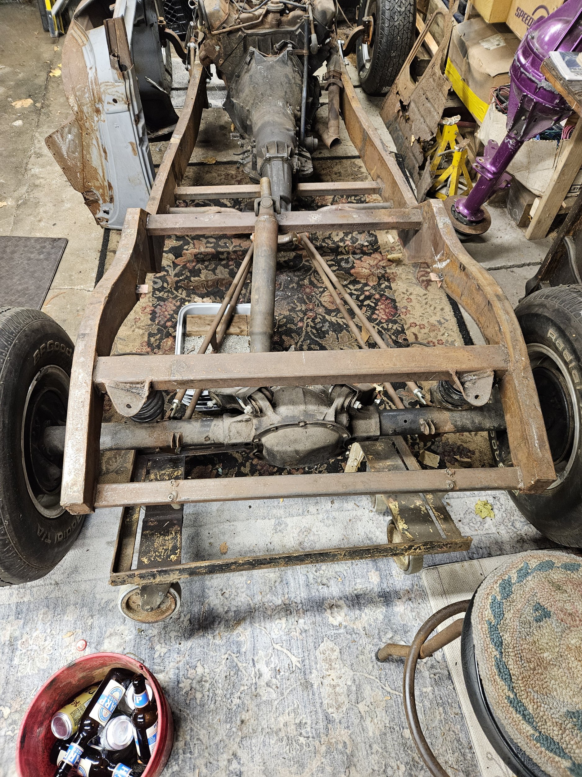

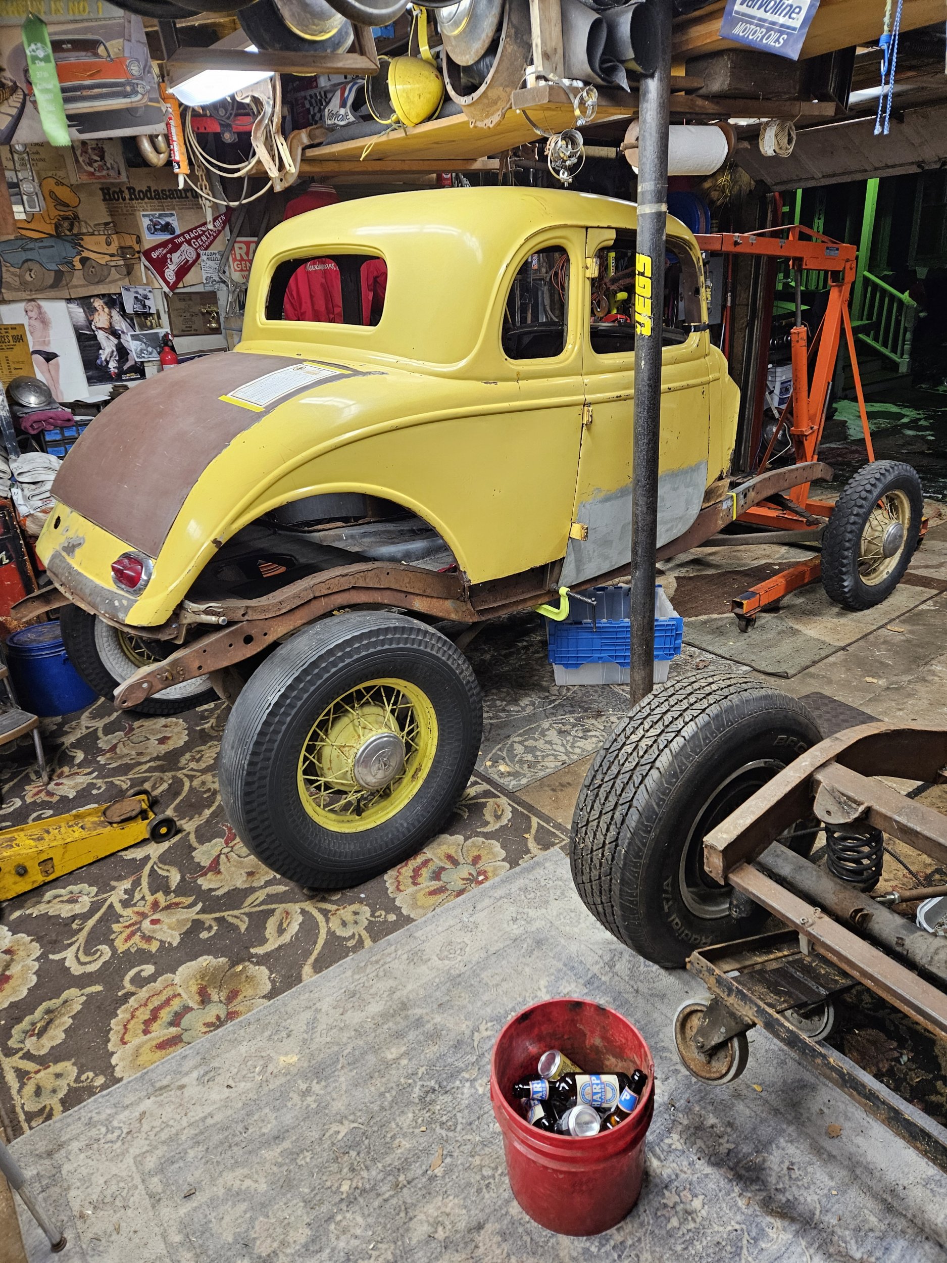

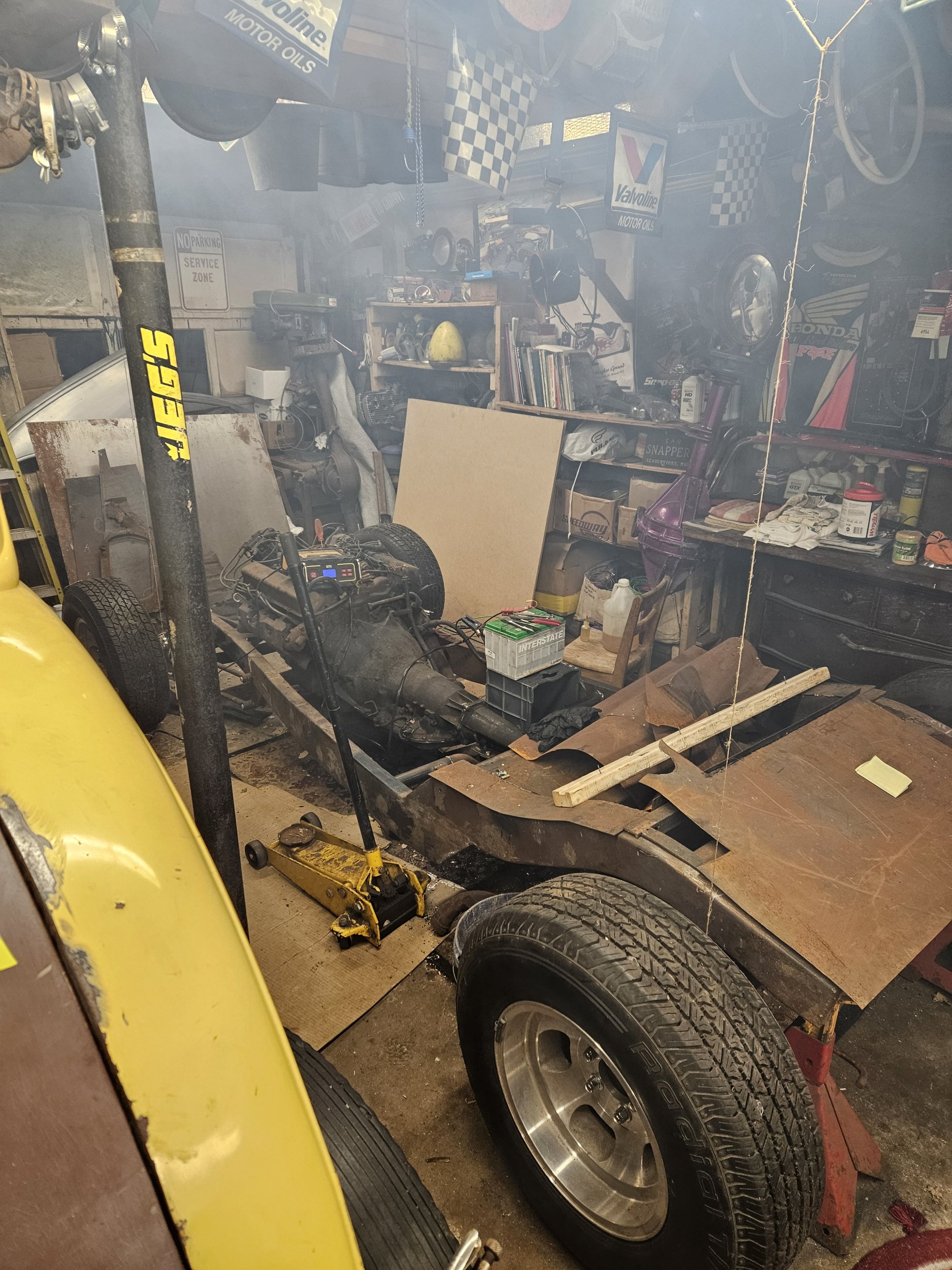

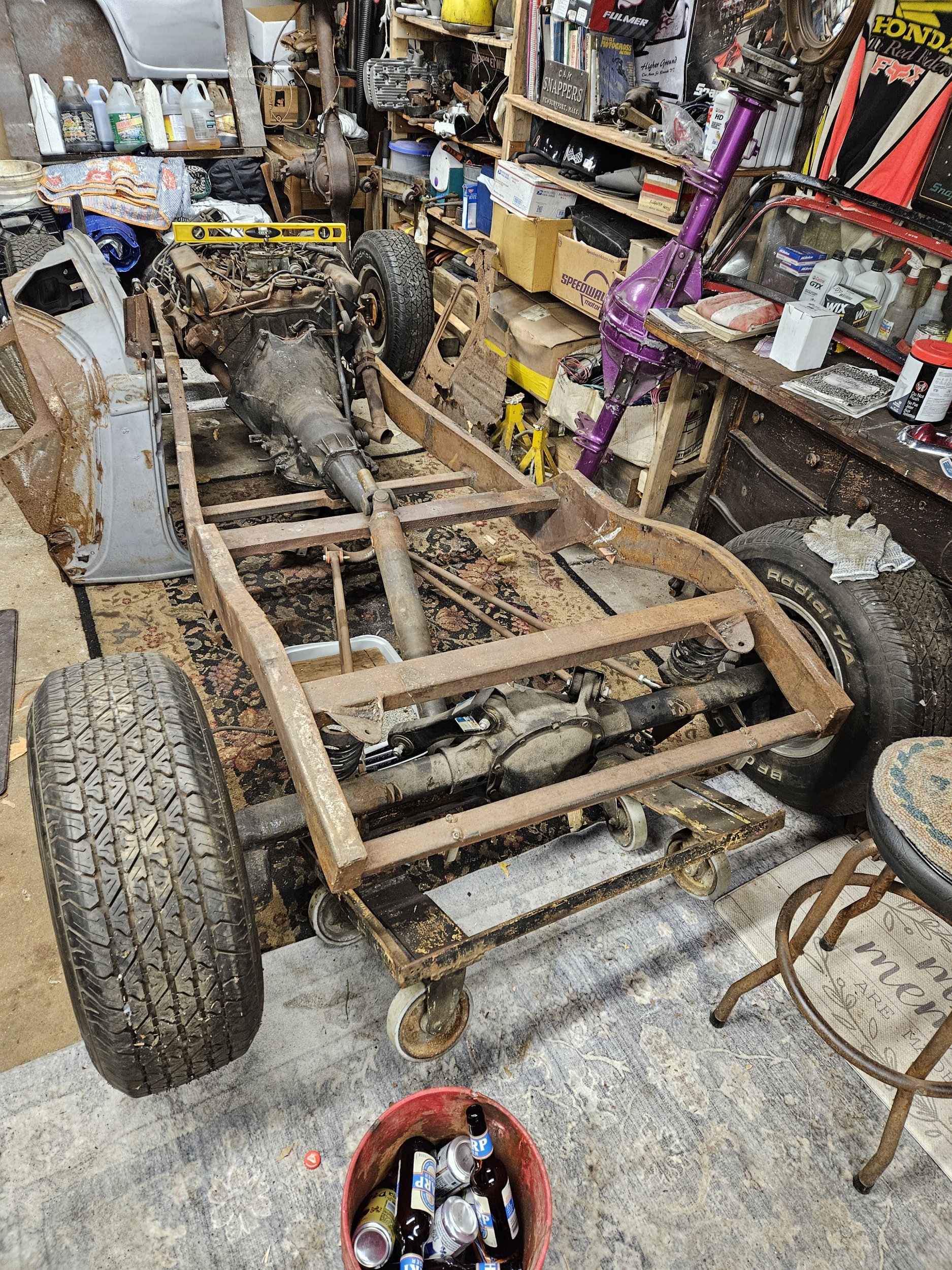

    Body shuffle so I can tackle rear suspension 20241227_195249.jpg 20241227_195311.jpg 20241227_195318.jpg 20241227_195332.jpg

    BOP rear, huh? Those are strong 10 bolt units. Also, it's fun to look at the background in the pictures!

    Thanks Steve, been collecting for some time and have no space. I believe that rear to be 80s GM Monte SS or similar. It has limited slip so that’s cool.

    I cut the crossmember out, it was a little crooked and too far forward. 33-34 wheelbase is 112" not 109.5".
    Brackets tacked on the rear need to be clocked up a little so the bars are more adjustable and pinion angle can be correct.

    I think all this stuff will need to be hacked off 20250109_190746.jpg 20250109_190733.jpg

    I did hack off the ladder bar brackets and the coil spring seats from the axle. The cross member was welded and welded again so I decided that most needs to be cut off. Still in measuring and planning stage but making forward progress.

    Planning for cowl feet, sub rails, and floor so I can get the body mounted back
    on this chassis. I found a home made passengers side cowl foot that almost fits in the clobbered yellow car. I made a driver's side one today at the shop- we have a big metal brake there 20250202_085520.jpg 20250202_091436.jpg 20250202_095848.jpg
    you can see that there was some trial and error but oh well

    Please, please, PLEASE get rid of the carpet and cardboard underneath the frame. One stray spark, hidden underneath or between either one can slowly smolder and eventually turn into something far worse. DAMHIK.
