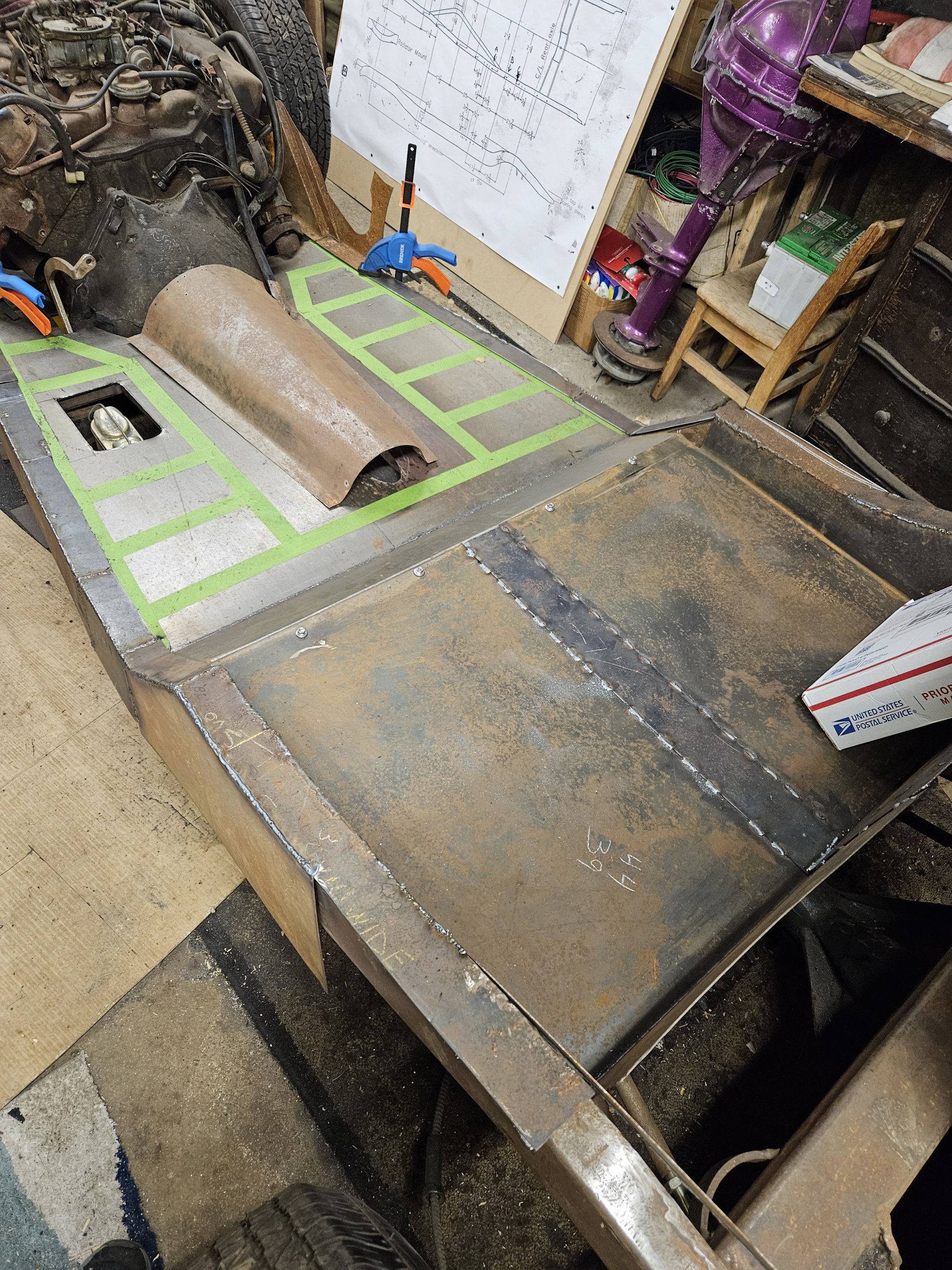

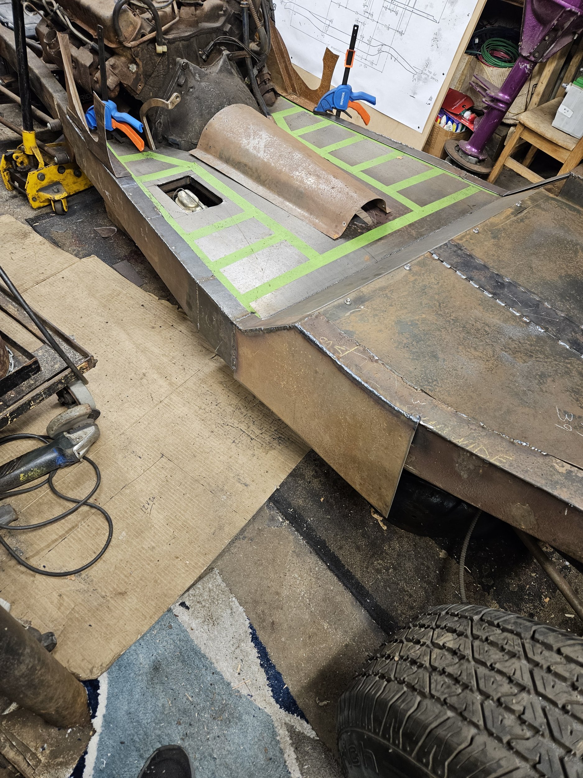

    Wasn't sure about the "mid floor area" but I figured what the hell, it's made already. . . 20250225_175710.jpg 20250225_175721.jpg
    Subrails made through 'b' post area. Now I'm ready to put body back on

    can you show a quick and dirty shot of forming that 'cone'?-nice!
    porkshop likes this.
  12. wheeldog57
    Joined: Dec 6, 2013
    Posts: 3,857
    wheeldog57
    @patsurf do you mean the transmission tunnel? It came with the car. I bent it, cut the support piece off of the end, and trimmed the flanges. So far I think I'll use it.
    bchctybob and porkshop like this.

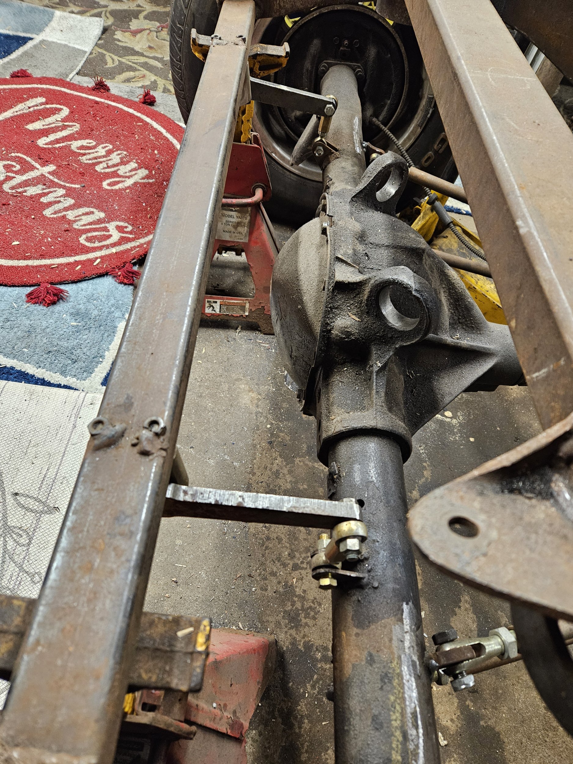

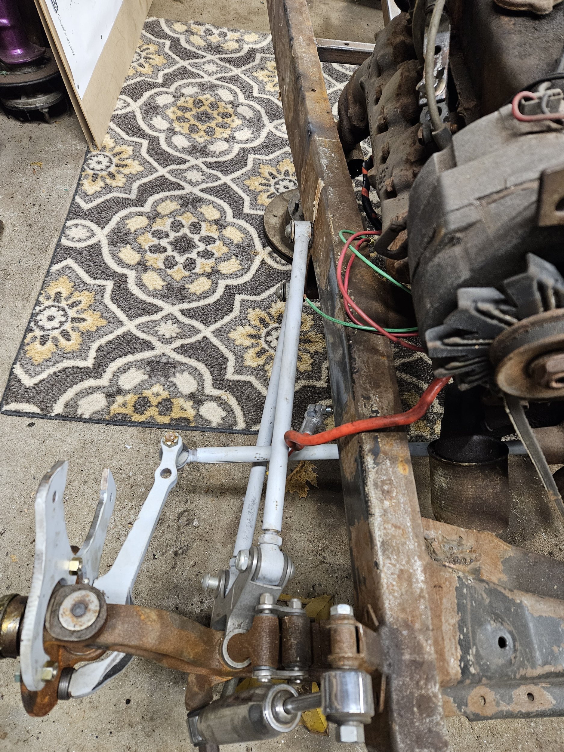

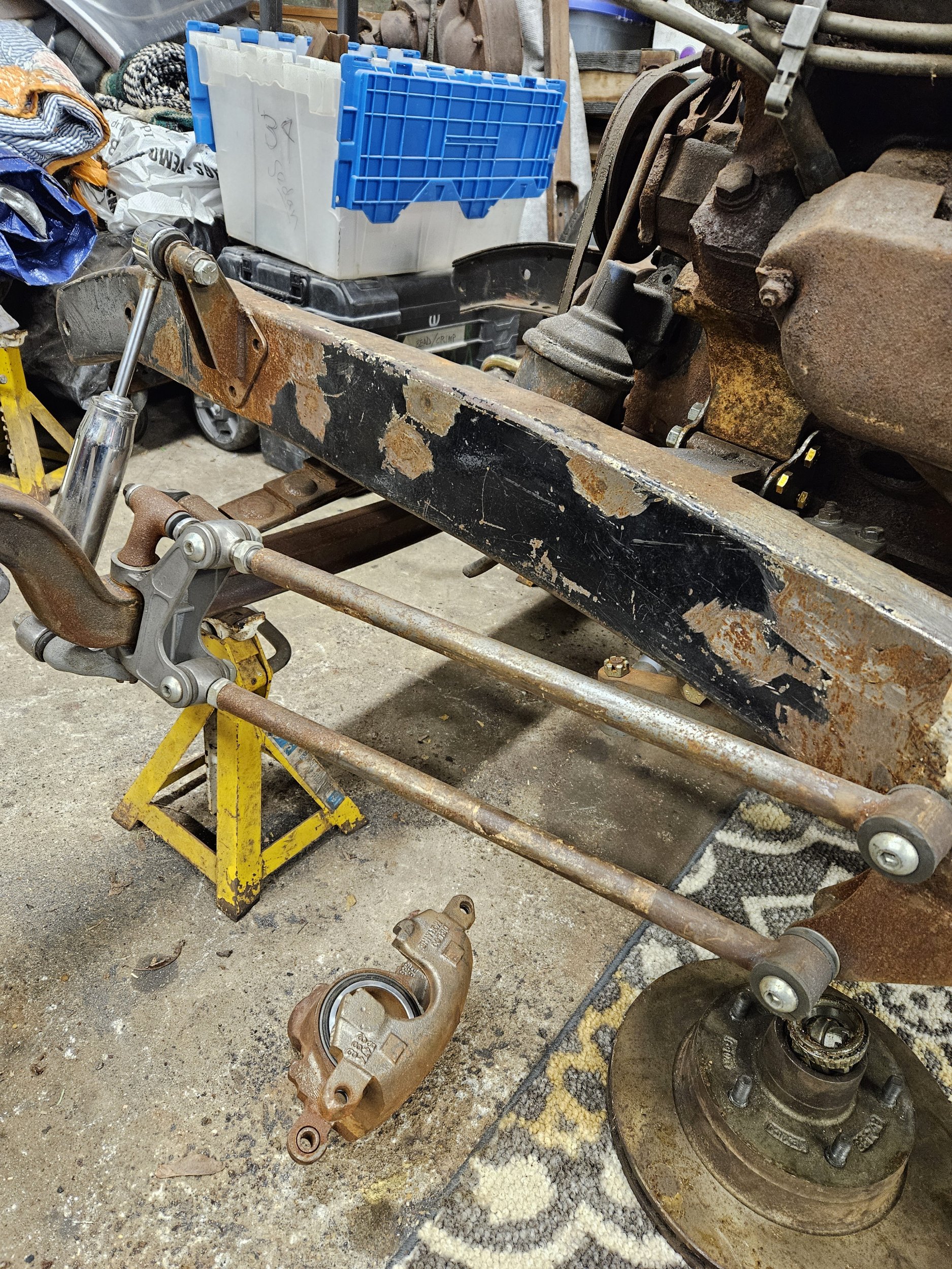

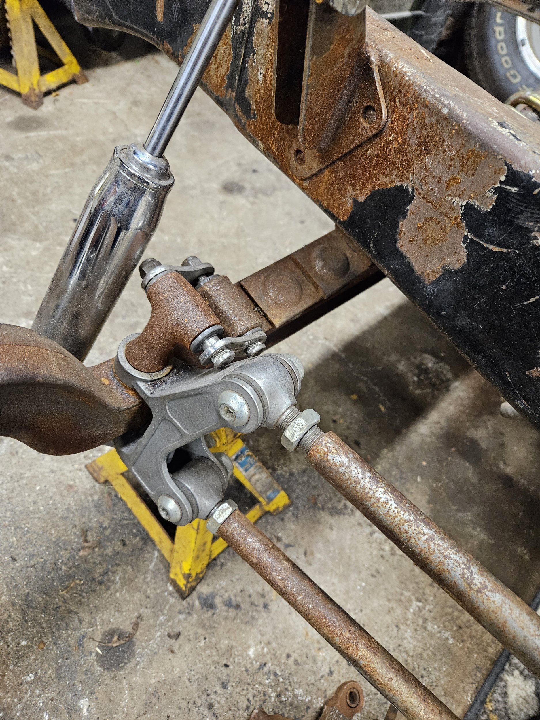

    Are these 4 bars and bat wings installed correctly? Parallel to the ground but not to each other when you look down on them. Any insight would be appreciated 20250301_200443.jpg 20250301_200452.jpg 20250301_200506.jpg 20250301_200443.jpg 20250301_200452.jpg 20250301_200506.jpg
    bchctybob, porkshop and Thor1 like this.
  15. The37Kid
    Joined: Apr 30, 2004
    Posts: 32,545
    The37Kid
    Just wondering are Bat Wings made Left and Right sided?
    wheeldog57 likes this.
  16. wheeldog57
    Joined: Dec 6, 2013
    Posts: 3,857
    wheeldog57
    Handmade floor and sub rails took mucho hours and patience but I am happy with the results. If the body fits over it snugly then I'll be really happy with the results!
  17. RodStRace
    Joined: Dec 7, 2007
    Posts: 9,023
    RodStRace
    Currently, they are like the angled rear 4 bars. I'd see if swapping them as @The37Kid mentions gets them aligned.
    As with many rods, the limited amount of travel hides flaws, but I'd try to get them in the same plane. That has got to be putting them into some side twist forces they aren't designed for. Rear bars are almost always in double shear.
    Also, on the left side, I'd have the shackle bolts go front to back (like the right side) for servicing. They may need a bit of a trim to clear.

    Thanks for the replies, all hardware was installed by previous owner (nylock nuts everywhere) and most just mocked up.
    I'll try swapping sides and see if anything changes.

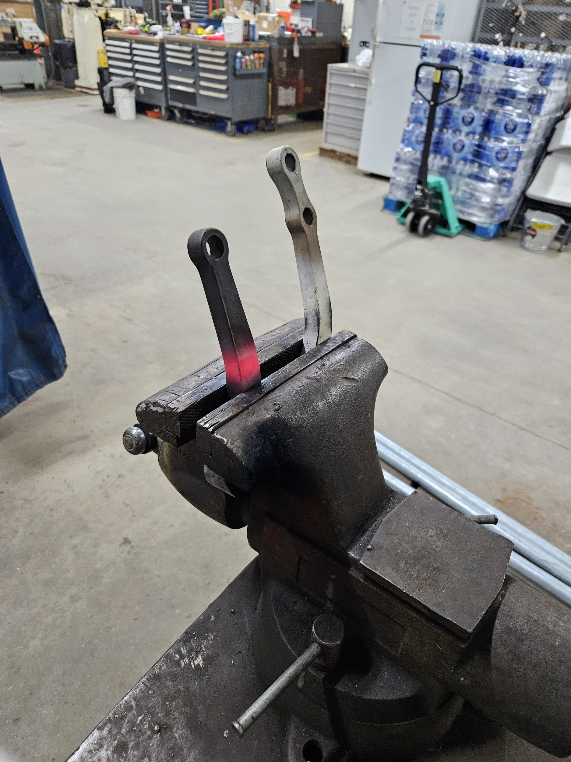

    Been working on front brakes, namely trying to get the brakes ***embled but steering components are trying to occupy the same space. Tomorrow I bring the steering arms to work to give them the blue wrench drop treatment. Also I need one tie rod end and one outer wheel bearing- P.O. had two different sizes installed, yikes. Anyway I shortened rear sway bar end links and dry fit them. Also mocked up steering column with twine. 20250309_201414.jpg 20250309_201425.jpg 20250309_201524.jpg 20250309_201614.jpg
    bchctybob, NoSurf, RodStRace and 2 others like this.
  23. wheeldog57
    Joined: Dec 6, 2013
    Posts: 3,857
    wheeldog57
    17416299668848262397798924945500.jpg 20250310_121551.jpg 20250310_122347.jpg 20250310_122900.jpg
    Senter auto parts Plaistow,NH
    I bring them random parts. They ask me the usual. . . "What are they off of?" What year car?" I don't know I'm putting a hot rod together from spare parts. "Ok, no problem" everytime, they always have what I need. In stock!!
    I heated and bent the steering arms at work today too. Mint

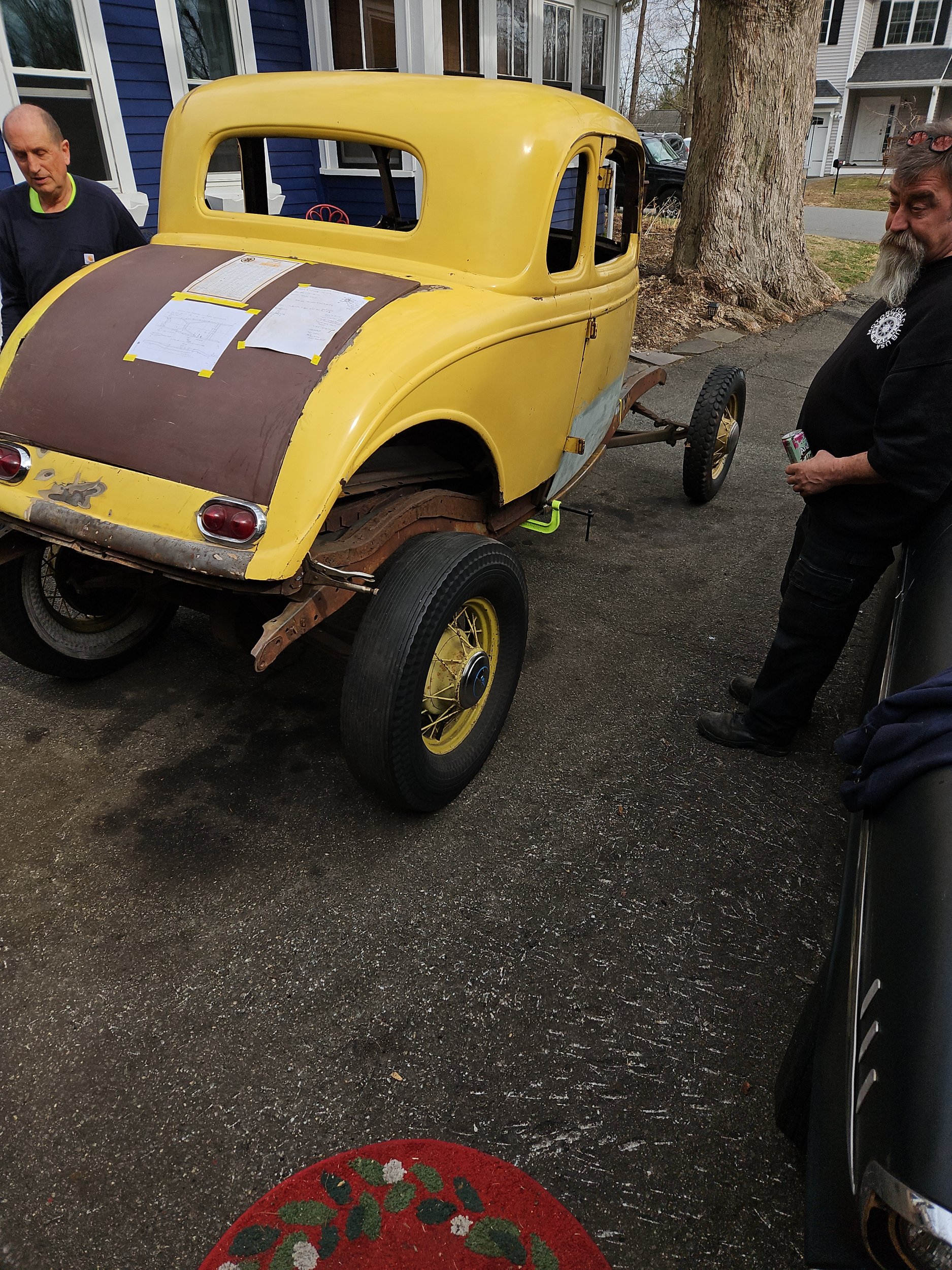

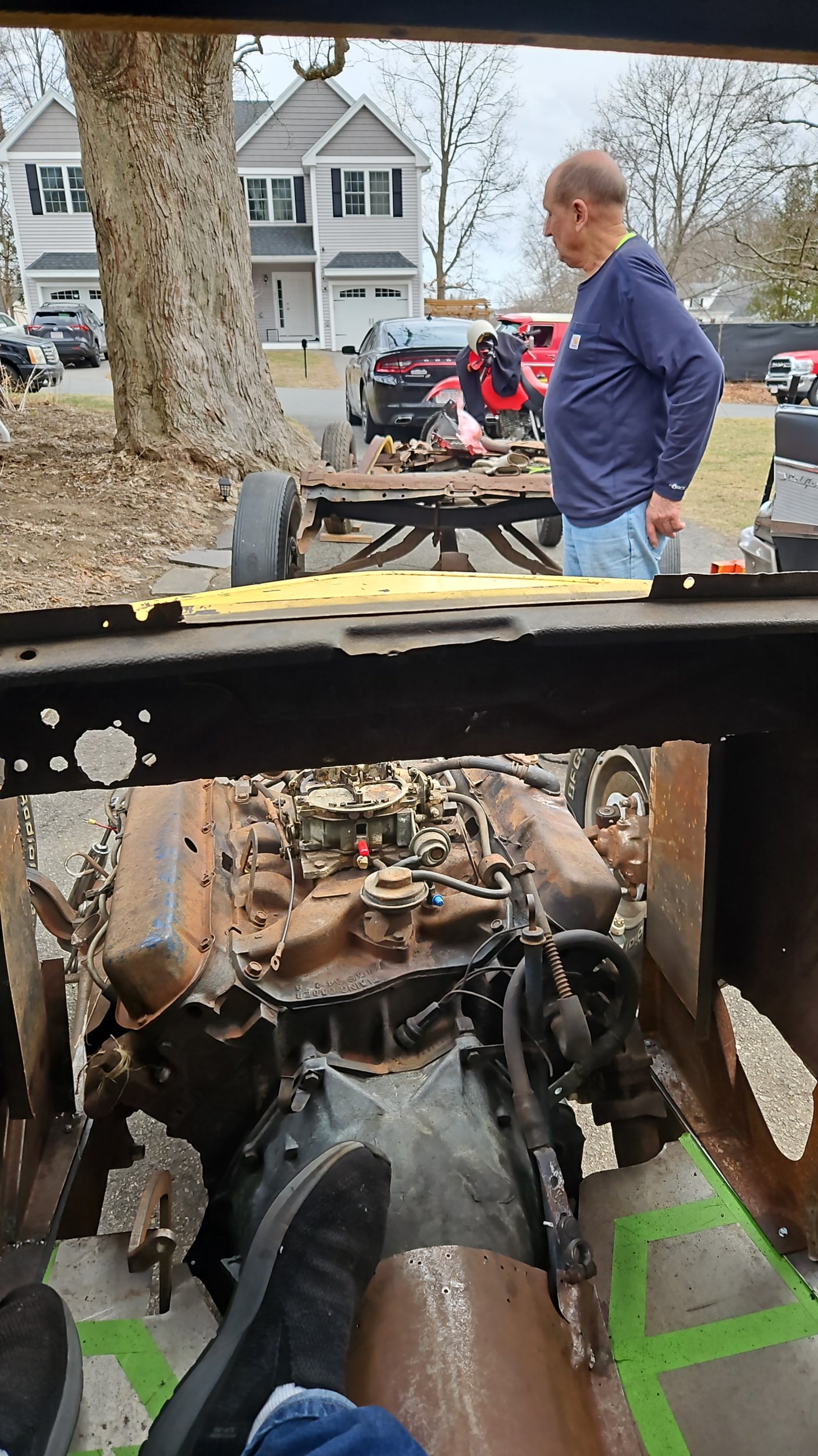

    Neighbor Steve came over he said " hey what are we doing today?" I said hopefully some guys show up and we can put the body back on this ch***is. Well, dontcha know. . . . Everybody came by today e81a820d-2adf-45fe-88ac-e9fc85de9a40.jpg 20250316_152827.jpg IMG-20250316-WA0004.jpeg IMG-20250316-WA0006.jpeg 20250316_163731.jpg

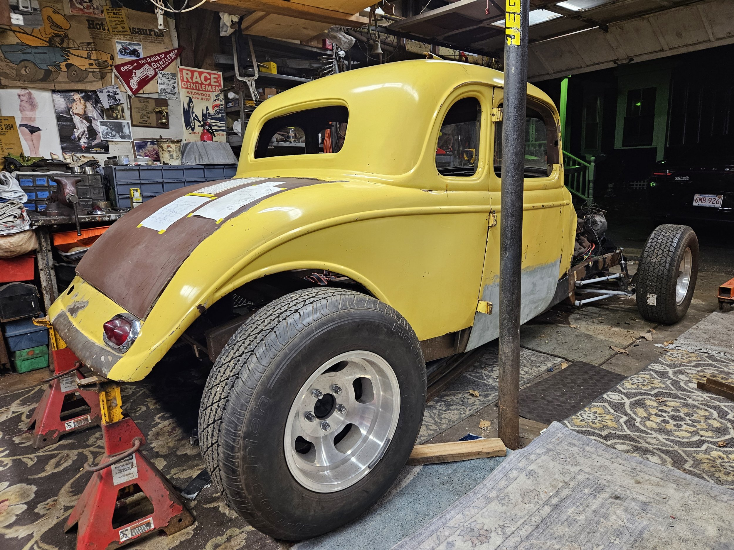

    What a huge difference an inch and a half makes 20250316_180904.jpg 20250316_180825.jpg

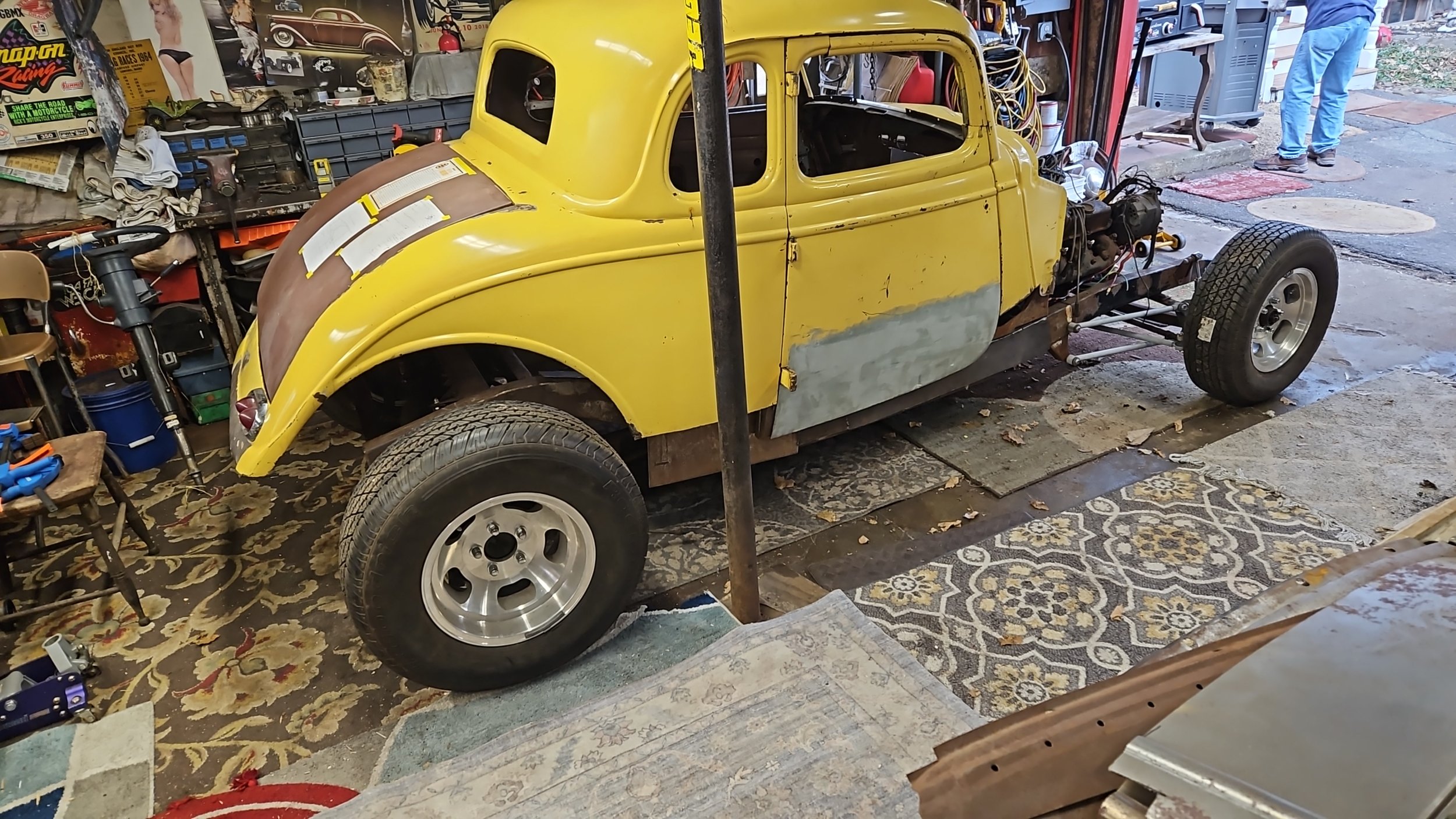

    After mucho adjustments I think this'll be the ride height 20250320_204447.jpg

    The body was very difficult to control while trying to get ride height UNTIL I welded the doors closed. Within 5 minutes I had what I wanted 20250320_205207.jpg
