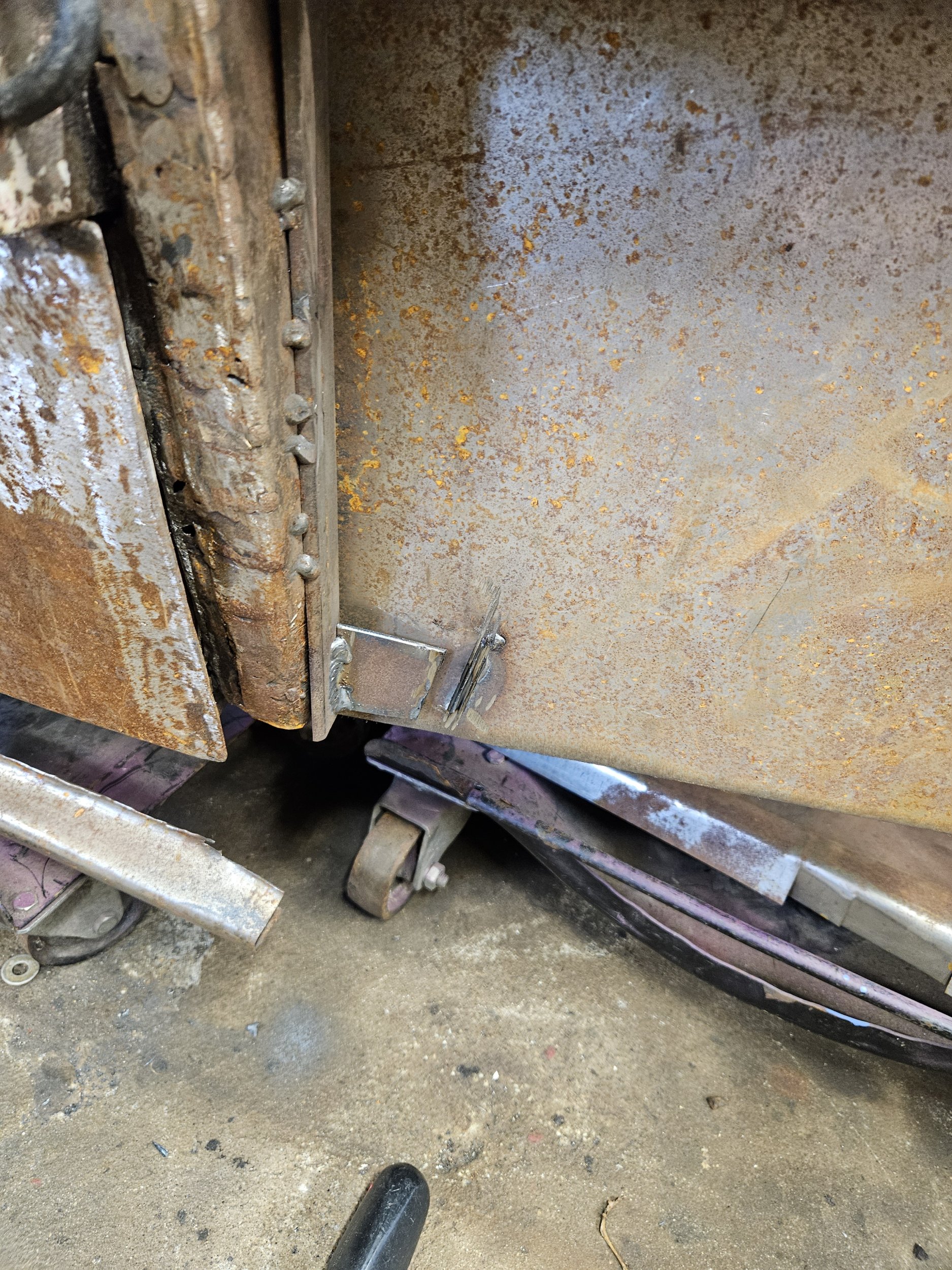

    Hinges back on with no washers ( before it was loaded to make up for B pillar being bent) all 3 Hinges at B pillar had nuts welded in and the upper the holes didn't line up. I hogged out the hinge and beveled the now oval hole, mint. 20250706_105039.jpg 20250706_105108.jpg

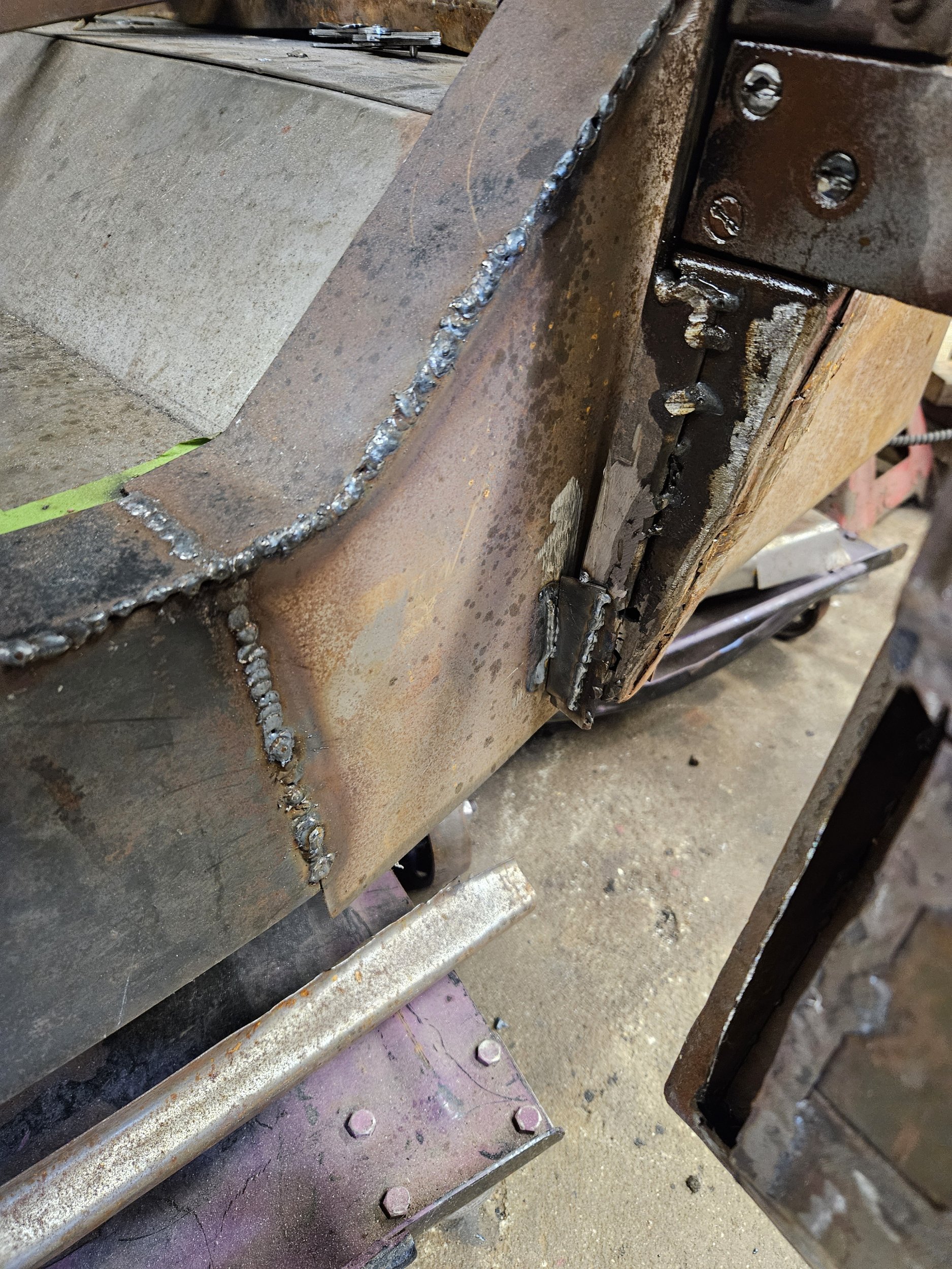

    Cut off wheel to the lower pillar braces and a ratchet strap got me back in shape.
    Now waiting for the MIG wire delivery so I can get back together 20250706_122954.jpg 20250706_122757.jpg 20250706_122804.jpg 20250706_131127.jpg 20250706_131112.jpg

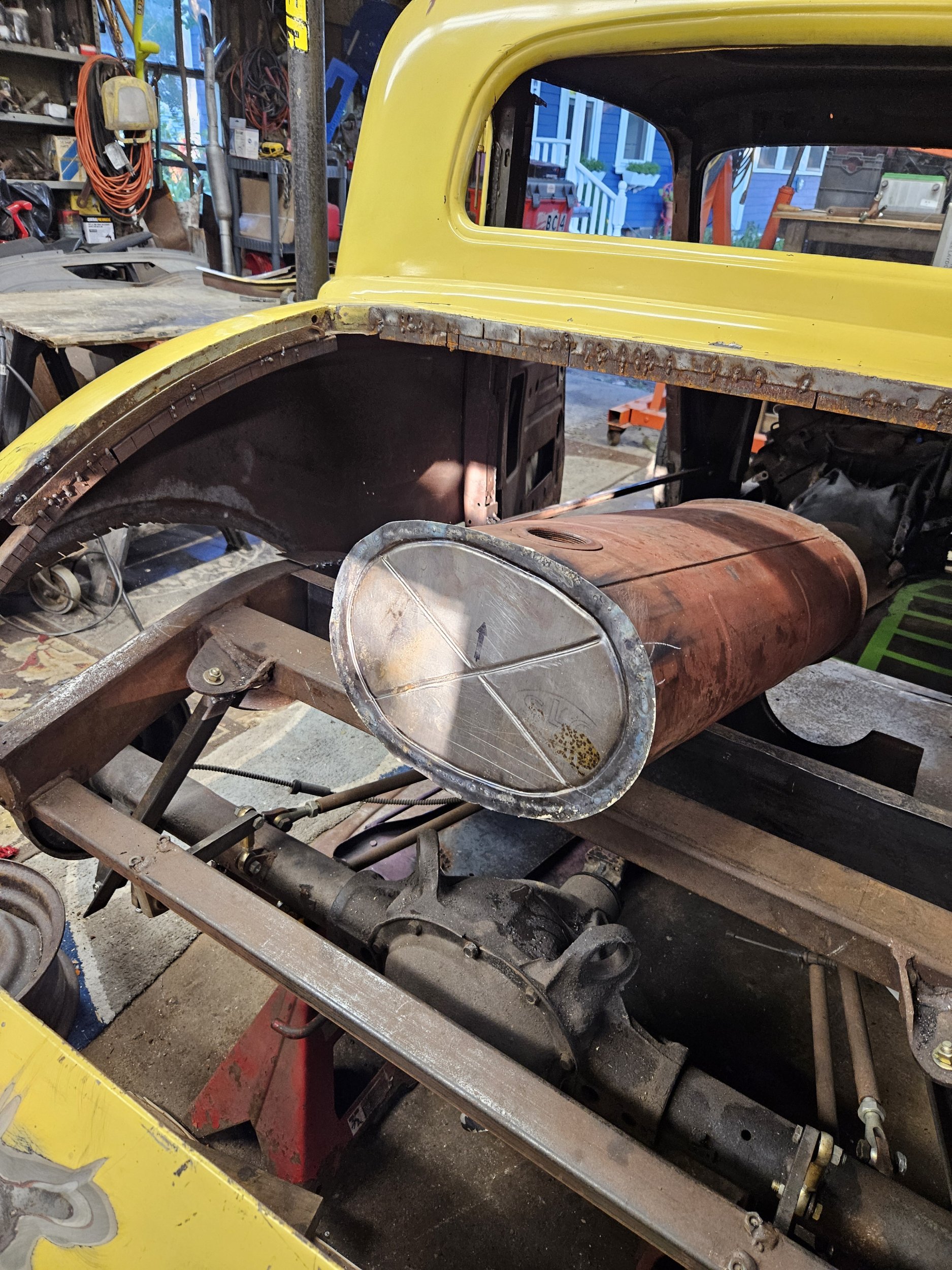

    Got the delivery and welded the pillar brace. Released the ratchet strap and the door opening opened up again! Ratchet strap ratchet tight again and temp brace from A pillar to B pillar. Move onto gas tank 20250706_145322.jpg 20250706_145743.jpg 20250706_185201.jpg 20250706_185221.jpg
    Red squirrel is homeless now. Not calling myself a welder until I can seal this tank. It has about a dozen leaks in it

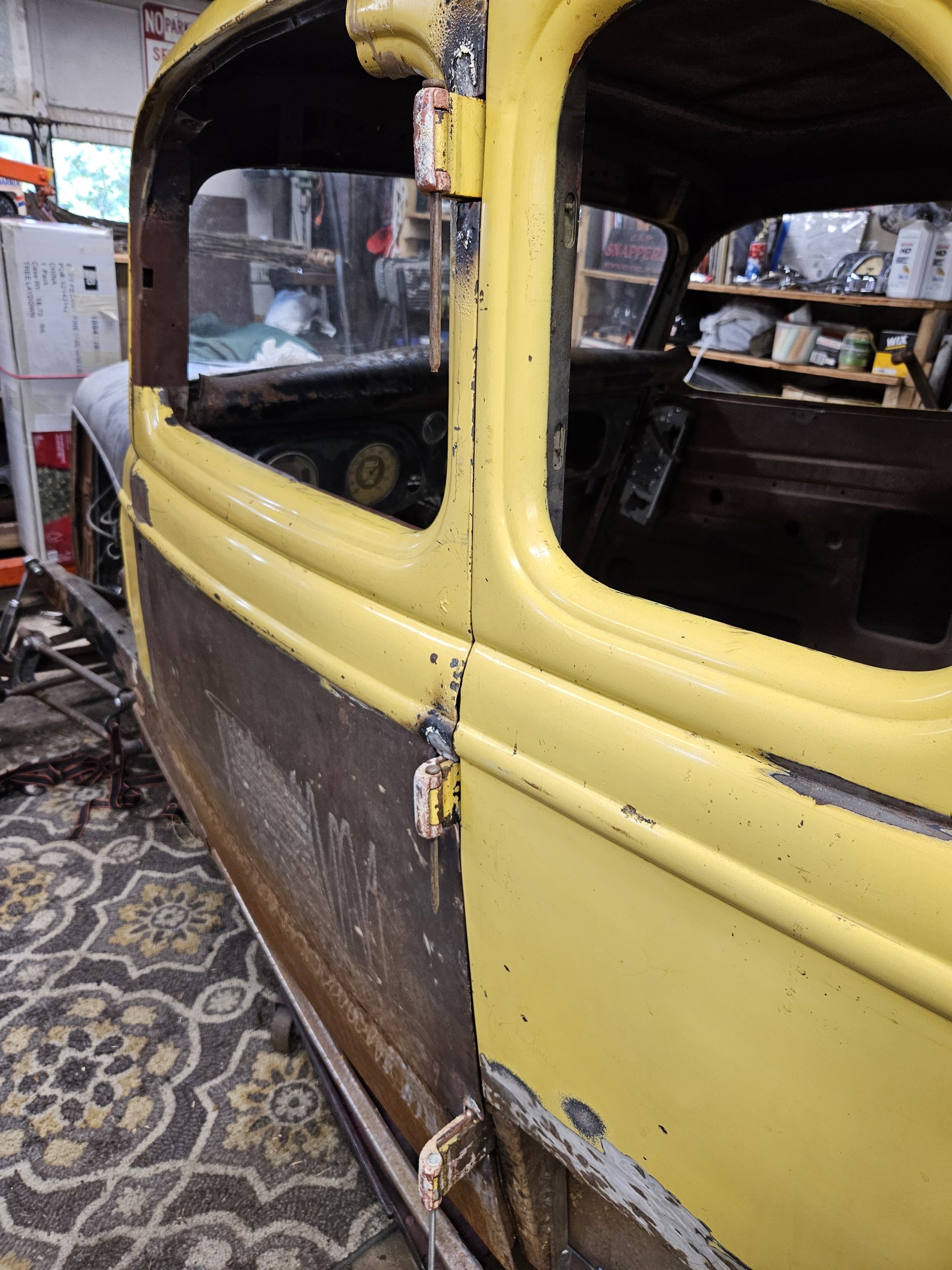

    Went over a fellow Snapper's place, he's got torches. We heated up and bent the 3 hinges back to straight. Installed the door and don't you know it closed the gap quite a bit! 20250708_172512.jpg 20250708_172523.jpg 20250708_172529.jpg
    Man, I am pumped about this!!

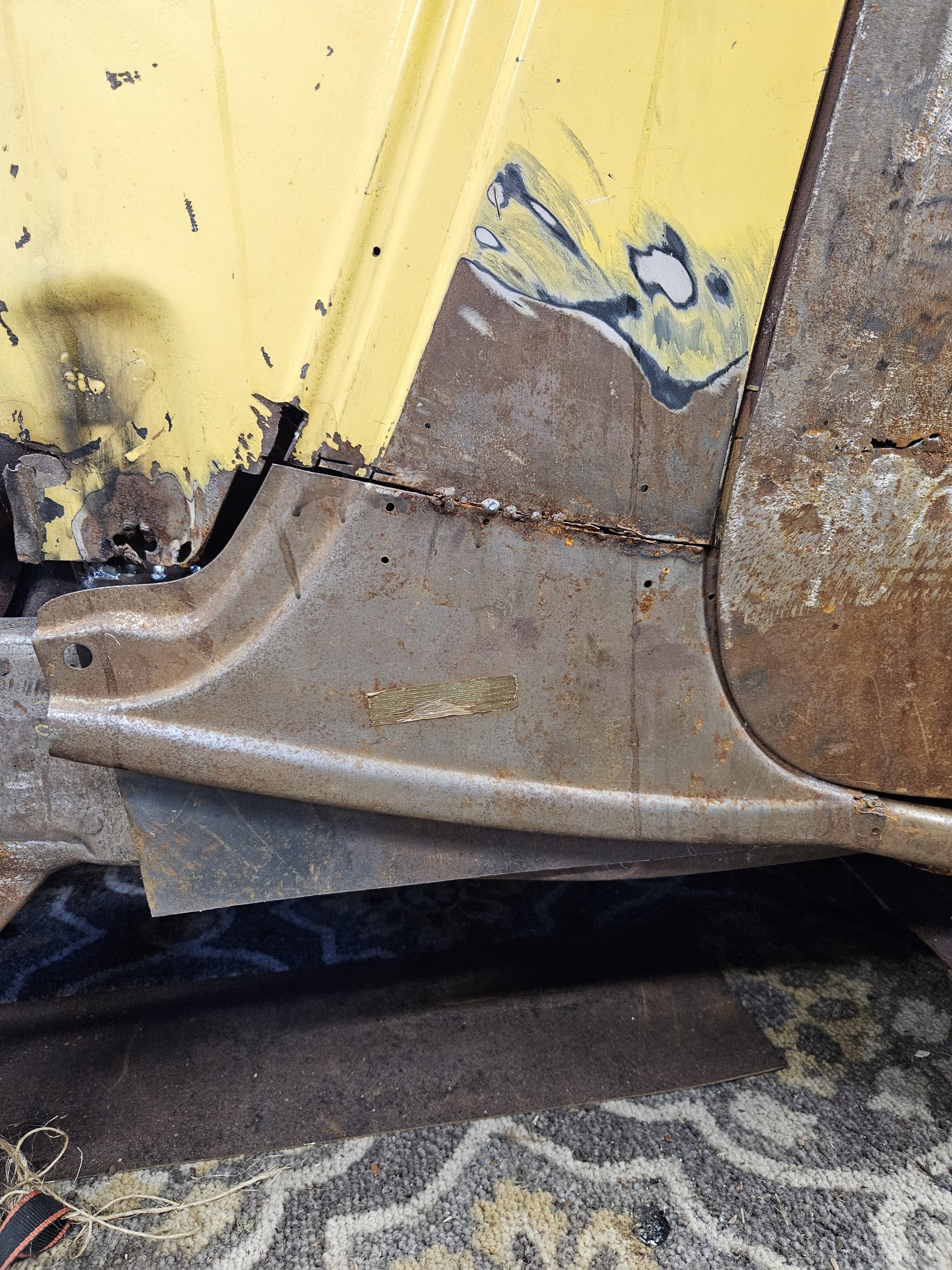

    wheeldog57

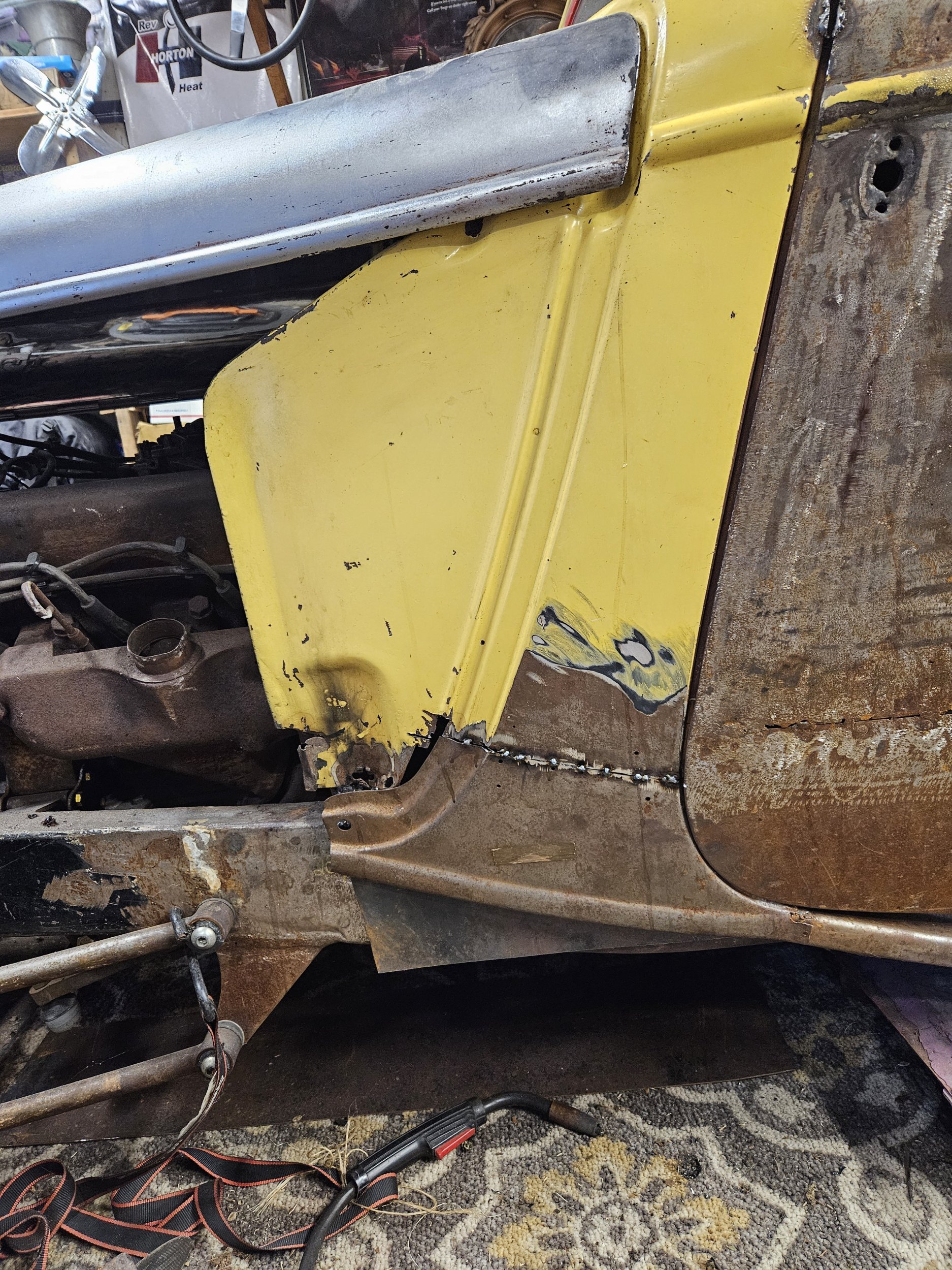

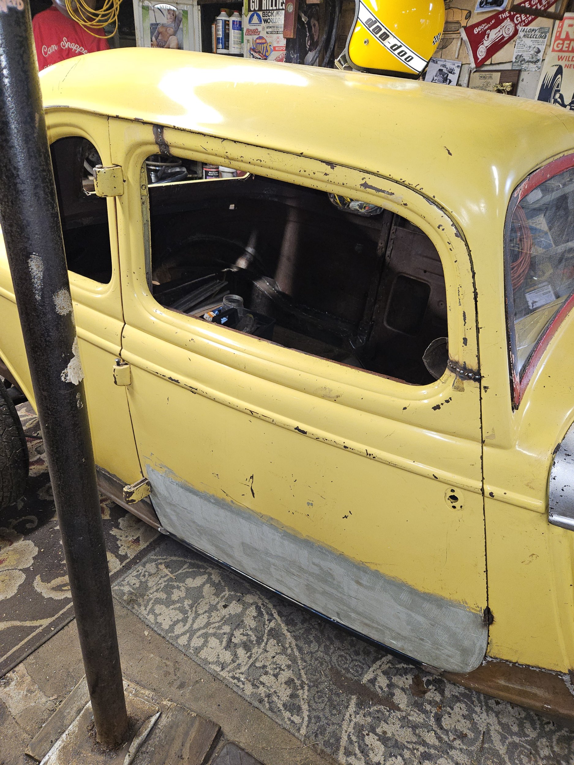

    After studying the driver's door for the last couple of weeks I just can't stop looking at the cowl patch, it's crooked! The eye doesn't lie. I cut it off, cleaned up the adjoining areas very carefully and then tacked it back on. Now I will be able to sleep tonight 20250708_172843.jpg 20250708_175743.jpg

    wheeldog57

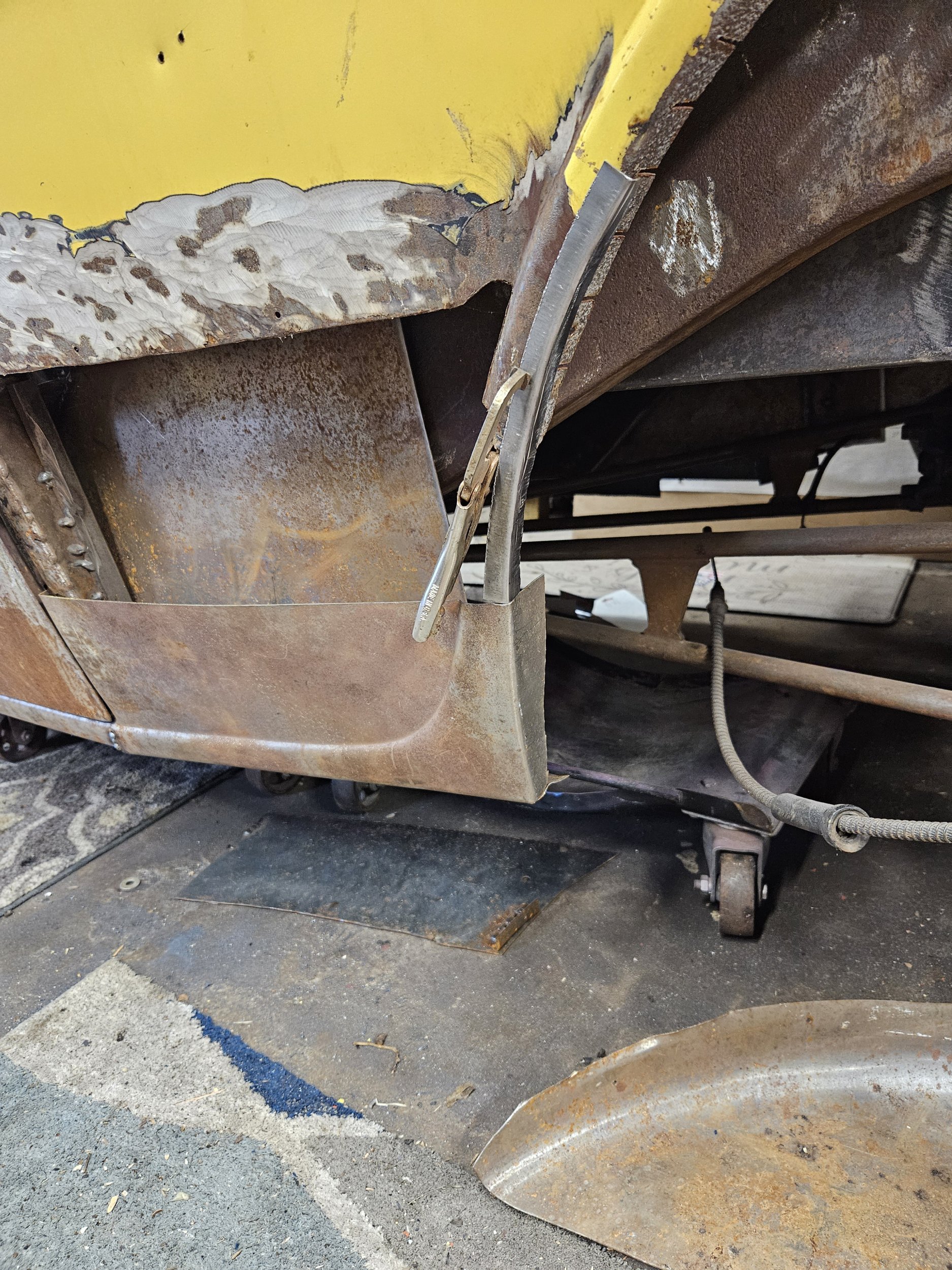

    I locked in the cowl patch, s***ch welded the rocker below the door, then mocked up my future panels. 20250709_200524.jpg

    Been holding off on the door tops for lack of confidence. Today I just went for it and I'm happy with the results 20250711_120627.jpg 20250711_120635.jpg 20250711_151358.jpg

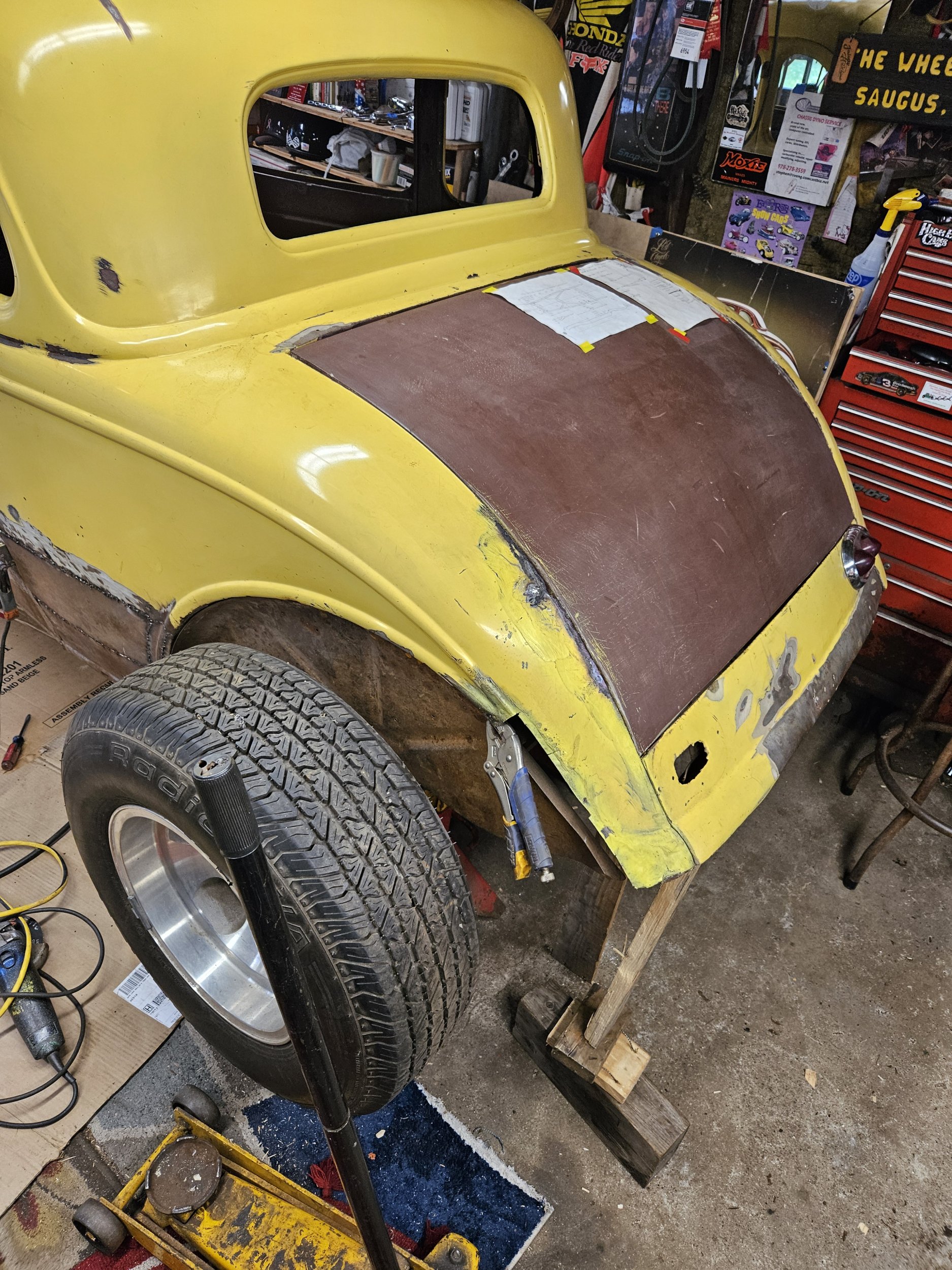

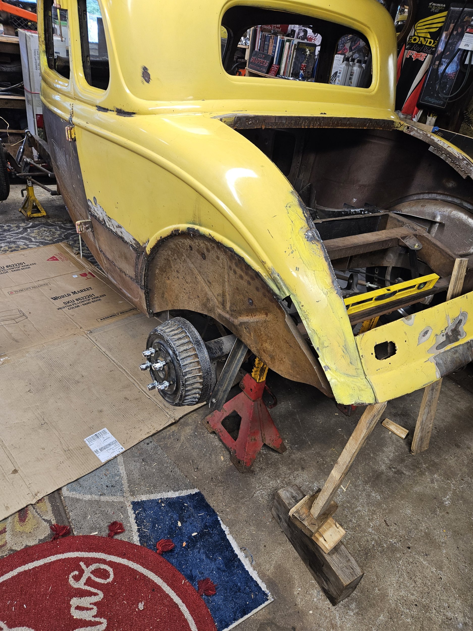

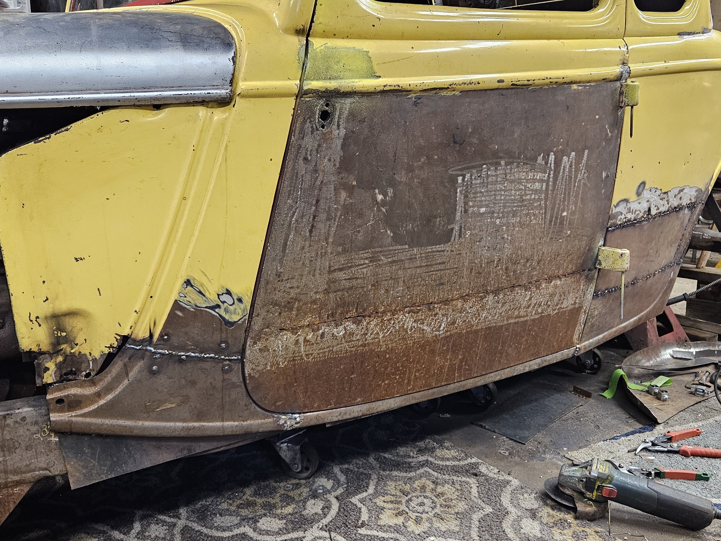

    Sheet metal fitting and measuring and fitting and re-fitting and shrinking and stretching and cutting and fitting. Driver's side quarter panel was cut off pretty high behind the door. I don't have a beader die to make the reveal but I do have an old patch panel. . . . Quite happy with the results. Shrinking and stretching tools are excellent 20250714_171518.jpg 20250714_172137.jpg 20250714_173540.jpg 20250714_174218.jpg 20250714_181206.jpg 20250714_194431.jpg
    Going to slowly and carefully weld these pieces in. This is curved front to back and top to bottom

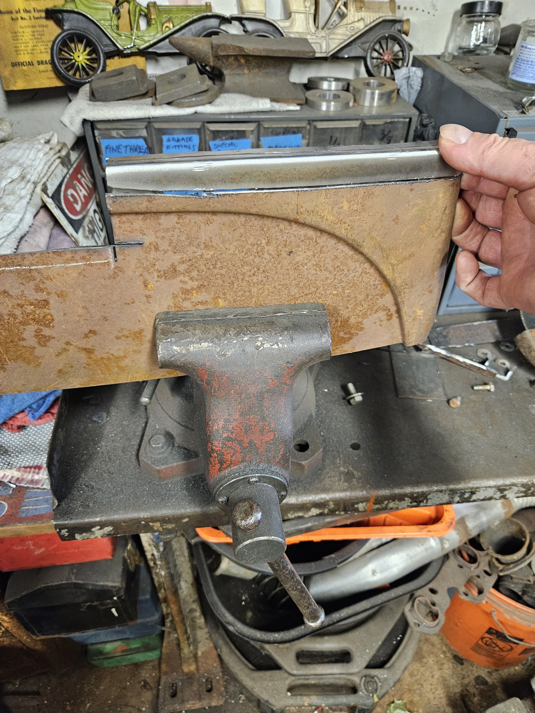

    20250713_162958.jpg 20250713_162947.jpg 20250714_145435.jpg 17525374695751898105900788897366.jpg I also made a patch for inside the driver's door at the lower cowl area. Many curves and steps in this, I got it close then squeezed the vice grips to **** it into place

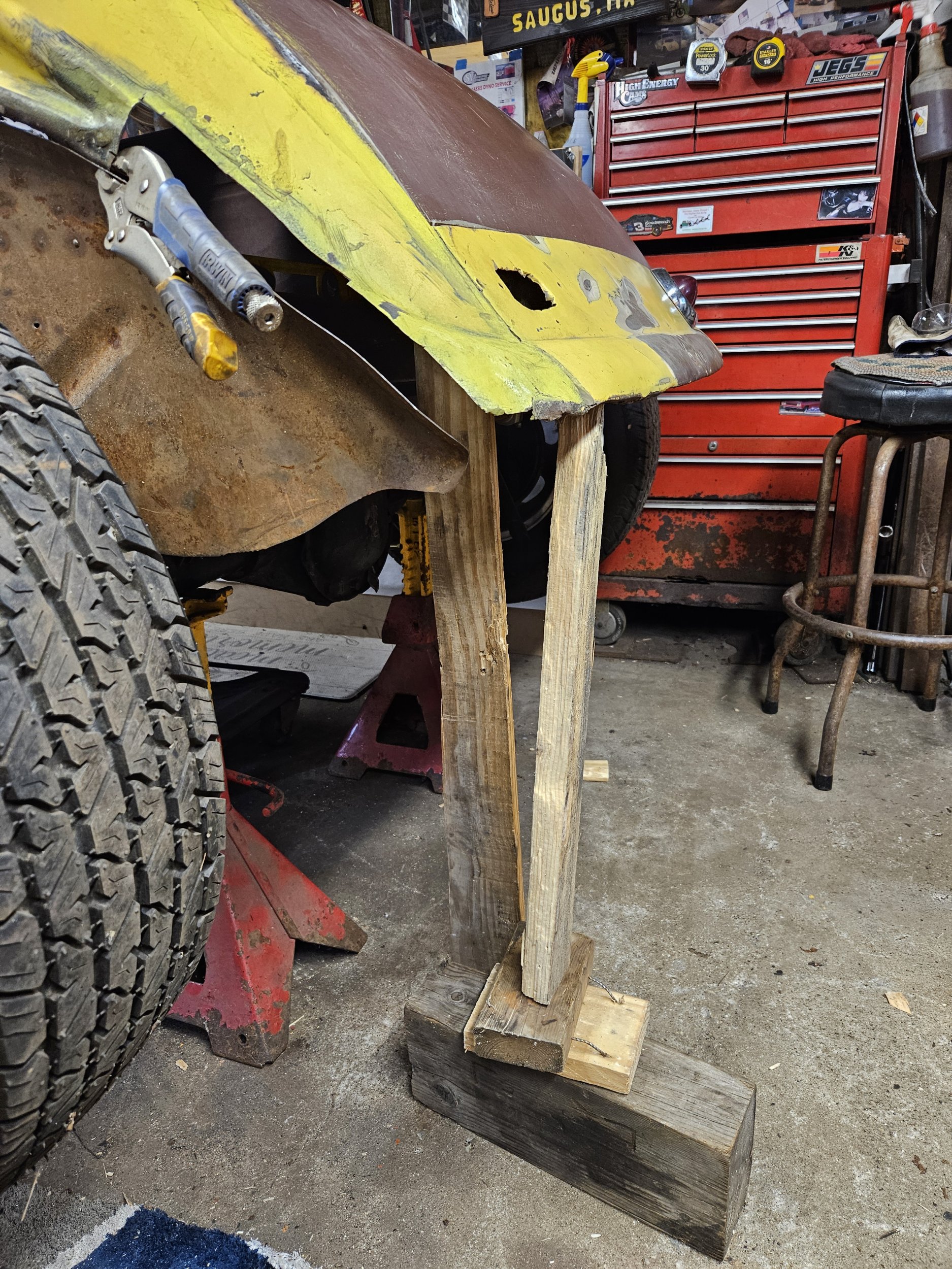

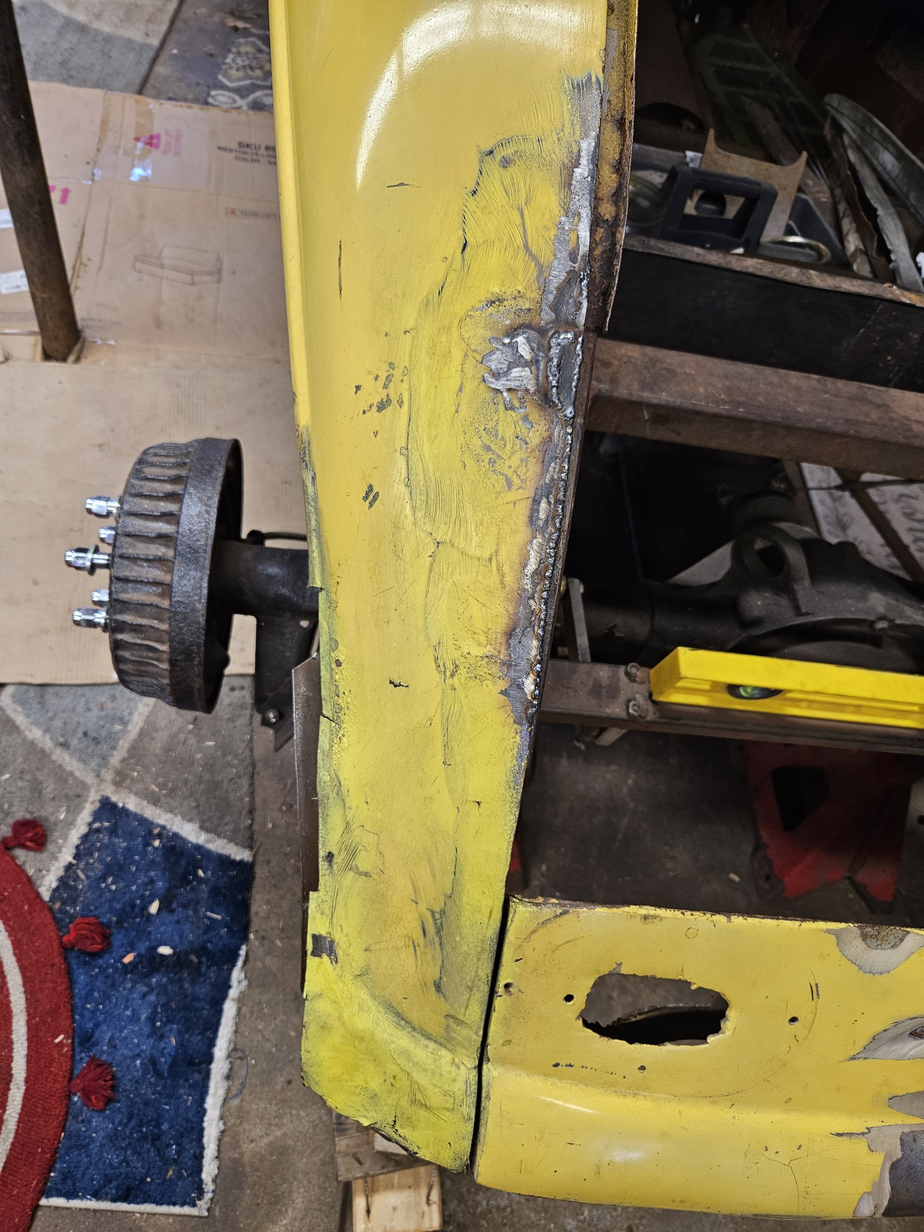

    PHEW! Slow and slower. Small tack welds, pushing out from the back to keep it from ****ing in. It's hard for me to go slow- I want to zip it up and be done!
    Very happy with my patience and the results of being patient. 20250715_161903.jpg 20250715_161941.jpg 20250715_162010.jpg

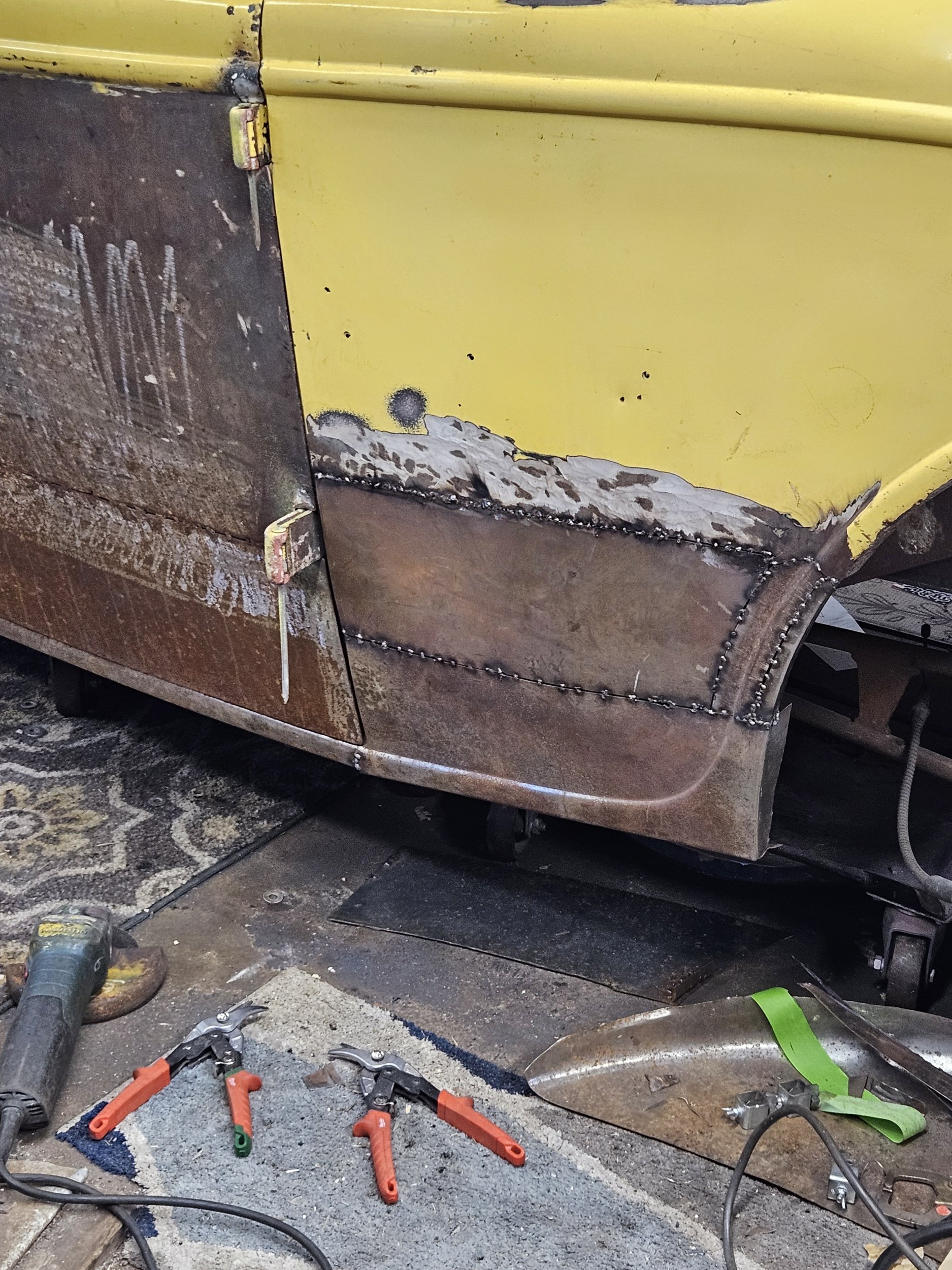

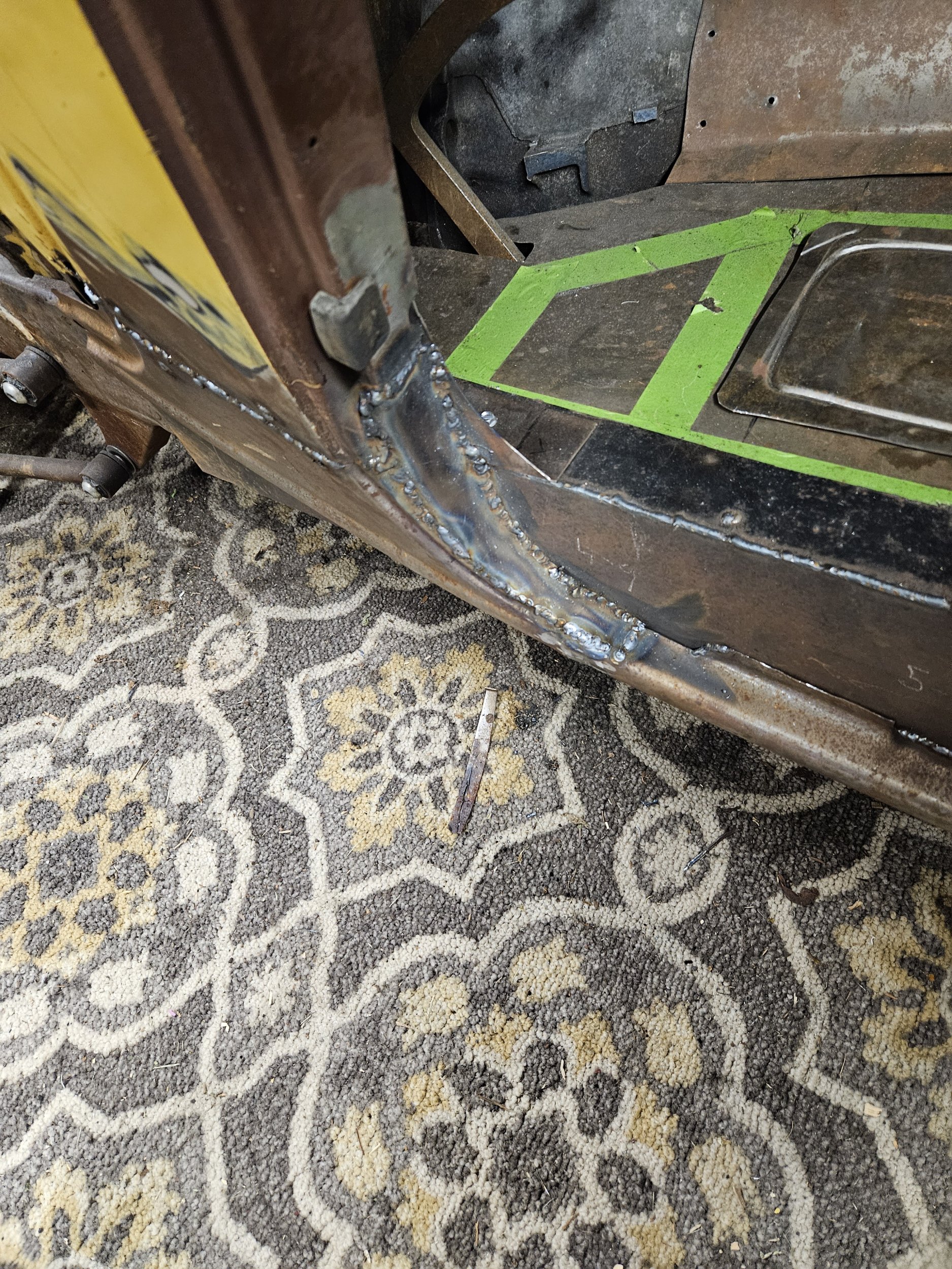

    Lots of welding today, bottom of B pillar, sub rail back to axle, wheel well all welded out. Still need to grind and finish but Lots of progress today 20250717_094427.jpg 20250717_094441.jpg 20250717_124358.jpg 20250717_124415.jpg 20250717_124433.jpg 20250717_142914.jpg 20250717_152301.jpg 20250717_152316.jpg 20250717_152327.jpg

    I used the remnants of the quarter patch panel for the back corner of the quarter. Cut the bead in the middle, cut, fit shrink/ stretch. Cut, trim, fit, then repeat a few more times. It's not perfect but pretty damn close 20250721_170944.jpg 20250721_170934.jpg 20250721_172239.jpg 20250722_193311.jpg 20250722_193328.jpg 20250722_193343.jpg

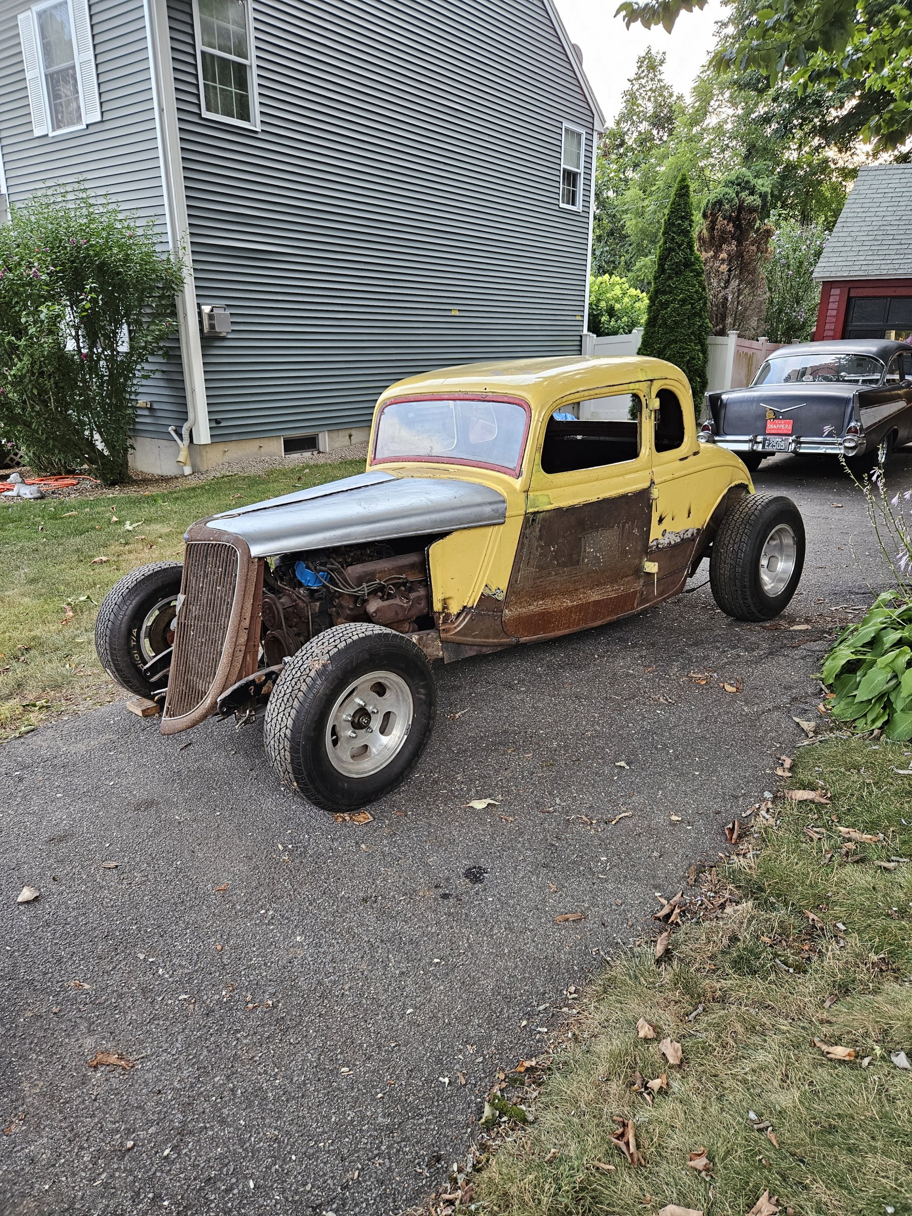

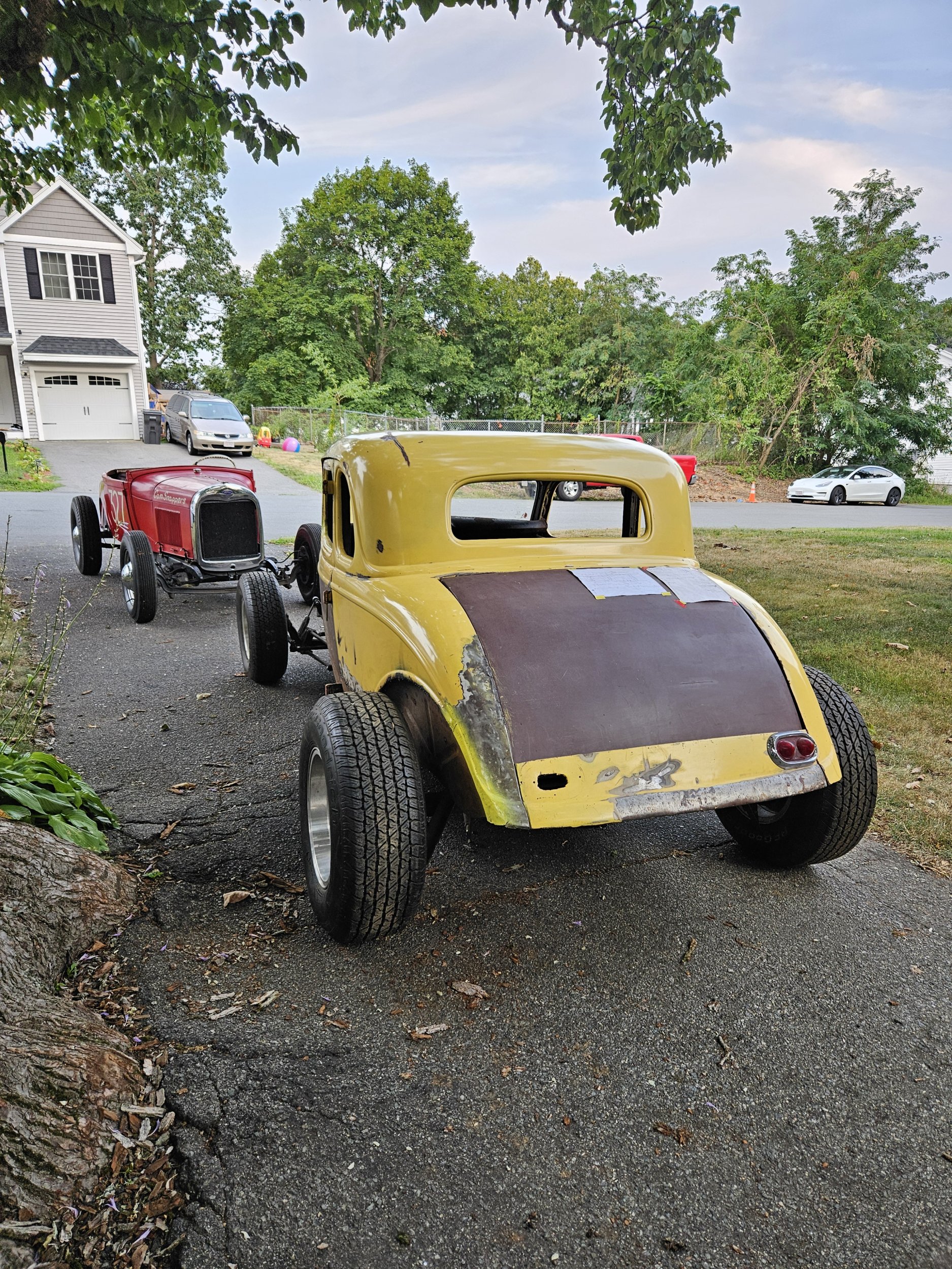

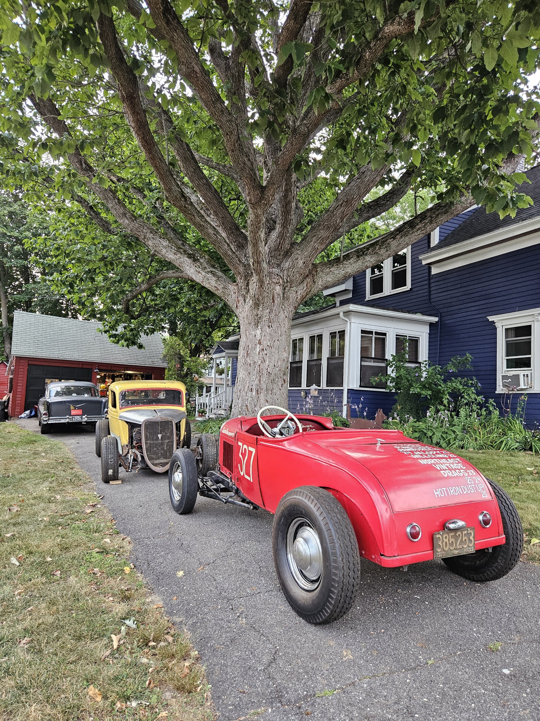

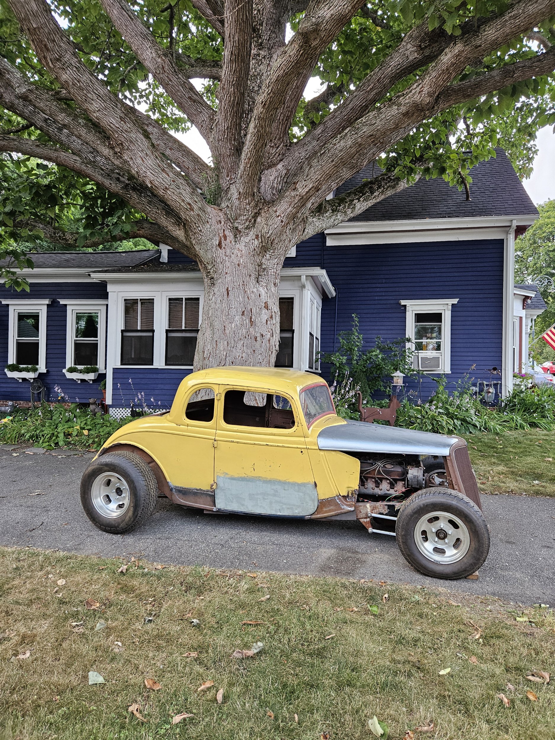

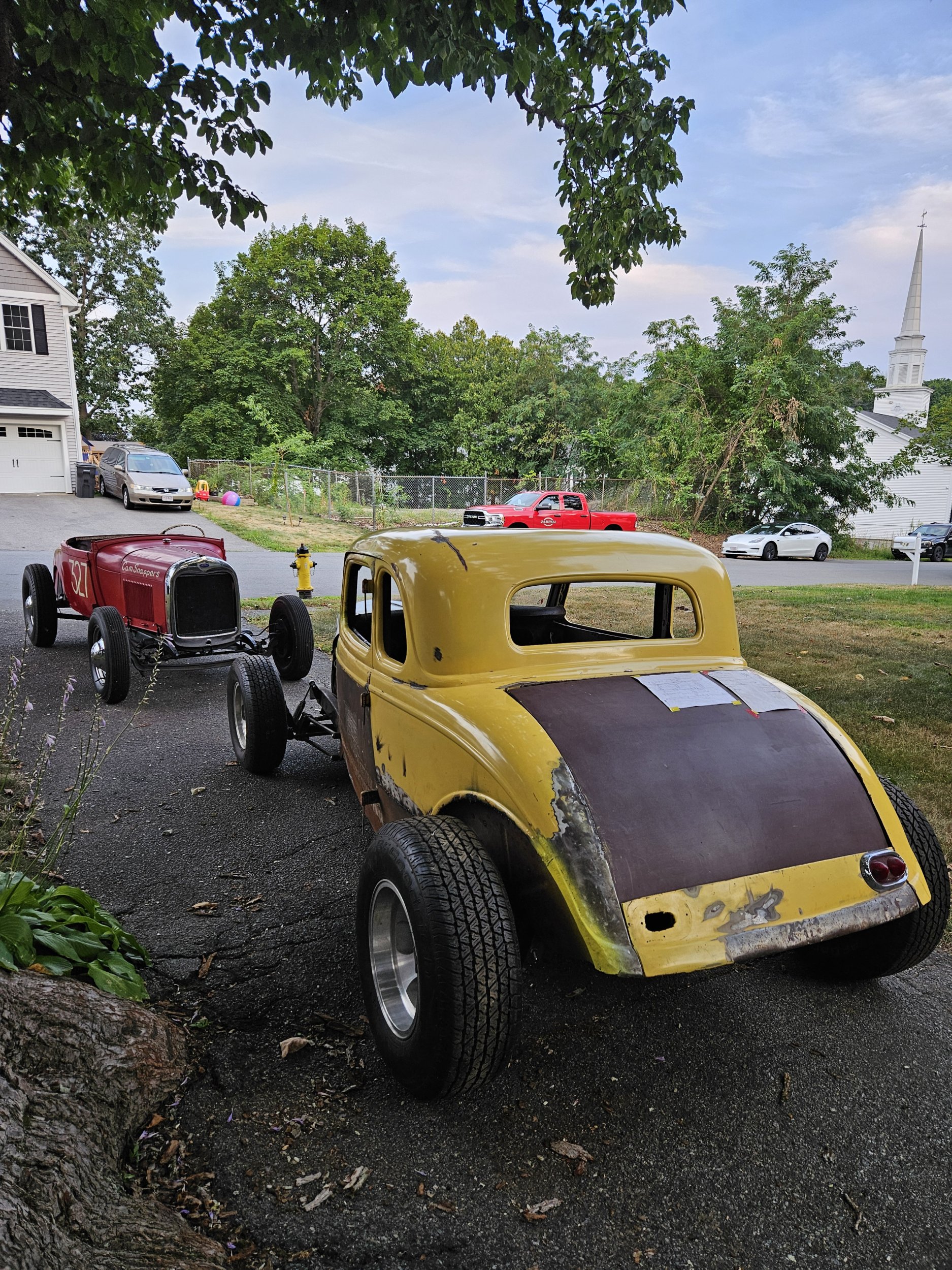

    wheeldog57

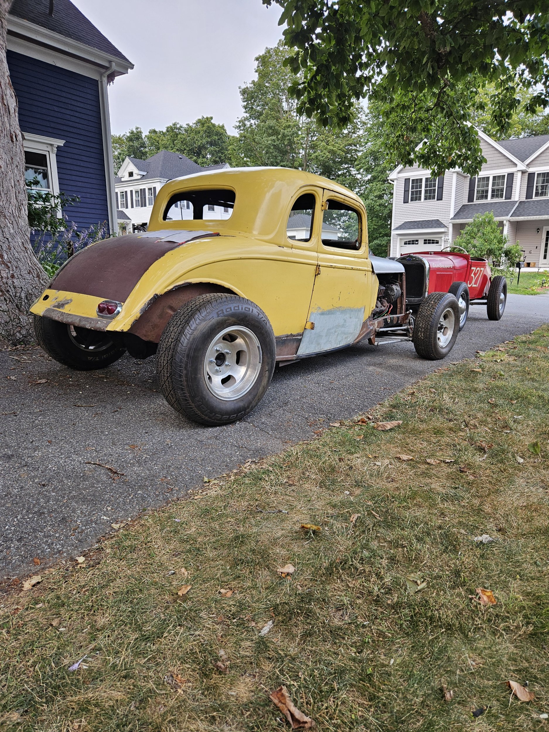

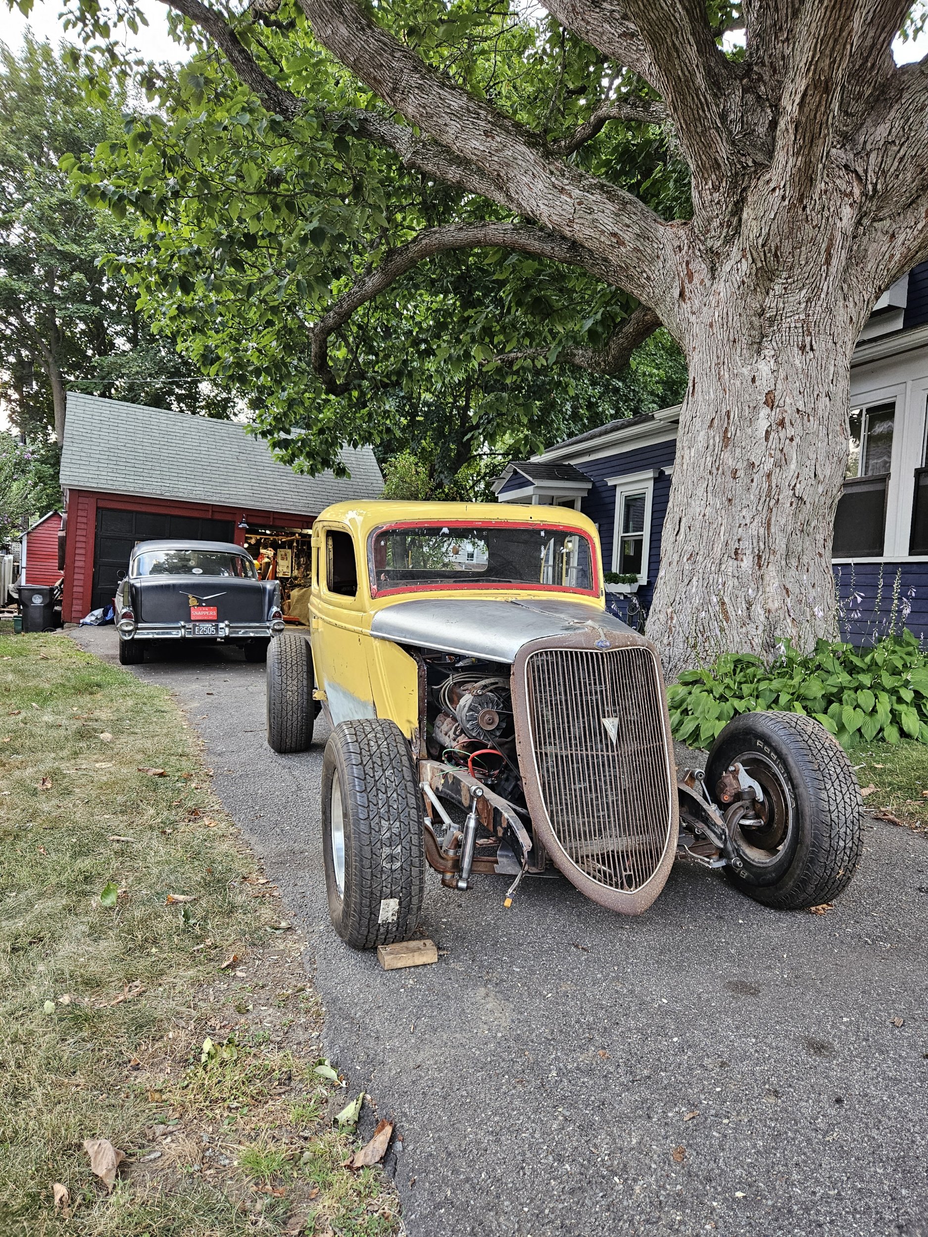

    I had to get it on the ground, step back and look at it from a distance. It's been a long time. 20250726_192158.jpg 20250726_192220.jpg 20250726_192255.jpg 20250726_192402.jpg 20250726_192439.jpg 20250726_192524.jpg 20250726_192555.jpg 20250726_195041.jpg
    Ok, I did climb in and enjoy a beer

    flamedabone
    It p***ed the "does it look cool outside " test.
    -Abone.

    ne'erdowell
    Looking great. I know it may not be HAMB friendly, but your tree is awesome :)!

    wheeldog57
    Thank you @ne'erdowell M*** DCR labeled it a legacy tree, just shy of the state champion. 20250727_170824.jpg
    P***enger door top welded in
