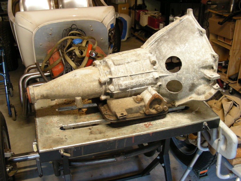

    Here's a question for the knowledgeable denizens of the hamb regarding Powerglide transmission cases. DSCN1963.JPG Here's the Powerglide that I just acquired. Look closely at the picture and you can see the two bosses typically used to run external cooler lines. You also have a great view of 2 of the big air cooling holes cast into the case. It has the standard Chevy bellhousing bolt pattern, so not a Vega transmission. Now here's the question for someone who really has infinite knowledge of the vagaries of GM oddball combinations.
    Those bosses are drilled and tapped for coolant lines. Further, it appears that they go forward to the pump. And finally, it looks like there was atf in the holes. Which leads up to my quandary.
    Was there some versions of Powerglides built from the factory with both the air cooling feature and external cooling? Some form of heavy duty, light duty Powerglide? Could something like a 250 six powered Chevelle have had a towing package that added on an external cooler? Or was this something possibly done during a rebuild to increase the durability of the transmission?
    As usual, thanks for the information, and let the verbal jousting begin!

    A lot of '60s 6 cylinder powered Chevelles and Chevy IIs had these; no cooler in the radiator, and large holes in the housing for airflow over the converter. I put one in a V8 Chevelle, removed the plugs, and hooked up the cooler lines.

    I was told the air cooled PG’s were only available in the Nova’s with the 4 cylinder motors

    You were told incorrectly.......62/63 were indeed offered with a 4 banger, but generally with a 6 cyl. The PG was in fact the air cooled case up to 64,then dropped in the Chevy II line for the newer addition with a cooler in the radiator.
    I have an early production 64/283/PG car, and it does have an air cooled glide in it, as well as 63 electronics (switches), etc...... GM was using remaining stock.

    I removed one from a '64 Chevelle with a 230 in it in the early '80s.
  13. Some aircooled PG's came with the plugged fitting holes, the air cooled versions were usually in smaller, lighter, or lesser powered vehicles and the fluid cooled versions were behind larger engines and/or in larger vehicles, but I don't remember the specific breakdowns on that, so don't quote me on it. These PG's can easily be converted to use an external cooler by swapping out the front pump with one from an externally cooled PG, or by adding a cooler byp*** valve in the air cooled pump.

    Mine has the plugs, just like yours. But as Texas has mentioned, there is something in the pump, or the actual pump itself, that redirects fluid eliminating the pressure out of the case at the plugs.
    If indeed coming from a nova, and possibly others (GM), it will have a specific bracket/linkage for the "p***ing gear" .Through rods via bracket bolted to the back of the trans case. One rod to carb, one to linkage....
