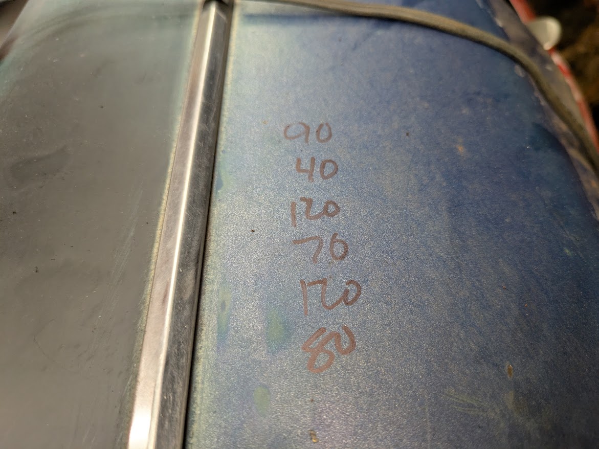

    compression test....
    and the #4 exhaust valve stem moves side to side about 1/16".
    I guess it's plumb wore out.
    Okie Pete, Baumi, ottersea and 8 others like this.
