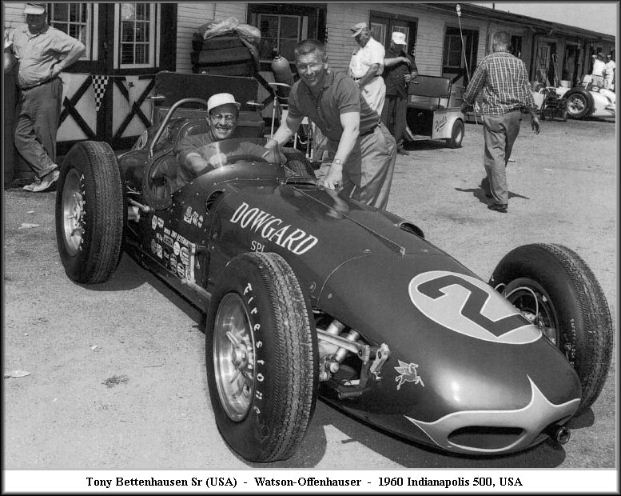

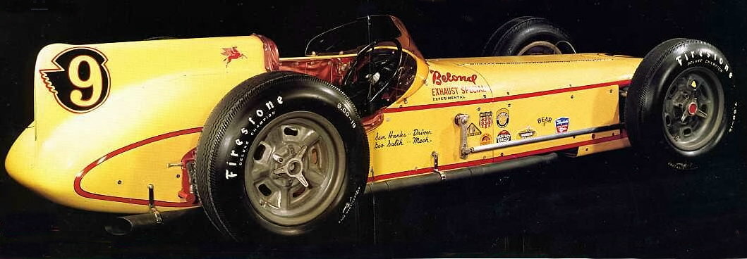

    Tread Pattern goes to the RIGHT side on INDY cars. Jo has them right. The outside of the tire would wear fastest, the tread grooves were only in the tire so the driver could VISUALLY see when he needed tires. Drivers in open ****pit, Open wheel cars can easilly view the front AND rear tires while running. (I checked Right Rear suspension on a vintage dirt car this summer going down the straight on a dirt track after a torsion stop slipped, could see frame dragging the dirt)
    Any ways, The original Firestone "Speedway tires" had a White cord in them.. and I've read many accounts where drivers are quoted as saying- "You'll see that white stripe appear and your *** better be in the NEXT lap cause if you dont you'll hear TWO BIG BANGS.. first bang is the tire going, second bang is you hitting the wall"
    These Coker Speedway tires run EXCELLENT on the street. They have a soft "race compound" for the vintage cars we run at the Speedways. Dave here at Zakira's is running a roadster right now on a set I bought from the very first batch from Coker. He ran 145 at Indy in may for several laps..
    J Shaw
  2. .
    There you have it from the man that knows. Thanks Josh.
    I wonder if the guys that ran the Indy cast-offs at Bonneville and on the dry lakes mounted them this way or if they mounted them symmetrical? Anyone know?
