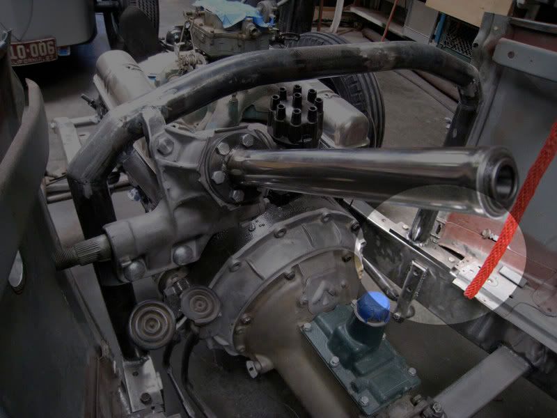

    Awesome build Chris! I hope my coupe project turns out half as nice. I'm struggling with getting my coupe to fit on the deuce rails right now.
    I was wondering if you could answer a question? I noticed that you cut the front of your subrails out. Did you replace them or tie them into your steering structure some how? I cut the front of my subrails out as well but I feel like the body is channeled too low on the rails now? I'm also curious to know what you did for the rear subrails- I didn't notice any pictures that showed them?

  13. I cut the subrails to clear the steering "hoop". Also there are some small tabs, that I cut out, alongside the body, that channeled the it over the frame about 1.25". To bring the body up, I made 1/2" wood (treated mahogany) body mounts to get a 3/4" channel. Looks just right to me and hides the usual gap between the body and frame.

    I see, so you just left the end of the subrail off. Thanks for the info!
