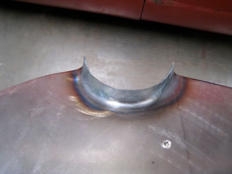

  21. A little update.
    I'm starting to feel better, about the project, since it actually looks like a car again.
    Alot of people were telling me, that shoeboxes are hard to chop, now I know why, because the damn roof is so small and all the pillars etc are tapered, so everything has to be angled/pie cut, bent in bent out, and to make it all look good.
    So, no walk in the park, but I feel I'm going in the right direction.
    Also, leaning the B-pillars is a job and a half, straight B-pillars or hardtopping would have been easier, but I'm not into easy, or that look.
    A problem I encountered putting the B pillars in, was that there are alot of round sections, that I didnt have, unlike the C-pillar, rear window curve that I simply pie cut and re-used.
    I had to come up with a "caveman" style method to make those pieces.
    I used some wood and cut out the two diameters that I needed for the job, I rounded the edges with a router (roundover bit), cut my sheetmetal to the appropriate size (oversized) and started hammering the pieces with a downward stroke, to get the desired shape, that could later be cut and used, the get nice flowing window openings. The pieces, were the stainless trim sit's on will be added later.
    The wood "buck"
    The metal is starting to bend
    Here is the smaller diameter (heated and hammered)
    Cut piece
    Some ugly unground welds, don't look.
    Here is a profile shot of the car, in it's current state.

    We have something in common......I caveman everything I have. the corners of my roof I rolled on my oxygen tank. Looks sweet Chris.

    Love the look and flow....also love the fact that your solving your problems using your own knowledge and applying it to something else...wood to metal....cool
